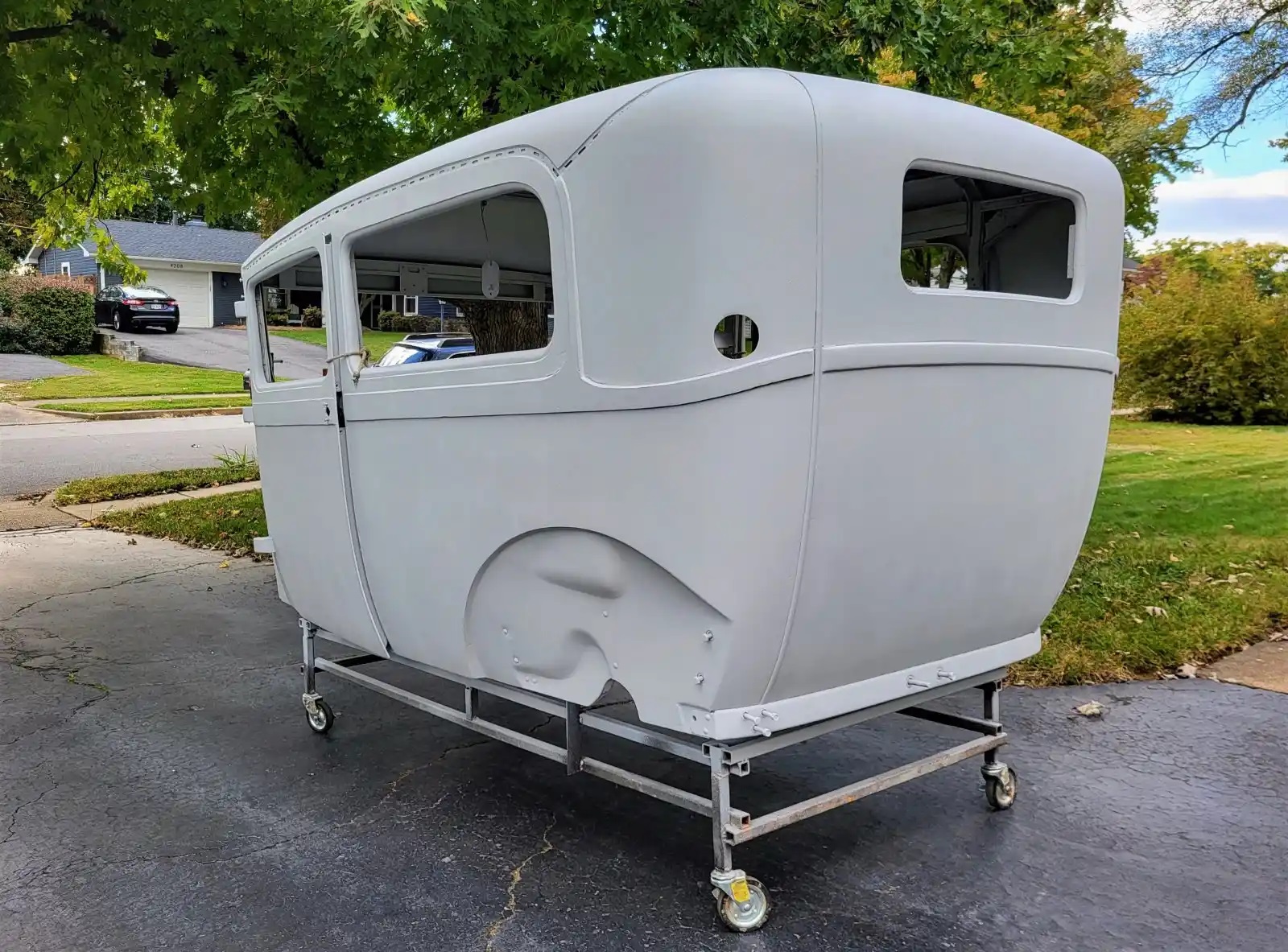

    I HIGHLY recommend them. I used their HP-5310 "Direct-to-Anything" 2-part epoxy high-build primer on my A sedan project. That stuff sticks to bare metal, filler and anything else, it's reasonable priced, and it's pretty easy to sand.
    Despite this being my first attempt with a spray gun, it turned out great.
