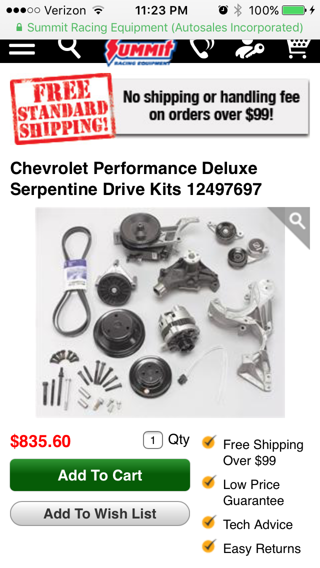

    Jalopy Joker
  6. 88-98 Chevy truck
    Available at pick a part as well at much less than 835.00
