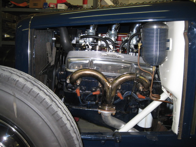

    can you 283 guys tell me what this is?

    beautiful is what i think it is

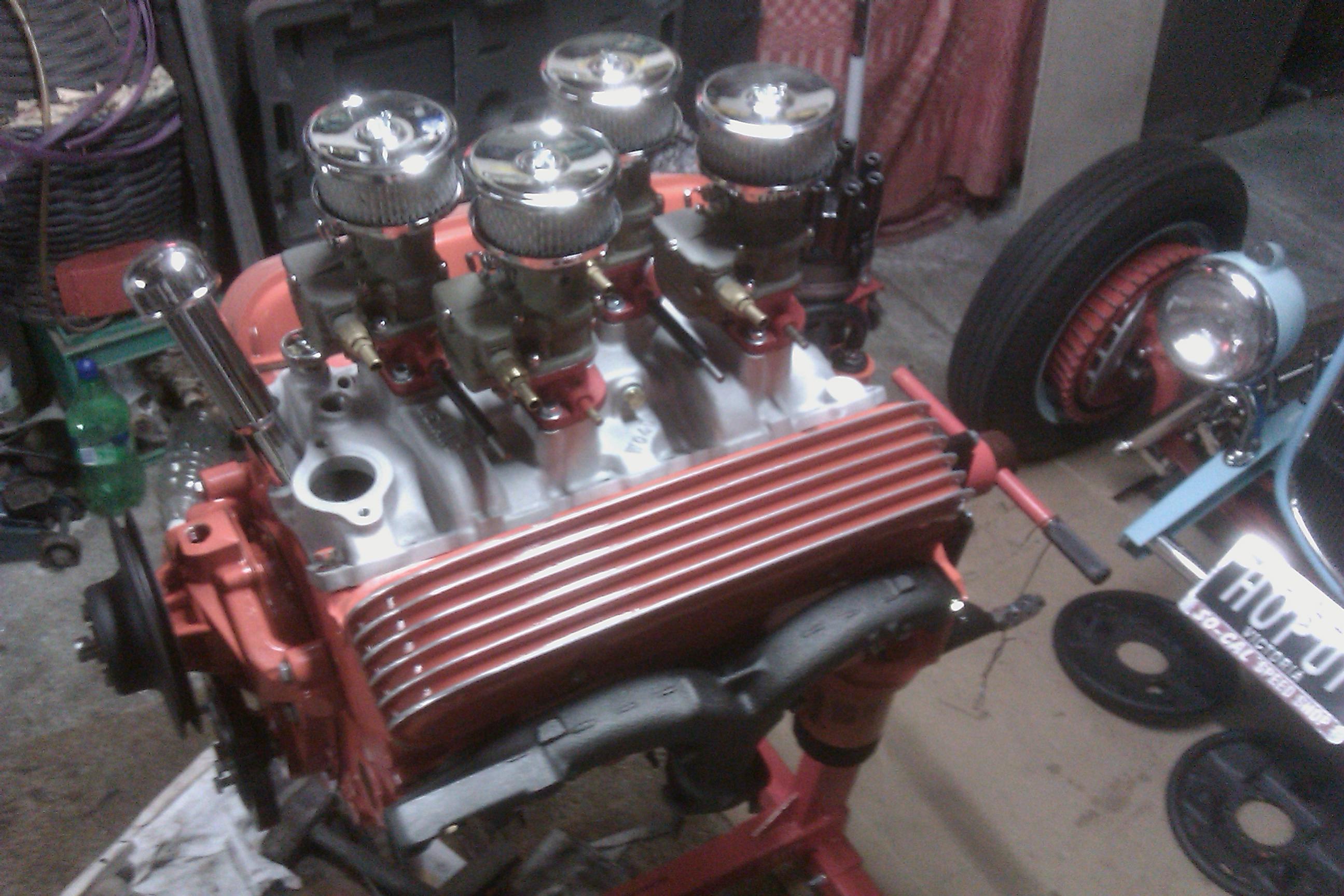

  30. I love 283s and can't wait to fire mine.
    Been modded like this for good street performance/efficiency:
    283 +.040
    balanced
    9.8:1 CR
    bowl ported 305HO heads, thin steel shim head gaskets
    Cal Custom finned valve covers
    Cal Custom finned alum oil pan
    hyd stick 210/216@.050 with .450/.475" lift
    1.6 rollers
    modded 57 chevy cast iron dist with elec ign guts
    port matched Weaind WC4D intake with 4 fresh 97s
    ported Corvette rams horns
    twin 2.25" mandrel bent exhaust
    Rat
