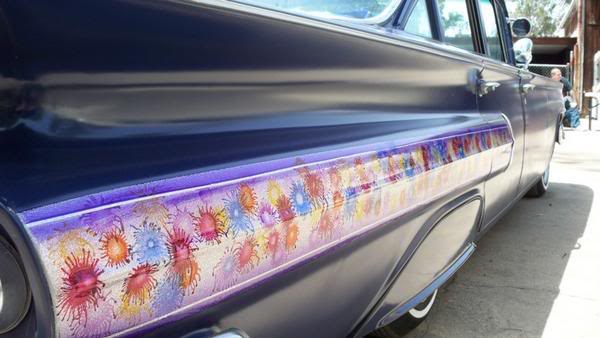

    Don't know if you can see it very clearly, but the fenders and exposed frame area on my sedan were painted candy gold with black cob-webbing. This would have been early 70's.
    Mick
  23. I did them in the 70s they were known as freak eyes where I come from. I would just adjust the gun pattern to a circle thin the candy paint pinch the air hose make the spot and then unpinch the hose and give it a 40 lb blast of air. After putting about 200 on a van you got pretty darn good at it .... I also had a 69 camaro with candy bubbles in the ss stripes another trick you dont see anymore. I can still do all that old paint stuff fish scales etc. Im just waiting for the right project or a customer with cash to come along!!

    Freak Drops.
    (pic is from the "Wild Paint" thread...i believe)
    There is another painting technique where you use water drops and it can sometimes give the "spin art" effect but mostly looks like that "motor oil on water" type effect without the rainbow-edness.
