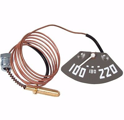

    Is there any conversion from the vapor bulb temp gauges to electrical or a new vapor? On my 50' Buick i was thinking of hacking up one of the after market chevy/GM kits and seeing if i could make it work in my gauge, but before I drop 100 bucks on a hope and dream, I was wondering if anyone had done anything like this? I am pretty set on making my factory gauges work.
    Was thinking I can take the faceplate off one of these and stick it behind my original faceplate and see if I can swap needles. Thoughts? there's probable an easier way, but nothing I can find online s-l400.jpg

    Are the scales of the old and new gauges the same? Both 100 to 220?
  3. OZCAST
    Joined: Oct 12, 2020
    Posts: 279
    OZCAST
    No idea. The factory gauge just says hot/cold and the shop manual only states hot/cold as option

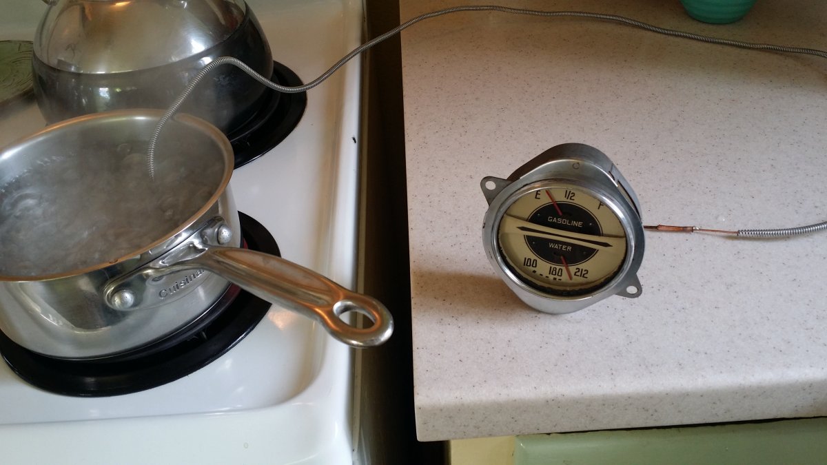

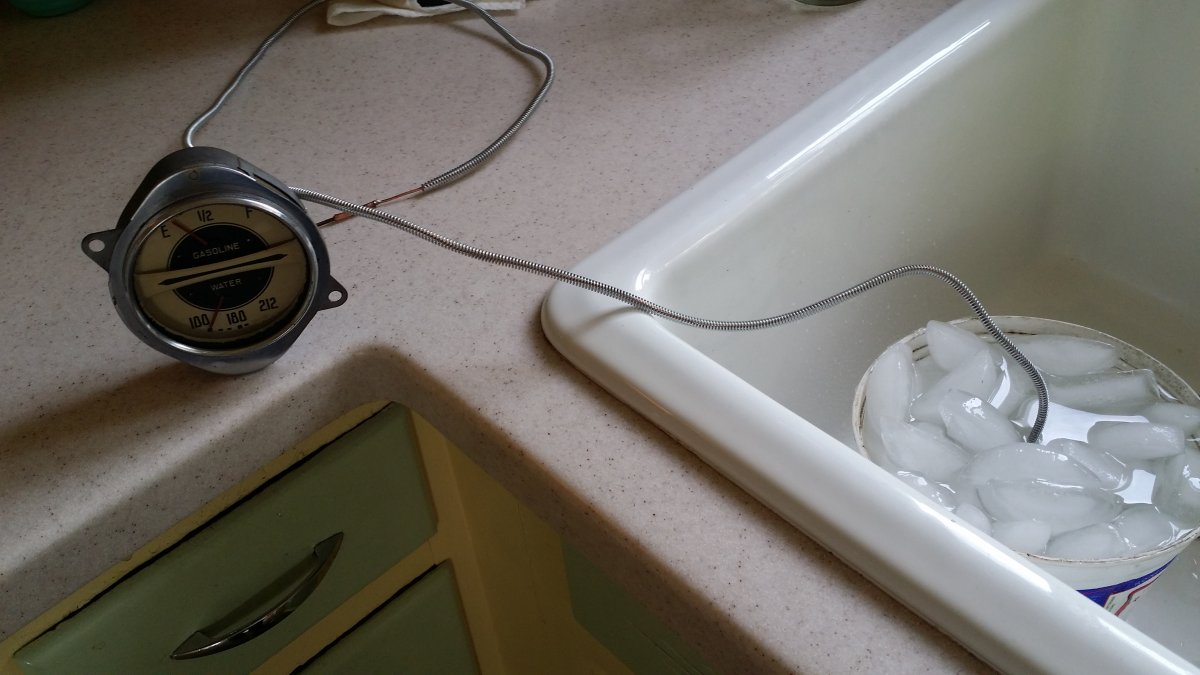

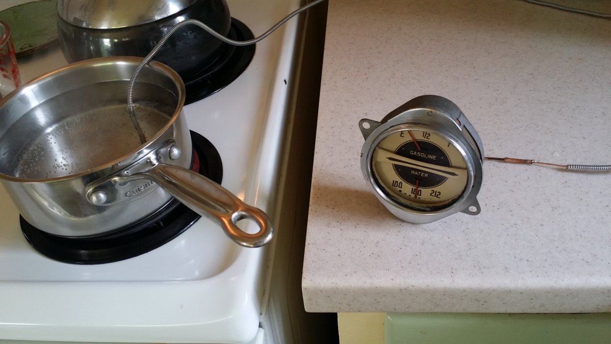

    I used the same process successfully as in the link.
    Not mentioned in the thread is what alchemy asked,
    I found and used a donor with similar sweep and range
