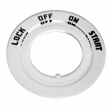

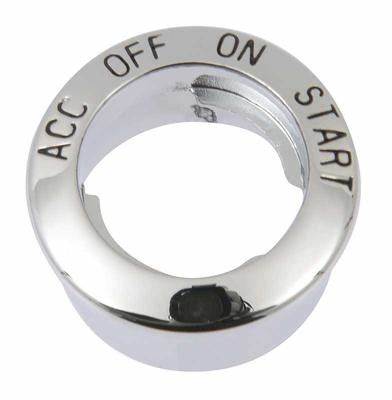

  12. Onemansjunk
    Joined: Nov 30, 2008
    Posts: 606
    Onemansjunk
    from Modesto,CA
    49F5AFFA-C8EE-41D3-98BE-10A3A7128BC2.jpeg 31CF1DB8-01D2-4B07-A751-45B0F3730118.jpeg So was the radio always HOT on the old 53 Chevy. Or you just turned it turned the switch to ON, and fry the points? Or accidentally leave the radio on? Ford bezel- Chevy bezel.
  13. squirrel
    Joined: Sep 23, 2004
    Posts: 60,346
    squirrel
    There were a lot of Chevys built that did not have the ACC position.

  15. tubman
    Joined: May 16, 2007
    Posts: 8,364
    tubman
    IIRC, every older GM car I have ever seen that did not have an "ACC" position also had the radio "hot". Things were pretty simple. If you didn't want to play it, turn it "off". Turn it "on" if you wanted to play it. I think that back then, people were expected to be a little more responsible than they are these days.
