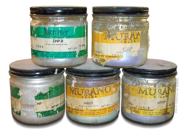

    Back in the 60's-70's (and beyond), before the metallic pearls came out there was a product that came in a squat jar that was a paste. I would mix it with lacquer clear and spray it over black to simulate chrome bumpers/trim on the funny cars back then. It was pretty darn close to real chrome in appearance. So close that occasionally some one would ask 'how did you do that?'
    Does anyone remember this product, the correct name, and where it came from?

    K13
    Murano Pearls? Not sure about the looking like chrome part though.

    jivin jer
    K13 you got it, thanks.

  8. lippy
    Joined: Sep 27, 2006
    Posts: 6,856
    lippy
    from Ks
    You would have to mix the old paste pretty strong to even get close to simulating anything like chrome. I remember using white mother of pearl and blue murano for bumper hi-lights on silver and for fake side trim. Long ago in a faraway land. Lippy

  13. rod1
    Joined: Jan 18, 2009
    Posts: 1,565
    rod1
    The concentrated Murano pearls were just that, Concentrated! We would stir up the jar very well, and then just put what was on the stick into the quart of clear, not the paint. Wouldn't yellow, or haze that way, Shortened version. Good times.
