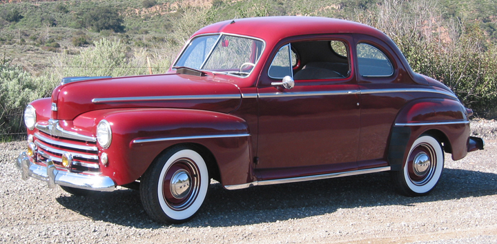

  24. Dane
    Joined: May 6, 2010
    Posts: 1,351
    Dane
    from Soquel, CA
    A 47 with Wheel Smith 15x8 wheels and Sportsman 255/60/15 radial tires

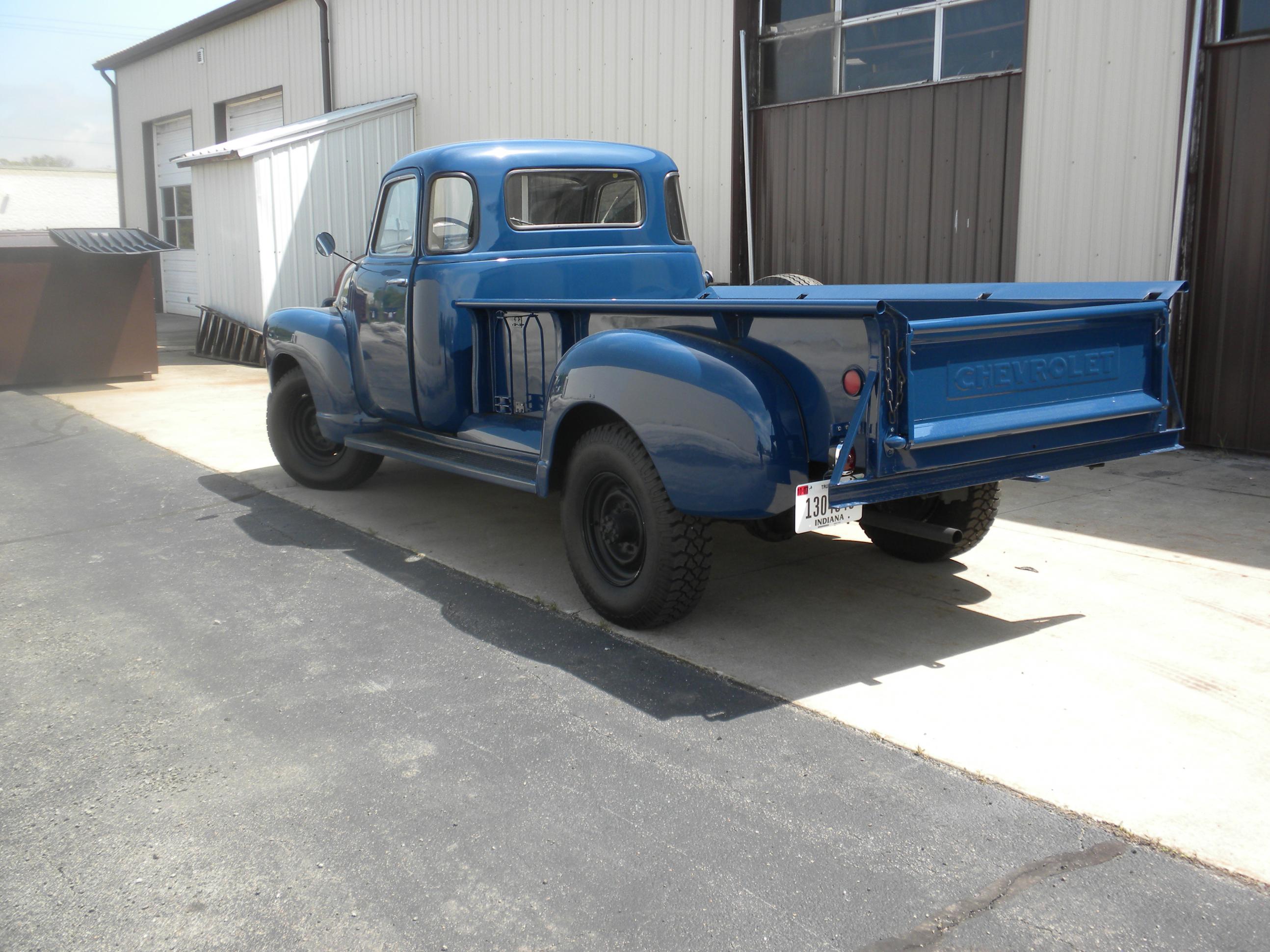

  28. bobwop
    Joined: Jan 13, 2008
    Posts: 6,131
    bobwop
    from Arley, AL
    this 50 Chevy came in on 15's. It just had too much gear to allow for highway speeds, plus, I didn't like the look. What do you think?
