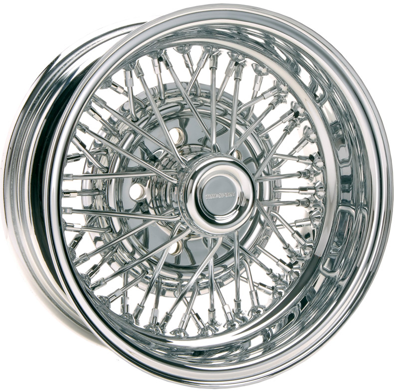

    Appliance... HRP

    Ya they are Appliance. I hate to be as negative as I sounded earlier about the lug system, but it does ****. The eccentric pieces can take the wheels from 4 1/2" pattern to 5" pattern just by turning them. The problem is setting them up so the wheel runs concentric. Tru-Spokes at least as far as hot rods were concerned out sold Appliance I'd have to guess about two to one back in the seventies mostly BECAUSE of the uni lug system. Someone was working on a method of replacing this system here on the H.A.M.B. a couple of years ago, but I honestly can't remember who it was.

    Thanks for the responses. After looking at the photos I can see that they definitely are Appliance wheels.
