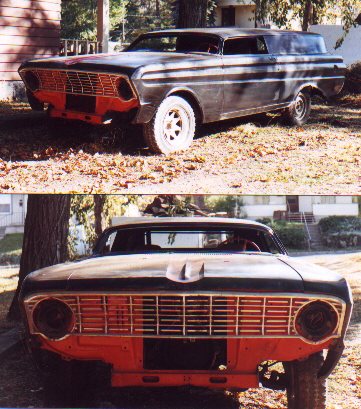

  9. Thanks Fat Hack, I was hopein you'd chime in. And thanks to everyone else, not just this post, but every time I ask for info I get it. I'v posted this before, but this is the car that it will go in, if I can put the deal together.

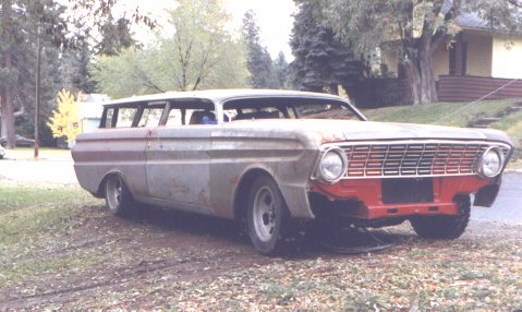

  11. One more, god I'd love to get back on this car!
  12. It's a 45 k orig car. 4 bbl motor. Be a shame to part it out [​IMG]
