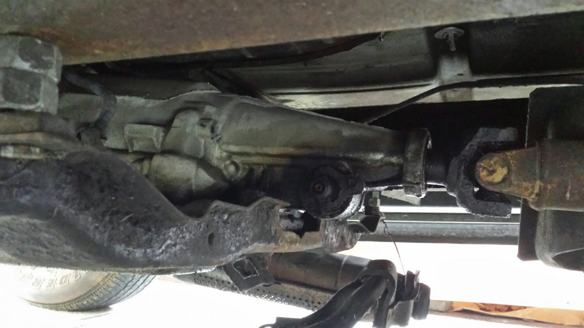

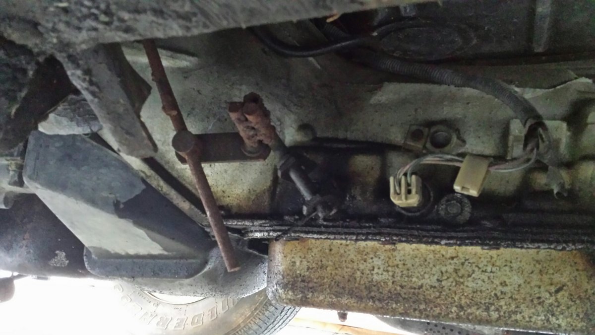

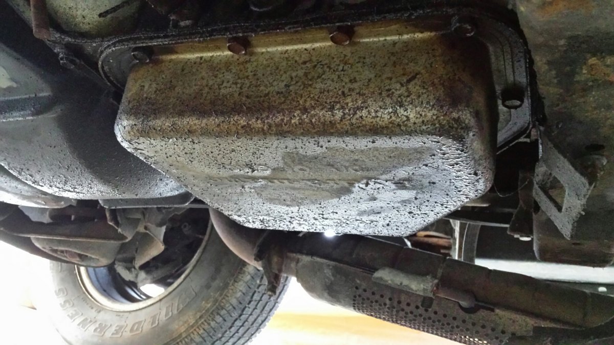

    Here are some pics of the trans (can't get the pic of the mine field that is the engine bay to load)... I have the feeling that the sooner I find an sbc/****** combo, the better :D

    That transmission looks like a 200.

    yeah, it's a 200. Haven't worked one of those for 30 years.
    no vacuum modulator on that one, it uses a TV cable to determine shift points.

    I would really check that shady linkage out. Like Rusty said. Disconnect it underneath and see if you're getting full range.

    Interesting "spacers" for the transmission cross-member, and the shift linkage is a bit dicey. Looks like the PO sold you his unfinished/poorly thought out project (sorry). Wipe the transmission pan off, it should say exactly what it is, a Metric TH200 transmission. It's a light duty transmission, but the Stock and Super Stock racers have been using them for a few years now; better gearing than a TH350, and lighter. I am Butch/56sedandelivery.

    I took the linkage off at the shifting lever/yoke... easy to do, because it was held on by an unbent finish nail. The PO modified the linkage by cutting and welded the two lengths of rod together with two tack welds. The upper tack weld was broken, which explained why I couldn't feel any detents after neutral- the linkage would bend after I got to neutral. Yeehaw.
    The rooster comb is good, and I could feel all of the detents by manually turning the lever/yoke, but it feels like I have P/R/N/D/L1/L2, so it may not be a 2 speed after all... like I said, transmissions are not my forte'.
