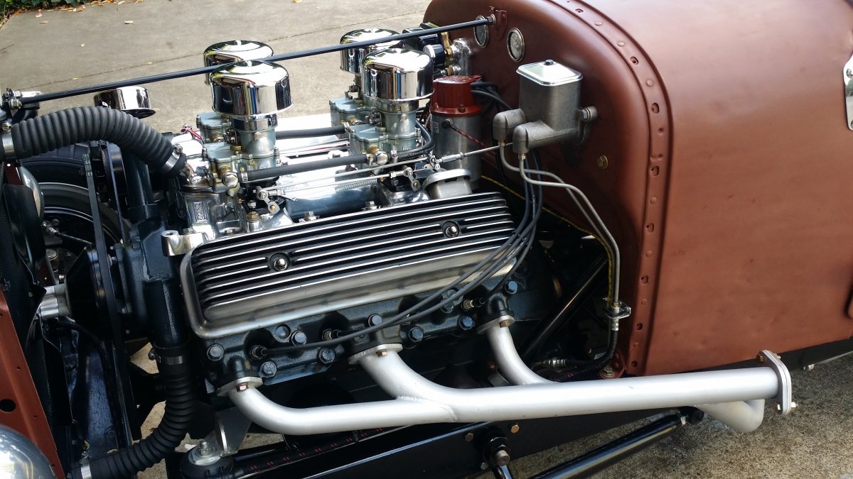

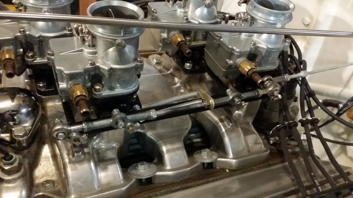

    I did this Edelbrock 4x2 with 97s setup on a 371 Olds
    running the linkage to work all carbs in sync.
    went a few steps fatter on the power valve and a few smaller on the mains..
    works like it should, idles nice, part throttle to wide open smooth and strong.
    I can dig though my notes if it would help.
    Moriarity and cactus1 like this.
