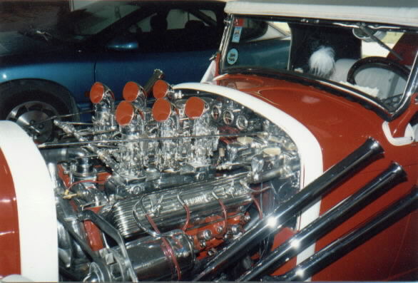

    I am goin to rebuilt my 1956 olds 324 engine next month and have some more performance out of it, Does any one have a suggestion which cam I should use? I have 6 Holley 94 on top(2 working ones at the moment, but want to have them working all 6)
    The engine is pretty standard now, I think. Also what pistons?

    That log manifold yer runnin' is a clue - if you plan on takin' it full house, then you'd normally pick a long duration/high lift cam. This pick will go like stink down the quarter-mile, but won't run worth spit on the street. You'll load up plugs faster than pete can slide the cheese off his cracker.

    The problem you'll encounter is the cam has to be matched (somewhat) to the intake. With a rumpy cam, you'll be hard pressed to make enough vacuum to properly meter a 6 X 2 setup. that's not to say it can't be done (assuming you go progressive on the outboard carbs) - it's just a lot of work.

    greetz
