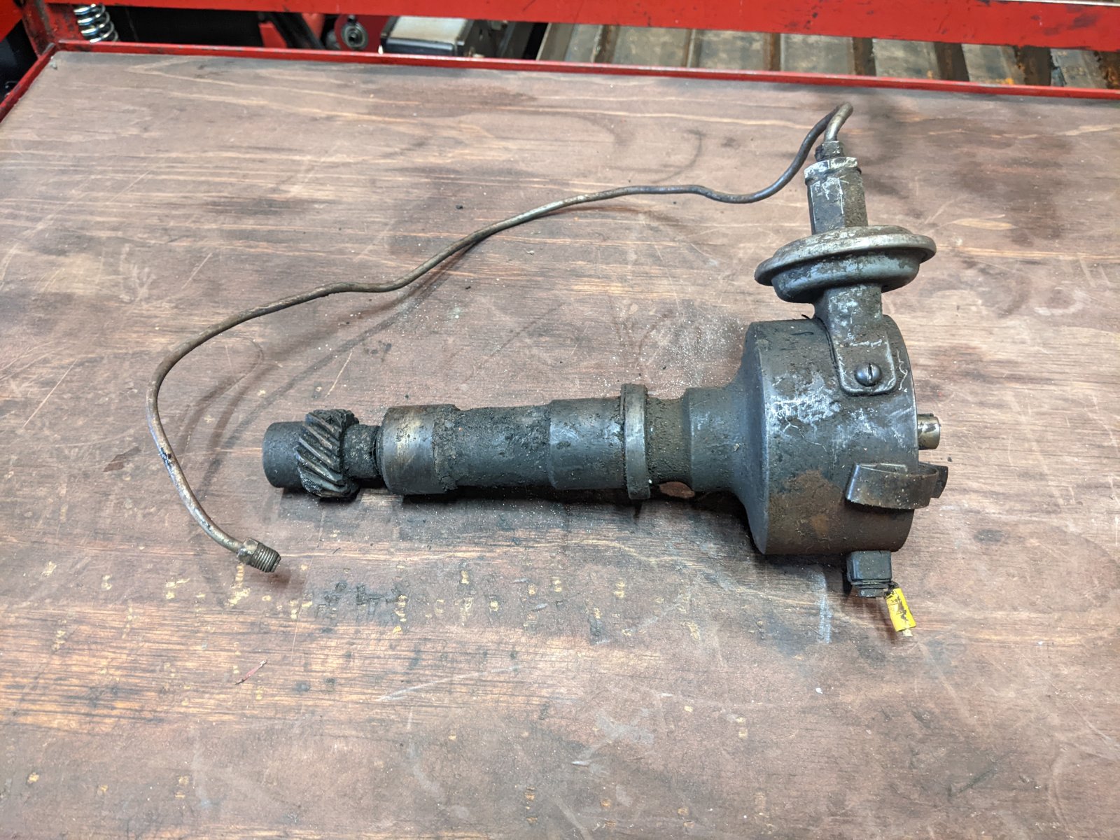

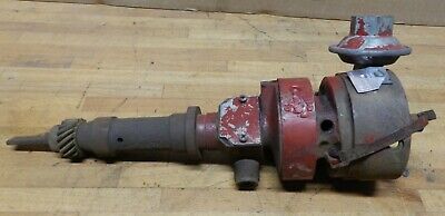

    the '74-'75 IH 266, 304, 345 tach drive distributor

    the 303-324 Oldsmobile distributor

    Right off the bat it looks like the distributor shaft would need to be shortened. It also looks as if the IH distributor will be significantly taller than the OEM distributor- I would consider available firewall clearance.
    If I was hell bent on doing this, I would buy one (***uming that they aren’t extremely valuable to IH guys) and turn a pair of calipers loose on it to see what else it might need, ***uming it’s even feasible in the first place.

    you can also see the gear is cut to turn the shaft the opposite direction.

    Good catch. Does anyone actually reproduce the D shaft distributor drive gears for early olds?
    Is it an optical illusion, or is the housing on the IH distributor canted forward?
