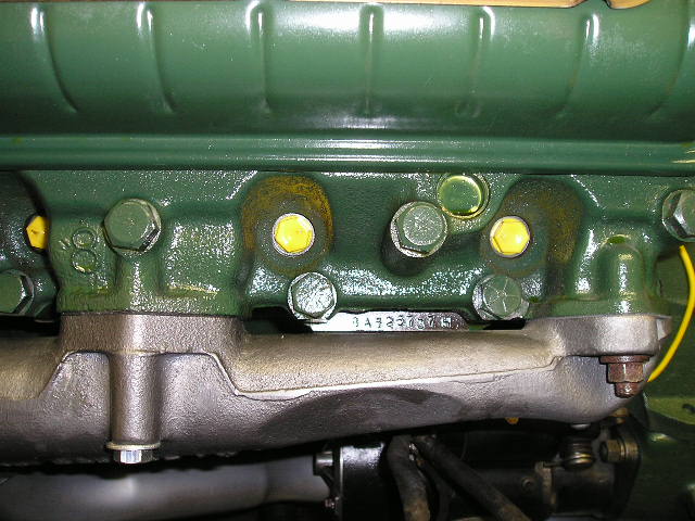

    Look for the number on the heads that will give you a hint to its year. There is a tab below the head that has the serial number if you can retrieve it. #8 head and number in pic below for reference. Take pics and post them up when you get back

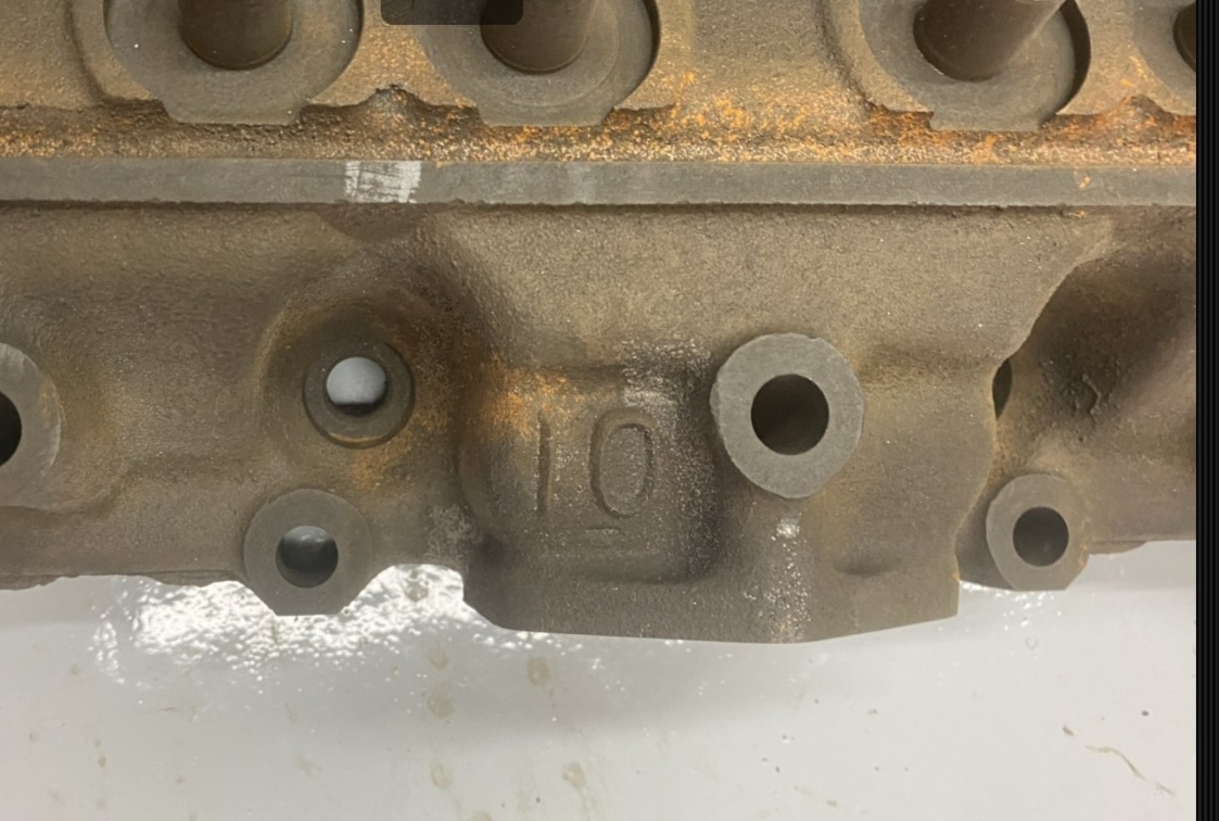

    The 1956 heads have a number 10 cast into them by the exhaust port. Those heads are widely regarded as having the larger ports and possibly bigger valves..

    Where exactly would the "10" be cast?

    Right over the center exhaust port..

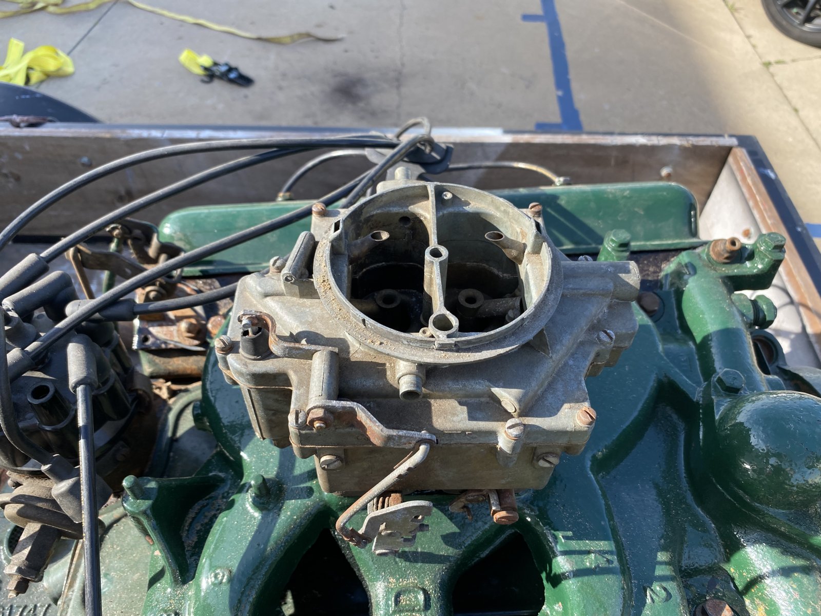

    Looked at you engine a little more closely. Looks to have #3 heads which are 1953...if the heads are original to the block it might be a 303.

    I saw that chart too..but notice that the R stamping starts at R215001 to R549482. 1953 was the only year the prefix started with R..but the OPs motor is stamped R180766. So maybe that chart isn't right?

    Small base carb intake gives it away too. It’s mounted backwards and a lot of pieces are missing. If was complete its value has been steadily going up over the years.
