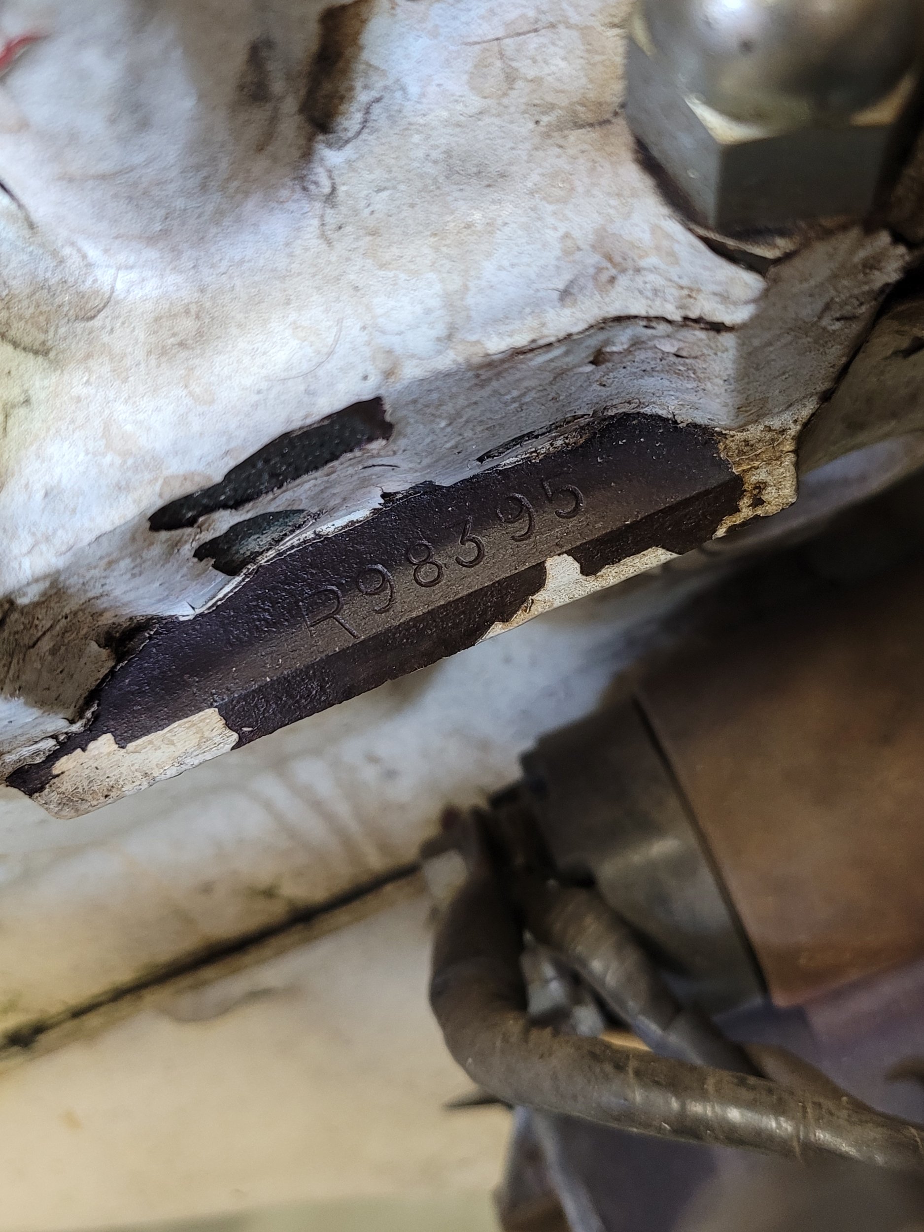

    So my 1953. 303 has a number like this one... Havent heard anyone say different but maybe its CANADIAN??? I KNOW my car was built in 56 from a wrecked 53 olds... maybe thats the canada serial numbers... 20250228_132227.jpg

    my notes say
    '52 is R1001 and up
    '53 is R215001 and up
    just speculation but if there were late '52 engines in line while early '53 cars were going together it would make sense that yours was original to a '53.
    sometime during the '53 run the hydramatic factory burned down and some Olds engines were given dynaflows.
    saltracer219 likes this.

    ..THANK YOU Paul!!! I do have the 561747 block....AND IT does have #3 heads.... I got info from the cl***ic olds forum ( mine does not have 8R PREFIX) so maybe they dont have it all correct...Believe me the corvette stuff has drove me crazy 45 years...
