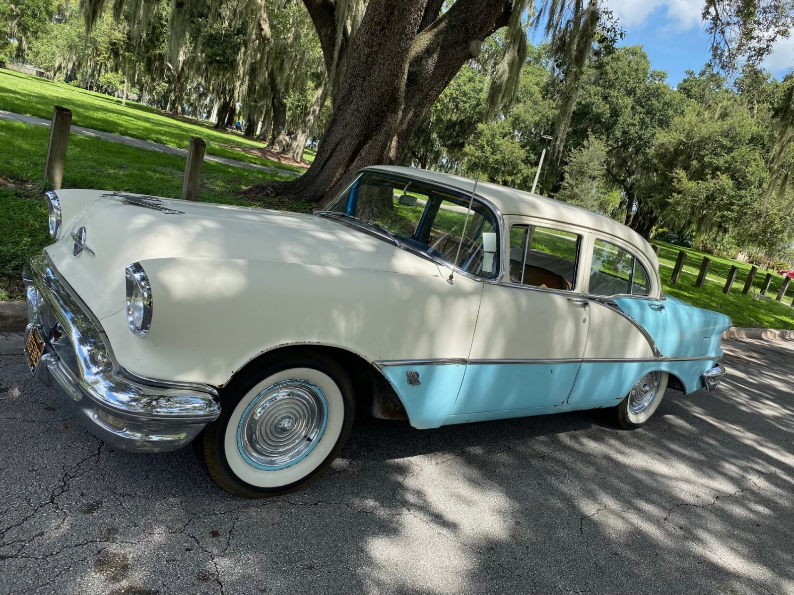

    Yes, like so many others, got several irons in the fire right now.

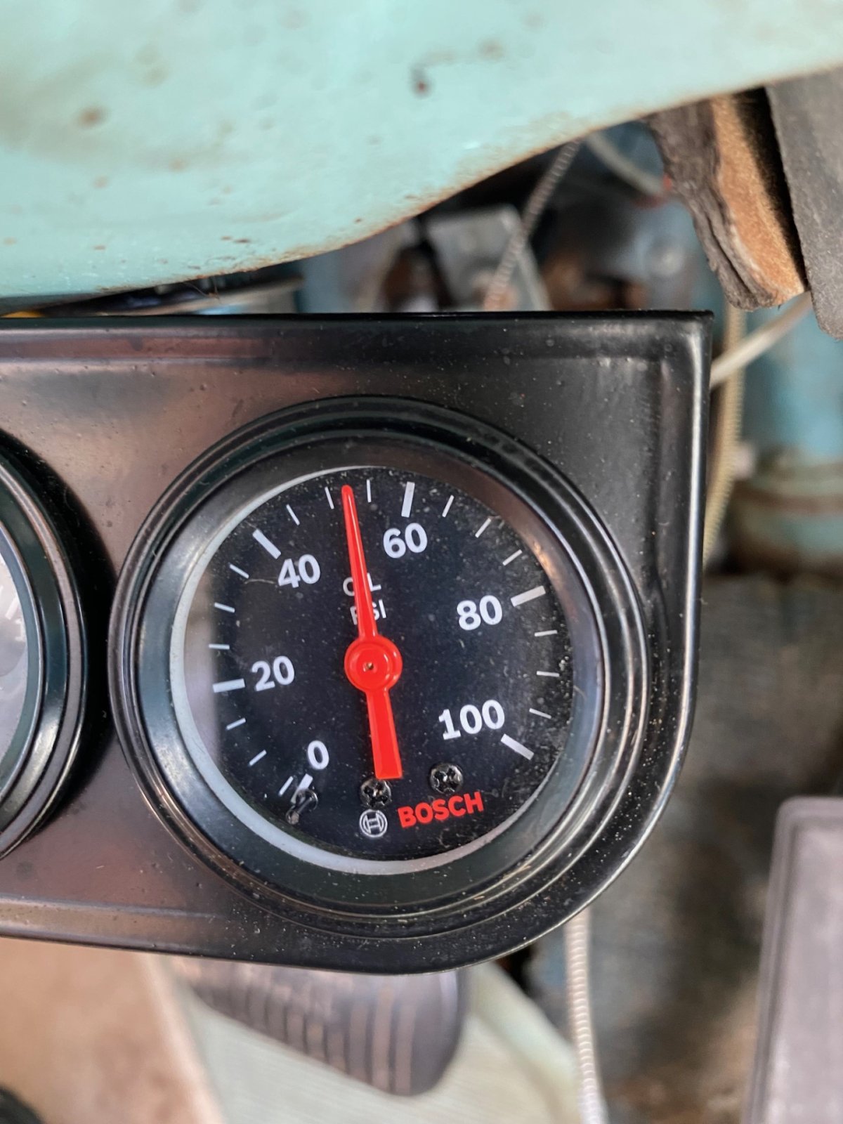

    Long story short, been fighting with overheating and low vacuum on this rebuilt Olds 350 almost since day one. Traded this engine for a motorcycle, early last year. Yes I've looked at ALL the obvious stuff. I'm a master auto tech for a living, but this one has me really scratching my head.
    Facts!
    Rebuilt 1973 Olds 350 Cutl*** engine TH350 Trans
    Properly broken in by me
    Good oil pressure
    Good compression and leak-down results. (no bubbles in radiator)
    OEM style radiator tested by reputable local shop (15" electric fan running all the time)
    (Cannot use stock mechanical fan, because of close fit.)
    New "Hi-Performance" water pump
    goes to 200 degrees and beyond, within about 15 minutes of running.
    Barely achieves 15inhg of manifold vacuum.
    Engine cranks right up and actually drives decent.
    So... The question is, can retarded cam timing be causing the low vacuum and overheating??
    Dammit Man, already not happy removing intake to inspect a motor that was supposed to be ready to go. (I'm done talking with the guy I got it from. He didn't do the work and is almost clueless. Machine shop is out of business too!!) He claims the cam timing was checked by the builder.
    Bought this car to fix and flip and so far, it's been nothing but a headache. Honestly would have been better off going late model LS route, even though it's not old school.
    Help!!
