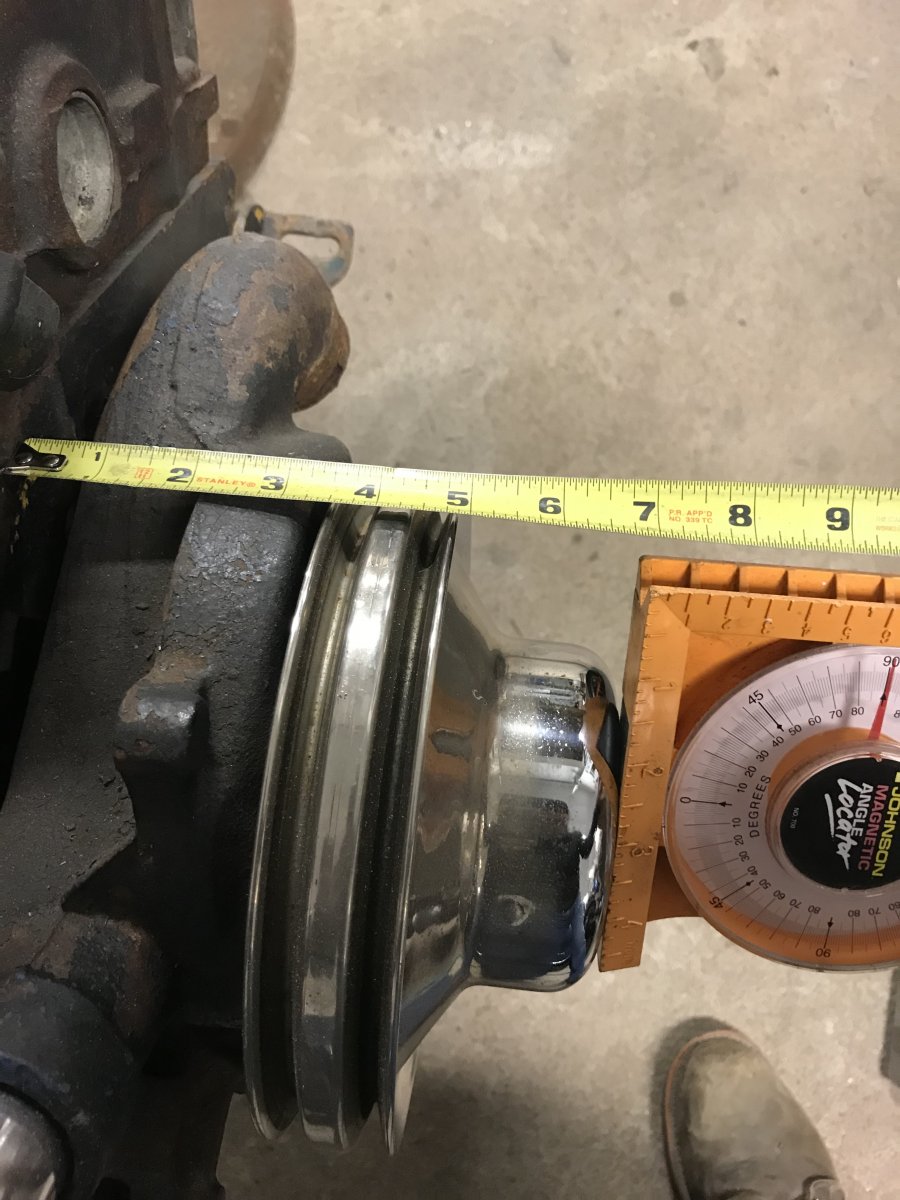

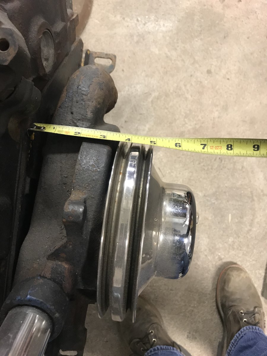

  13. Looks the same (or darn close) as the 303 in the BB. FF26C7C9-6A06-43E6-919A-7020D59B2D1E.jpeg

  15. raven
    Joined: Aug 19, 2002
    Posts: 4,707
    raven
    Man, thanks a lot cactus!!!
    That’s exactly what I was looking for!
    r
