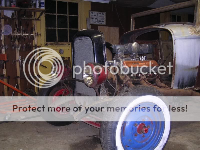

    Holy smokes, the ch***is looks slick... and I would have a hard time deciding which motor to use...nothing brings back the old days than the SBC 2x4 with finned Corvette covers.
    I like the wheel color too.

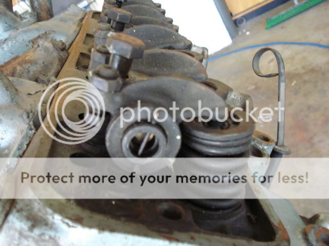

    Read my post above; Both ratios were made by various companies and both ratios were used by dragracers to dail in the cam. They both said camgrinders would do different profiles to use either ratio. That's according to two different old time Olds racers I have talked to. They both also preferred the steel vs. Magnesium..something about flex with big springs and hi rpm. So, yes, you can't expect a modified late 303 or 324 to still have 1.8s in every case.
    I have 2 different brands of 1.5s here, both steel. I sold my 1.8 because my cam was within .007 (lift at valve) of the MAX useable lift of a stock 324 piston/uncut head if I used the 1.8. Plus I figure that the 1.5 must be less stress on the lobes....and I'm not racing those gas Willys :)
    Put up a pic looking straight down of the rocker shaft with at least one stand showing.

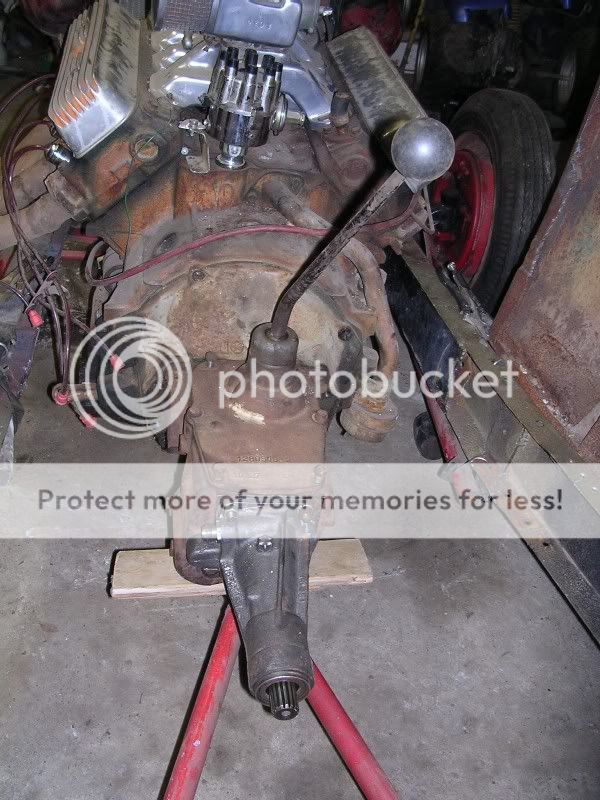

    More Olds...Not Mine.. Just sharing info for other viewers swapping stuff around on Olds. I think the owner said it was a 56 324 with early 371 heads. I am pretty sure the heads were #16. He made 1/4" thick aluminum spacers under the intake to make the 303 Edmunds fit the bigger ports on the 324/371 size heads. It just allows you to use 303 gaskets on top side of the plate, and 324 gaskets on the underside of the plate.
    Firewall is tight because he is hooked to the flathead driveline.
    Here is the mis match of a 303 Edmunds on a early 324...and shows why you need a plate with both sizes of gaskets. The angles of head and intake match fine but the head port is too tall.
    Here's my mockup: a complete 55 324 stick driveline from a sideswiped-when-new(er) 41,000 mile virgin. I just did the Olds trans gear swap into the top shift 37 Buick trans case. Boy, that trans feels sweet shifting. My friends can't keep their hands off my stick :eek: i wanted a hydro but this setup was too good to p*** on.

    Aftermarket adjustable rocker arms were made in both ratio choices; to further complicate matters, some companies made 1.5:1 adjustable rockers that were intended to be used with the '52-'58 1.8 style rocker stands. I've never seen Iskenderian rockers for early Olds engines that were anything but 1.5:1.

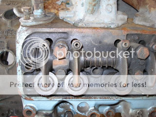

    ****py picture of stock 1.5 and 1.8 stands and rockers. the stand and rocker to the left are the 1.8.
    I'm running #8 heads with the 1.8 rockers on a bored 303 with a reground '50 cam. Hopefully it will work.

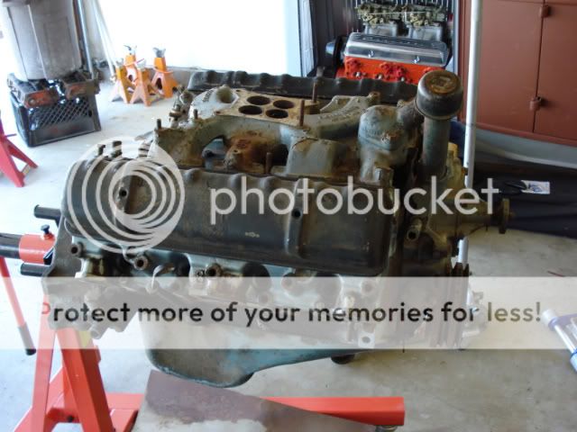

  26. ocfab
    Joined: Dec 26, 2007
    Posts: 678
    ocfab

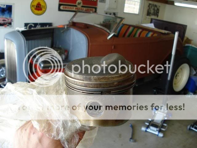

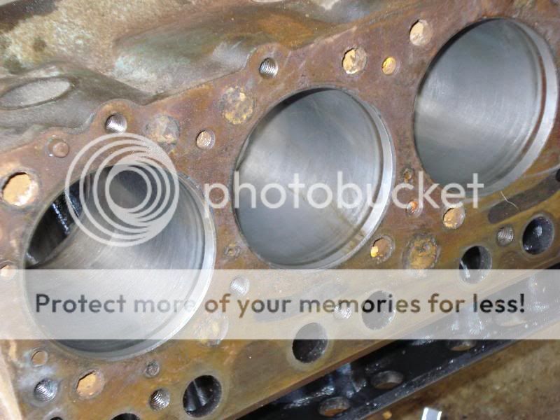

    ok i pulled the324 apart and it has a engal 134 cam popup pistons and i think it is a keeper crank looks nice also it has been punched out to a 4" bore
    here are some pics
  27. Paul
    Joined: Aug 29, 2002
    Posts: 17,010
    Paul
    Editor
    compression is probably a mile high,
    but if it all looks that good, I'd be tempted to clean it all up and bolt it back together
    nice score
  28. F&J
    Joined: Apr 5, 2007
    Posts: 13,291
    F&J
    I think that's good advice because it looks like it was definately a street driven motor. It survived a lot of miles by the looks of the buildup of stains.
    I'd look for a stock J2 intake and make it fit. They should be cheap unless they had the orig genuine J2 carbs. Run painted valve covers with the repro J2 decals and it will look slick. Tripower is a good choice vs 6x2, 2x4, 4x2 as far as set-up and reliability.
    Those rocker stands are 1.8 and the rockers seem to line up, so I would think the rockers are 1.8. It all ran as it was in the past, so don't mess with switching things...yet..

    the bearings look good i will mesure everything and if all looks good maybe just do valvejob and new rings how high do you think the compression is? and with a 4" bore does that make it a 347?
