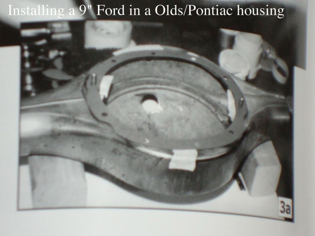

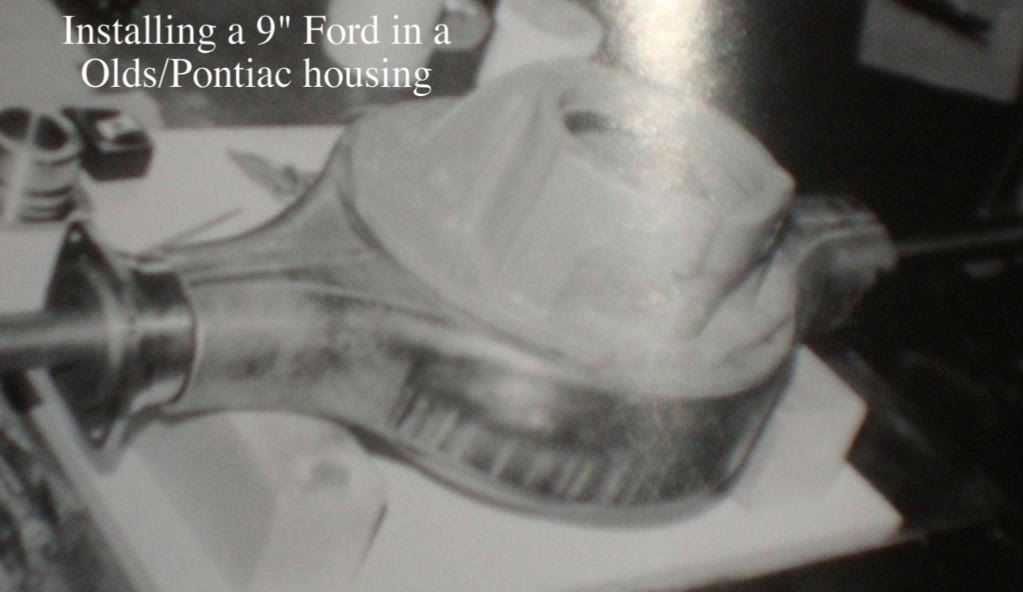

    G***er wars magazine #38 has a article about putting a 9" ford internals in a olds/pontiac housing.If anyone is interested i can scan it and post it.Here are some quick pics...
    Steve
    <HR>
    <HR>
    <HR>
    <HR>
