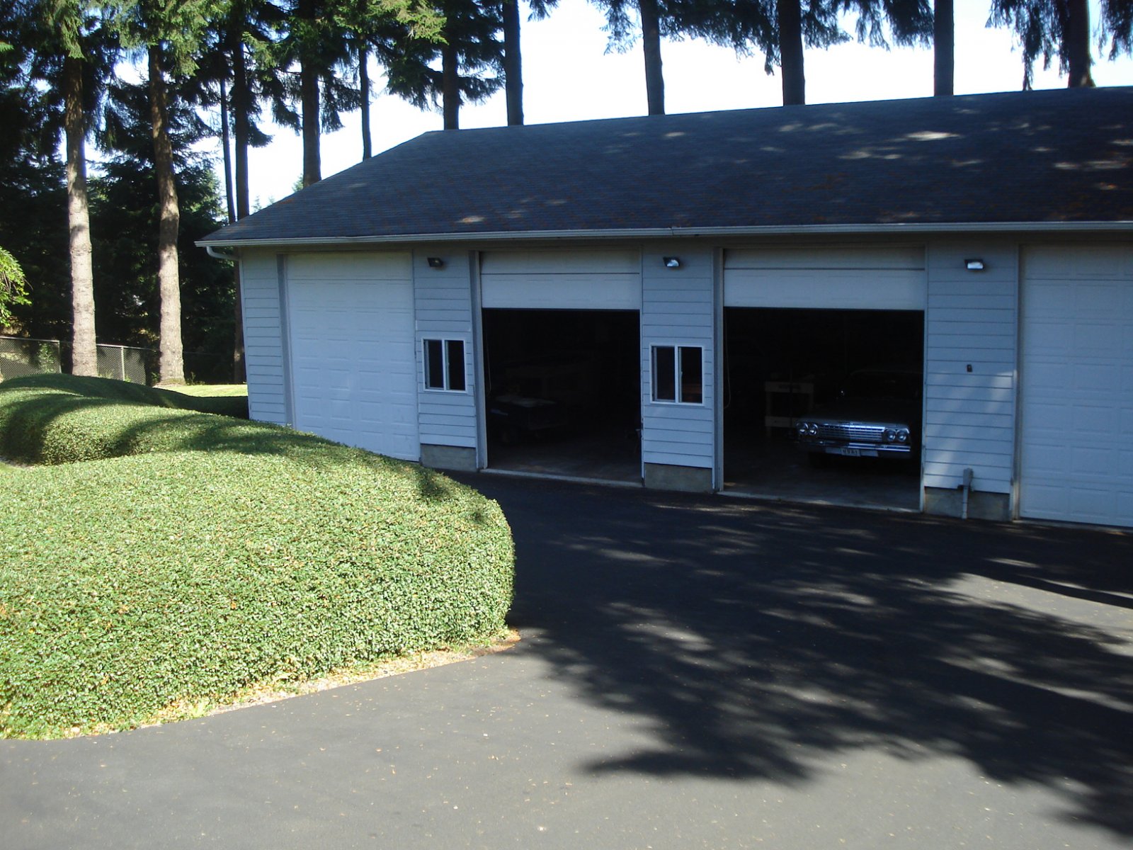

    I have an oil furnace that I have been using since 1978. I have had to do some repairs over the years, and I am lucky to have a buddy that's a heating/air conditioning guy, who gave me a unit that is a twin to mine, for parts. My shop is a total of 2700 sq ft, in three sections, with doors to close off the sections I am not working in. It's a wood building that is fairly well insulated, and on a 30 degree day, I can keep it quite cozy. Also, most of the shop has a 9-1/2 ' ceiling, except where I have a lift and my machine shop, and metal rack. That is 800 sq ft, and has a 12-1/2' ceiling. Where are you located in Wa. ?

    Thanks for getting back to me. I live a bit north of Longview, 1000ft al***ude. My shop is 2400 sq. ft. , 12ft ceilings, well insulated wood construction but I can only close off 600 sq. ft. in the winter. Currently using an old Earth Stove but at 73 years of age it has become difficult for me to wait for that old stove to get up to temperature. I was wondering how you handled things down there. I need to make a change soon. Your fab skills are way above mine so I enjoy following along on the build threads. Thanks for the information.
