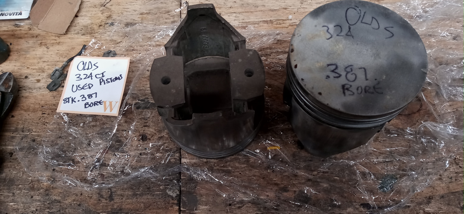

    Marty, I have 2 good used pistons in the shop. Might be a 324 or maybe 303. I will check tomorrow.
    54 blocks ran from V10001 to V355083 so Paul's notes are certainly correct.

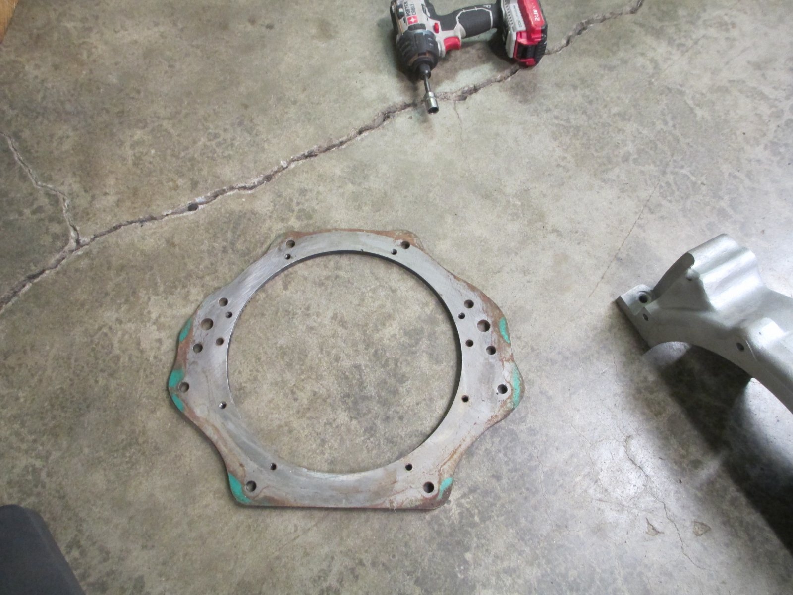

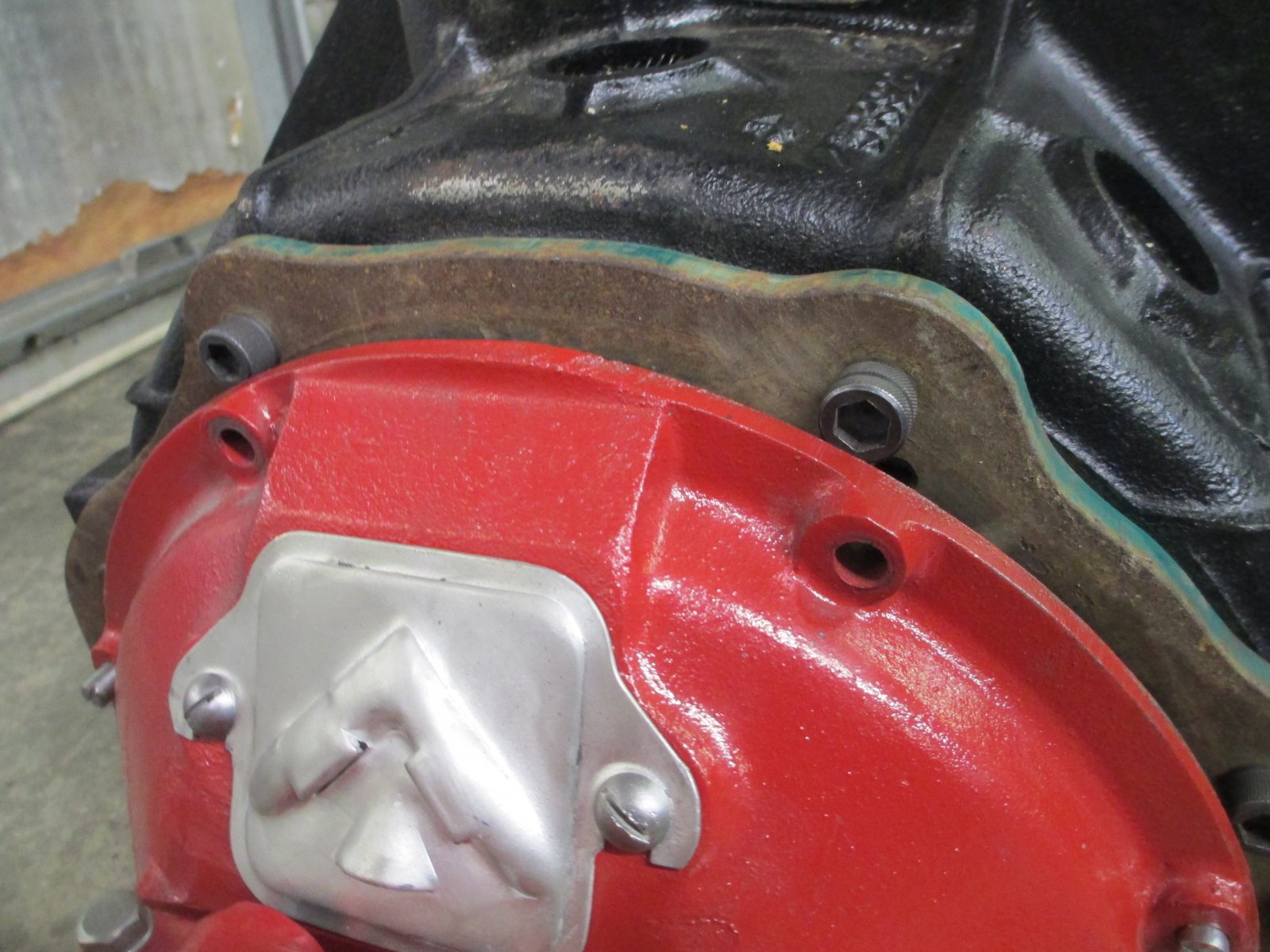

    I have at least one old Ford trans with little notches filed right where those adapter bolts go.
  4. Marty Strode
    Joined: Apr 28, 2011
    Posts: 9,707
    Marty Strode
    Ooooh, I hate to grind on Jim's beautiful trans case, but I will consult the boss !

    For now, I decided to minimally grind the trans case, and grind the heads of the Allen bolts down. I could have put them in the lathe, but since this is temporary, I stuck them in a drill, and spun them while the belt sander ran. I just had to accessorize the engine, for inspiration, while building. I have had the Edelbrock and Moon stuff since 1984, and my friend Ron Urback did the polishing 30 years ago. IMG_8265.JPG IMG_8267.JPG IMG_8268.JPG IMG_8269.JPG IMG_8270.JPG IMG_8271.JPG

  9. vtwhead
    Joined: Oct 20, 2008
    Posts: 5,307
    vtwhead
    Marty, I do have 2 decent used 324 pistons that came from my '54 build. You are welcome to them, pay the postage and they are yours if you want them.

  10. Marty Strode
    Posts: 9,707
    Marty Strode
    I sent you a PM, with address, thank you very much !!!!!!

  20. I've seen a bunch of transmissions that were notched at the bell housing to accommodate the bolts.

    @vtwhead, thanks Walt, I picked up the pistons at the Post Office today, they look great, thanks again. Now, I will get my machinist buddy to check the piston to wall clearance, and hopefully it will p*** muster. One way or the other, I will swap the mount on the trans, and get ready to set the engine in place tomorrow. I needed to form a hood for the Track Roadster thread this evening.
