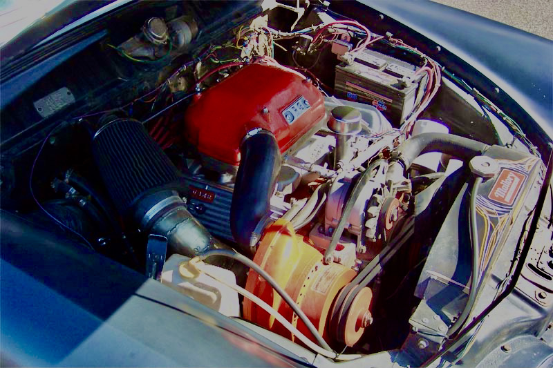

    OK Tom, you are on to me, nothing gets by you !
    Stogy, lothiandon1940 and Six Ball like this.
  2. Marty Strode
    Joined: Apr 28, 2011
    Posts: 9,689
    Marty Strode
    Alan, I sold Tom and his Son a McCulloch Blower over 20 years ago, he likes to rib me !
    Stogy, Six Ball and alanp561 like this.

    I turned my kid into a car junkie. When he was 15 Marty, John Erb, & that Mc Culloch turned him into hot rodder.:cool:

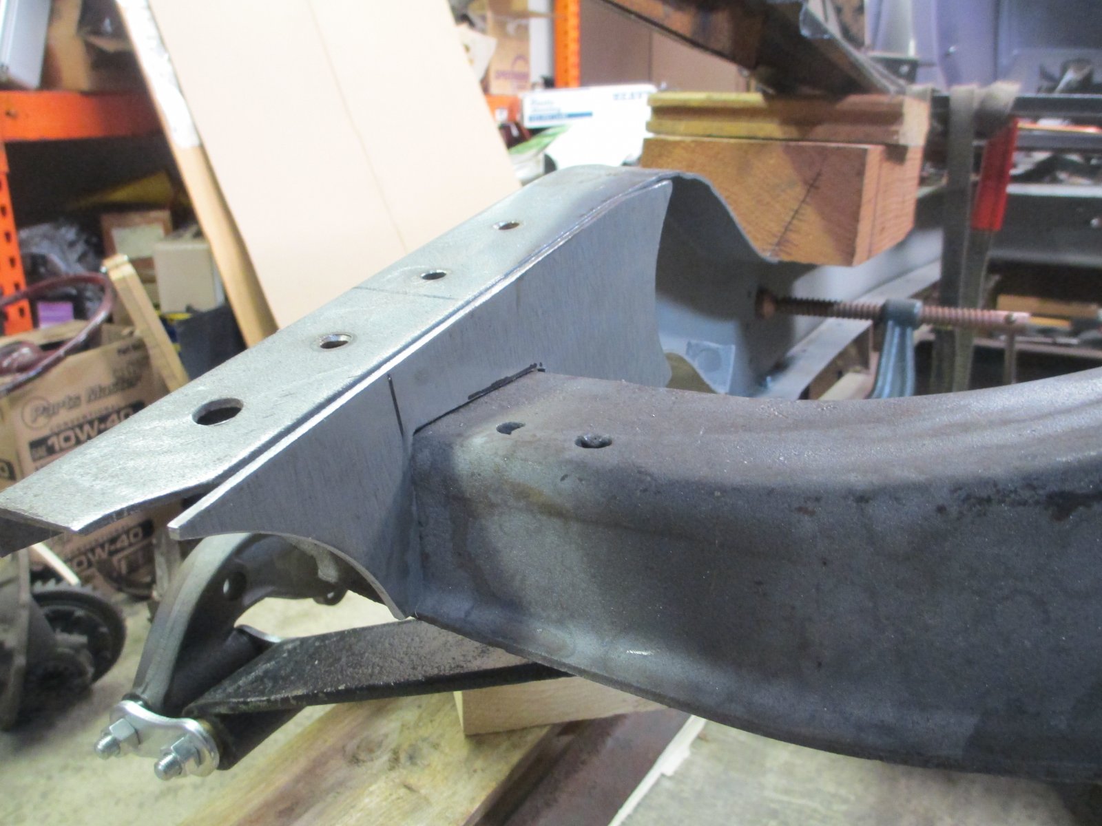

    Sorry for the sidetrack Marty, by the way, that is some fab looking welding right there!

    You know me Doug, I rolled it over, until I found the best looking stretch and took the picture.

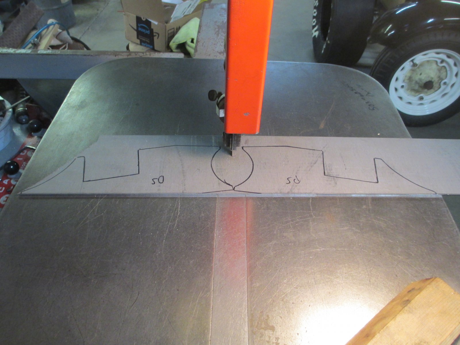

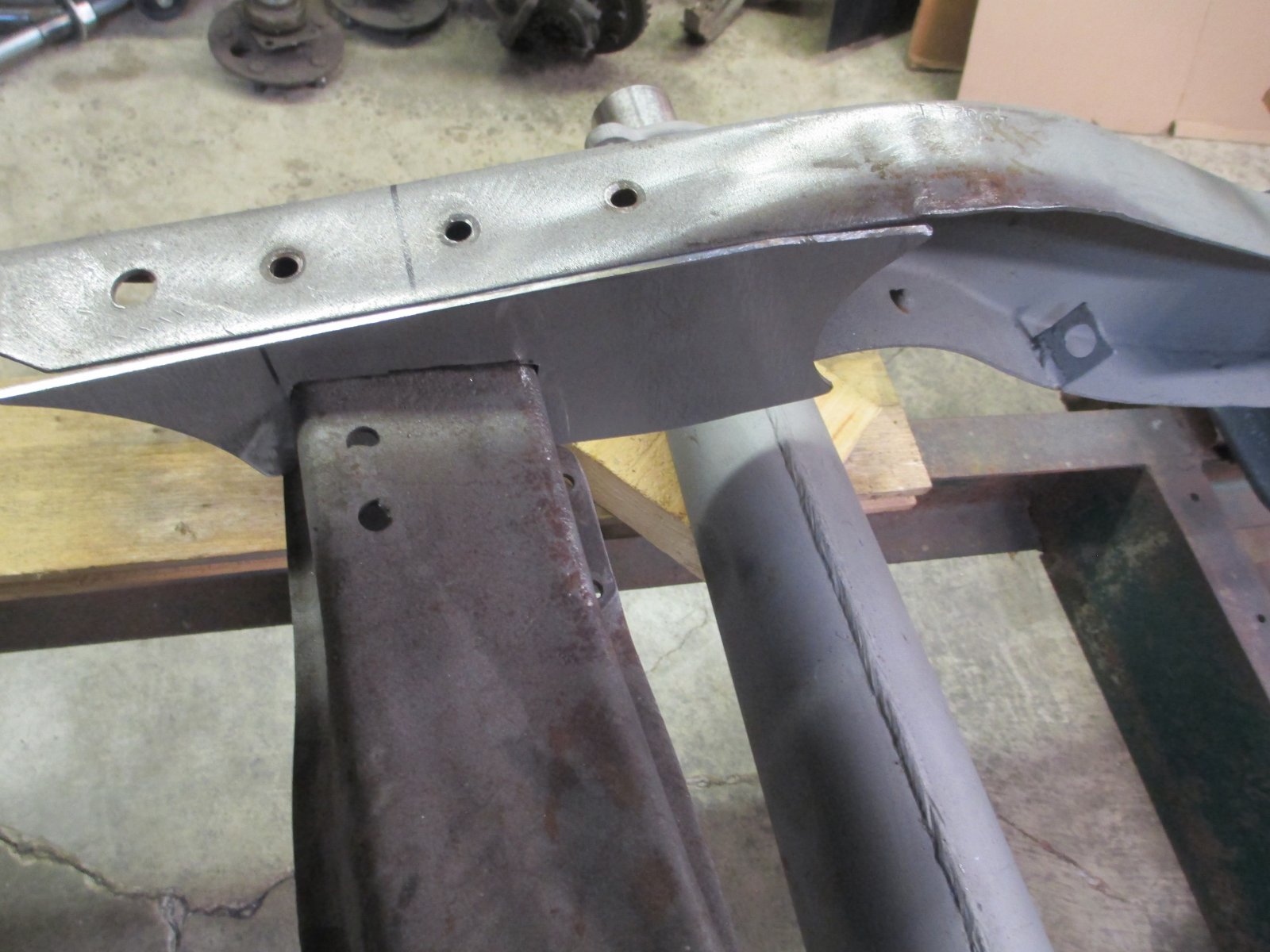

  22. Marty Strode
    Posts: 9,689
    Marty Strode

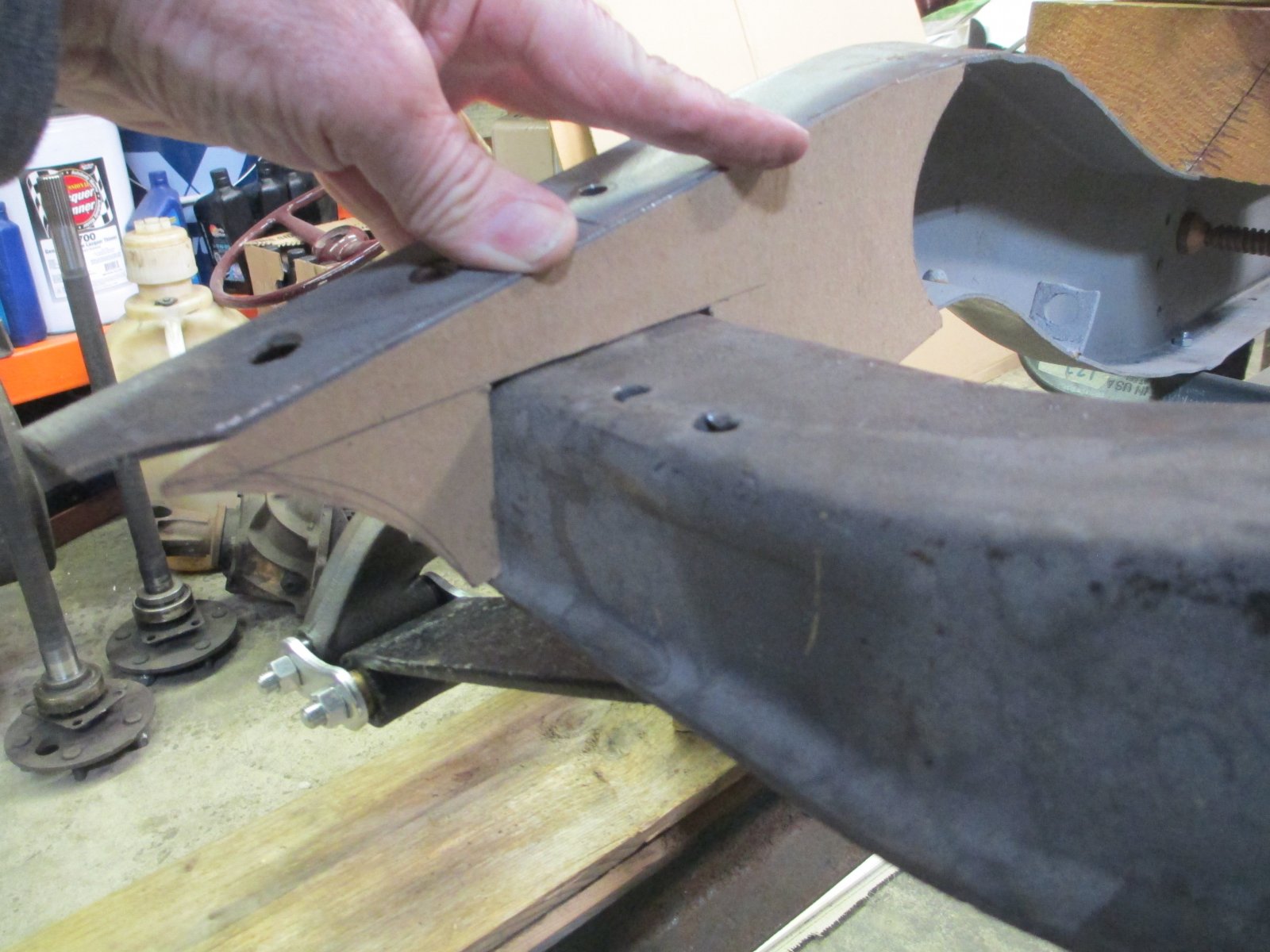

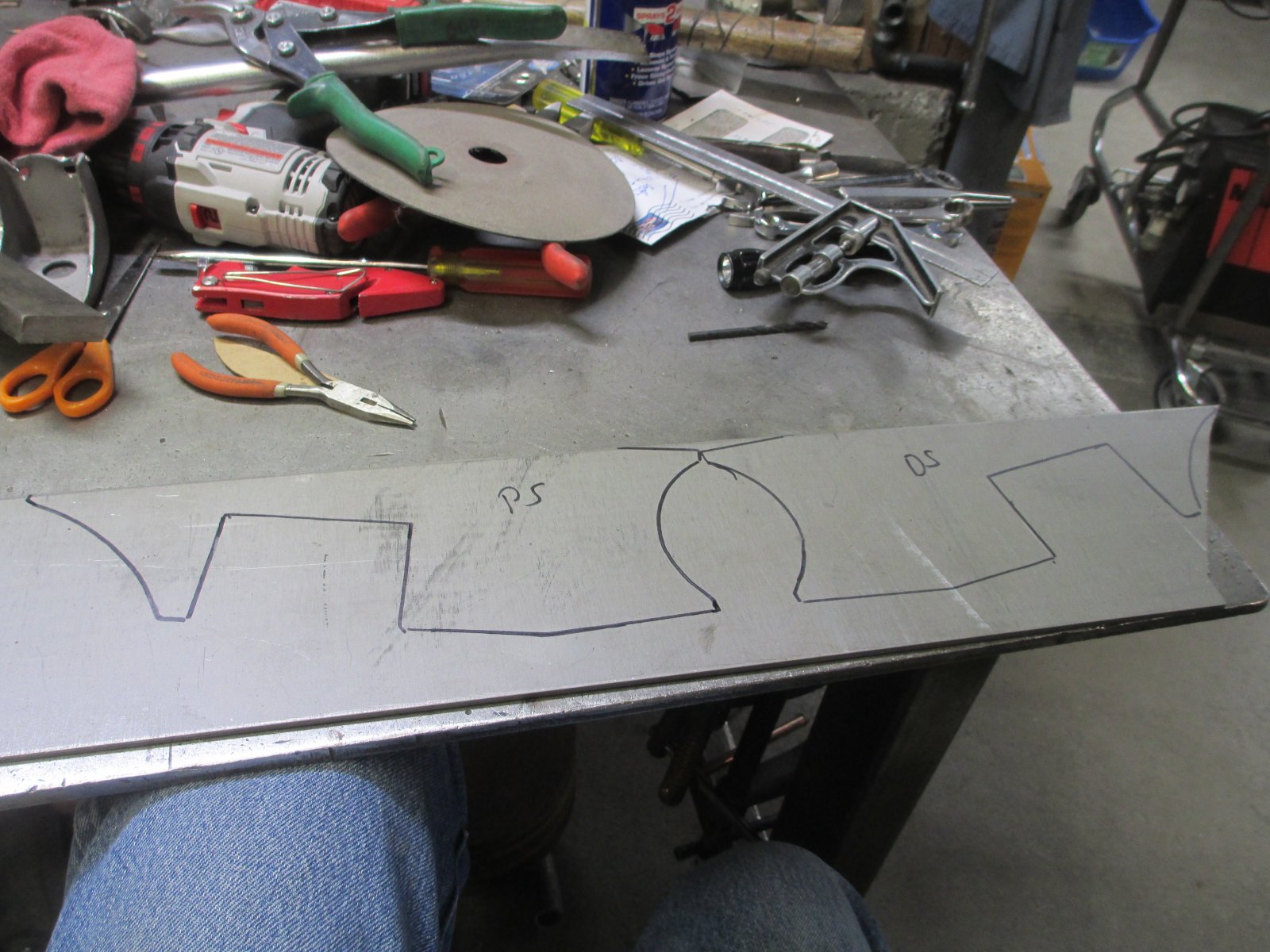

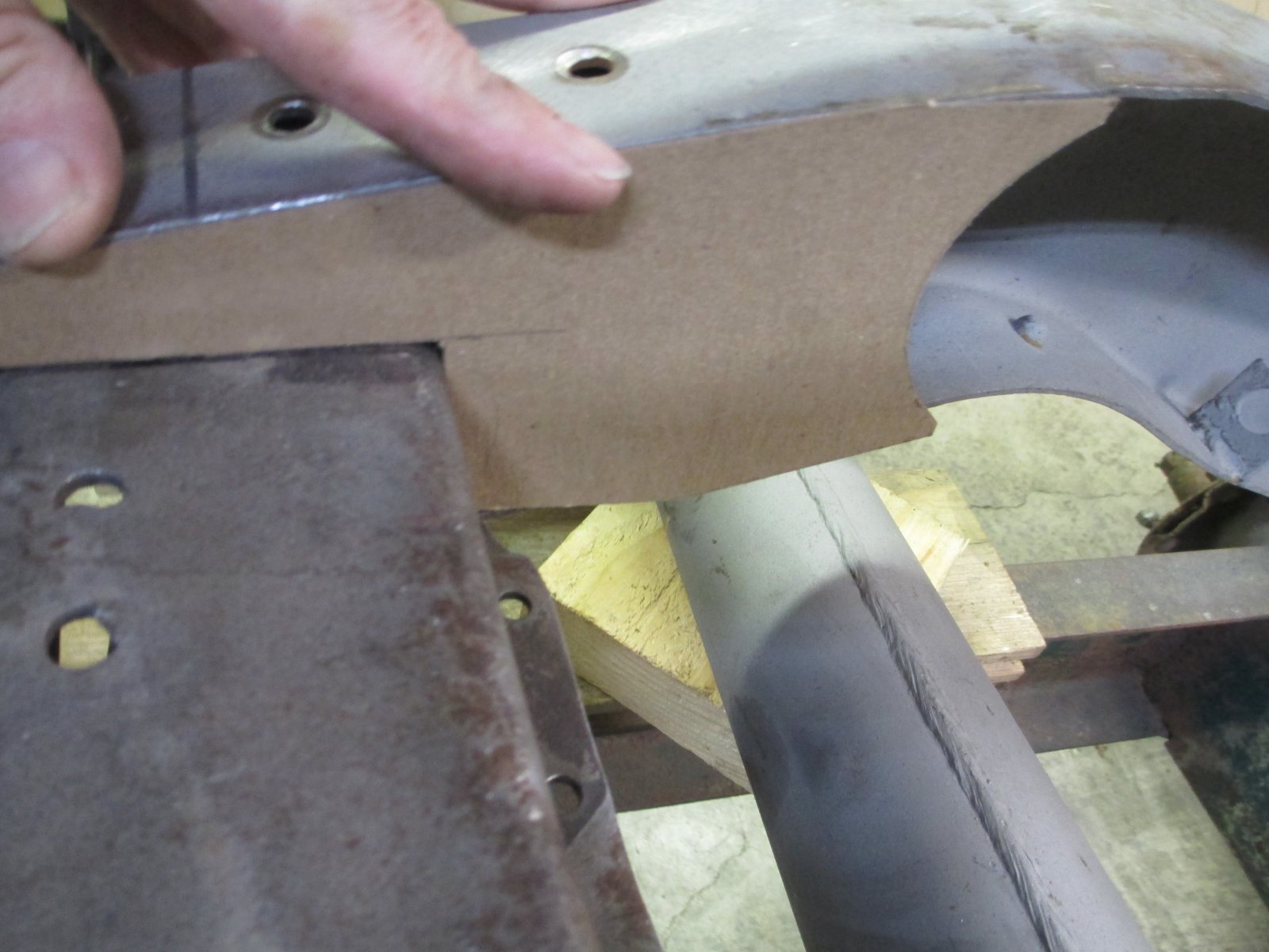

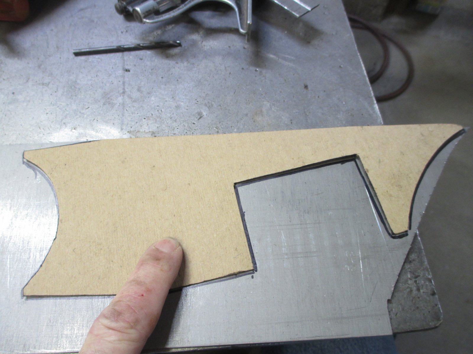

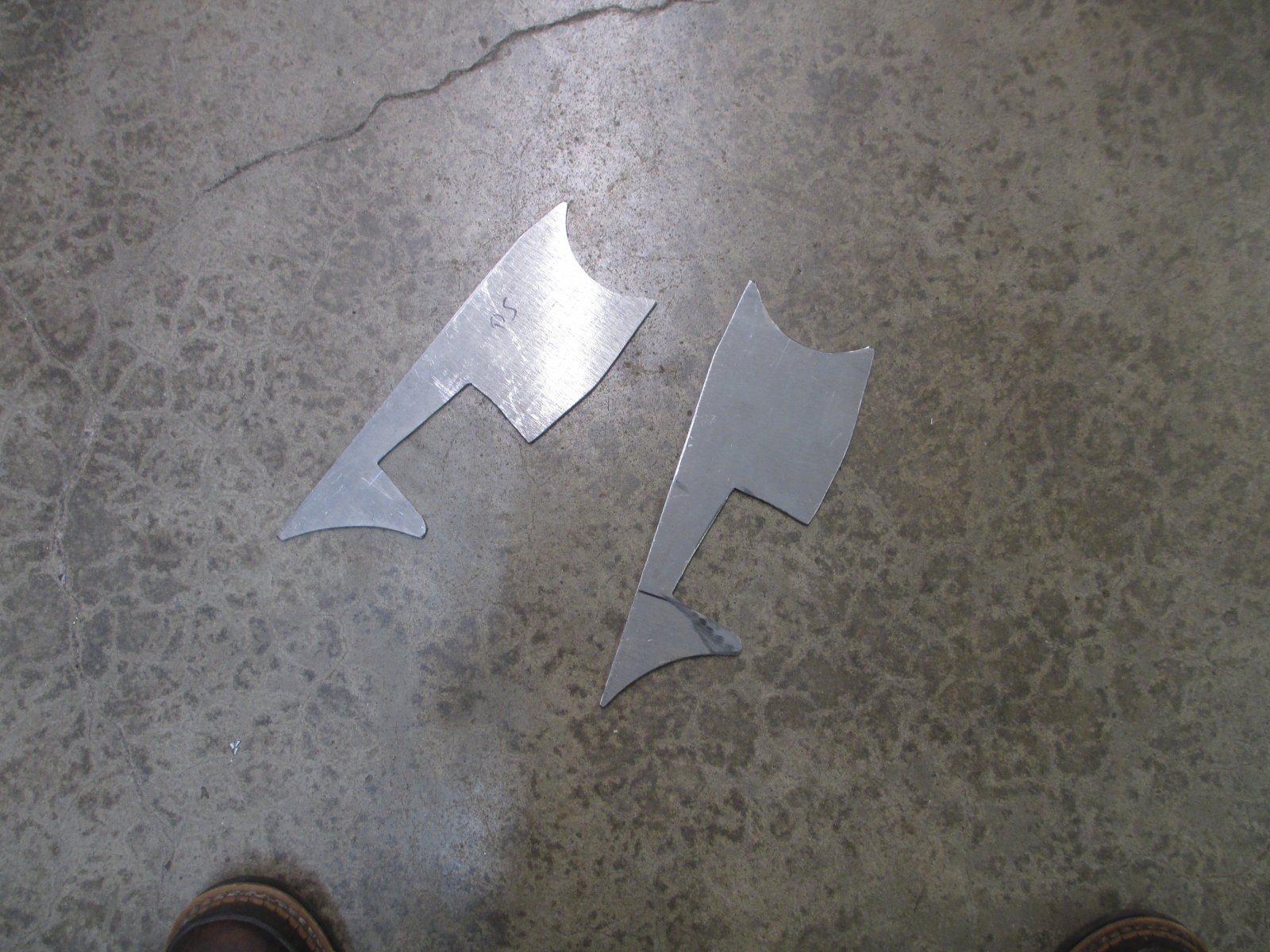

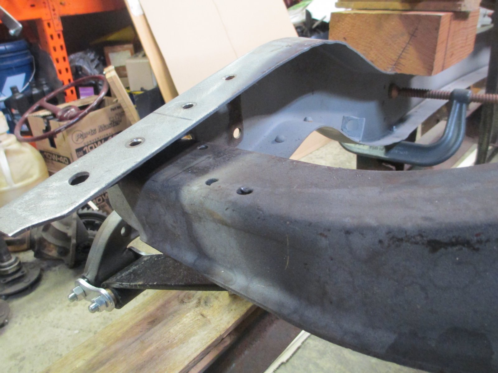

    While getting ready to install rear axle and torque tube, it was necessary to box the rear frame section at the crossmember. I made some paper templates and sawed the plates out. They will get welded tomorrow. BTW that is black ink on the plates and not a gap. IMG_8421.JPG IMG_8422.JPG IMG_8423.JPG IMG_8424.JPG IMG_8425.JPG IMG_8426.JPG IMG_8427.JPG IMG_8428.JPG IMG_8429.JPG IMG_8429.JPG IMG_8429.JPG IMG_8430.JPG
