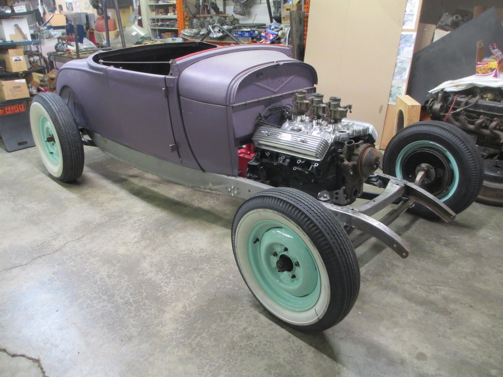

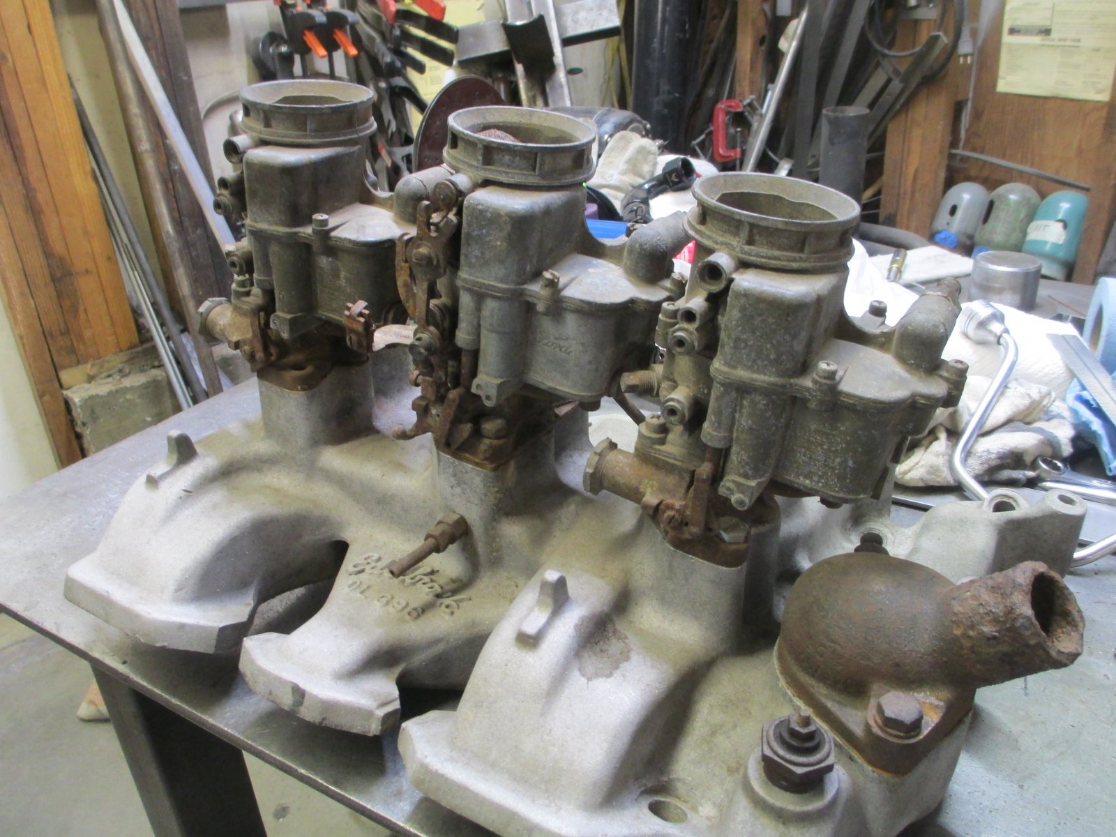

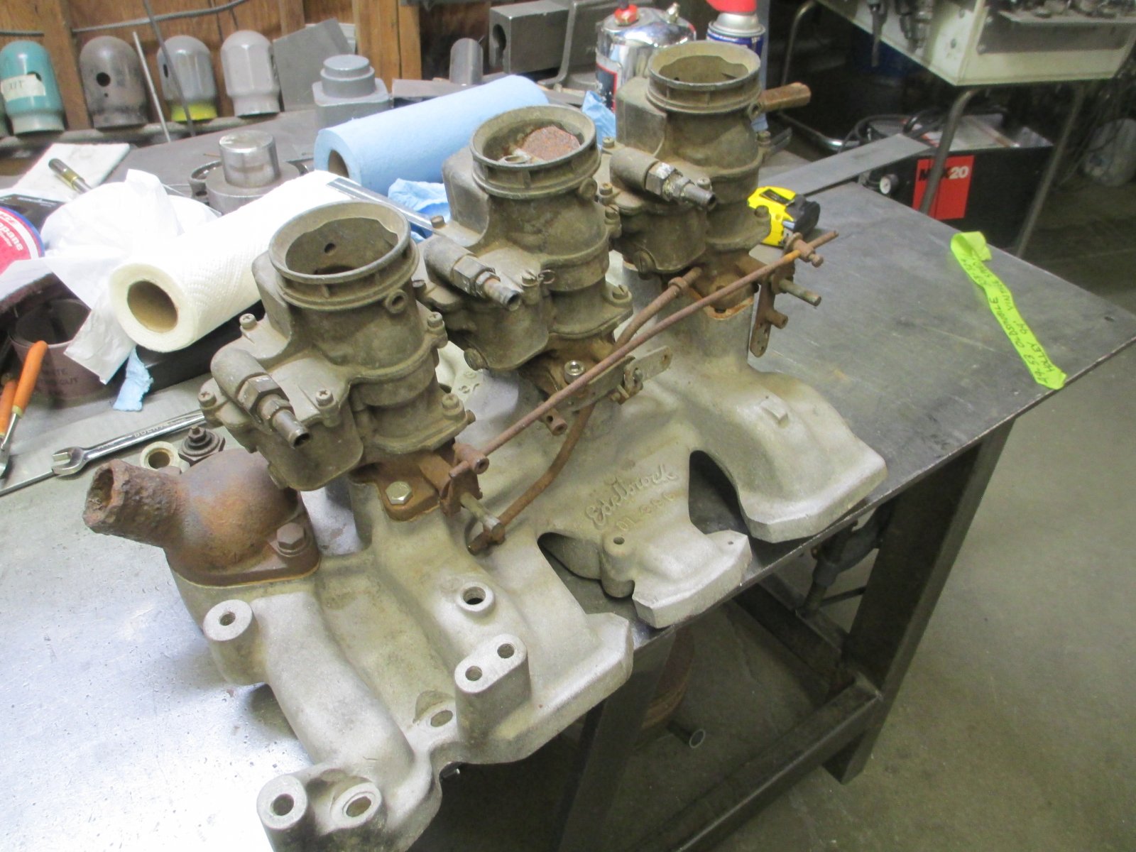

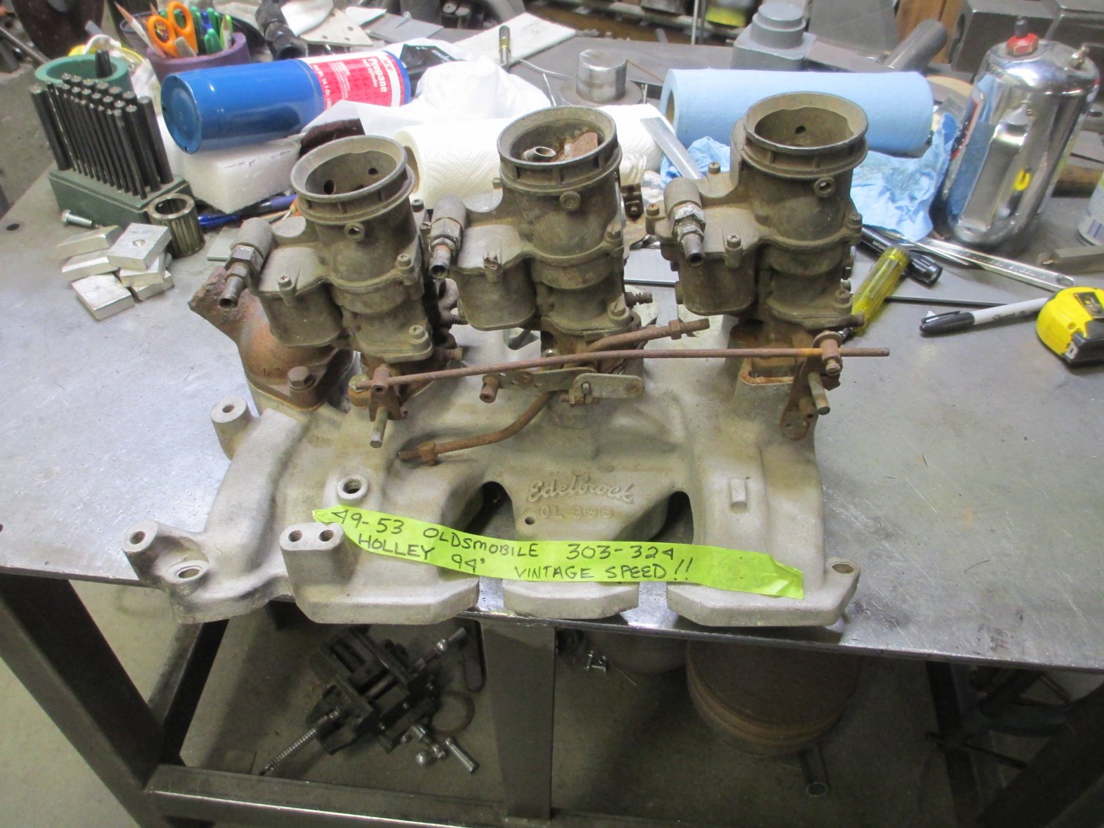

    On the subject of the engine, my machinist friend dropped buy Sat morning and checked the piston to wall clearance, and found it too sloppy to replace the piston and re-ring. So for now, I will leave this block in the frame, while decisions are made in the engine department. I have a 303 block that has a fresh bore to 3-7/8, and 2 sets of rods and pistons to choose from. Also, a friend called me about a tri-power that was for sale. It is the same part # as the polished one. So, as I have three of these engines, I bought it. With luck, I should have the car out of the chassis fixture, and sitting on all 4's this week. IMG_8462.JPG IMG_8463.JPG IMG_8464.JPG

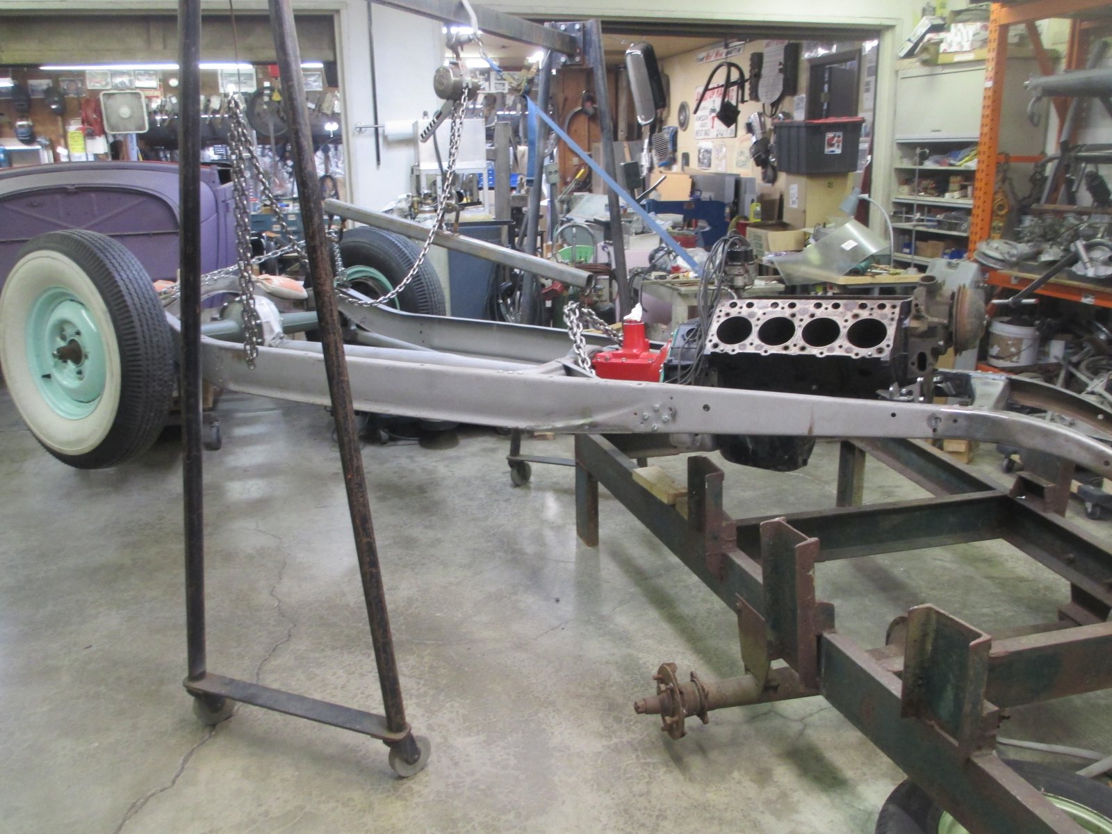

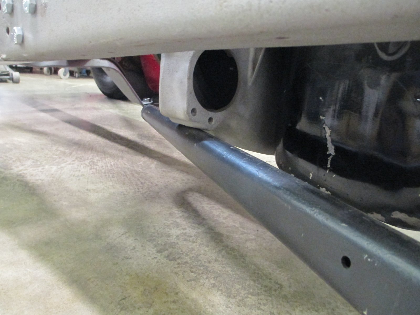

    I finally got the chassis on the floor, and the body set on. It can be****bersome, to lift and move around by yourself. I whipped up a spreader bar, out of some heavy wall tube, some old trailer u- bolts, and used some shot bags to correct the balance. The one hitch I see, is the wishbone hits the starter change over, and it is going to require splitting the bones, a little. IMG_8472.JPG IMG_8476.JPG IMG_8477.JPG IMG_8478.JPG IMG_8480.JPG IMG_8481.JPG IMG_8482.JPG IMG_8483.JPG IMG_8485.JPG

    Looking the goods, page 6 of this thread mentioned a Lincoln yoke for extra width at the back of the wishbones. That way you'll get the space but keep them un-split.

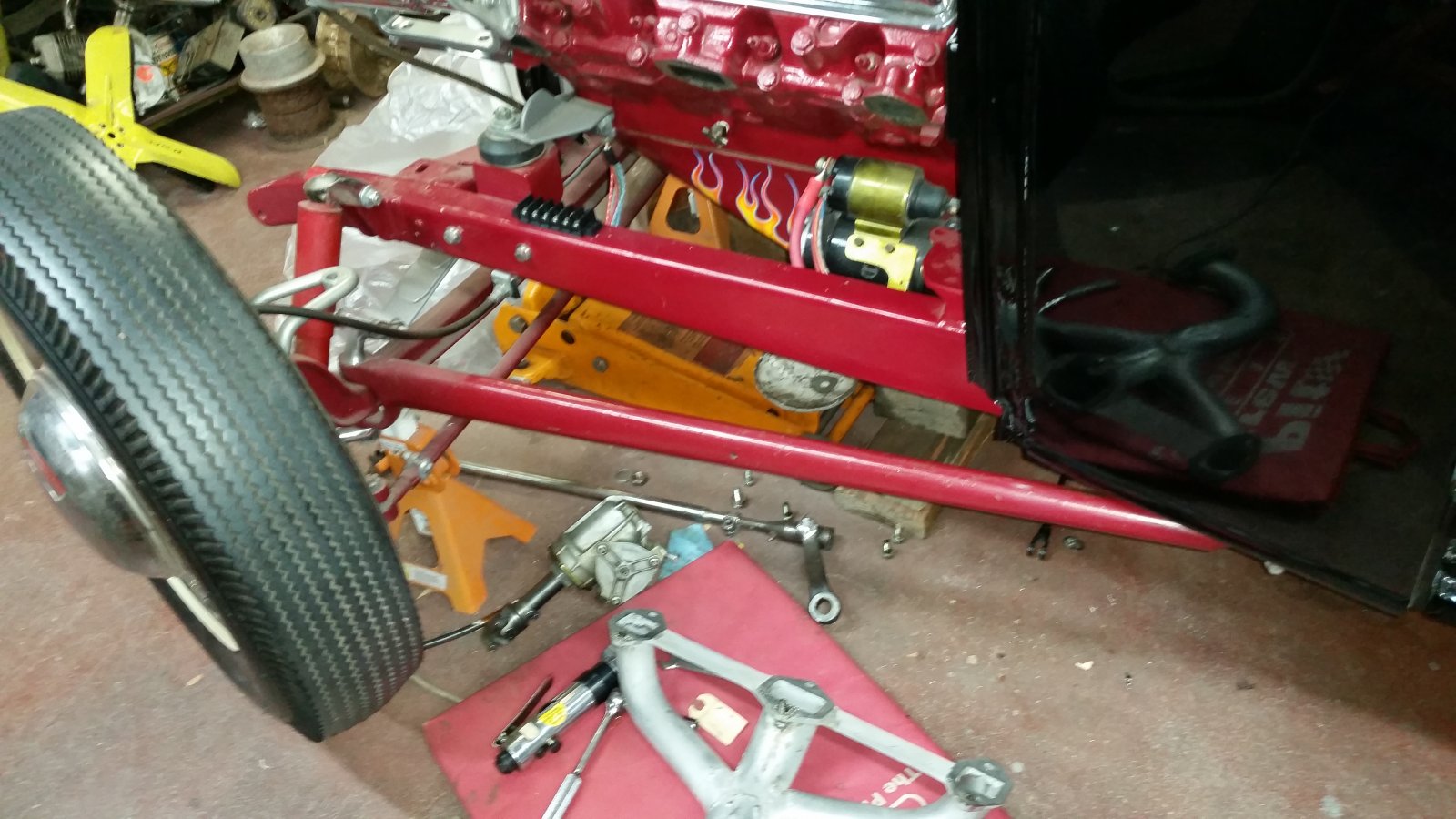

    20151119_134403.jpg When I did mine the first time, I had the motor mounts where you have them. The oil pan was below the tie rod. Had to raise them up...

    The problem I have with raising the front of the engine is, we are using a stock 32 K-member and trans mount. If the center of the tie rod has clearance problems with the oil pan, I can bend up a dropped tie rod. Also, raising the front will not help the clearance problem at the starter change over housing. Is that a 32 or a Model A frame you are working with ?

    Those wide Lincoln yokes also will give you room to bend and droop the wishbones down for even more clearance. Would add some caster as well if you want it.

    You could do a similar droop to the 32 wishbone yoke if you really put the heat to it. Might need to narrow the yoke a bit to get the length back that you lose by dropping down. I’d do some mocking up to find exactly how much more clearance is needed, and if could be accomplished “below” instead of spreading “beside” your bellhousing.

    Well, Jim took it home yesterday, to give me the time to catch up on my stuff. Here are some outside shots. IMG_8510.JPG IMG_8511.JPG IMG_8512.JPG IMG_8513.JPG

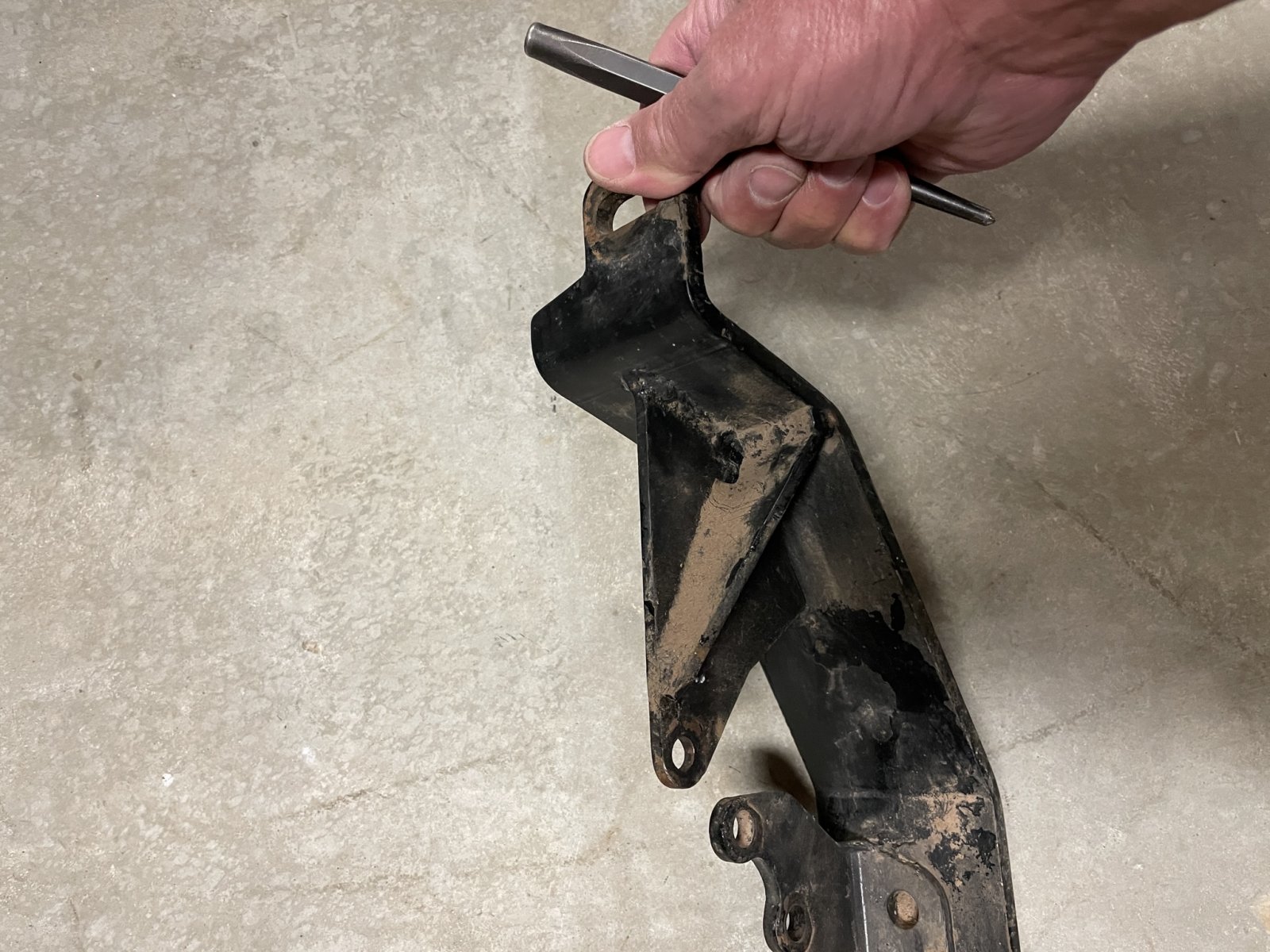

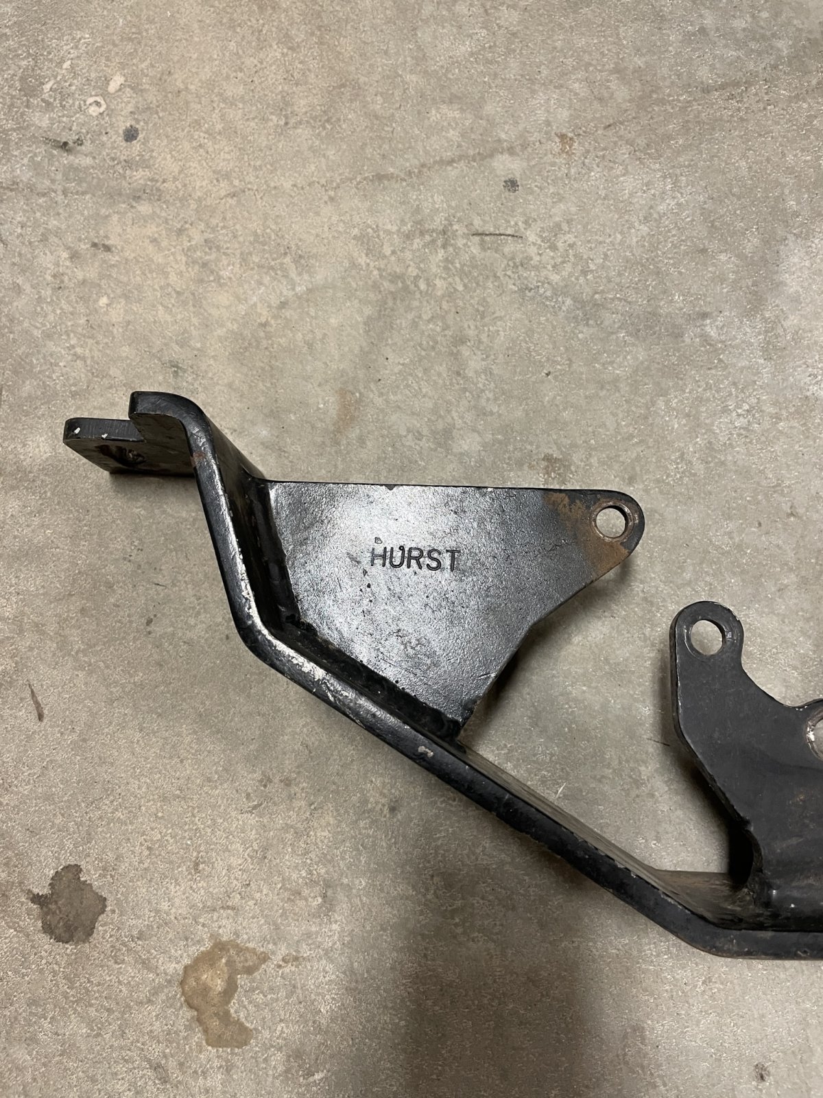

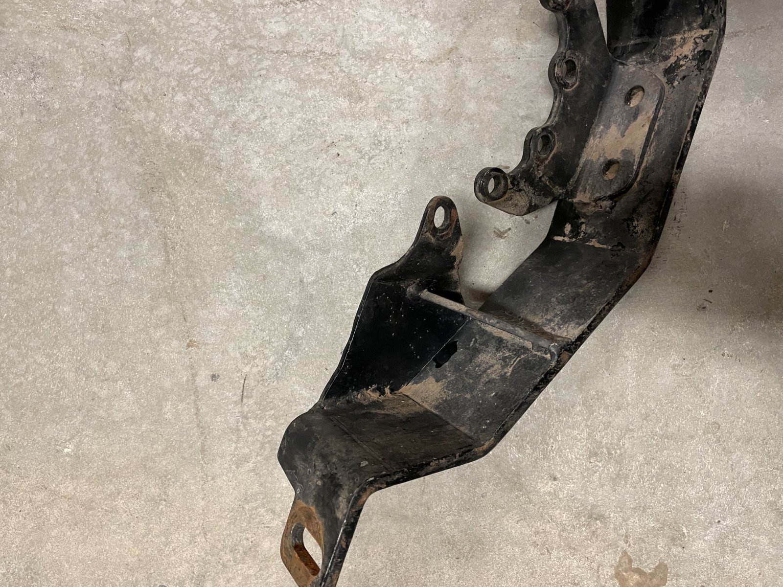

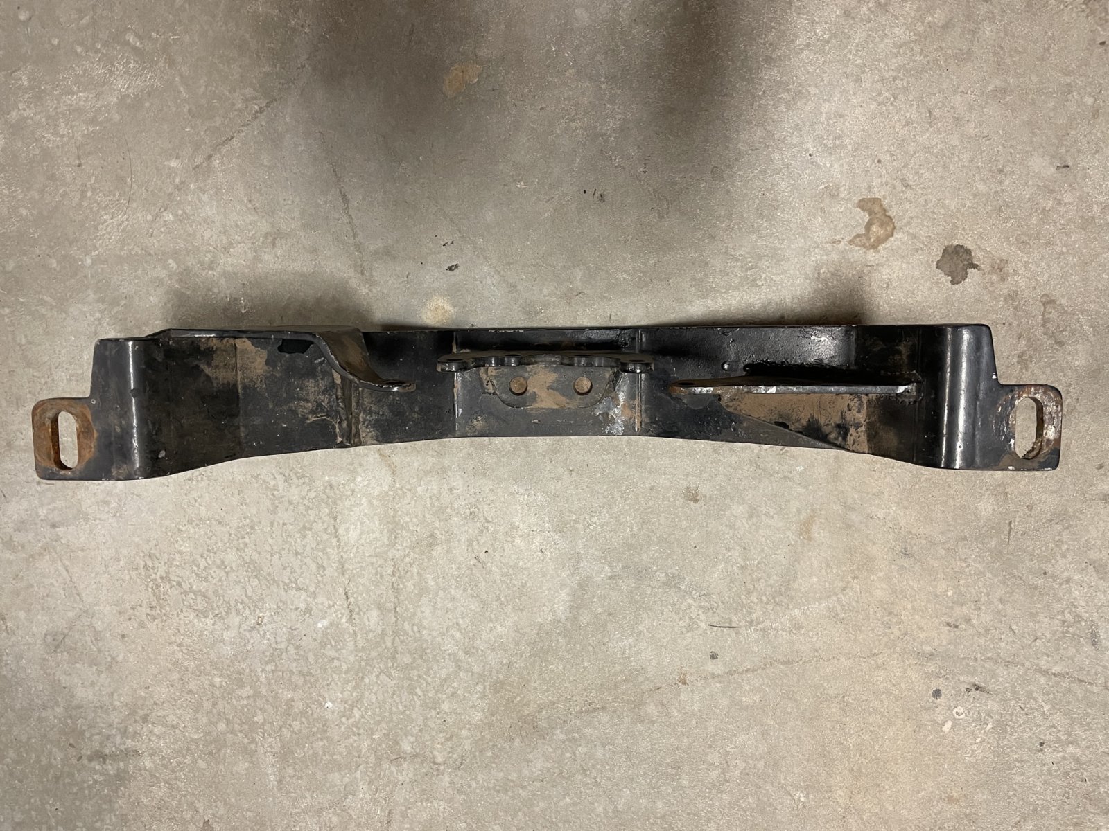

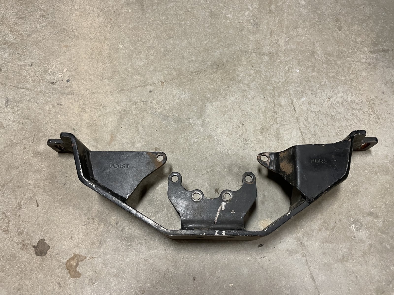

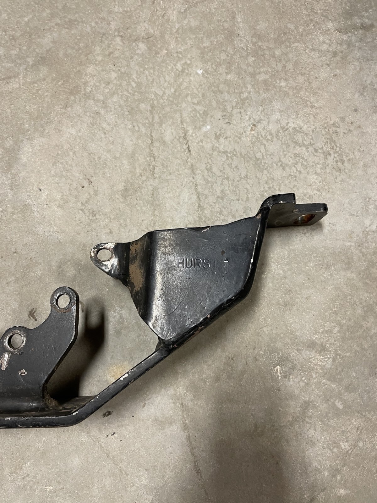

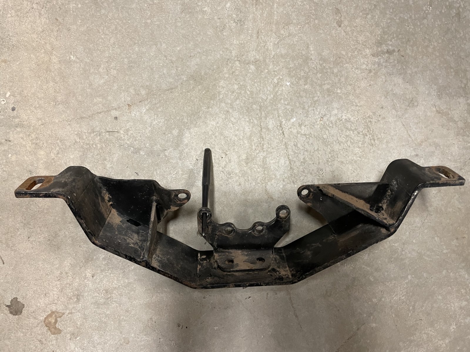

  26. Marty, in an attempt to be helpful I was going to post pictures of my Hurst mount that came on the 324 Olds in my 32 5 window. Got all the pictures posted and then realized that that build wasn’t this build, it’s a SBC build! But I’m thinking you might still want to see this mount because it’s so different from all the ones I’ve seen before. It mounts on the usual bolts on the front but then also has an extra tab that uses the lower bolts on the timing cover.
    Check it out… BABD1966-4C08-4132-8B54-790DE1A15A79.jpeg B7B8AFC7-7017-41FD-A5E4-408B1E5D9789.jpeg 50C55B78-848D-4920-9C12-5F3BC9977B21.jpeg 6AAC0F04-C82F-49E5-A8AC-6BCC5DE2E411.jpeg A773525E-DE77-4D3A-8ABA-697A6E3C0185.jpeg 92AA578D-958A-45D4-ABB8-66C1324B662C.jpeg 0FBD0083-5B6A-4558-B7A1-976E1AE21227.jpeg Maybe we should start a “Hurst Mounts” thread?
    Hamtown Al, loudbang, brEad and 3 others like this.

    I haven't seen that one, and maybe a Hurst mounts thread would very informative. The one's I used on Jim's had an extra tab that connects a large bolt 90 degrees from the crankshaft. Thanks for posting,

    You've got a good one to start a Hurst mount thread with!

    I'd like to a thread like that, but one suggestion, make it a Hurst Type Motor Mount thread
    I've got one that I'm sure Hurst never made but copies their style.
