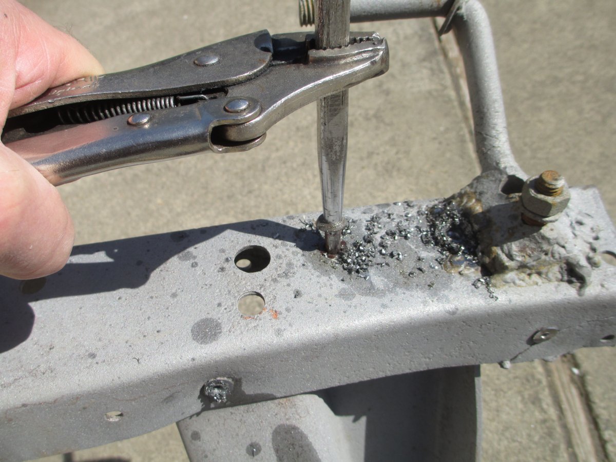

    Yes, they are. BTW, the striking force of a 3# or a 4# hammer figures out to roughly 10,000 - 11,000 PSI. Which ever one you use, you gotta be tough!:eek::eek::oops:;)

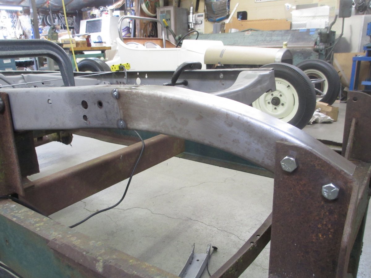

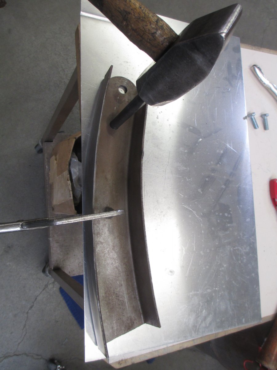

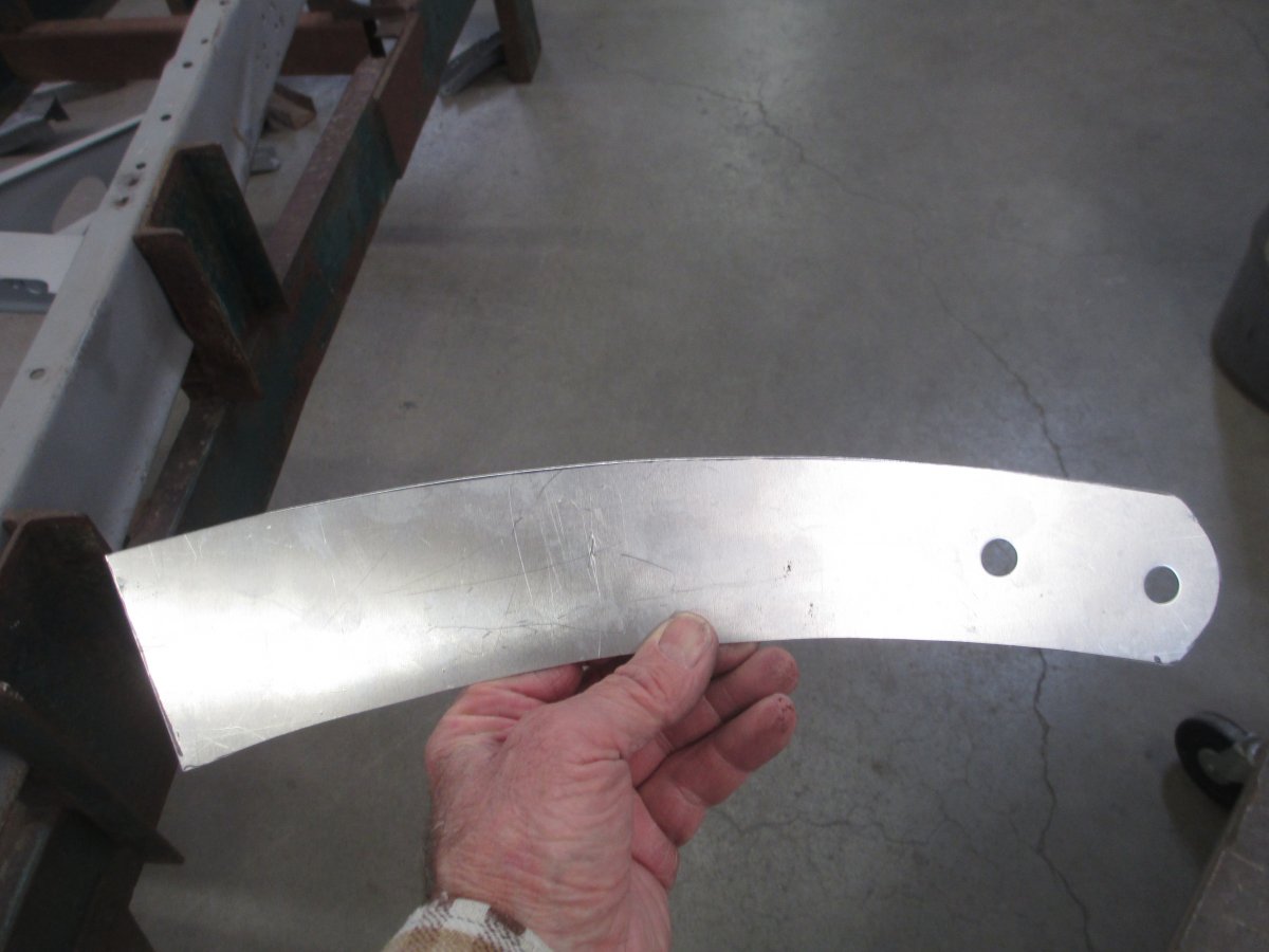

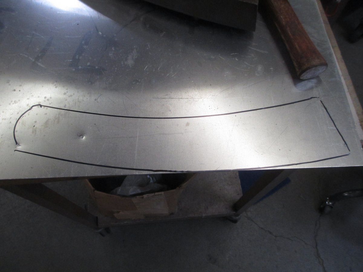

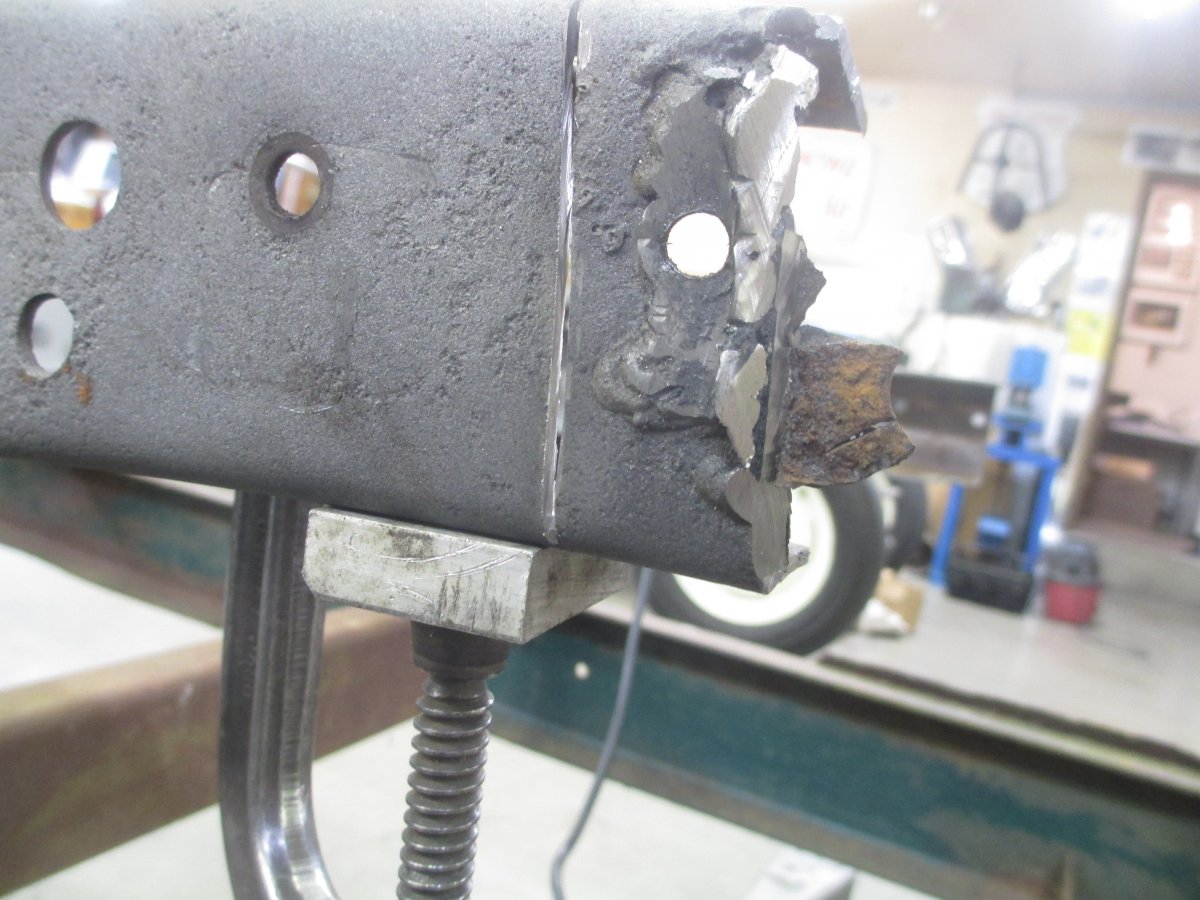

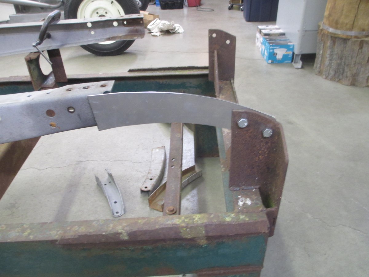

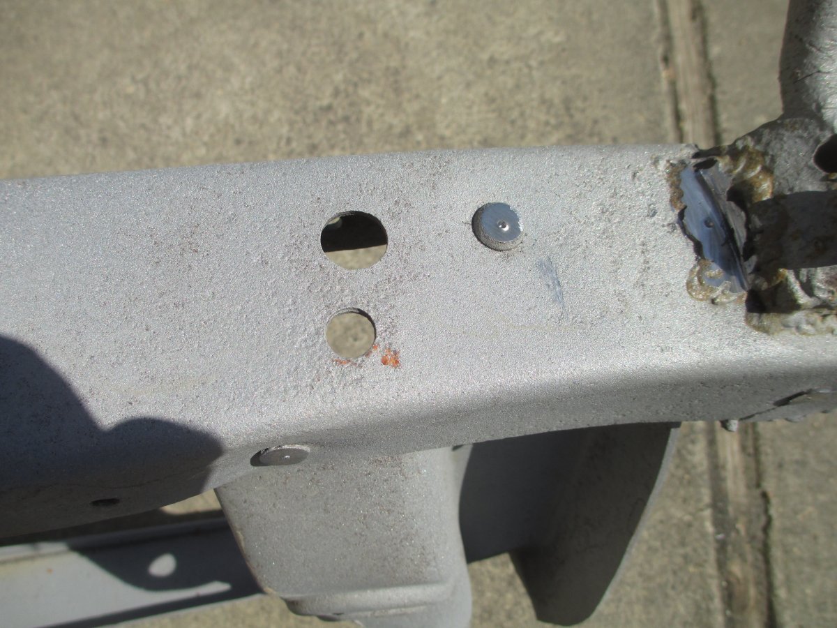

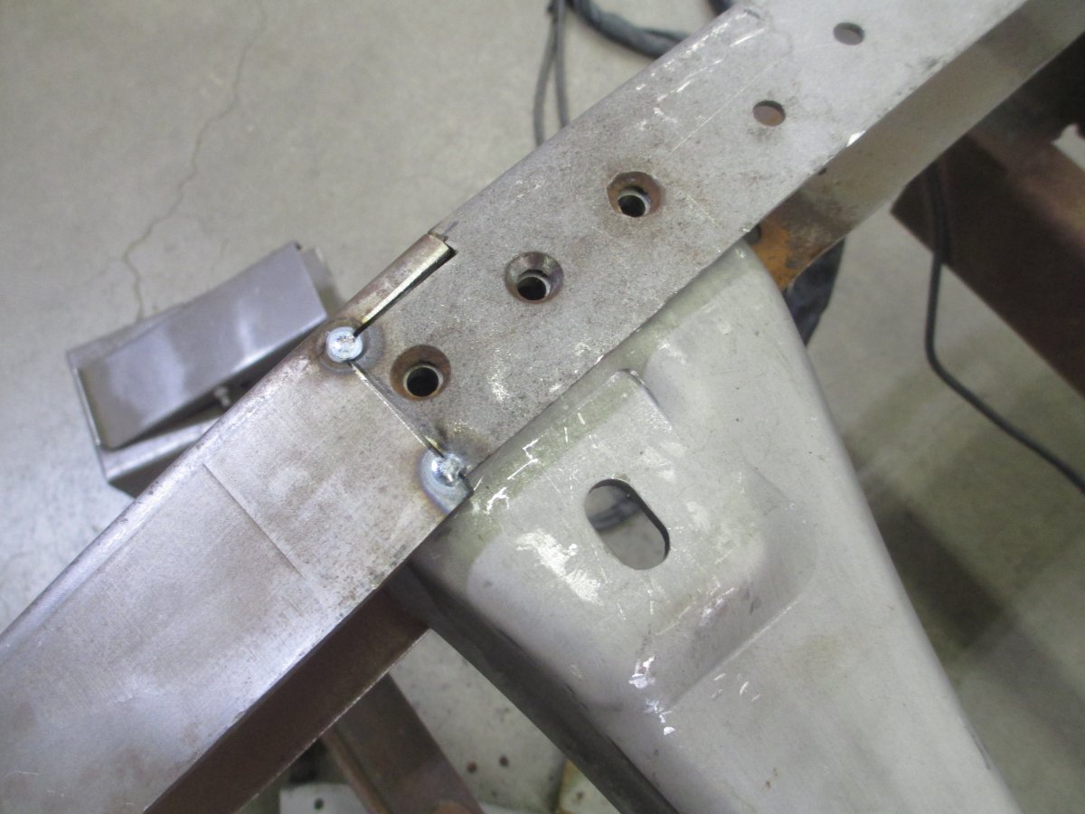

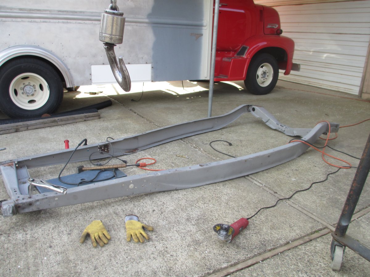

    I got one frame horn fit and tacked on. Starting with making a template of the replacement horn, out of aluminum. It allowed me to layout the zigs and zags, retain the rivet holes in the top of the rail, and replace the nasty on the sides. The other side will be more of a challenge, as the drivers side rail, will require a "pull", to line up at the crossmember. IMG_6707.JPG IMG_6708.JPG IMG_6710.JPG IMG_6711.JPG IMG_6714.JPG IMG_6715.JPG IMG_6717.JPG IMG_6719.JPG IMG_6720.JPG IMG_6721.JPG

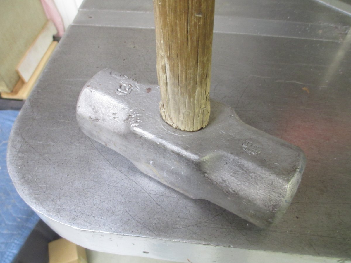

    Like this one Tom ? When swing room is limited, I use the 12 -13 hammer, 12 lb head and a 13" handle. IMG_6725.JPG IMG_6726.JPG

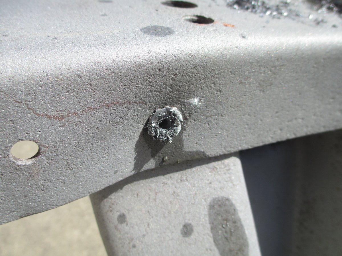

    The lower flange on the RH frame rail, had a bad, rusty spot, where the K-member is attached, and need repaired. So, I rolled and punched a short section, and got it tacked in place. Now with the rail back in place, I can finish replacement of the driver side frame horn, and bolt in the K-member. IMG_6732.JPG IMG_6733.JPG IMG_6735.JPG IMG_6736.JPG IMG_6740.JPG IMG_6741.JPG IMG_6743.JPG IMG_6745.JPG IMG_6749.JPG IMG_6751.JPG
