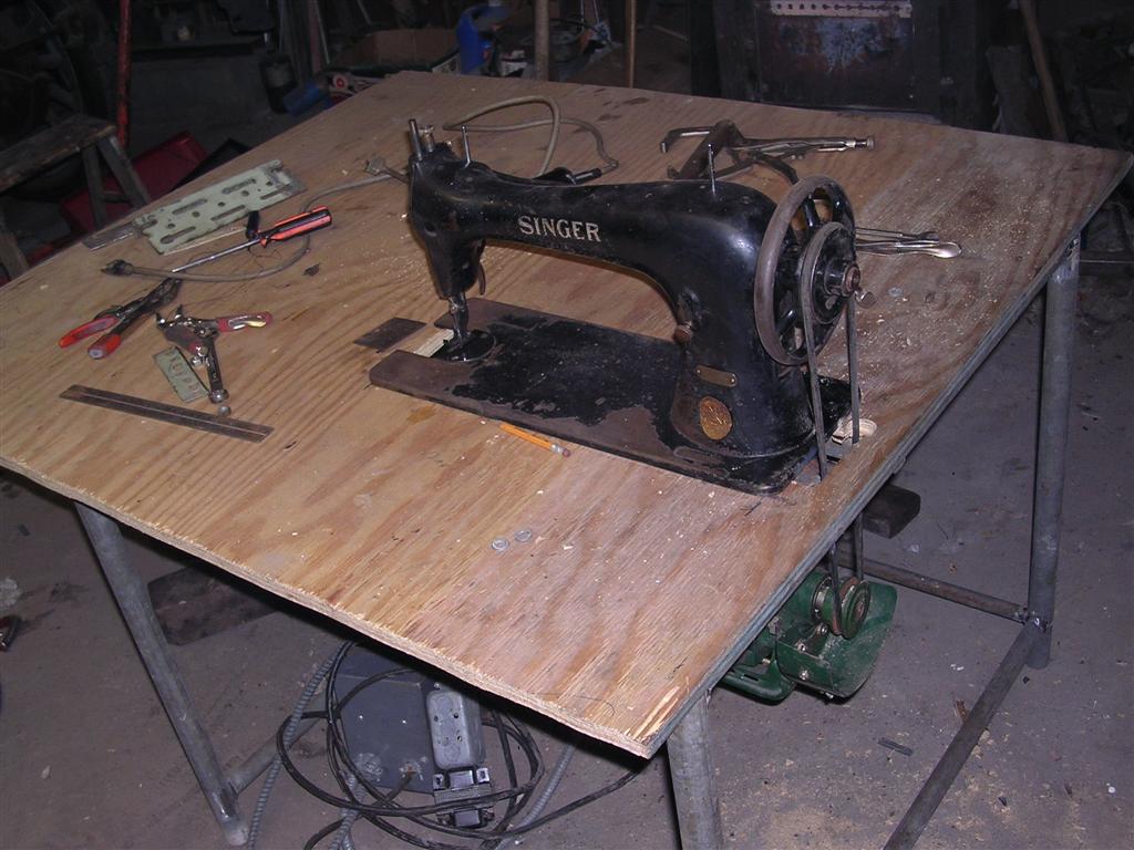

    Time to build a sewing machine thingy :)
    I've had the old Singer walking foot for almost 5 years, never set it up. Back then I bought a used ebay clutch motor that turned out to be a 3 phase, it came shipped in a plastic cooler. Maybe I can use that to sit on while I sew:rolleyes:
    Well, I built the table from free pipe from my last house, and some leftover 3/4 ply that a friend found 2 new 4x8 sheets in his dumpster. I used some to fix the seats in the Nash and also the 31 Caddy seat in the Ford.
    The special 1/4" dia round drive belt up to the Singer is actually a sealing O-ring from a swimming pool filter cover that my son scrapped out:rolleyes:

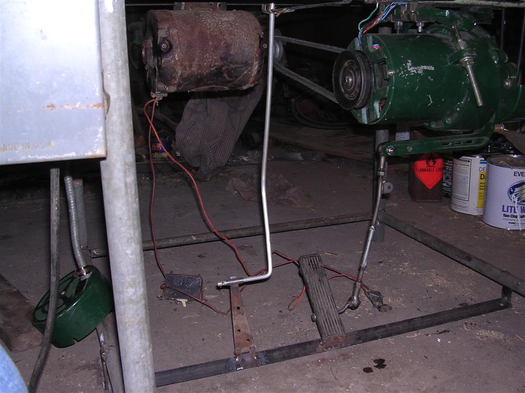

    All that went good but, as I never ran a clutch motor, I did not know how to set up the clutch/brake pedal, or even know that there is another pedal to lift the walking foot with your foot instead of using the hand lever.
    Clutch/brake pedal is 40 Ford gas pedal, hooked to old heim carb linkage that came with my 2x2 setup. The foot lift pedal is made from a shed door hinge:eek:, and the leftover aluminum rod from my grille. I spent some time planning the pedal ratios to make it very smooth to operate.
    Then disaster hit when I hooked up my static 3 phase converter to the clutch motor. First it studdered the convertor box, but the next try, the motor started. It ran 1 minute and smelled real bad. I think the phase converter is too big for the small HP motor. It runs my 1HP mill just fine, though. Checked the fields, not shorted, but the armature is what is boiling hot.
    So I wrote to a hamber last night for advice on what type of motor to get: either a 110 clutch motor, or a servo type variable speed, that does not run till you touch the pedal, or any other ideas. He said go with a clutch motor. Well, I don't want to wait to order one...so....
    My son found a 1/2HP antique 100% duty cycle motor in his shed this morning, with a pulley on it. Now I need to hook it to the dead clutch motor so I can keep the clutch, which was new.
    I took the armature out of the clutch motor, put it in the lathe to bore a hole in the back end and then thread the hole. Then a short piece of 3/4" round stock that I bored and faced on the lathe, then milled a keyway on it for a driven pulley. Bolted that stuff to the old motor back end, and ran a belt to the "new" motor. WTF?... Hey, it was one of those projects where you keep saying "this won't work for shit" ... and..."something will go real wrong"
    I just finished hanging the "new" motor on an old house door hinge so the belt could stay tight by gravity, then put on the belt and gave it a try. Holy crap it runs so quiet, does not slip, and it also geared the sewing speed way down to make it easier for me to sew. It sounds perfect. Pedal operation is so silky smooth, no jumpy rpm changes on the needle speed.

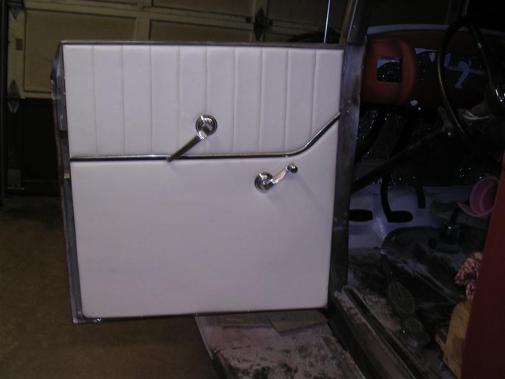

    Barely touched the car in over 3 weeks; lifes other obligations need doing.
    Anyways, the heavy weight white leatherette I bought years ago is silky soft to the touch, like leather, but even if you wash your hands a lot, it gets dirty from working with it. So now I am practicing with marine white vinyl in thinner weight. It does not get dirty at all.
    It is hard to learn sewing in this heat, when busy with other things, and nobody around to teach me. So it's more practice.

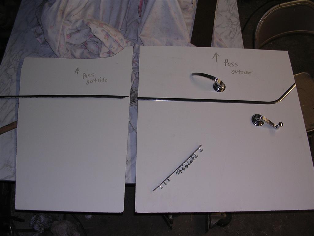

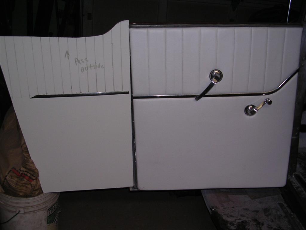

    Here is the trim layout for door panel and rear quarter panel in pics. In the first pic you might see the small piece of trim with all the screws. I made these from "t nuts" that slide into the stainless trim, then they get held to the panel with screws.
    The stainless strip was cut from 37 Ford hood sides. I silver soldered the cut ends on the door piece, and it looks fine, so i'll do the others too.
    Above the strip will be the roll pleat or whatever it is called, and the bottoms will be smooth. That's because i never liked front kick panels done in roll/pleat because it's too busy looking.
    The roll/pleat at top of door edge will be covered with garnish mouldings, so when you fold the material up over the panel board, it won't look unfinished.
    But on the curvy topped rear panel, there is no garnish. So I tried making welting from a piece of material wrapped over 14 ga wire, and tried sewing that to a test panel. I think that will make the top of the quarter look fine. I never knew the walking foot has a groove in it for making welting till 2 days ago. Duh.

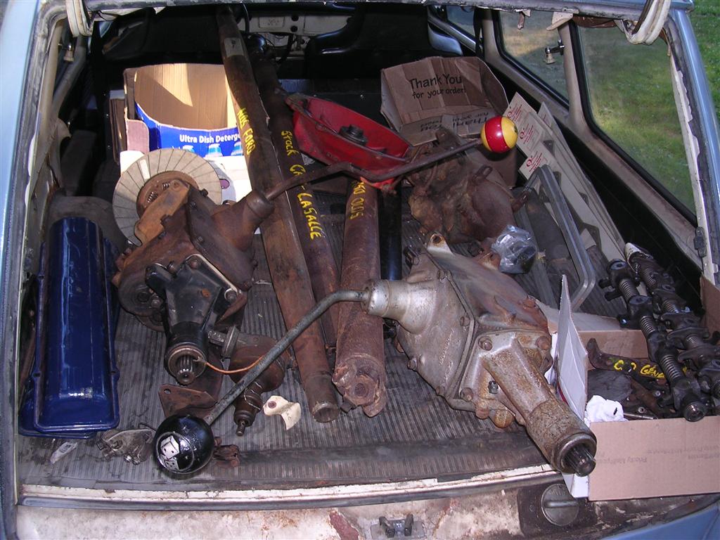

    Son and i left early AM today to meet a great old school hamber from out of state, for some parts. I was supposed to bring a truck, but took the little station wagon that Ted does not like :D. Well, he brought way more heavy parts at the last minute. Quite a load; 2 buick and one chev trans 4 driveshafts, and more stuff. One buick is Walt's. Check out the only part I really needed :confused:...the very cool dice shift knob:rolleyes: He told me it weighs 5 pounds, and it sure is heavy. I may need to trim it down, so it won't wear out the 2/3 fork.
    Also stopped by at the Gasket Goon show on the way back. He, he, the Gasket Goons asked us if we were vending, when they saw all the junk in the back :) Busy hot day today.

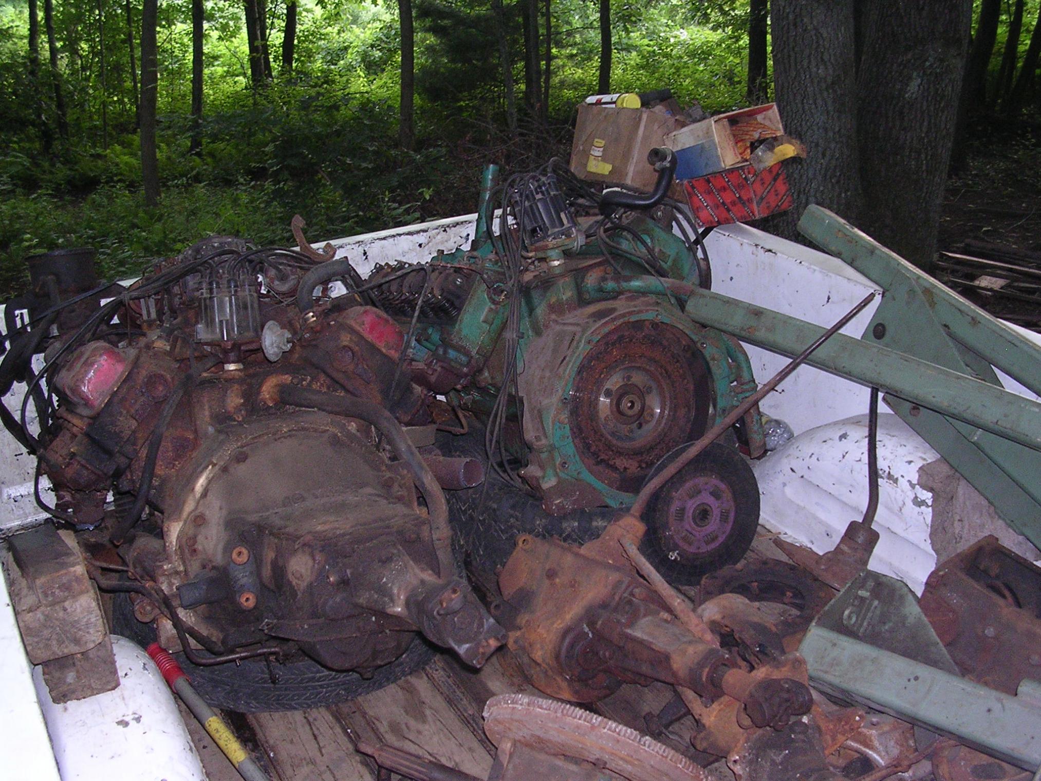

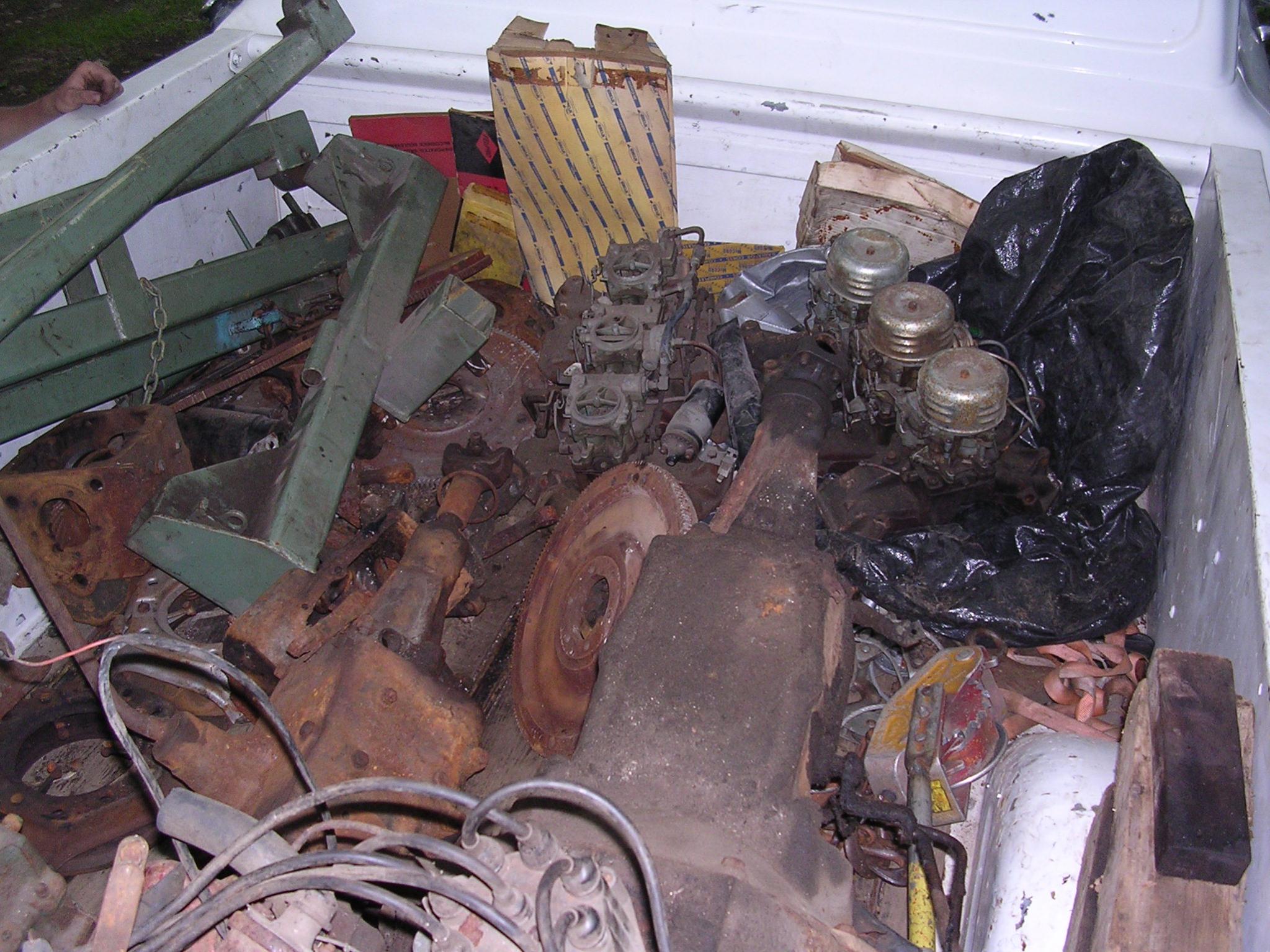

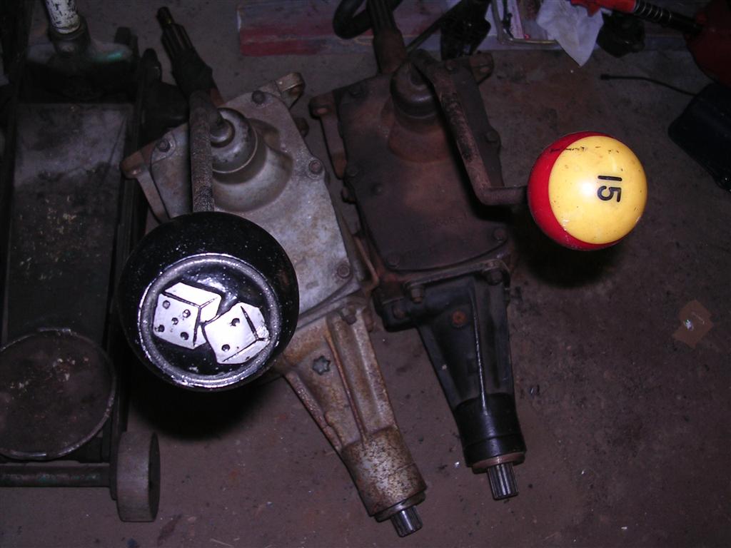

    That was today, this was a couple weeks ago.. It's like "where's Waldo" pics. Some good stuff is covered with the black plastic.
    I believe I have some sort of problem, I think. Well two, one is Olds, the other is overloading things.
    The old Chevy truck was not squatting, but my son did the hauling, and said it could have used a bit more brake :D

    I figured, so I put up huge pics in that post, so you could find waldo :)
    where it came from; you could walk right by something 20 times and not even notice it.
    One was a pair of old time aftermarket aluminum plates to use a 324 intake on an early 371. Three Olds hambers went right past them many times, on several visits, and they were sitting right in plain view on a valve grinder bench. Not a big deal type of part, but shows how the mind sometimes is completely out of tune.

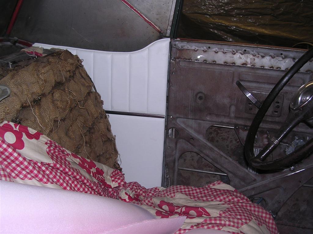

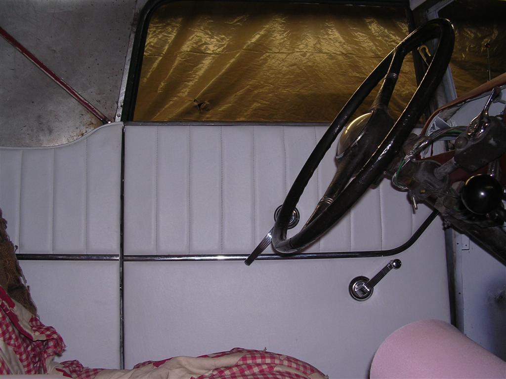

    Despite the insane heat/humidity, I decided to stop practicing, and try to do one panel. This Singer machine is at least 80 years old, but it works good, even though I don't know how to use it.
    I am doing the panels that I can't see, if I am in the driver seat :D
    The last one will be the passenger door.;)
    Anyways, there is my first attempt. I think I will keep going, because I am OK with it. The rolls are a bit wide, but for every extra sew line, that's one more chance for me to screw it up.
    I am not having great results with the spray glue. 3M #80 is for vinyl/rubber, but is useless. It does not stick at all.
    I did buy a commercial brand from the local upholstery shop, and it's good if there is no stretching load on the piece, but it is not good enough around corners where I pulled the top welting over, and tried to get it to hold on the curves.
    The best stuff I used years ago, was 3M Fast Foam Adhesive, but I have not found it around here. Made to bond slabs of foam together, but it sticks to anything real permanent.
    So, how's it look from far away ? :D
    Oh, I did not make the "windlace" yet. Windlace is what they used before door gaskets were invented. It keeps drafts out. It gets sandwiched between the edge of the rear quarter panel, and also at the front kick panel, and the door touches them.

    I'm stuck. I could use some opinions on the rolled part of the door panels.
    The 2-1/2" wide rolls look so streetrod to me, too modern. IMO
    How would it look if I did an extra sew line in between those, just like I drew on the rear panel?
    1-1/4" is a bit narrow, but maybe it would look more old time? I think it would make more of a rounded roll, not so flat looking. I hope..

    I did 1.5" pleats in my '35. They start out as 2.25 I think and then with .5-.75" thick foam they get small quick but I like how chunky they are.. I think 1.5" was the standard T&R in the mid 50's. Sorry about the shitty pic...
    kidcampbell71 likes this.
  24. I like the look of the 1.25"/1.5" pleats. I say, stitch some more lines Frank. See how they turn out.

    JJ's car looks freaking old school cool as far as the width of the rolls. That's the ticket :)
    Thank's for all the opinions, I guess I will soak my head in cold water again, and see if I can stitch some halfway straight lines

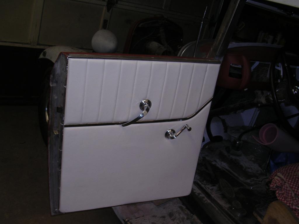

    Ok, ever try sewing a straight line in a thunderstorm distraction? So here is the passenger quarter done in 1-1/4" rolls, but not stetched or glued to the backing panel, no trim piece, no top welting yet.
    I like it way better, because the flat look is almost gone on each roll. These would be too close together on a much wider door panel, but I think it will be OK on my very narrow doors and rear panels.
    I just need to find a way to relax when I start a line. Once I get halfway through a line, I can, but when I first start, I am worried how fast the clutch will grab. Just need more experience.
    So, if the roof and seat ever come out way nicer, I could remake these 4 side panels for maybe $40-$50 total.
