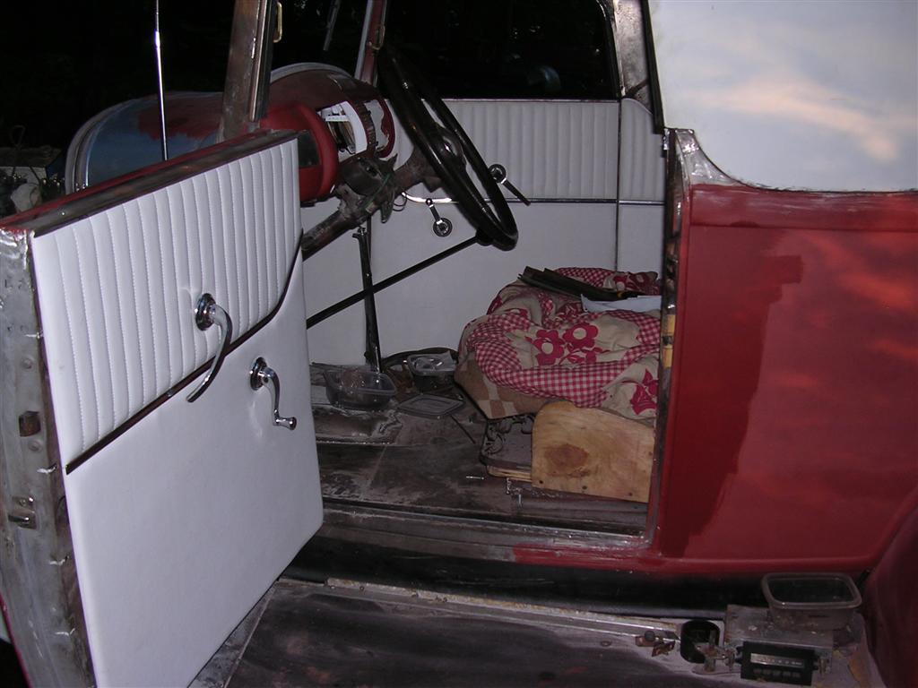

    Well, I'm still having trouble with sewing straight lines. I am sure it is caused by using the sew foam.
    That foam won't be used on the top, or a good part of the seat, so it may go better.
    Pics show panels are barely held in place. I did not put in the Auveco clips yet, because this all needs to come back out during paint/bodywork. I also have not made the windlace yet, to cover the gaps at the door edges. Those are easy to make, sew, and install.
    I started laying vinyl on the roof tonight, but I am thinking I should start on the seat tommorrow instead. An elderly friend said the seat will be easier than the door panels:confused: ...he has done a lot of cars, so...

    It's worth a try in this economy. I think it's less than $10 for materials to make a door panel, so if it looks too ****py later, it can be fixed.
    I will take the seat out in the morning and I think I have enough vinyl to do the whole "frame" of the seat. I should be able to do that in a day. I'll take some pics of how I did it.
    Sewing the cushions? well... I will see

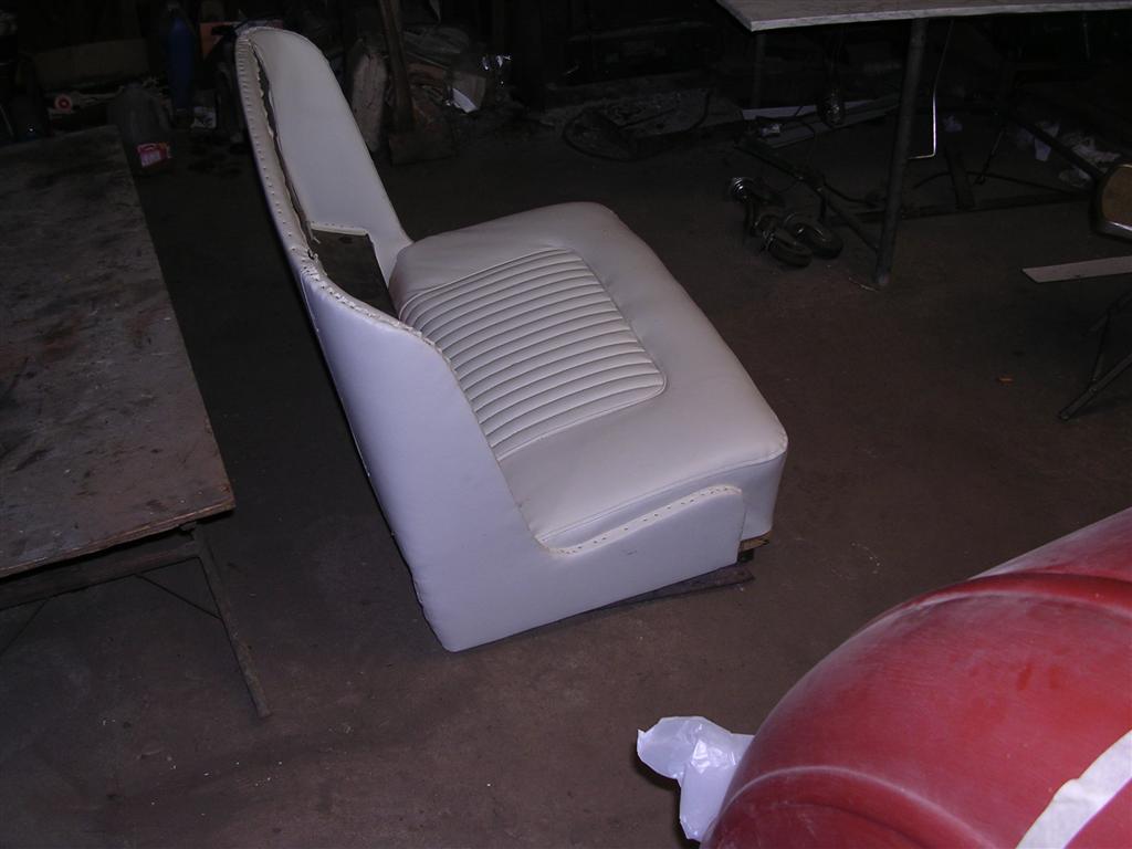

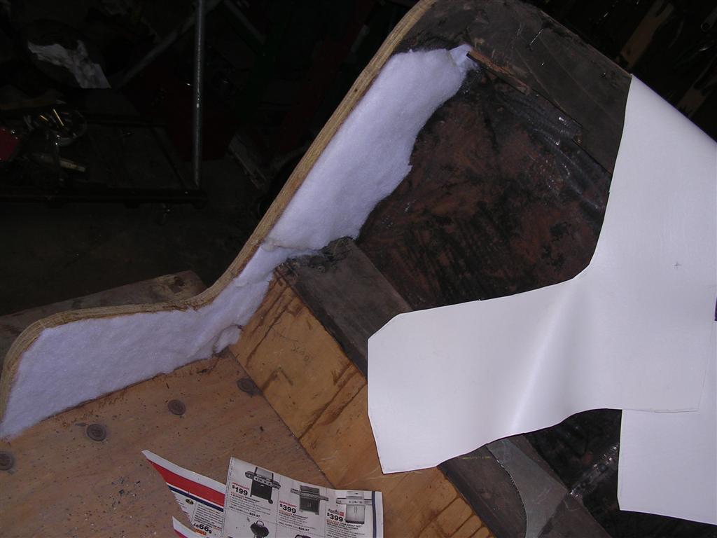

    Barely got started on the seat. First thing to do, is to find where to start, so I started on the inside pieces.
    I needed to put quilting stuffing in the upper corners so that the vinyl will be smooth on a concave corner.
    Then, it looks terrible with wrinkles when you just get started stapling it in. I am pulling the vinyl up over the top and temporarily tacking it to the outer sides,while stretching and tacking.
    That extra material on the outside will need to be trimmed off before putting the outside pieces on. Then there will be "hidem" strip running all along the edges when done.
    Tommorrow, I need to sew the 2 outside pieces to the large center panel on the back of the seat, then stretch and staple that on.

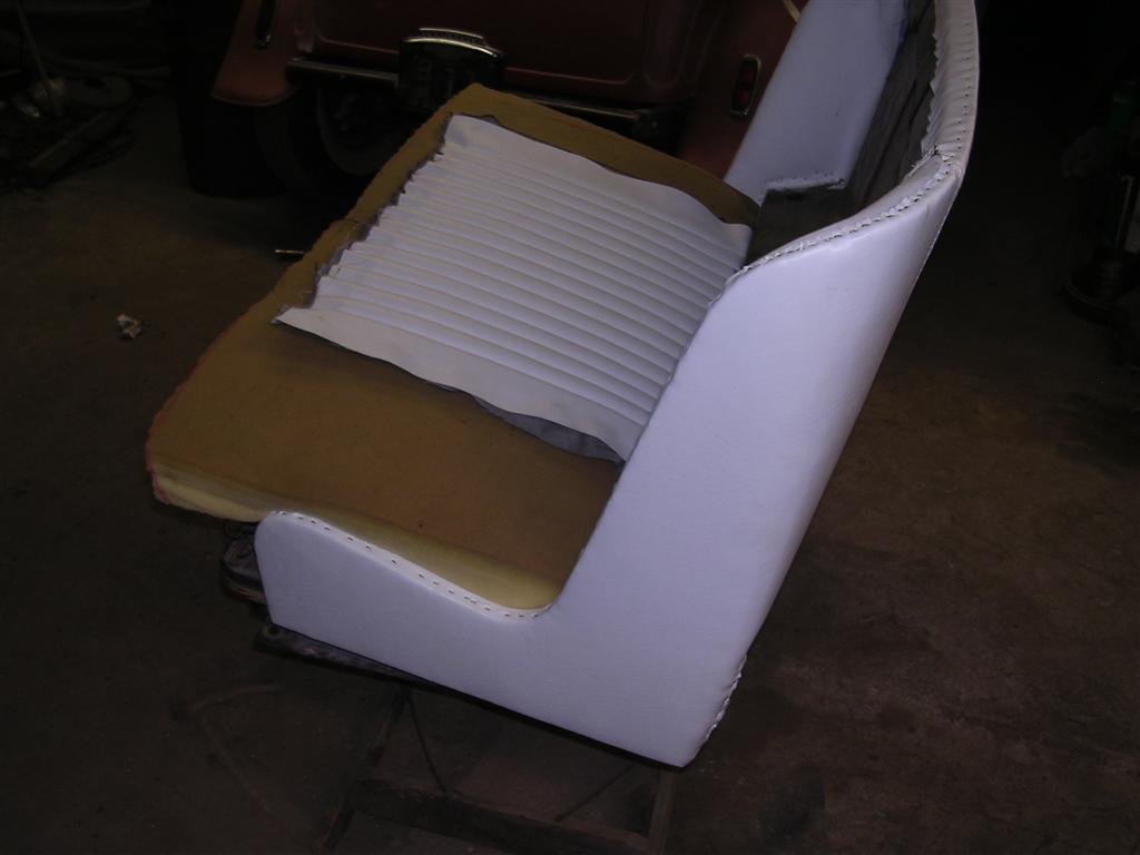

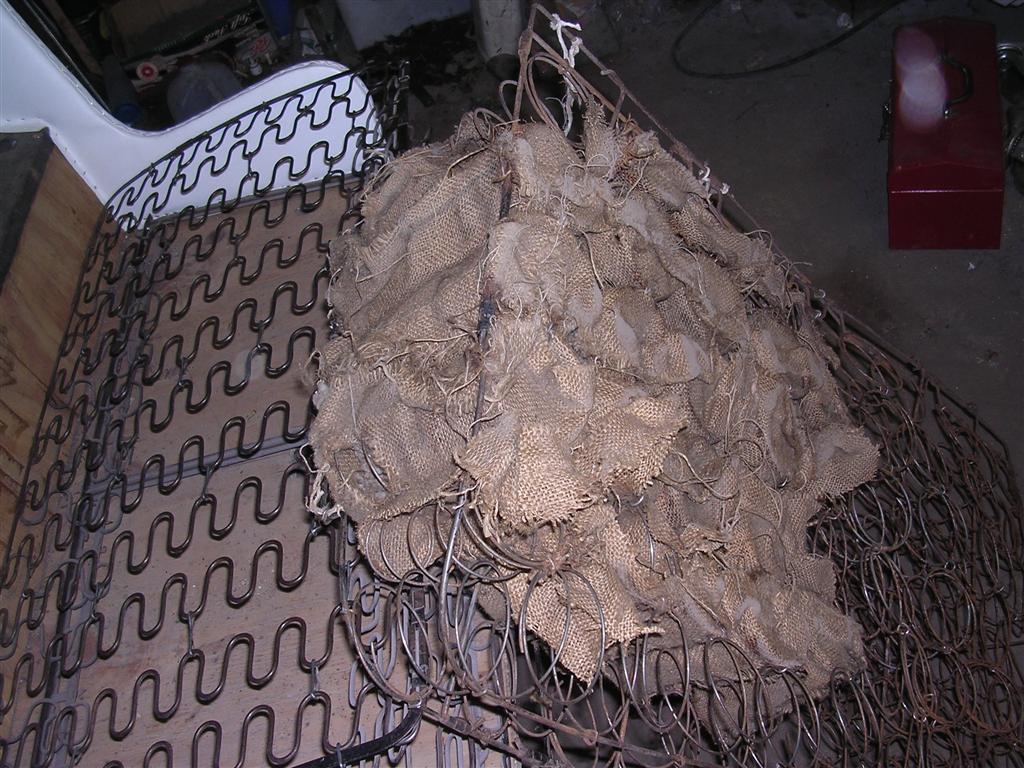

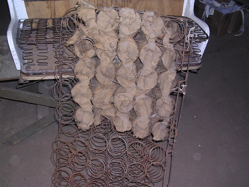

    Still not getting many hours in. I started stripping off the old burlap spring covers on the original 31 Caddy seat backrest. I am not going to replace these cloth tubes, as it's too much work. I will hand tie each coil like many cars had back then.
    The bottom cushion/springs were missing, so I made my own from a rear VW bug seat, and used donor corner band strapping/framework from Bug front seats to get the correct shape. That bottom will have 3" foam on top, instead of the 2" shredded coconut fiber/glued mat that VW used.
    Full foam cushions **** for feel, so that's why I'm using spring bases. The backrest won't have foam, just batting like original. It's comfy & soft. Someone told me to use a minivan seat; if I wanted that ambiance, I'd buy a minivan and sit in the back :confused:
    Off to Joanne Fabric last night for more white vinyl and some sewfoam. Well, they don't carry sewfoam, so I hoped they would have 1/4" foam to make my own, but they start at 1/2". I bought just enough 1/2" to do the center rolled pleated panels for the seat bottom and backrest. I glued cloth to one side and sewed up the bottom center panel tonight.
    I am trying to copy the center rolled pattern from an old 50s built roadster I had 40 years ago. It had the center panel done in rolls, and surrounded on 3 sides like a horse collar U of plain vinyl.
    Even though 1/2" foam should be tougher to work with, my lines are a bit straighter..... I scotchbrighted and waxed the lower base of the old sewing machine. That made the material easier to feed, and I also changed the way I hold the material. I was overconcentrating before, on watching the pencil line. Now I concentrate on matching the speed of the fabric to the speed of the machine, to get the s***ches more uniform length. When sewing foam, the walking foot won't feed the material without help.... But it will self feed 4 layers of vinyl no problem. learn, learn,learn...
    Ok, the seat frame looks scruffy on the tacked edges, but I will put Hidem welt on last, they did not stock that either, at Joanne's.
    I like working with this smooth running ancient sewing machine, and if you can find a strong machine like these, this sewing stuff is sort of fun...i think...

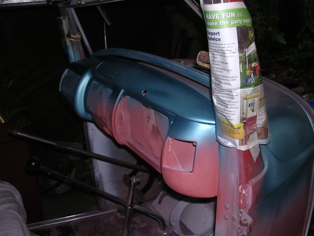

    I am waiting for white hidem trim to get here for the seat, so I started mixing my lacquer paint late yesterday.
    I ran out of natural daylight before I got to the color I wanted, and it looked wrong under flouresent lights.
    So, we had good sun today and I somehow made a dull drab ****ty color, look like what I wanted. It is what it is ;)
    Problem was, it takes a LOT of toner to change the color when you are close to the total amount of paint you needed. I was mixing in a new 5 gal bucket.....and I kinda got a lot of spare paint:D. Hell, I can even trip over a full gallon, and not worry.
    Ok, so the lower dash will be bright white, as well as the other small lower piece near the drivers side ashtray.
    ...and, I was telling Dave50 this morning, that I'm going to try to speed the body/paint up by not getting way too fussy with sanding out every last defect. This is a homebuilt, and I don't want it to look like it is all brand new everything, and looking too perfect.
    So, I will see in the AM, if I did not sand it fine enough, when it settles. Still need a few coats more tonight.
    Geez, I like working with lacquer. I used to have problems decades ago, but it's working ok right now...I think. Maybe I was thinning it too much back then:confused:

    in the first picture it looks green/ blue, in the next two it looks sort of blue leaning towards turquoise which is it? i like both so it does not matter to me and i think it will look great, and correct, with the white.
  23. F&J
    Joined: Apr 5, 2007
    Posts: 13,291
    F&J
    I don't know :D:confused:.... I was trying for a teal/turquoise, like would have been a bright color for the 1958-1962 Autorama builds..
    As you know we ended up with thunderstorms and gray skies late today. So the colors are under flouresents, flash, and some gray natural lighting. I'd say that the pic taken through the rear window of the whole dash, is closest to real, but it is kind of a color that changes with the angle of view.
    Hamber Earl Shieb helped me out twice with questions I had, about all the color mixing additives and polys. He said the (#310) "mixing clear" is mostly used with colors with poly flake content, and the clear "gives room for the flakes to be suspended in different angles". Sounds good to me;), so this morning I looked at the door I test painted last night, that had no mixing clear.
    It was dull, drab and lifeless...and too much of a light green 1970s look. I was so depessed that I even tried machine buffing the door, and it still looked terrible. I'll get a pic of that mess tommorrow.
    So, I then fixed the color blend with 2 types of ink blue toner, and dumped all the mixing clear I had, into the bucket...and said "f*** it":D. I hated to waste it, but it seems to work. I think that is what makes the color "flip flop".:confused:

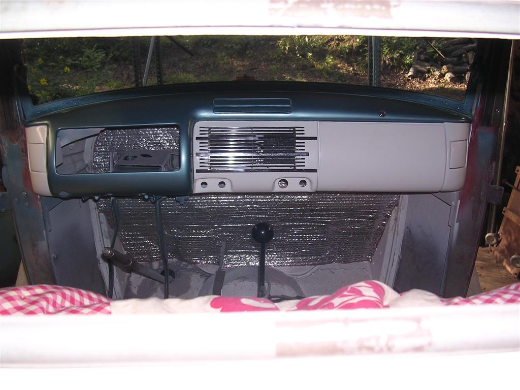

    Painted the white lacquer a few days ago. Also rubbed out the blue on the dash just a little bit. Need to rub out the white in a few days. That part goes real fast; no sanding, just Soft Scrub bathroom cleaner by hand :D
    Now, I'm doing a major clean up of the shop. Adding 20 feet of pallet shelving on one wall, tossing stuff, what a messy place :)

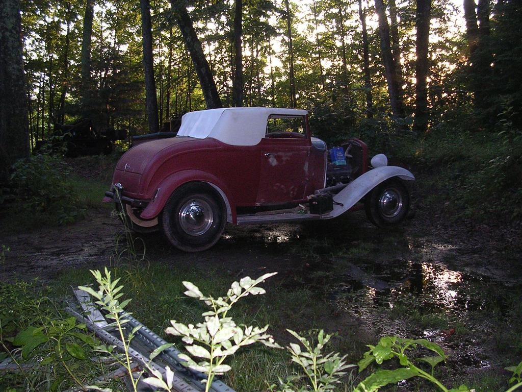

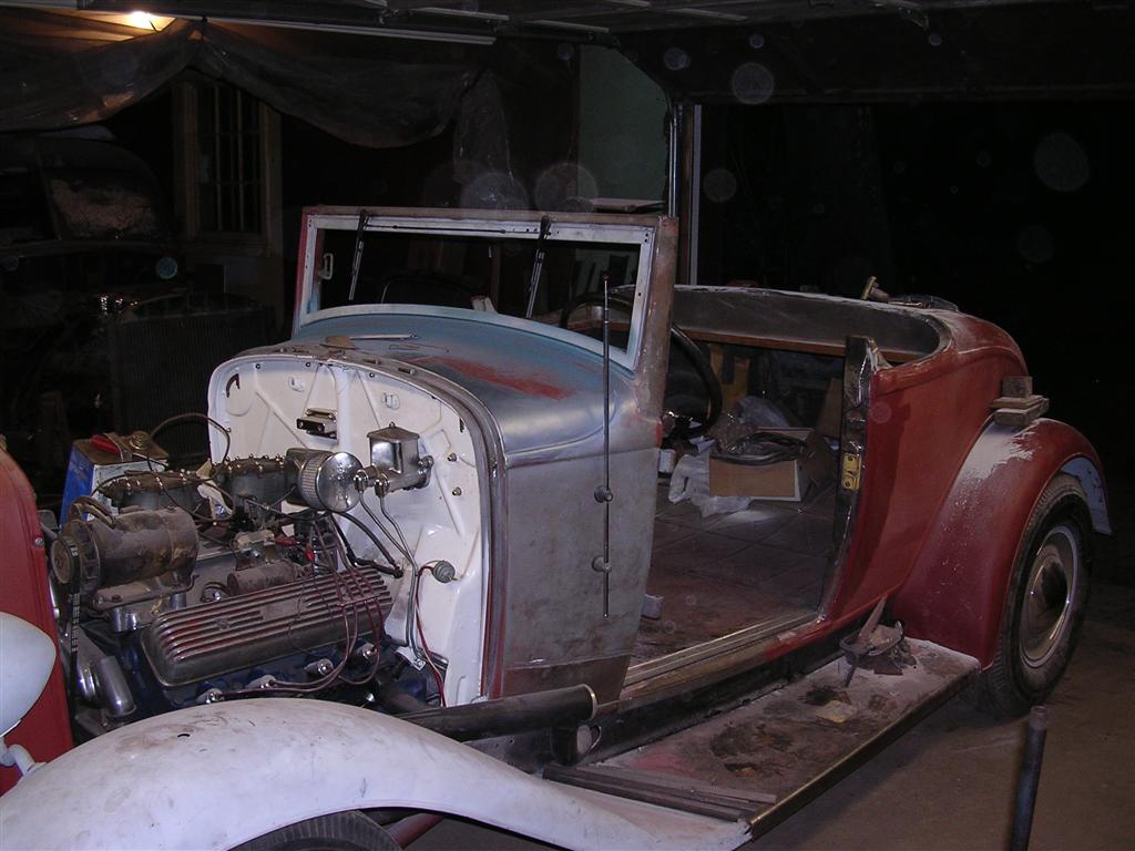

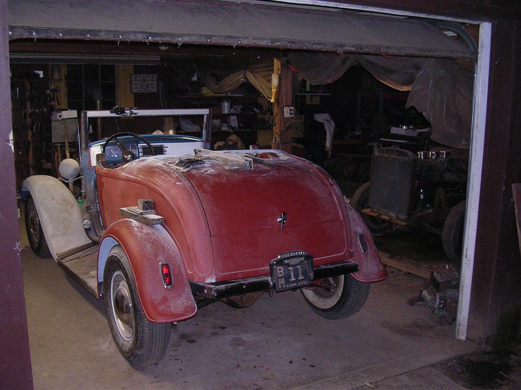

    Car is coming apart for paint. I dread this part, but it's the final push to get it done.
    I had to do some body work at the top of rear deck where the top fits on, and then when I fixed that gap, then I could take the roof off...and doors/interior out.
    One of the Boston Alter Boys was here on Saturday, when the car was still together and sitting outside. He said the color looked cool, and that there is lots of room when sitting behind the wheel.
    ...and.. that the car "looks a lot cooler in person". I guess that's a compliment :D
