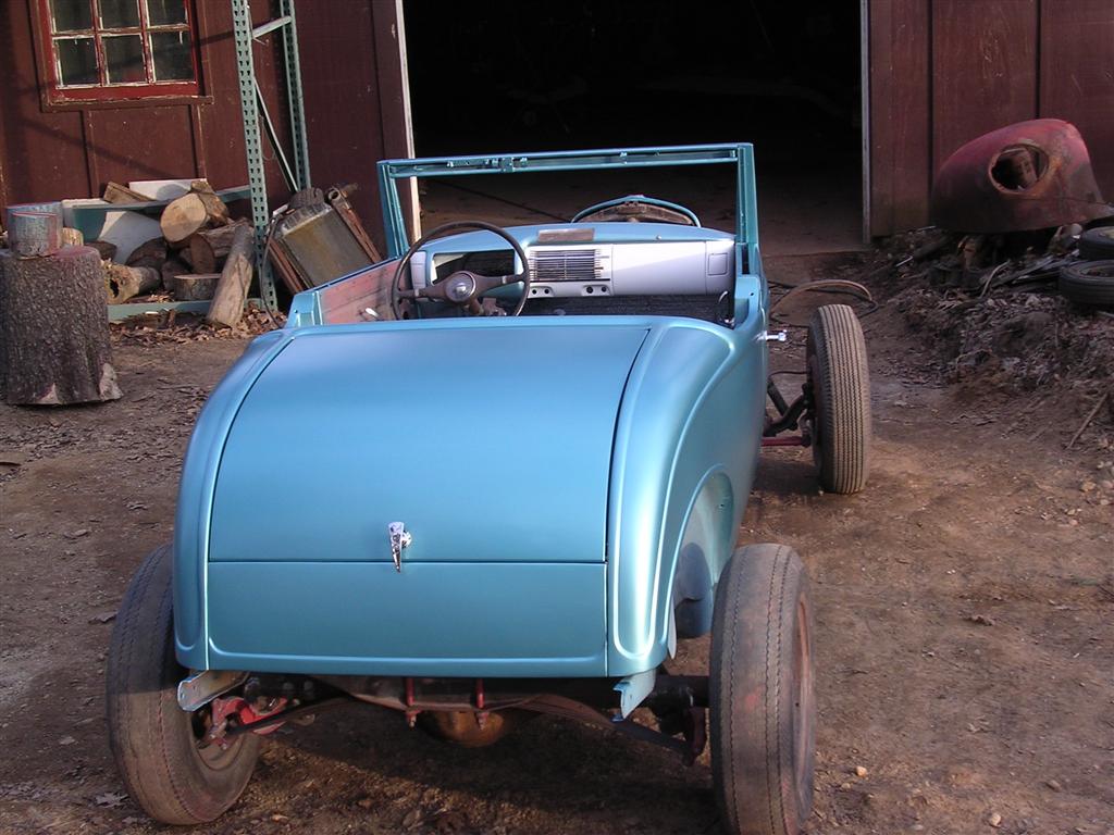

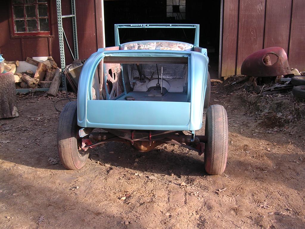

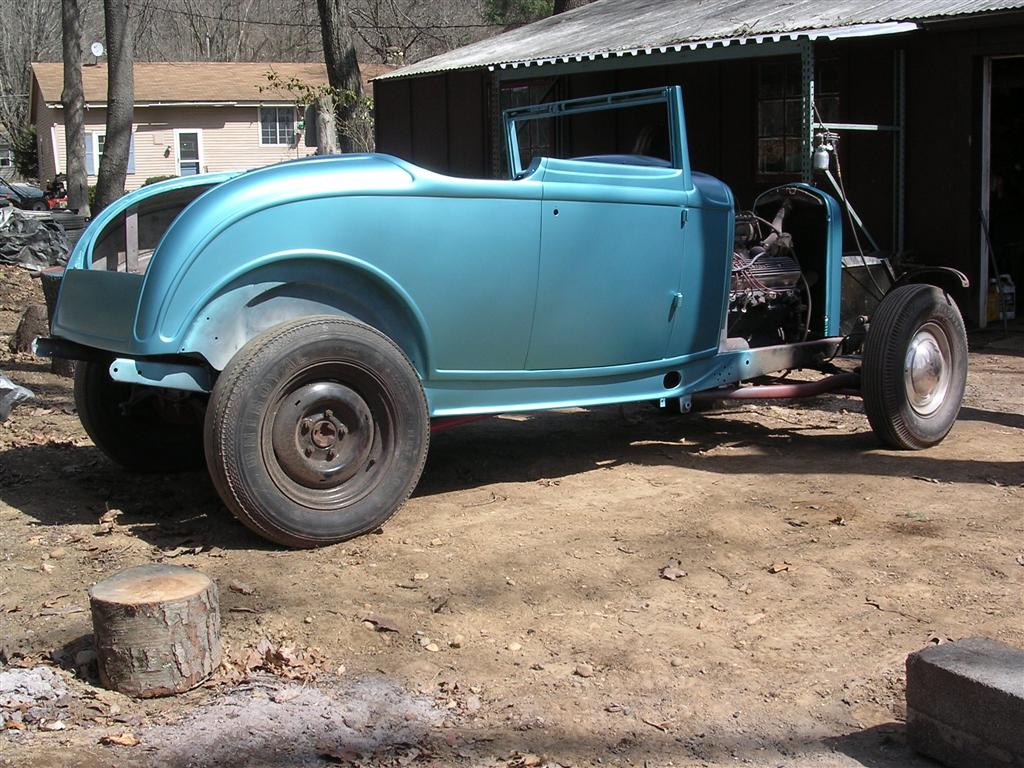

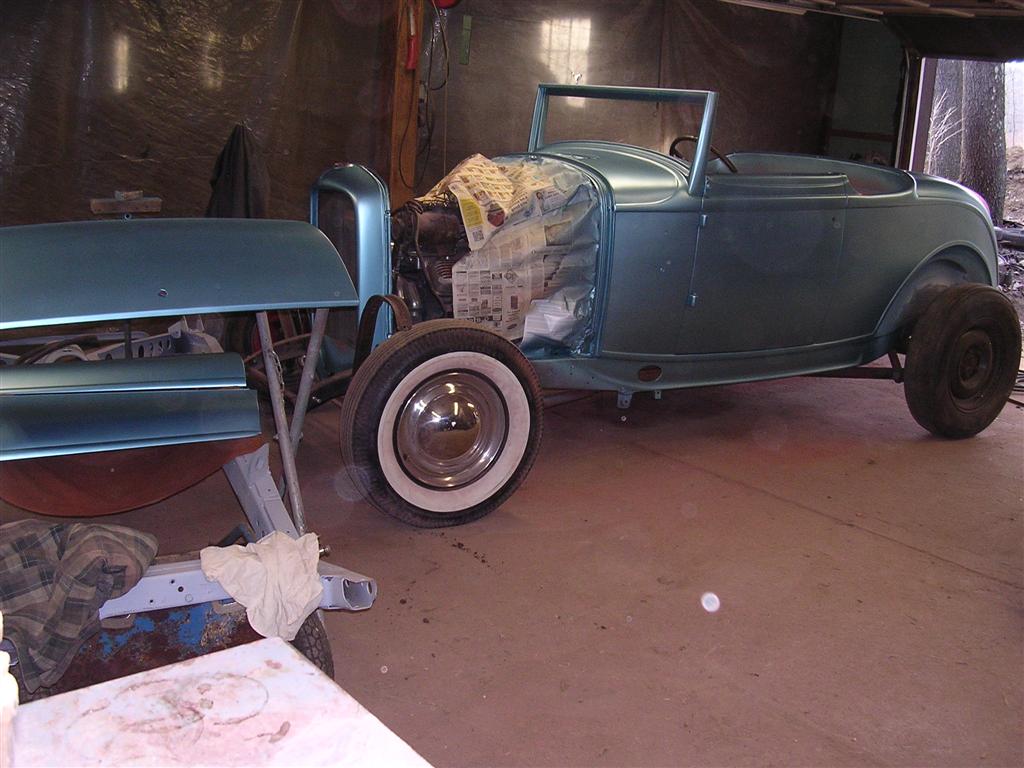

    I found out you can't do a laquer job using "compliant laquer thinner". I had the car apart, doors off, decklid and lower panel off, etc.. I figured I'd have less dry spots where you leave off.
    I picked up the gun at Noon, and went for 6 ****ing hours, fighting with the 100% acetone "laquer thinner". I started with small parts like cowl vent and went on to a door. I knew I was in trouble by the time I got to the opposite side of the door, the beginning was already dry. There is no way to paint wet-into-wet. Shade or sun made no difference.
    I was using a Binks7 and tried a bigger tip, had the trigger stop fully out, and tried different pressures all afternoon, with little improvement. I wanted to stop at the 2nd coat, but I thought I could get myself out of this mess. I do have some real PPG retarder left, but I did not dare mix it with acetone.
    Towards the end, it was getting to look like I could save it, except for tiger stripes; I even went vertical on one coat, but that gave vertical stripes.
    Out of desperation, I put the doors back on and hit both sides with very overthinned mix. That helped the stripes, but it dried way quicker, and the sides now feel like 80 grit paper. It was 6pm, and my kid showed up and said "park it in the shop, and think"

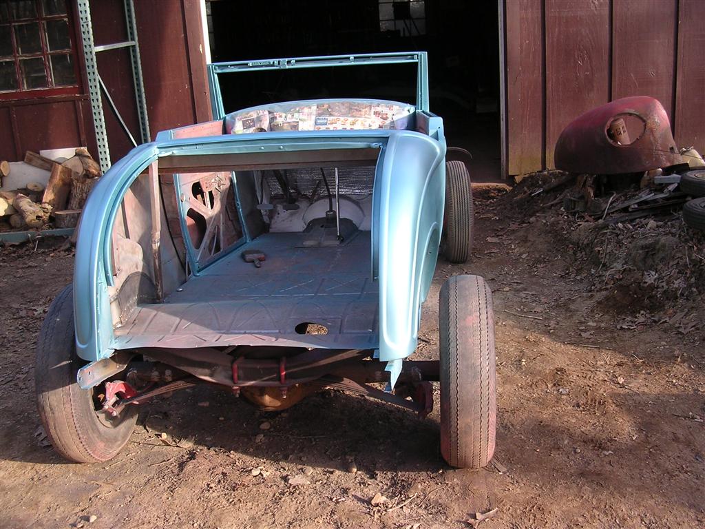

    See the outdoor pic where I slid the rear deck lower panel back on; it looks OK right? In the shop, I can see vertical stripes. (the one indoor pic has dust on the lens, so it looks like there is crazy spots on the car)
    I am not sure how to fix it.

    Looks good, love the color.
    jeff
  8. 327-365hp
    Joined: Feb 5, 2006
    Posts: 5,441
    327-365hp
    from Mass
    Man, that looks pretty good from here. Looks like it'll buff out!

    Looks good to me....Really like the color.
    color sand with clear coat??

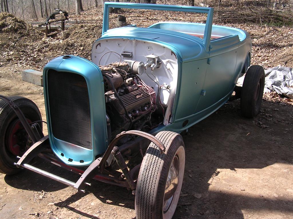

    Looks fine in the photos, but I do know how much internet photos can hide. Does it really look that bad Frank, or are you being too critical? Thing looks GREAT from here. The color is dead-on perfect.

    Loving the color Frank !!! To me it looks silvery blue where as the painted dash photo it looks more teal. Probably a lighting/camera issue. Good luck moving forward !!!

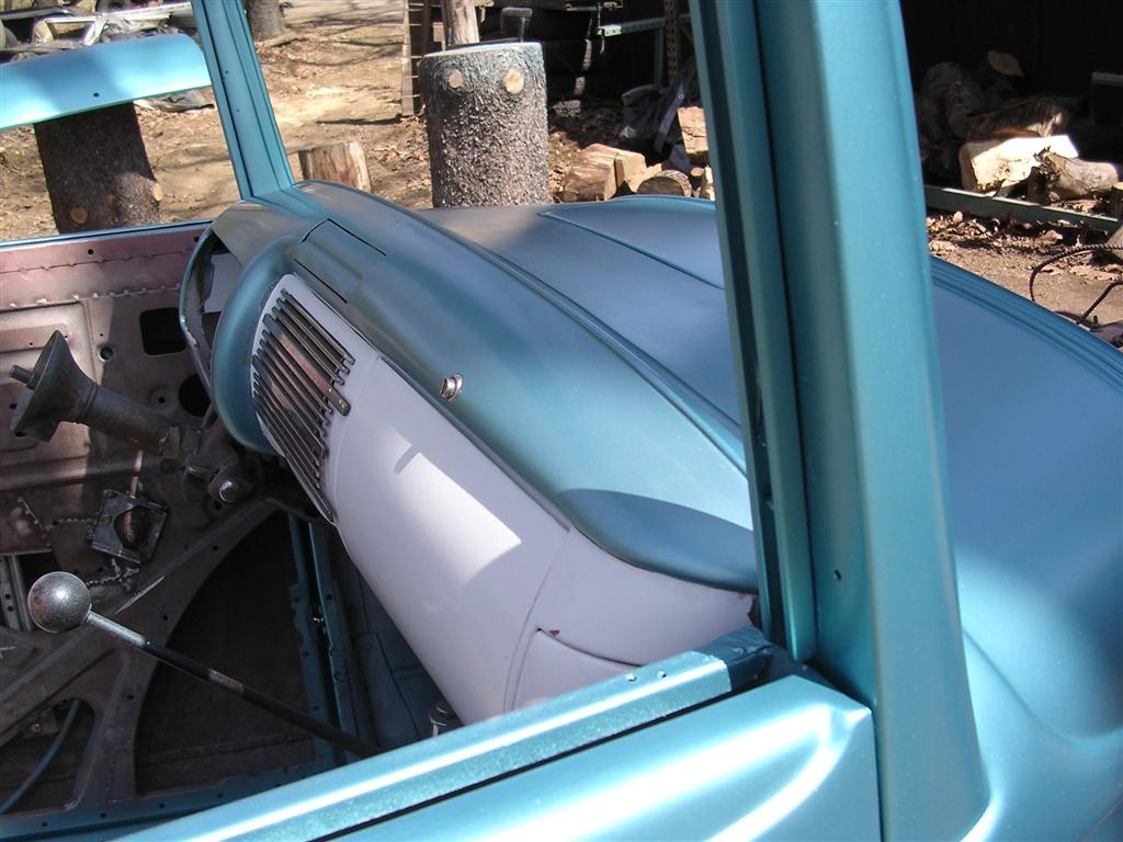

    The close-up of the top of the cowl and windshield post looks good to me, looks pretty smooth. Did it really go on that dry?

    Yes, I like the color also; I was after the 58-62 local small town Autorama build style & color. It's what I recall when I started with 1/25 model kits. Take a look at hamber Devin's roadster on the channeled thread; his also has a great heavy poly look.
    That close-up of the cowl is OK enough to use the SoftScrub cleaner, by hand, they same as I did on the dash. It ends up smooth, but not a "wet look" paint finish..which is what I wanted right from the start. That's why I went laquer.

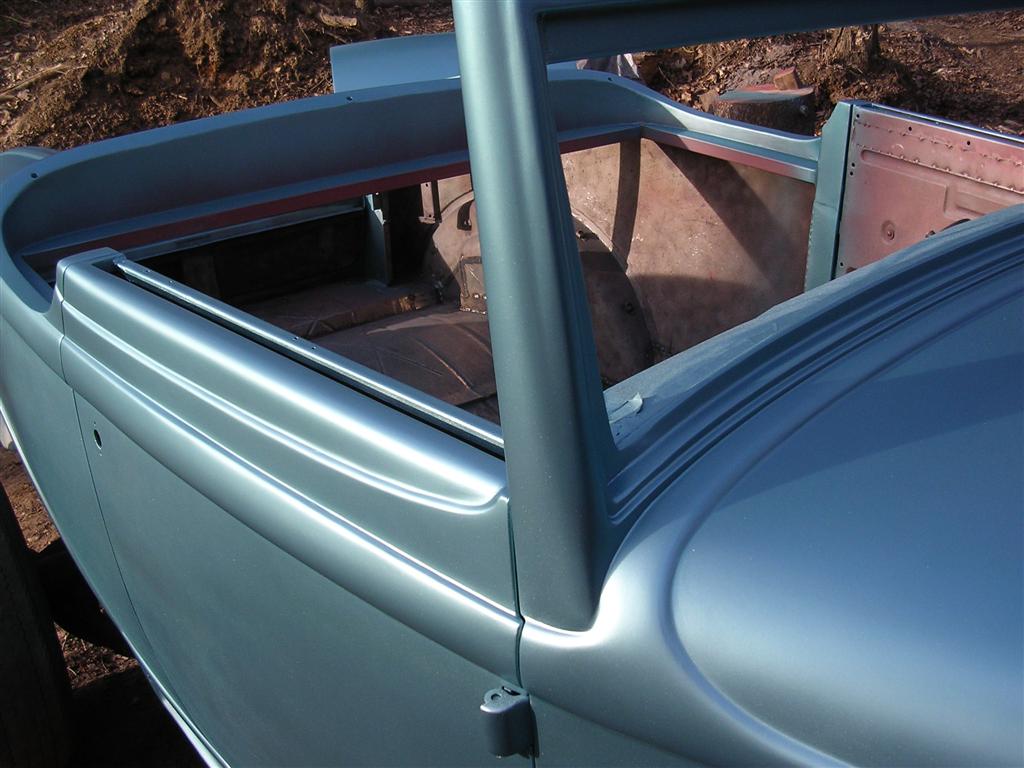

    Not being too critical; I just went back at 8pm to look at it again...the sides really are like 80 grit, no fooling. Very bad, and I think if I wait for it to cure, then sand, it will get blotchy. There is a TON of poly mixed in.
    Each coat, I would rub it out with green scotchbrite, because all the loose flakes. just like a metaflake job. Each coat added, made more "sugar" finish in the nooks and crannys like beltlines, inside corners etc.
    I have at least 2.5 gallons (un thinned) left:eek:. I need to think on this a few days, rather than charge at it again. Maybe tape the frame off, and also the beltline, and just redo the lower body sides that I hit with the thinner.:confused::confused:.
    Yes it went on wicked dry. You can't make a run, even with the trigger stop backed out. Take the radiator shell for example...I could not get the whole thing done without dry areas, no matter how I went at it. It dries right behind the p*** you are making. Sun or shade.

    Yes, by what you are describing, it sounds pretty bad. It can look a hell of a lot better in on a computer screen than it does in person. Can you get proper thinner? I'll pm Rich Wright, and send him a link to your thread, see if he can chime in here. Lots of poly(metallic) with too fast a thinner is about a worst case scenario.
    By all means, hang back until you really have a good plan of attack. If its that rough, color sanding it is gonna be trouble, it'll probably go blotchy on you. In the meantime, maybe consider setting a couple pints aside and let the poly settle out, save that for the finish, thin it with a slow thinner, and lay it on wet. But first, lets see if we can figure out a way to save whats already on there without having to strip it back completely. How much pressure were you using?

    Well, I almost pulled the tape off last night late but was tired. Setting on the porch this morning, I remembered asking hamber Earl Sheib about a full case of Ditzler "color blender" that I got with all the paint stuff. He told me a few things that is was good for, and said it's "good stuff".
    Well, I tried to remember:rolleyes::confused: ..so I experimented with straight blender which made a mess, then added some color which was better. But It acted so different that I changed inner nozzle size on the gun, and was able to go way low on pressure...now getting a great fan and wet-into-wet.
    Still has the issue of poly flakes flying around and landing, so it ain't perfect. I don't see any stripes at all.
    BadPenney was right on the dash color. The dash is lighter, and that is because I hand rubbed, which knocks the color off of the top flakes. So, who knows what it will look like when I rub the body down later.

    The car sat inside right next to the wood boiler all night, and it looks much better now for some reason.
    I walked in there this morning without turning the lights on, and there was a "glowing object" in there, wow that is a lot of poly flake:eek:
    I did take another pic at dusk late yesterday after I got the trunk lid back on. Yesterdays recoats were 3 more on the main body and about 6 or 7 on the back lower panel and lid, but it seems to match ok.
