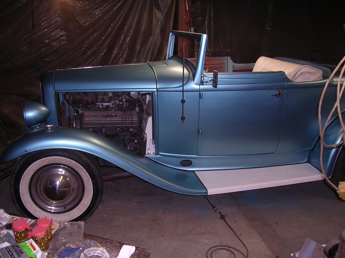

    I haven't rolled it out to see the shrinkage yet, just finished a small job for a guy. Maybe this afternoon.
    I am pretty sure I will have to use 2 grits, depending on what happens. I am ***uming I can stop at 400?
    Anyways, my plan is to do the recoat well thinned with the right thinner, and I hope it will be smooth enough for hand rub. I don't want wet look. My old speed parts and old chrome just won't look right, if the paint looks too showy.
    I wish the bright teal will stay, but I think that is impossible. If you saw the last single pic of the back of the car, you can see the "lightly" hand rubbed teal on the dash is more of a bland color, as the excessive poly loses it's cover. Oh well, maybe the washed out teal will fit better with the old parts..

    I'd start with 400 (unless its really rough) and see how it looks...maybe hit it again with 600 prior to recoat. Whatever it takes to get it as smooth as you think it needs to be. Remember..the courser the final grit, the higher the probability of severe sand scratches showing up, which means the harder it will be to get the finish to lay down enough to be hand rubbed.(which I'd never recommend anyway unless your arms look like they belong on a gorilla;))

    Speedy, the paint looks the same, the sand scratches and a couple tiny waves are still there ;)..
    The color on the frame sides is all that the frame needs for that color. The other parts of the frame will be enamel black or satin black.

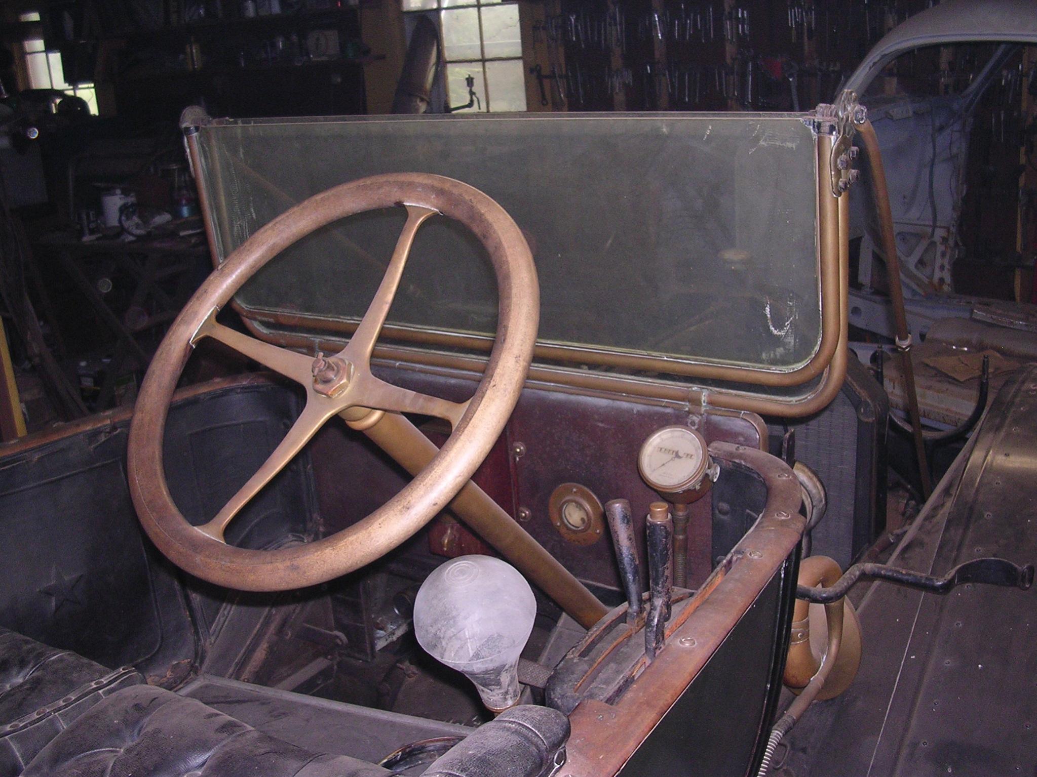

    I tried doing the final blocking on one rear fender yesterday, but 10 minutes later a 101 year old car showed up for some work.... I don't think I will ever finish my own stuff.
    I took a pic of the "selector shifter" just for you:D...It's on the top edge of the fake driver door.

    You always have cool stuff rolling into your shop! That selector shifter seems to be a bit different than the ones I have though. :eek: haha

    Not quite what Lokar or Genie makes - is that a 1913 Buick?

    1912
    it is hand crank only
    no battery
    acetylene lights
    no front brakes
    rim diameter; 27" :eek:

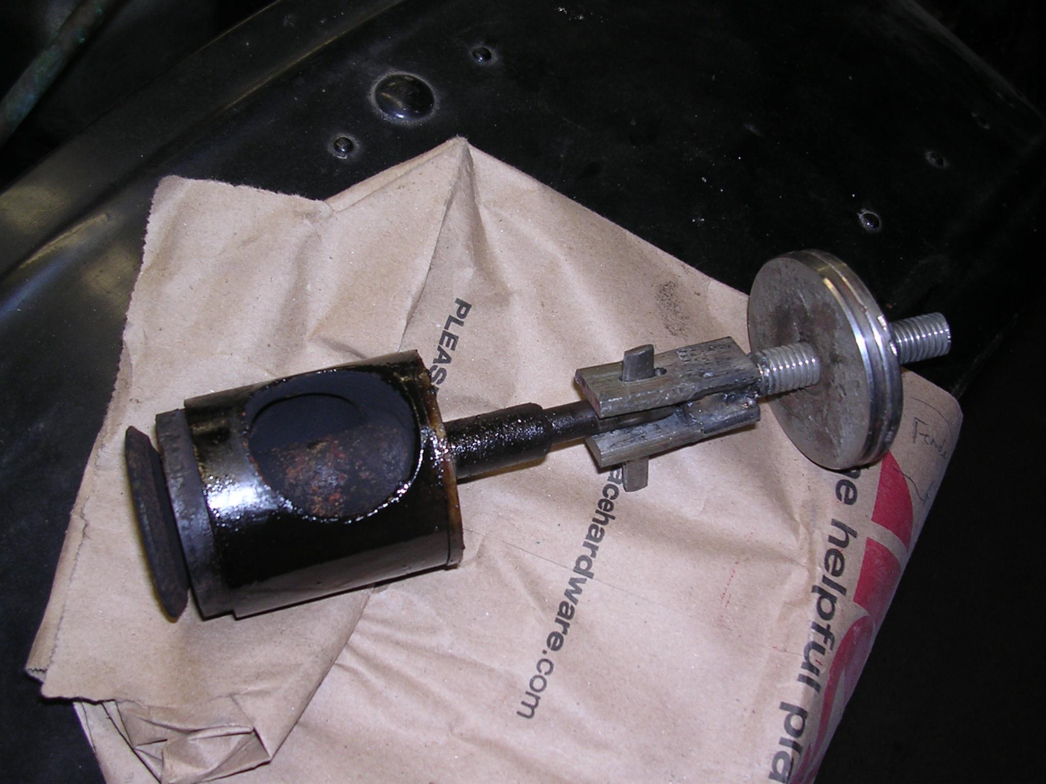

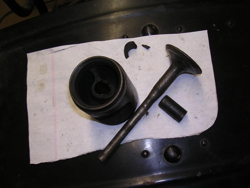

    anyways, it sat since mid 60s; 2 stuck valves and one smashed/broke the guide and bent the valve. There are no cylinder heads. Valve sits in a spool shaped cage piece. I made a puller today and got them out, might get it running tommorrow

    Way cool. Are the br*** caps on the rocker arms oil reservoirs? Trying to figure out how things stay lubricated.
    And the only 27" rims I've seen, they are off a "Donk", right? Not Hamb material at all, they have or go. (Ok I looked again. No chrome, they can stay). :)

    Sort of; they are grease cups. Fill them with grease, and barely screw the covers on, about one thread. Then after X amount of miles, you screw them in one turn which pushes a bit of grease into the rockers.
    The rest of the valve train gets hand oiled. There is a bracket on the firewall to hold the old type oil can.

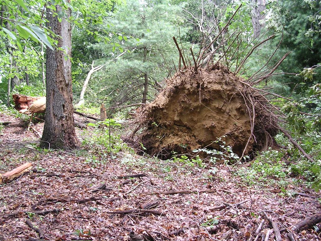

    :rolleyes:Sorry the only pics I took recently, is of last Wednesdays F1 tornado that came right over my place. First pic is a news picture showing the funnel right at my place, viewed from 1.2 miles due south of here.
    Other pics show some of the bigger trees that came down on the north side of my shop, about 50-60 feet from the shop. They blew down parallel with the shop, so I only had one minor hit on the building. 8 cars are in that building.
    I never heard these huge trees fall, that tornado noise that people talk about is insanely loud as it hits.

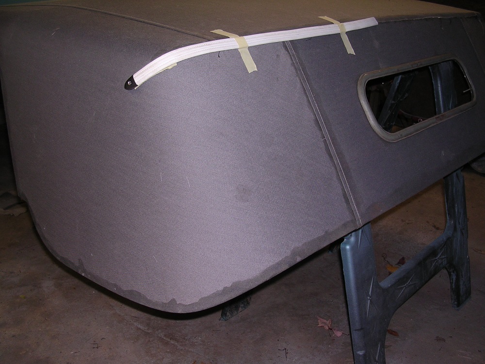

    I ran out of patience trying to bolt the p***enger side back together, so I started thinking about how ugly the steel roof was in white paint. There is no way I can send it out to a pro shop to have a cloth skin put on $$$..
    So, I had some thin grey cloth that the mice haven't found yet.. I know my limitations with sewing a top together and have it fit. So, with little to lose, I decided to fake it, by making individual pieces with sewed edges, then glue each section on the roof, one at a time.
    I started with the two side pieces that wrap around the back. These have no s***ched edges. Then I made the back window panel and pre-sewed the side seams with a hem, then glued it over the side pieces. Then, I made the large center piece, with it's two long side seams, hemmed and s***ched, and glued it on.
    Then I will use some white Hidem welting across the rear bow, capped with the chrome end caps I was given recently, by an 82 year old restorer friend who is disposing of his stuff.
    The color of the cloth comes next...
