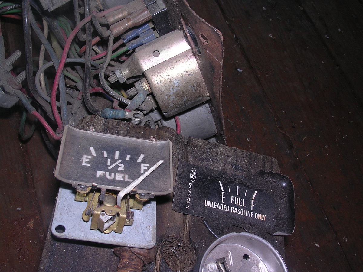

    I need to use a 70-ish Ford 30 OHM gas sender like this one, but all I find are Tiawan made.
    I will keep the Cadillac sealed filler cap, and use the Cad fuel pickup line, but I will modify the Ford sender fuel line to be a vent hose to run outside of the trunk.
    The gauges are 46-48 Plymouth, and I am using a Techweek thread from Kevinsrodshop to use 70s Ford pickup gauge guts in them.

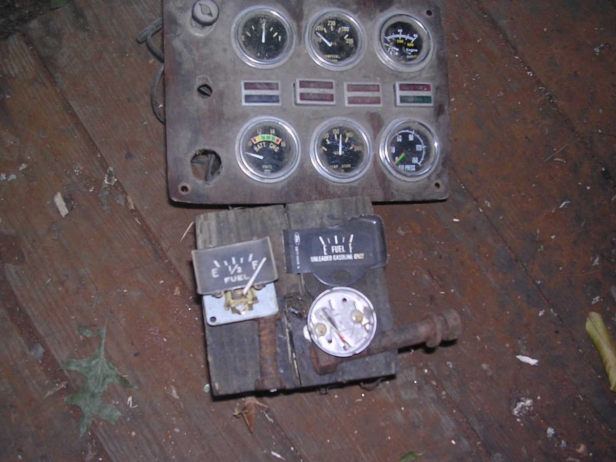

    I worked on putting modern guts in the gauges like Kevinsrodshop tech week thread shows. Crazy Steve answered my question on there, on how to wire the 70s Ford truck amp meter; him saying it would be tough to match the Ford resistances in a shunt type gauge. He suggested a voltmeter instead.
    In my junk I had a panel from an 18 wheeler I posted a pic earlier, with a SW voltmeter.
    I wanted something showing on the old Plymouth amp face, to remind me where 12v and 14v was on an "amp" face. I ended up cutting up the thin aluminum face of the SW, and grafting it to the back of the Ply clear see-through amp face. Fuzzy pic but it shows what was left of the SW face in foreground.
    epoxy is used to bond the old face to the Ford or SW gauge "can".... Just like Kevin does.
    not shown is the new square steel mounting plate with the two terminal lug holes in the proper place, to make the gauge centered in the Plymouth cluster. You can see the old rusty ones there.

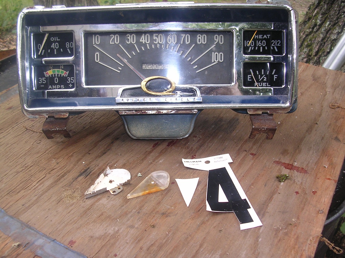

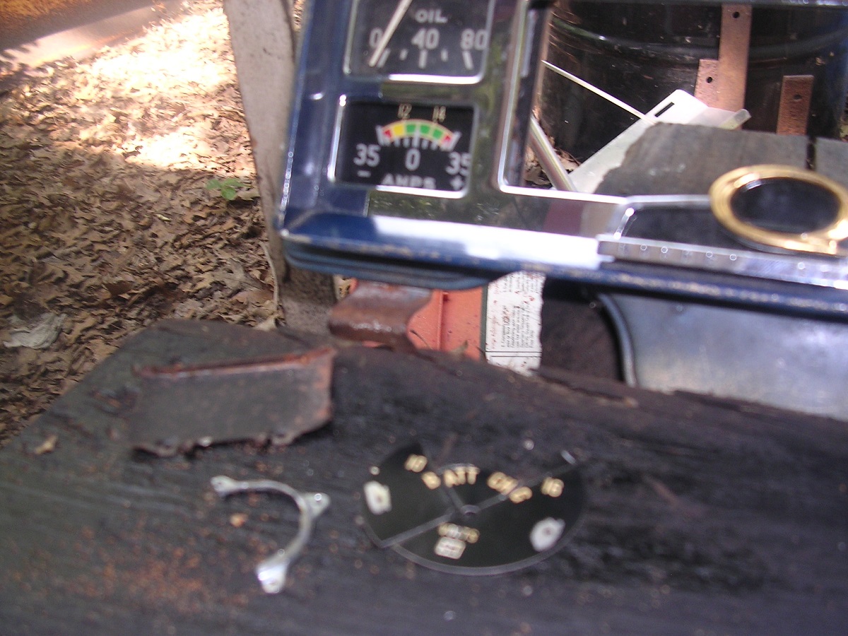

    I think I spend too much time on odd things.. :) When I bought that Plymouth cluster at a swap, I did not know what car it fit. My elderly friend told me it was 47 Plymouth, but he also followed by saying: : "That's the ones where the speedo needle changes color, the faster you go". WTH.. :)
    Hard to show all the pieces that make it change color, but in this pic foreground you can see a pointed tin tray painted with luminescent? white paint, and that pointed clear prism fits into it. One dash light bulb sits right near that prism. It funnels and magnifies the light to a very tiny beam that shines on the round clear plastic hub of the needle. On the sides of the hub, are three bands of see-through color, and those were faded badly.
    I used whatever I had for a see-though type paint a couple years ago. I tried repainting the flaked up white with flat white yesterday. I tried it at night with poor results. I could kinda see the base of the needle change color.
    Last night a brain storm hit. I had found a hardware store "mailbox stick on number" outside last week, something leftover from my son's boat numbers. Hey, I don't throw stuff away, so I figured to try cutting the super reflective white from that unused sticker to reline that tin tray...hoping it would work a bit better..
    I just now tried it in the dark trunk of the car where the battery is, with shop lights off. I had to LOL when I spun the needle higher....the needle does change color, but the whole darn speedo graphics of numbers and lines, all REALLY change colors.
    I was thinking Cheech and Chong....."OH, WOW, man"
    Forgot to explain the colors: Green is low speeds, Yellow is in the 50s, and Red is faster.
    still have to repaint the speedo black backround and detail everything...but it's pretty darn cool

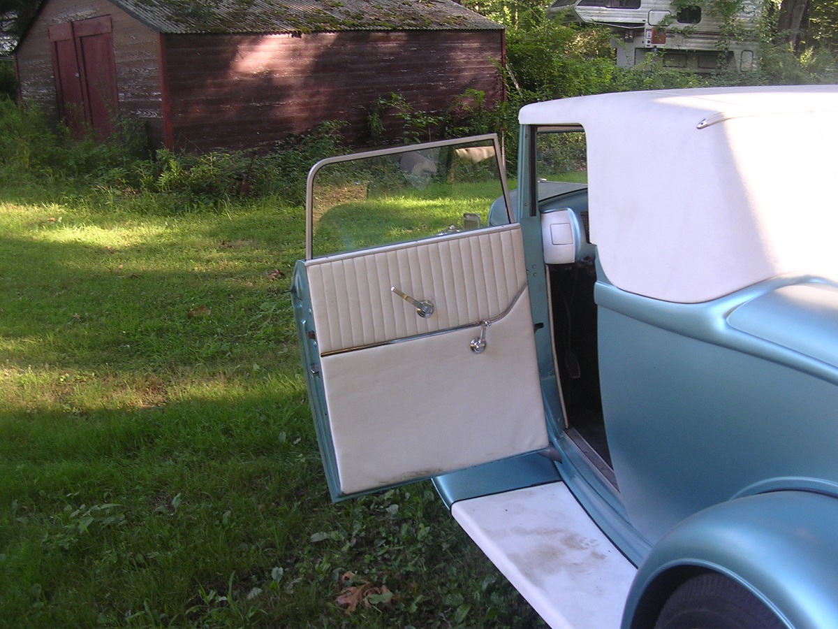

    Gl*** shop finished on Wed, so I've been installing. Also paint inside doors, add sound deadener tar/foil stuff from Home Depot, then go find my door panels in storage. I had cut the thin curved stainless panel trim from 37 Ford hood trim, but now had to "finish" the cut ends like a "capped" trim is. I can't hold the torch and silver solder steady anymore! "golden years"
    The old upholstery glue came undone, and got smeared on this panel, but everything needs a good cleaning anyways.
    Having trouble with the NOS Trico dual wiper kit that converts one vacuum wiper to twin blades. I guess I never figured it all out when there was no windshield gl***. The gl*** is One Dollar height in center, as a friend tried that. I have no dollar to try. :(
    It was too hot/humid to work, but I told myself if I do something today, I get to drive it outside for pics. It still runs..
