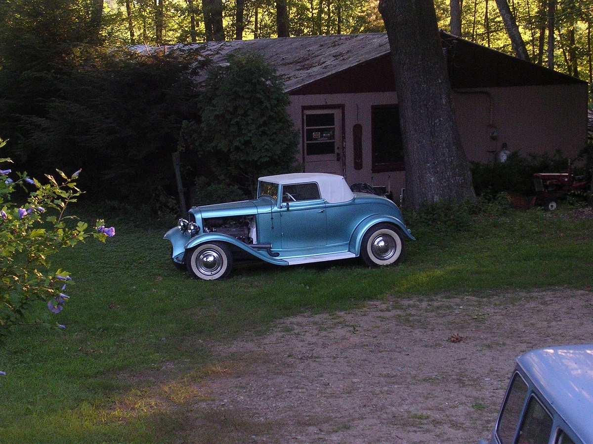

    Someone just posted the exact Hot Rod magazine pic from 1951, that I tried to copy/mix the color for mine. I never was able to get the same teal look, but close enough I guess...
    I think those headlights in the pic are why I wanted chrome ones :)

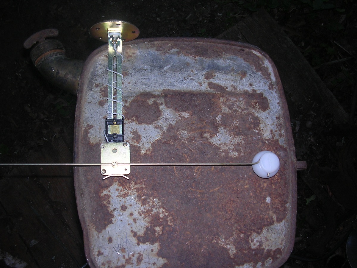

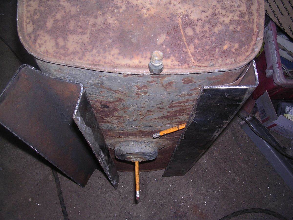

    Working on the teens/20s Cadillac gas tank today. Last night I did look up the prices for a new tank in a size close to this 20 gallon. They were $250-$300 plus ship. So that's not going to happen, as the only way I got this far in life, is by saving pennies and dimes where I can.
    So I ***embled the new sending unit loosely to adjust the things to make it go from 14 to zero inches on the depth. I laid the sender on the end of tank. It has to swing front to back direction, not side to side, because there are 3 compartments in the tank.
    To not have the float hit the front end of tank at 1/2 full, the sender needs to be mounted very close to the back edge, But the tank is a "puffy rectangle" and the sender would not sit flat there.
    So I had to make a blister thingy to weld on the edge, to make a flat gasket surface. I used a piece of .120 gauge sheet steel so it would not be a flimsy gasket surface, and easier to weld to this thick tank metal. I was going to try to use the hydraulic press with a wood form. That was too much setup time, so I used this steel cylinder thing, and clamped it in my big bench vice, bending over a couple inches at a time, then rotate the part again, and again, till done. I started with a guess of a oval shape on the steel, and I guessed good. (for once, lol) :)
    In that last pic, things are pretty busy looking: I had to put the sender hole in one of the 2 compartments that had some way of peeking through another hole, to see if the float ball went far enough in both directions. I could not put it on the far end because there are no other holes on that end. I can't use the middle because I wanted to keep the original Cadillac mechanical gas gauge, so I can watch it's needle dial when I fill the tank, so I don't overfill into the trunk. :)
    ^^ here you can see:, the filler, the new sender mounting, the old Cadillac sender with cork and br*** dial, and the gas shut off valve.
    If you look at the very back edge of tank, near the shut-off body, there is a short br*** line that used to be where the compressed air filled the tank. I will use that line for an external tank fume vent hose.

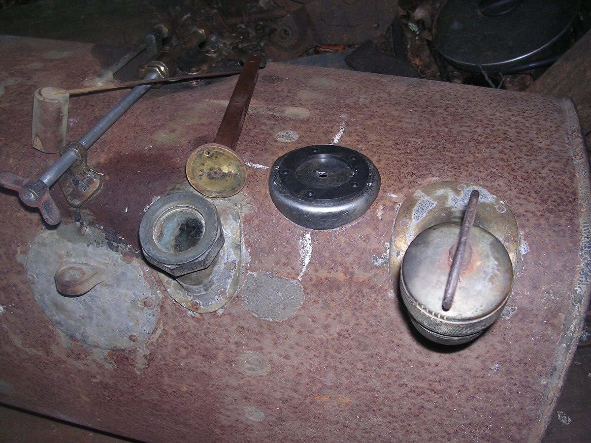

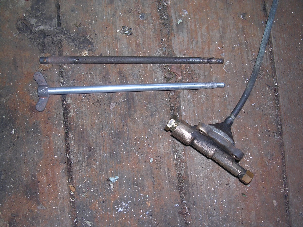

    Here's some shut-off valve parts. I don't know if it's the 4 weeks of stupid hot humid weather, or me getting dumber each day, but I thought the tank sat so the valve body was at the bottom side of the tank. DUH, I had it 90 degrees off the first time I showed a pic a week ago.
    So, when I still thought the tank valve was down low, I figured I'd better rebuild the shut off, in case the fuel pump or something started leaking, and would drain the tank. The old long needle shaft was steel, and rotted/pitted at the sealing gland nut, and the needle end was not any better. I had 3/8" aluminum stock, and no steel, so I chucked it in my old lathe to cut perfect straight threads and cut the needle. Geez...I start the thread cutting, and said: "that sure looks odd"... the threads were LEFT HAND :p.
    Tried again after shifting lathe gears, and I almost had it done and the bit dug in, and bent the 2" sticking out of the chuck...3 friggin times! So, I had to go look for a dead center, then drill a pilot hole for the center, and then, duh, it finally cut like New York, and fast.

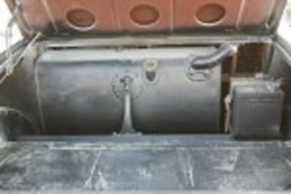

    Very slow progress on the Cadillac tank install. So, some old history on these tanks going back to the early Dry Lakes Racecar days.. :)
    I guess the racers liked using hand pressurized fuel systems, as we've all seen them on old dirt cars and others. If you follow 1940s Lake cars, the Jack Calori roadster would be right up there at the top.
    I found two pics of a Cadillac tank in that car. One seems to be a very early pic. His tank is a different year than mine, because his has a bolt-on fill neck pointing to the right side. (or maybe he made the neck bolted?). It looks like he moved the tank to the left, to get the filler up through the rear deck panel? It still must have been hard to fill it at the Lakes with a 5 gallon Jerry can.
    His rear center tank bracket is a triangle shape, might be stock Cadillac, and my homemade bracket came out looking like a triangle, too. I did mine like a triangle because I thought it needed some sideways strength, and I had not seen this pic when I did mine. Here is another pic, from a different time, below:
    And here is a pic of mine, late today:

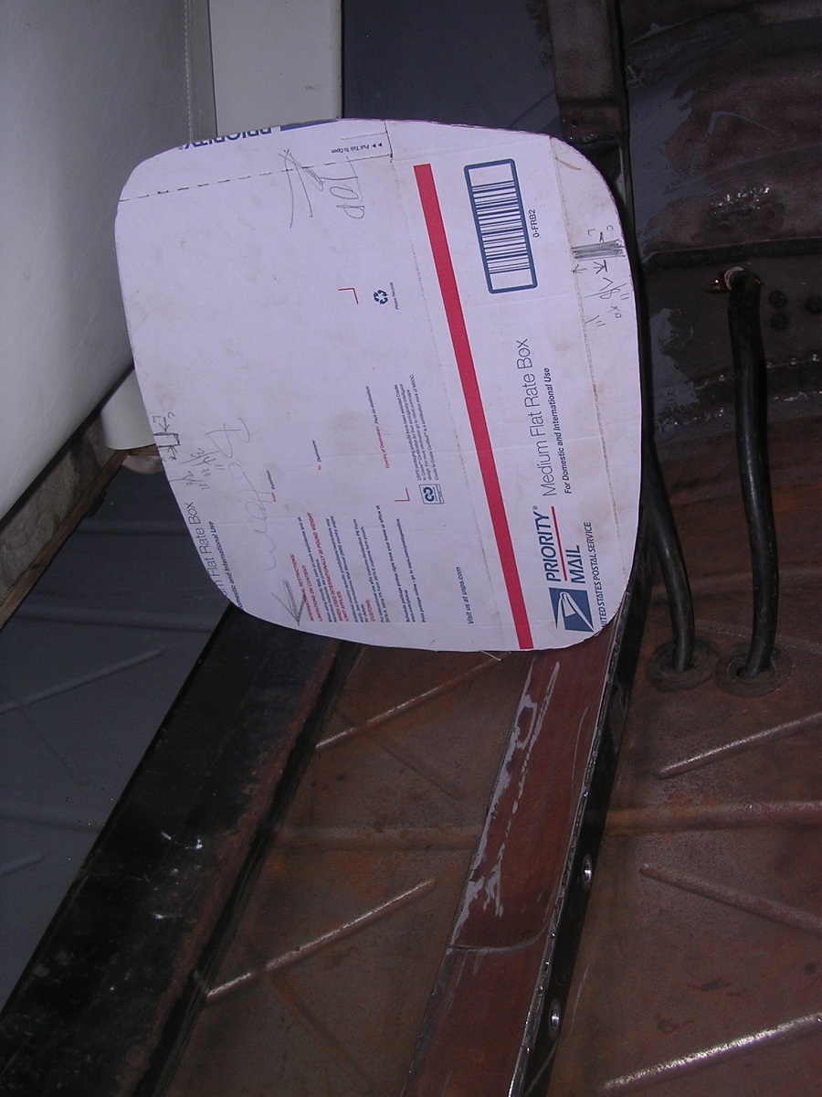

    .....what A pain to make floor saddles of different heights for the very slanted floor. To make it harder, there is a extended sump sticking out the bottom of tank, so it's impossible to test fit it, unless you cut the 4" hole in the floor first. But how can you cut the hole if you don't know where?
    Here is a pic of the 2 different saddles. Both made from slicing up a 3 foot, 1/8" thick 3-1/2" square tube that once was a rear frame crossmember in the old ch***is. The rear one is just an L slice, but then I added curled strips of 18 gauge to make a saddle shape. The front one is 3 sides of the tube, but I ran it through the press to make a curved saddle. These will have rubber strips or felt glued on, and will be welded to the floor.
    Here is a template I used to try to get the location for the tank saddles. Of course, I forgot to check if the seat was all the way back ...lol. After cutting the tackwelds several times, I had to finally cut the 4" hole in the floor, because it won't fit right until I do. (I did want the sump drain under the car, not in the trunk). Also, I had trouble guessing if that the template was level... with the angled floor, angled back of seat, and the rake of the car. Very misleading, so I had to later make a level line on that template to be able to use a carpenter level on it. Then keep moving the floor saddles to get a good fit, and still be level...arrrgh..
    A sharp eye can see that there are two battery cable holes in the floor, and the final "tank in car" pic I posted 2 pics up, shows that the forward cable hole had to be filled, and the tank moved back.....because I finally figured out the seat was only 1/2 way back in this last pic..duh
    The front of these tanks have two mounting brackets, one at each end, almost to the ends of tank. The J-hook is made from 5/16" stainless, so I know the hooks are pretty strong.

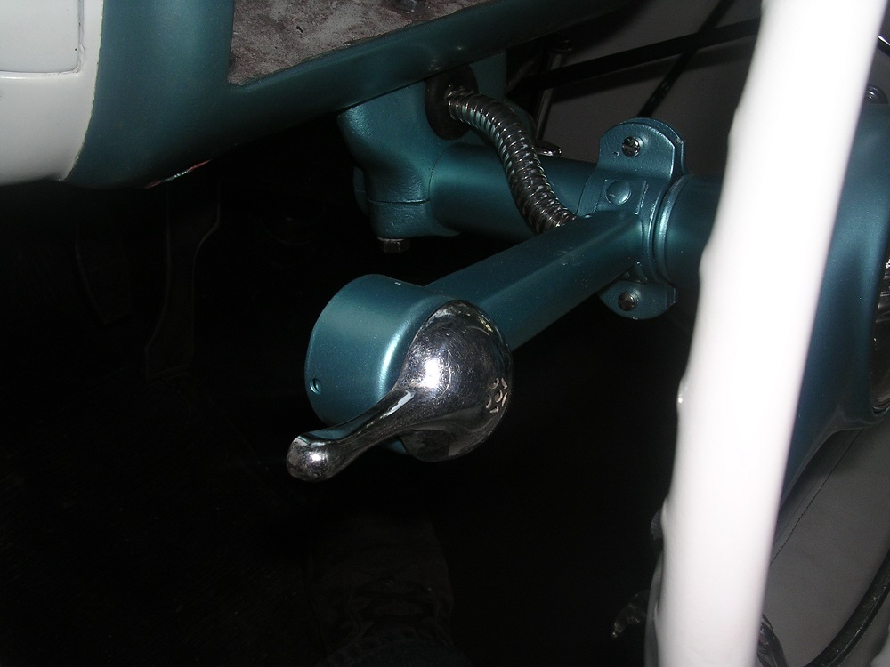

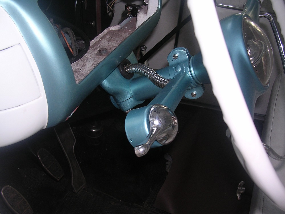

    Wiring is the last major thing to do, so I started putting every old/nos/hand-me-down electrical parts saved over the years, spread out on the floor. I got a LOT of stuff ...lol..some good some bad, some ugly, but most all was free.

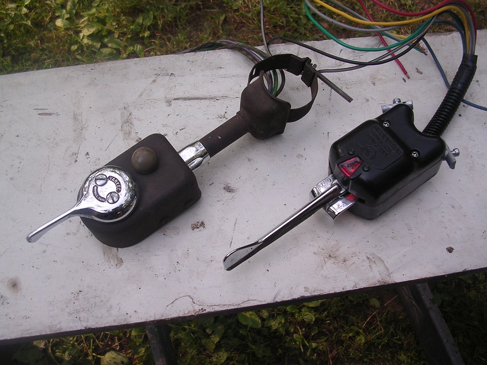

    I had planned a long while ago, to use this old switch for turn signals. But I took it apart to find it has a built-in "flasher coil and points" and is maybe 6V. Then I took the repro switch apart to see if I could swap in the modern "7-Wire" system, compared to the old "3 wire" in the other. Nothing will fit.
    I could have just used the new switch, but just holding it on the column, it just looks like someone got lazy at the end of the build :) . Geez, I detest new stuff with a p***ion, it looks so ****py and it will be right in my face.
    So I had to steal the old Deco one that was saved for my 32 Nash. I tried cheating by spraycan white, but it looked awful placed on the column, so I did spray it in body color.
    It's a 3 wire also, so I will need to use a "electronic trailer converter" to use a 3-wire with only two filament tail lights.
    I had some stainless flex conduit from a s****per friend, so I tried that through the former column shift hole in the column bracket....with a reshaped grommet. I thought it might look gaudy, but I think it looks fine.
    I took the switch body apart to remove the 3 position crimped switch to clean it's contacts/lube/test. It has a tiny bulb under the chrome lever beehive thing.
    When I had the switch contacts all apart, it looked like the bulb can't work, because it gets power from the main flasher wire. That would try to make the flasher work all the time...I thought?
    After I recrimped it to test R & L sides, I also tried testing the bulb contact. I have no idea why, but the ohm meter shows the bulb does not have power in center, but does have power on left and also right. I don't know why. I must have missed something in there?

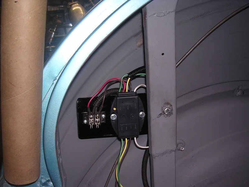

    Update; I am mostly finished with the homemade wire harness/installed. I only need to add wires to the rear marker light.....and in this pic you can see a two terminal "wire attaching block", next to the trailer converter box in the trunk. (the converter allows use of the old fashioned 3 wire turn signal switch)...with the 41 chevy rear lights
    I put that terminal block there, to tap into the taillight wire, and also the wire coming from the brake light switch before it enters the converter. (my son is going to make my marker light housing into a combination marker/3rd brake light) So the block gives an easy hook up.
    You may have seen my recent thread about getting this converter to work. I found out that you cannot test these with only rear lights hooked up, but hadn't wired the front signals yet. Now it works great
    here is a old pic showing the rear marker light housing. Can't see it very well. (that's a reminder-note to check the gear oils, taped to the marker light :) ) It was once a rear tailgate emblem for a 1940s Olds Woodie, and was never illuminated. My son is going to remove the plastic lens, and use red translucent plastic, then build a wall between the marker light bulb, and the 3rd brake light. The extra brake light might give me a better chance with the texters out there?
    I did find so many neat things to help wire the car, given to me by a 82 year old friend who retired from restoring hobby cars. I found this handy 5 wire quick disconnect plug. It sure makes it easier to string wires to the removable dash and not worry if they are long enough, or waste time under the dash hooking up each wire you run in the "rough-in phase".
    I only needed 5. One ground, one gauge power to the Ford voltage limiter, one for temp sender, one for gas gauge, and last one for dash lights.
    I really like this plug feature, because I can leave the dash cluster out while I was testing the gauges and whatnot. Sure beats bending under the dash. Here it is propped up on the floor for a pic, with a test light LOL.

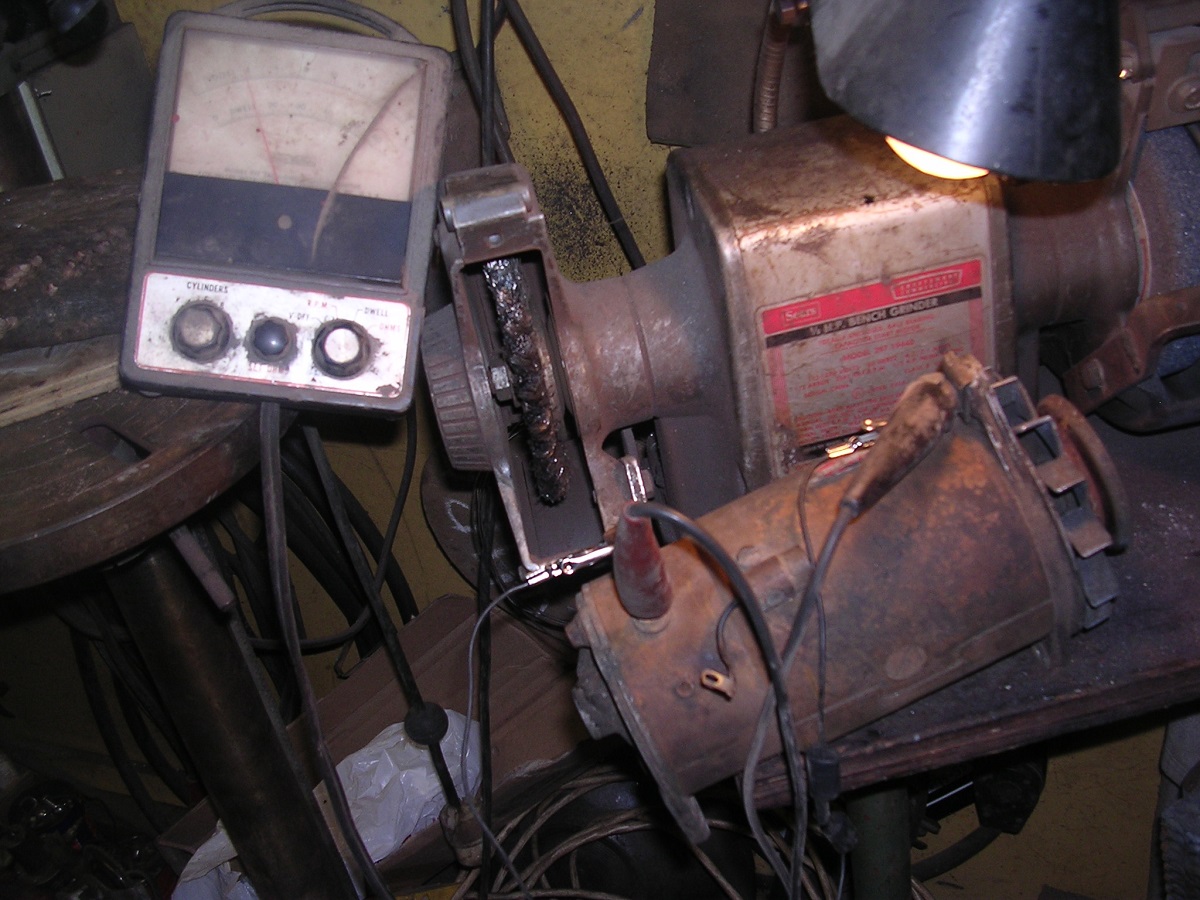

    I found some generators on a shelf, but the best candidate was on my 1953 303 engine. I took it off and bench tested it on the bench grinder's wire wheel on the pulley fan. You just hook a voltmeter to BATT, then jumper from F to the case (grounding it), then spin it, and see if the volts pin the ****og meter...and it did :) I will paint it and install in the morning.

    I'm not sure if a digital would work.. I tried one on the bad generator still in the car. The digital meter was showing all over, *******. Then I dusted off the ****og Fox Valley I bought in 1970, and the one in car showed zero.
    When you test them this way, you only ground it just long enough to see if it can run "wild"... meaning far beyond 12v ...like 2 or 3 times the normal Volts. You don't want to burn it up.
    Testing on the car; unhook all generator wires, including suppressor ...then run the RPM up to driving speed...but again, not for long.
    GM/Mopar is ground-to-test on the Field.
    Ford is different; you must power the F to test those

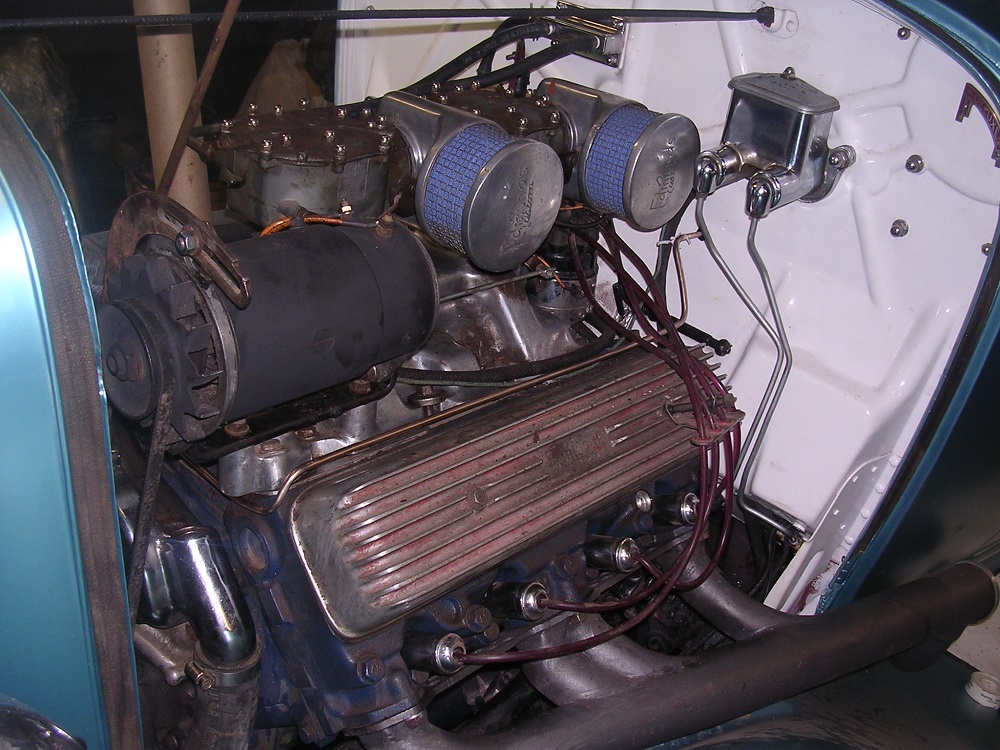

    I ran hard lines to the vac wipers from the Olds dual action fuel pump on p***enger side. The line to the intake vac source went to the rear carb base running along the top edge of valve cover. There is already a single heater hose there, as well as the fuel feed line from pump to the firewall fuel block.
    So, I decided to try running the other hard vac line to the wiper, on the driver side, above it's valve cover. I did these late last night, because I wanted them done before installing the dash cluster and speedo cable. Well it was like trying to stuff a marshmallow up a wildcat's ***, getting the bends correct to go under the front of intake, then along the valve cover, and be able to run it through a new hole in firewall. I had to take the plug wires off on that side, but so tired that I forgot to install them.
    I also found both Edmunds air cleaners that originally had multiple wraps of house screen, which they covered with co****r screen for a better look. I decided to use one layer of cloth, between the two types of screen, from hospital surgery room (don't ask) :)
    I had one done and installed when a friend dropped by yesterday, and I ran the motor to have him listen to the valve chatter. It kind of seemed that my forever steady idle had changed a bit with one cloth air-cleaner on. By the way, that's the 53 generator that did work out good. Still need to buff/paint this side valve cover....and more cleaning everywhere.

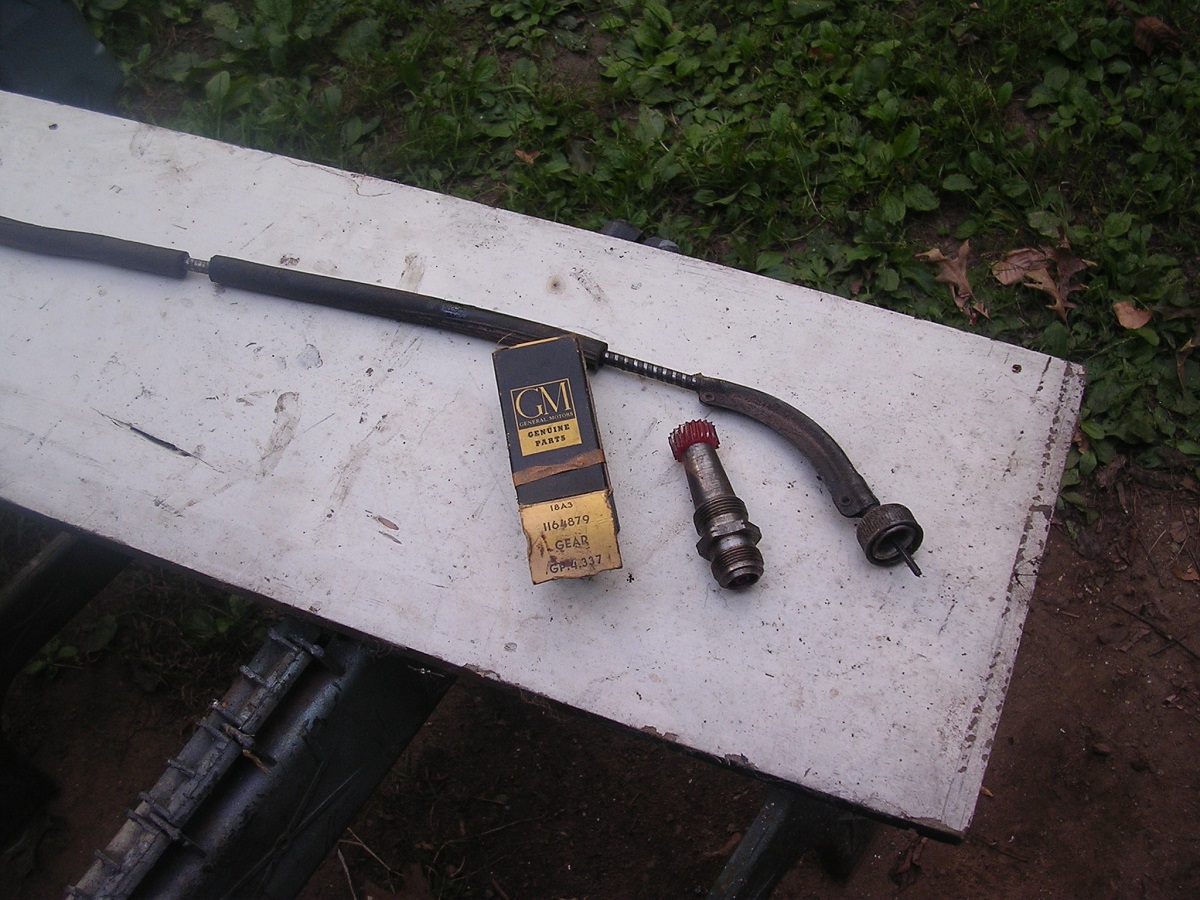

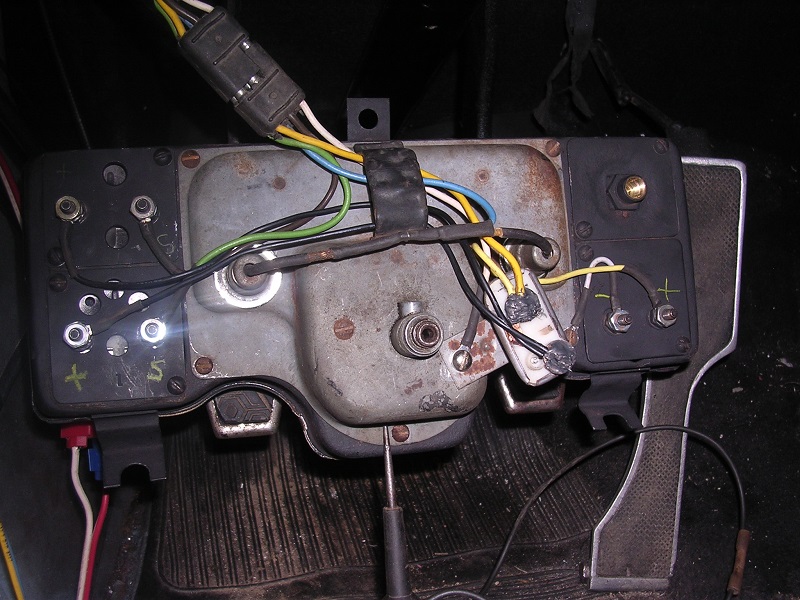

    I get to trying to change the speedo driven gear, but the 1935 ch***is X member is blocking it. I just can't rip the carpeted trans tunnel and floor mat out, so I had to make a homemade crows foot wrench to get in there. What a ***** to get at, and after all that, the damn gear is 20 tooth just like the one I looked up in the book!. So, I need to get back in the book again.. sheesh.
    So, late today I'm done installing other air-cleaner, and dash cluster, speedo cable.... and ran it to see if the wipers work and speedo works on jack stands. Sheesh, the engine sounded worse, smelled rich and a bit of roughness. Thought it was the air cleaner cloth restricting. I went to get something and saw the 4 plug wires off LOL. I've worked every day since July 5th, with maybe only 3 of those were 1 hour or less, so I am used up.

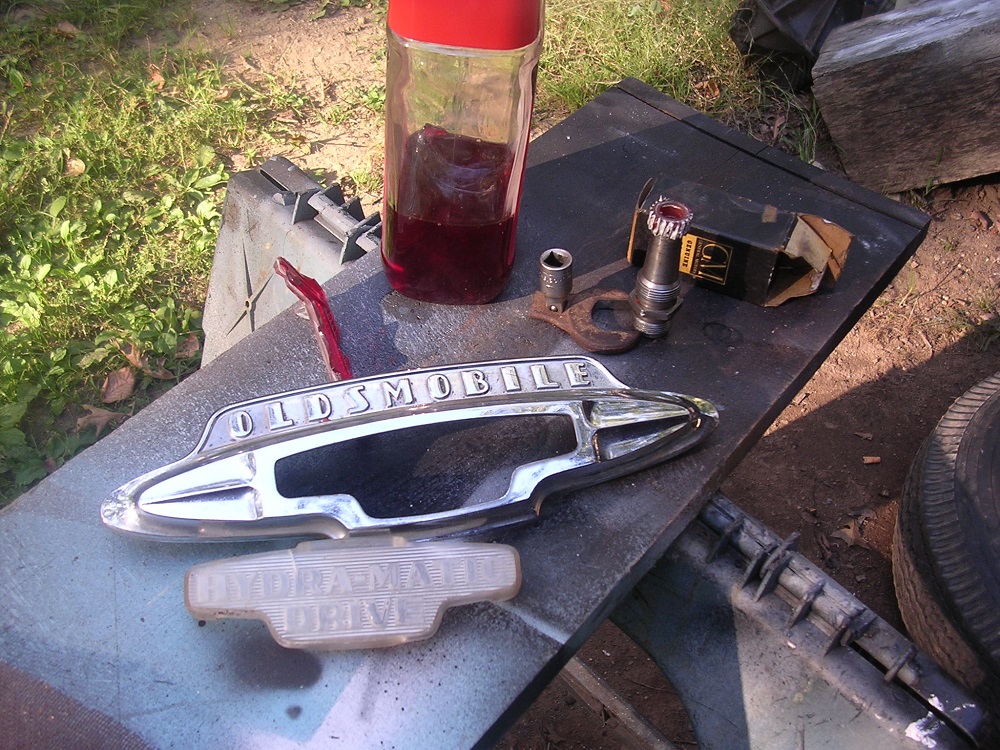

    here is the wrench I made and the bottle of red goo, and the Olds tailgate emblem housing:

    that is the third chrome Chevy dual bore master I've seen in a week,
    is or was there a source for them already chromed?
    falcongeorge likes this.

    I'm a rag picker, :) , car is built with junk. That old chrome master came off ebay. Nobody bid too hard because the seller said it was frozen solid on both bores. I do worry about "life's" other things way too much, but I have zero fear of running a re-honed rebuilt single brake master with old NOS kits. I made sure I have a excellent working handbrake in a good spot, but I also can feel when a wheel gets wet with fluid, and I do a good job I think, with running lines properly, etc.
    Speaking of comparing "us"...I was under there fighting the speedo and I noticed antifreeze on the floor. The car never makes a drip, so I thought of your 27 pic showing it leaking a huge puddle during "your" deadline work. So I look up, and it was not a lower header bolt like I guessed, but it looked like the corner of the headgasket. So, I go topside to see what size socket for headbolt retorque, and spotted my NOS heater shut off T handle valve was dripping. It's screwed into the back manifold port. (Whew) Dang, the day before I had screwed the T down to shut the heater off, and I even tightened the packing nut in case it needed it, from disturbing it.
    I still think I can make it. My hyd lifters sound lousy. I do have adj rockers. Dave50 runs a engine shop and was here a week ago, but he did not seem concerned. Oh well...run it.
