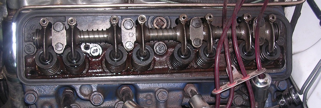

    I'm doing several things at once today, and took the valve cover off to buff/paint. While I was there, I used a remote starter ****on to bump the motor while feeling for lash on these hydraulics.
    So I went through all of them not running, checking one valve that was up and it's mating valve down.
    I found one very loose one, felt like maybe .008 or so and one more that had maybe .001 or 2. The real loose one bothers me quite a bit. I know I had these set with zero when the cam was swapped some years ago. A friend was chasing a couple noisy ones with motor running, and if he tried to go from barely zero and then a 1/2 turn for pre-load, the motor would shake like a sbc does, but it never cleared up until backing off the pre-load??
    Anyways, I ran it after setting the two loose ones to zero with no pre-load,and it just sounds like a solid lifter chatter on both sides. I grab the intake manifold with my fingers and used my thumb to press real hard on the adjuster ends while idling, and I can't seem to change any noise. I have 35PSI oil at idle, warmed up, and oil is getting to both rocker shafts.
    any thoughts?
    BTW, it is an old NOS Crower hydraulic 1.5 ratio cam, with 1.5 stands and 1.5 McGurks, I don't feel any shaft-to-rocker slop. Covers are still off and I see no contact of rockers hitting anything while running at idle.

    I have the covers off and noises are still there, but a bit louder for that reason....and I also did look on the insides of covers, but no signs anywhere, of contact

    Could just be noisy, some hyd cams are noisier than others, depending on the ramps. Does the oil look clean?

    lifter bleed down while running causing valves to slap the seats?

    I went back and really concentrated on how it starts, sounds etc.
    The couple of leaking ones; those go instant quiet as soon as oil pressure comes up.
    Now that I did adjust the two loose ones, and the car is up on stands so I can get my ear right in there on both sides...they all sound exactly the same light ticking, front to back on both banks. So, is George solving the chatter issue, by suggesting it's the lobe profile? I was really listening closely all down each bank, and they are uniform.
    Look how clean the heads are/were. I did no cleaning in there when I installed the 1.5's on the old shafts. That is taken in a dark shop at O'dark thirty tonight, and pic looks like rust where the oil is, but it is as clean/rustfree as the upper surfaces.
    Unfortunately, I may have to remove those Badger spark plug chrome boot covers. I hear arcing on some on humid days like tonight is, and it makes the engine stumble on accel. I may coat the insides of them with plasti-grip to try that.
    Those, and the red solid wires and loom/dividers, all came from that un***embled show motor 303
    I'm going to run the car as is for now, and see if those couple of lifters straighten out on the trip to the show. :)

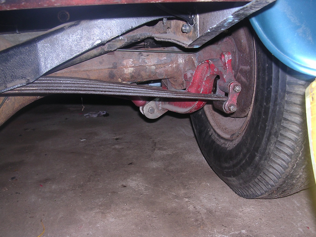

    Sitting on a hill, the car leaning like it should, the right axle whacks the frame when my kid did the bounce test. One inch clearance on the left axle, and he said about 4 fingers on the left, due to tilt. It's just too soft.
    Running board all clamped with clothespins and body clamps ...sheesh
    Old pic on hamb...32 cabriolet, but look at the running board covers....snaps to hold them, just like Ted's (hamber)33 Chevy coupe built by his Dad in 1959. I guess I will try that in winter.
    I told my son to drive the car back to flat ground to bounce test again. I could tell it was hitting on the 2nd push he did. You can see in the next pic, that the rear has settled flatter, now that the car is at ride weight with 6.5 gallons gas and a huge truck battery in the trunk.
    He offered to help put another leaf back in tomorrow night. Not sure if I should do a mid-length leaf or put the longest full width one back in? ....any thoughts?

    in my opinion i would add a couple mid length leaves, you need clearance.

    Two mid length? Maybe I should take a pic in the shop on flat surface. I took out the real long one that backs up the eyelets of the main(also took out others, mid to shorter). When the car was leaning on that hill, the right side 1/2 was darn near flat. I'll try to get a pic when I put the car in now.
    My R/Boards are new 18 gauge I made, primed, and new clean vinyl. DAP fresh can of contact cement the first time, and they were off the car, clamped with long strips of 1/4" thick aluminum on both sides of the vinyl that wraps underneath...and it sat for 5 days, clamped. They started to lift about a month or two later, and the board and the mat now feel gooey/sticky/slimey??? I did let both surfaces flash dry before bonding like the can said. This time, I can't clean the slime, so I just brushed more in there. I will put those long clamping strips back on tonight. I need to take insurance pics tomorrow for sure!

    In person, what I see from "the center of car, out to the shackle", is that there is some arch in the part that is closest to center of car. But it looks like starting halfway of that half, and out to the shackle, that part is dead flat, like it needs at least the longest one put back in? Or not?
    What I need:..... it is far too soft, soft as a Cadillac with bad shocks. And I do need a slight raise, as the shackle angle is not as good now.
    Open to suggestions.. :)

    I would agree with tb33; adding 1-2 mid-length leaves will provide both clearance and stiffness.

    Thanks for the reply, as we may do this tonight. I have all the removed leaves, so I will do exactly as you both suggested..
