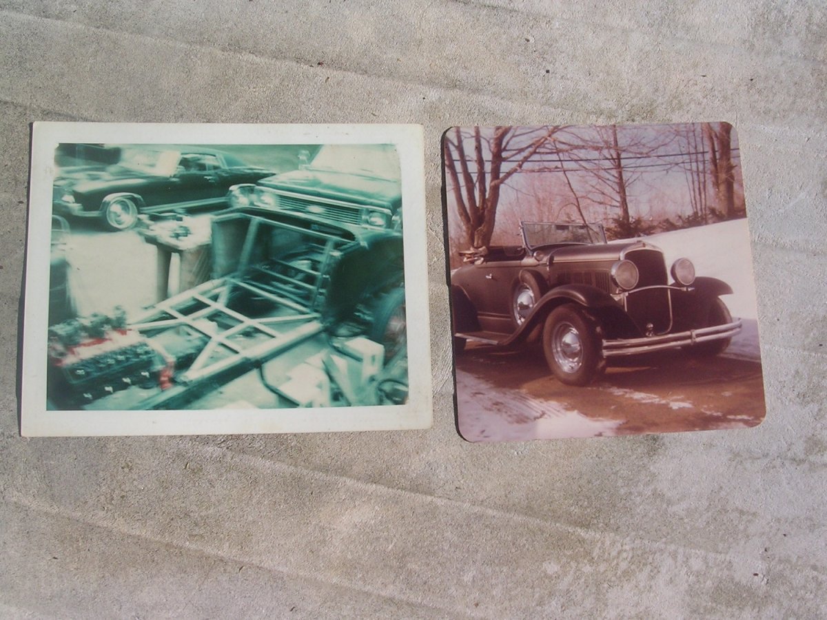

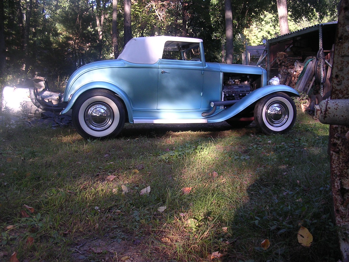

    Hey, I found some pics today while looking for something. Stay tuned for two different Fords, a 39 TRUE barn find conv that I passed on, and pics of the first beater 32 Ford I once owned.
    I had no recollection that I took pics of the 32, but found two. You guys will crap when I give the price when I bought it, and then sold it for a few years later..

    Oh, and my only other 32 Ford project body:
    No bull, I went to the big CSRA swap in 1979...saw this and it reminded me of what I wished I had back in high school. Nobody wanted it!...so I bought it for $200 from Belmont Speed.
    EDIT: yes the doors are there in the body :)
    I was already building my first major build on a 30 mopar roadster, so I soon knew I'd not get the 32 done as it was just a body with doors. Do you believe a couple years later, took it to a big rod swap and I could not get any takers for the $200 I'd accept? It did not sell, but a couple months later in mid winter a flipper calls up and said he'd take it for 200. Funny how things work out; I got to know him well, and then we always chatted at swaps together. When I could not find a matching heavy backspaced 56 Olds rear wheel for my present 32, I asked him at the next swap....he was the guy who hooked me up with the "Olds Farm"...and ended up with a lot of Olds stuff.
    He also told me, that he quickly resold the 3w to a guy in south central Mass, who collected parts for 25 years, then retired and had the car pro-redone, and it's been on the road awhile.
    Here is the first full fender rod I built back then from parts car pieces. I had most pieces except a rear body, then found one, so I made a resto rod ...geez...I don't like big stock lights anymore. I had just bought my used Miller 35S mig, and redid the missing wood with steel, outside. Still have my Miller, but sold the car in 1985 as I was too cold going to work in the AM..
    This car was almost as bad as my current one was, but I did not have to build doors/roll-up windows, or a top, because I had the roadster top. took 2.5 years and had a full time job. Only farmed out the chrome, and about 1/2 of the sandblasting as my compressor was small.
    ooops, forgot: It was 327, 4 speed, early Dart 8-3/4" posi. Stock beam axle, spindles modded for 4 piston early dart discs.
