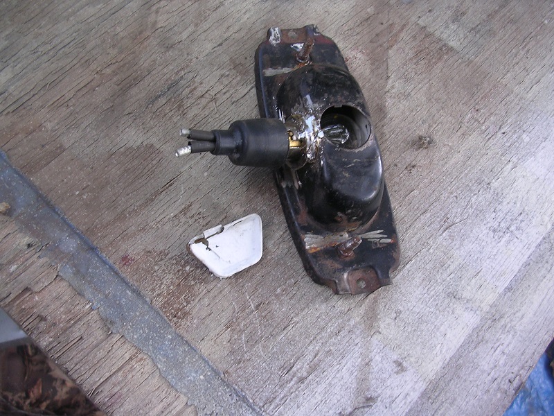

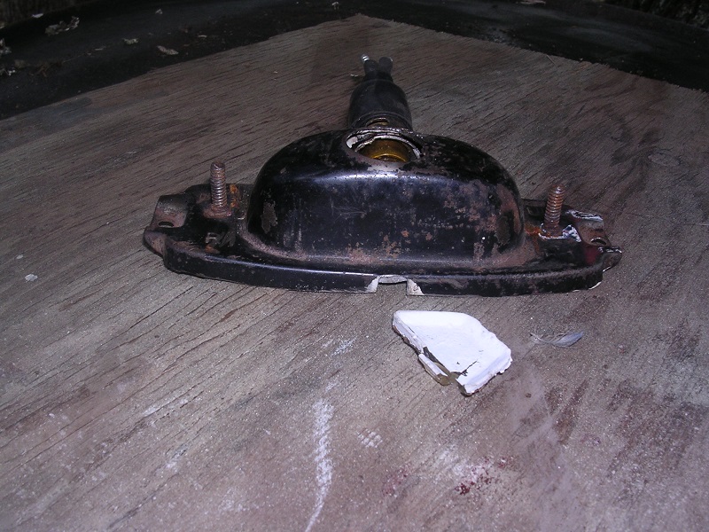

    Supposed to be rainout today but sun came out and it is warmer today, so I really wanted to test drive to see if removing those acorns helped..
    My son turned the car around in a very tilted gulley yesterday and scuffed that taillight wire socket again, so I removed the housing to see if there was room to put the bulb sideways so it cannot ever happen again.
    Stock matching pairs of these Chevy housings, have a clear small side lens that gives light in those cars trunks for getting things like spare tire out in dark. Lucky me, as that bucket was the one with the lens hole, and the hole faces the trunk like I need. There is no room for a snap-in modern bulb holder, so I uncrimped the chevy bulb holder, knocked the (painted-over) lens out, then soldered the chevy holder to the housing for a perfect ground. I had to angle the holder a bit so the bulb can be removed, then a straight distributor wire boot, instead of the destroyed angle one:
