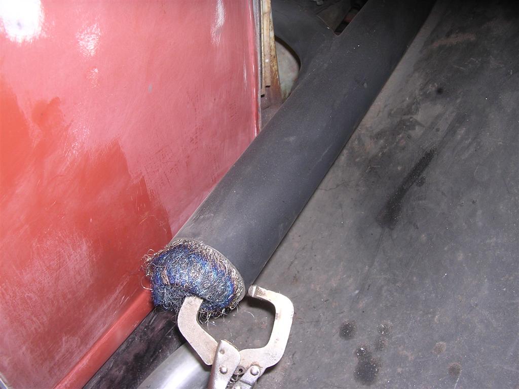

    Started it a few more times, and I also bought 2 packs of coarse steel wool to quiet down the lake headers...it works great. Very quiet at idle, and feeling the exhaust flow, it seems fine.

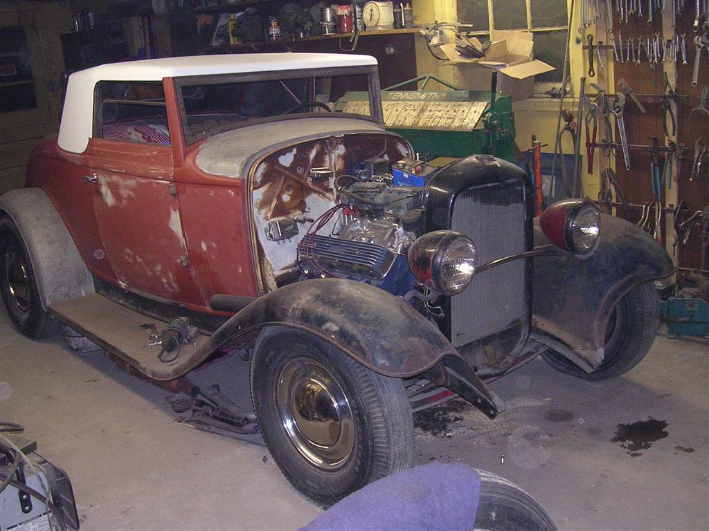

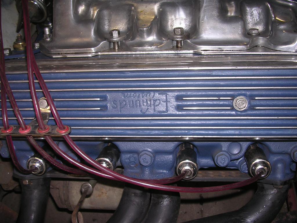

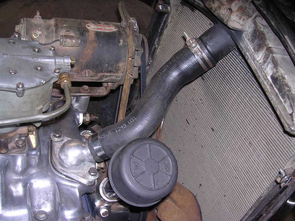

    Dave called today right as I got back with the new upper rad hose. I was telling him I was about to trim a stock fan and then re-bend the tips, or just section them/reweld, so I did not have to bend the tips. He did not like that idea:D
    So, I just cut the spare fan that had a smashed end tip. I did not try to bend new flares yet...and later I found out Dave has the perfect Jeep donor fan. Cool.
    I soldered a tailpipe adapter into the top rad inlet,,,I think it looks OK. Hose fits sort of OK, not perfect,but.. Lower hose fits OK too.
    Ran it for at least 45 minutes non-stop late today. I had a few water leaks, but tightened things and it's fine. Radiator face seems equal heat all over, not plugged, no leaks in rad.
    I've been hearing light puh,puh noises out of the exhaust, and with the steel wool packs, I could hear sparks jumping. The dist cap that came with the chromed distributor is actually chromed! not painted... The sparks were jumping down each plug wire tower, down the chromed sides of the cap. The Dist, cap, chromed spark plug covers and timing cover came from a never finished show motor in Cal...from the 50s I guess. Even the stock 4 barrel intake was plated! Nobody bid on that:rolleyes: So they must have found a shop to plate the dist cap. Tried to get a pic of the sparking, but does not show. looked like Frankenstien movie..
    Plenty of oil pressure getting to the timing chain:eek:. I don't have the fuel pump on yet, just a rag stuck in there. Getting a bit messy.
    Motor is running in all the pics...no smoke out the breather or draft tube hole. No water in oil yet. Not running hot. No problems so far.
    Almost forgot: After 45 min run time; the fenders and cowl side near the lake headers were not hot...barely warm. But that's at low idle speeds. A hamber did reply earlier that his paint does ok driving with wind cooling, but his gets soft paint idling in stopped traffic. So, does this mean I might be ok....I hope so. I want finished paint, not primer.
    I did discolor the steel wool, and partly blew it back out when I was sitting in the car, goosing it:D:eek: Time to put a clutch in it and make a driveshaft, mount the slave and get a brake working..:cool:
    I'll detail the motor better when it's out, and get some more old style hose clamps, etc, ..and a new cap and rotor.

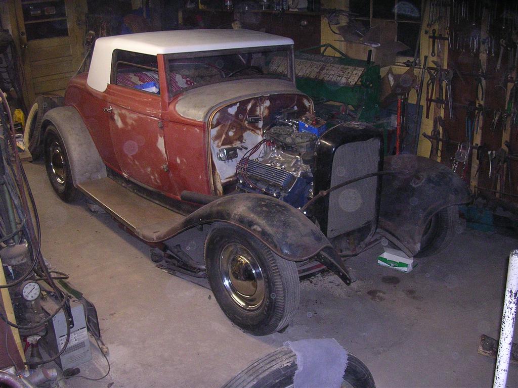

    Sunday was a slow day. The water test is looking good with just a minor leak at the thermostat gasket overnight.
    We have a wicked cold snap here, so I can't tie up the work bay with the engine crane to pull the motor out, in case I get emergency work.

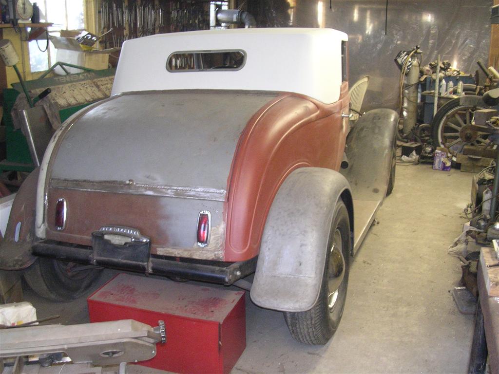

    So, I mocked up a roof color for when I get a vinyl roof skin made up. WHITE is what I will use. Black would be better for a street rod look.
    Pic also shows my new repro smoothie 40/48 Ford stainless steel center hubcaps with the old full stainless trim rings. Tried to show the rear tire tucked under for Dave50, as this is the same early Olds 60" width rear end.

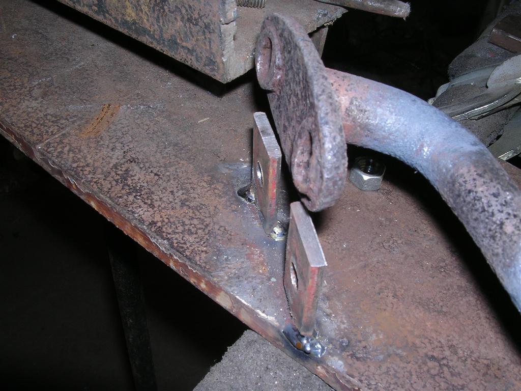

    I am having a lunch for once... I just finished making a jig to hold the stock headlight bar. I will use this today to try to drop the bar. It has all 4 holes, and the angles, and whatnot, to use as a checking jig, as I try the drop.
    Theory... yea right :confused:
    This could go real wrong. Not kidding.
  15. 'eating up the miles'... tell me they have that saying south of the border!
  16. F&J
    Joined: Apr 5, 2007
    Posts: 13,281
    F&J

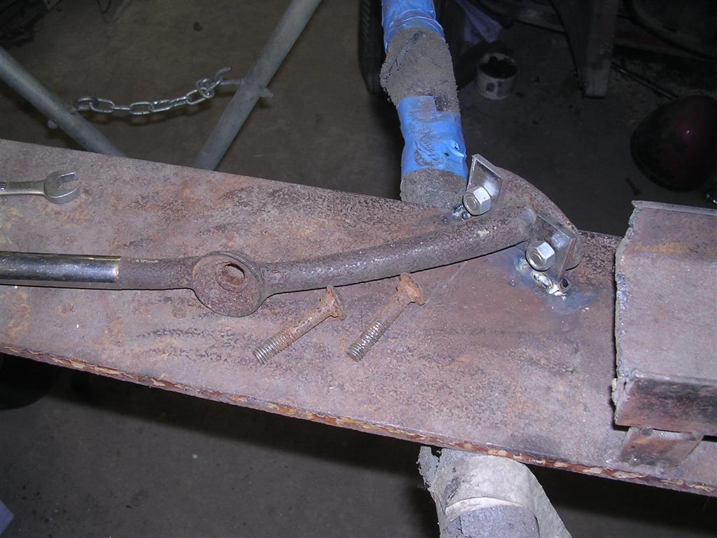

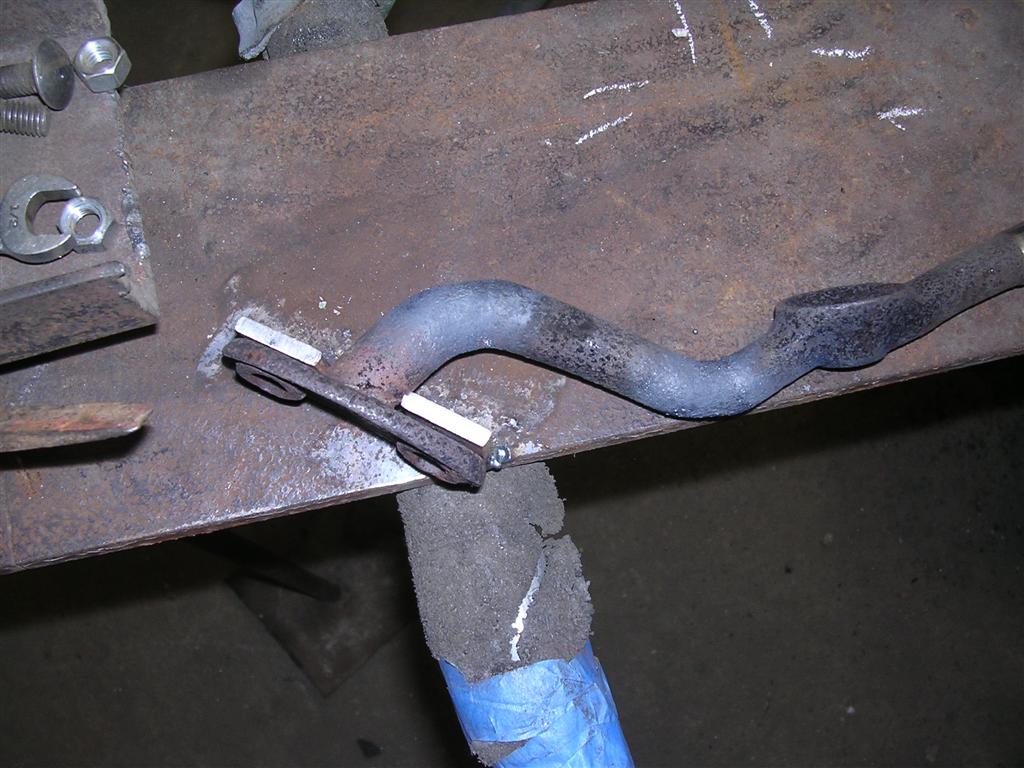

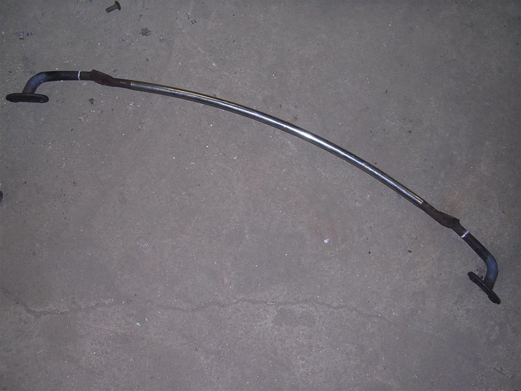

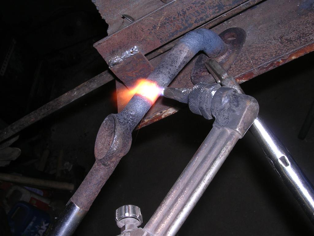

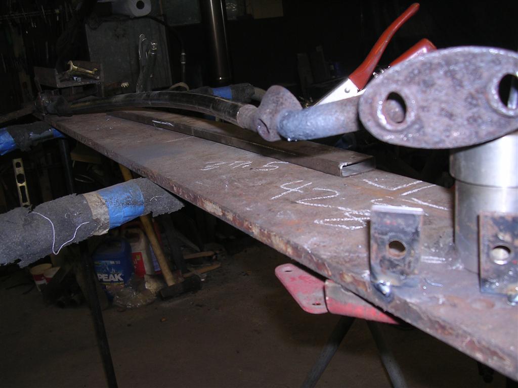

    Today I did the headlight bar drop. I will do multiple posts to keep the pics in order.
    I spent 3 minutes during lunch, to look at a very old rod pic on google to see where to start the inner and outer bends. I do know that if you go too tight out near the flanges, you will never be able to get the special bent-head bolts through the bar,fender, and fender brace. This is critical. Also, I tried to guess the total old style drop because I think if you go too low, you will lose your width?
    First thing was to make a jig on a big heavy plate that I weld stuff to, for bending square tubing, etc. The jig will have 4 plates with a hole, for each of the 4 headlight bar bolts.
    The jig lets you know where it all should line up, after you bend the bar: Width, bolt alignment, angle of the mounting flanges, and if you mark the location of the light "cones", you can know how much final drop was.
    first 2 pics show the jig being made/welded with the stock bar.
    3rd pic shows that I bent BOTH outer bends first...that was a quick decision, and I am glad I did that, so that I could have some way to try to keep both sides the same.
    4th pics shows heating the inner bends. This is where you just need to guess on how much bend you think you need, to get it to fit the jig.
    I was real worried before I started this project, as at some point of drop, if you go too much, you would need to stretch the bar back to the correct width. That would be a bitch to do.
    Last 2 pics show how close I got it on the first try. The width is perfect, but both flanges are at the wrong angles....
    Will finish in the next post in a minute..

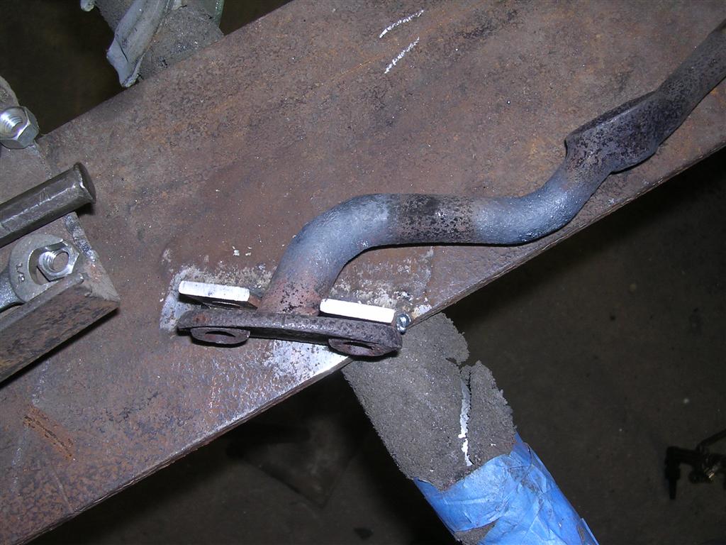

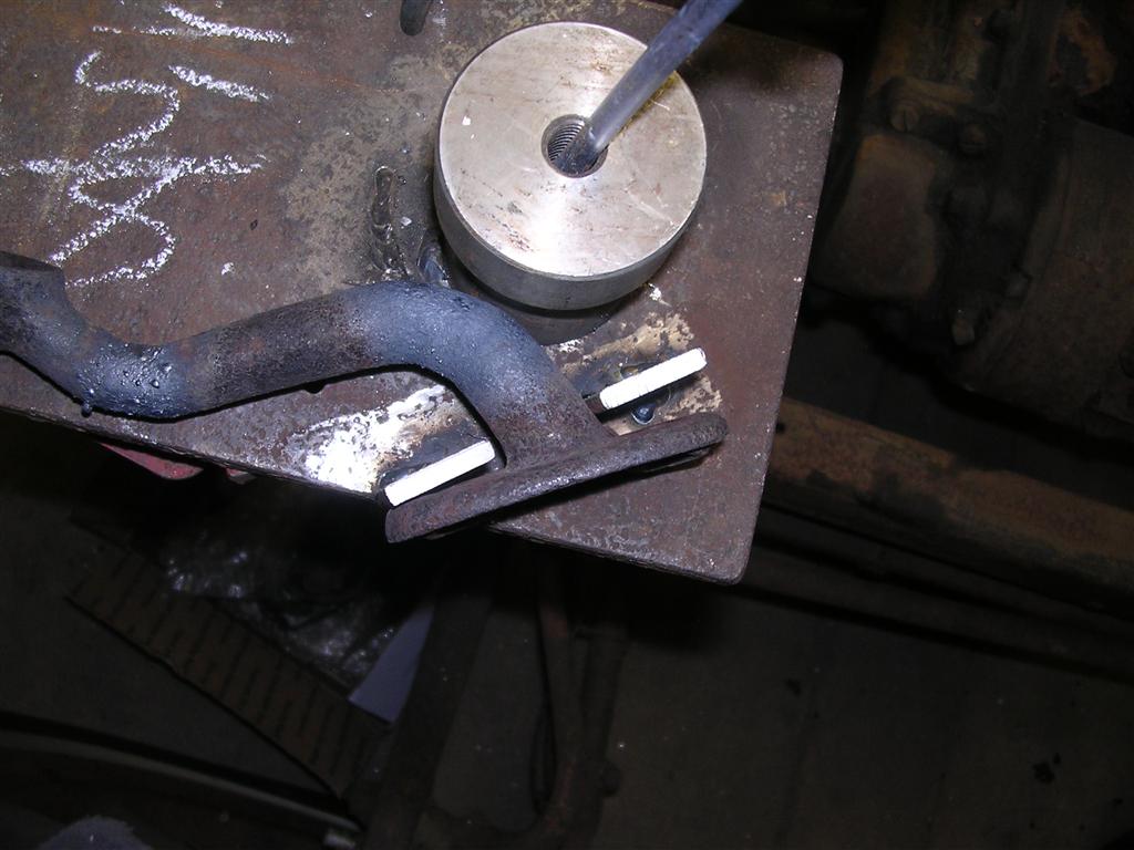

  17. F&J
    Joined: Apr 5, 2007
    Posts: 13,281
    F&J
    First two pics show how good the unbolted fit got, by just a quick heat/bend on each inner bend. It will be easy to get it close in one or 2 tries.
    But, as the next two pics show, that if you bolt one side up to perfectly line up the holes, the flange is twisted slightly, which makes the other end stick up. Just keep one side bolted and heat up the inner bend on that side, while pushing down on the other end. Easy. Then unbolt that side and bolt up the other side for the same heat/bend.
    Then, after both sides are close enough to get all 4 bolts started and fairly tight, you need to "normalize" the bends to take all the stress out. Once you do that correctly by heating BOTH sides at the same time, the bar should not move when you take all four bolts out, after cooling.
    By the way, the marks on the jig shows that the drop was exactly 3", right on the line. I did not plan for any predetermined amount, it just went to that. I was surprised both sides were equal drop to within 1/32"...if you make stuff, you know what I mean by surprised.

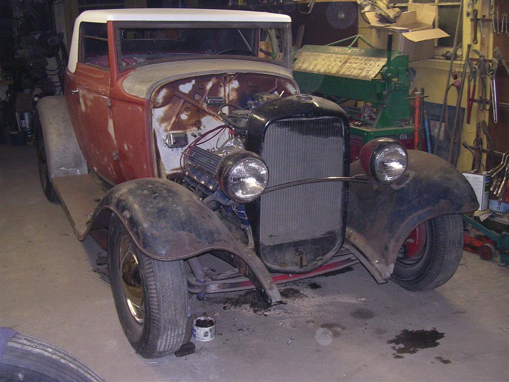

    ...and some pics of what it looks like with BLC 682J lights. Not sure if these look too big? or should I go with smaller ones like King Bees???
  18. hammeredt
    Joined: Mar 3, 2006
    Posts: 433
    hammeredt
    Frank, I KNOW my cabrio is rough. It will come around though.
    I think the healights look great. I think any smaller would be too small. It has a nice early look- not slick or street roddy. Just classic.

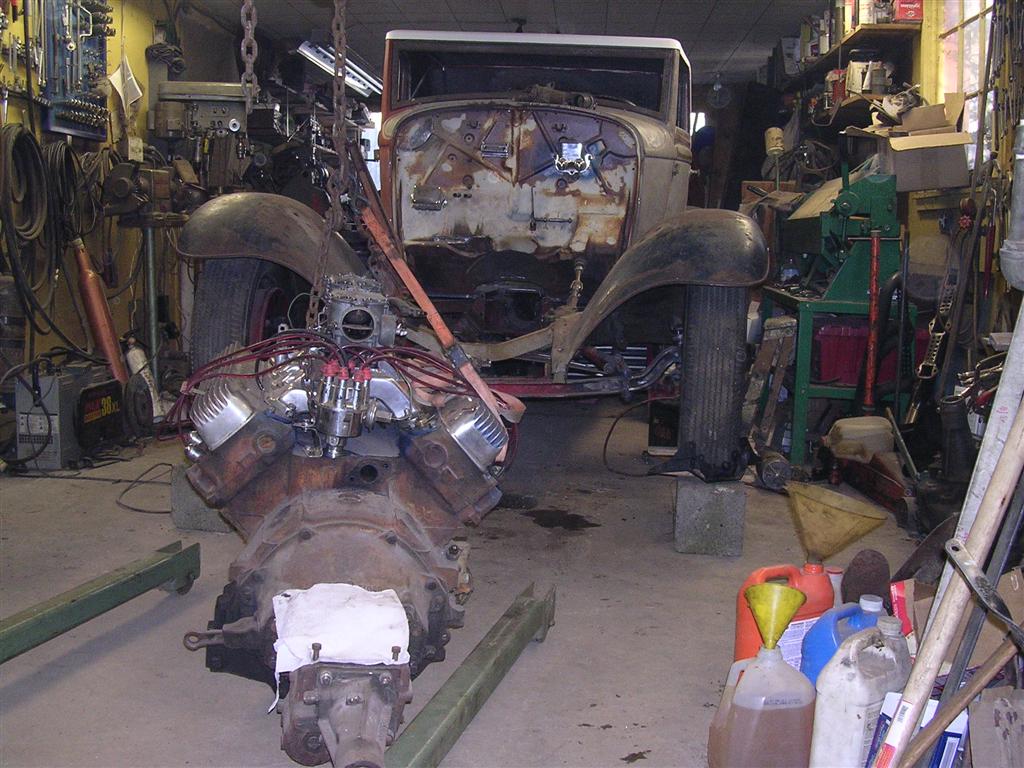

    Dave, I am getting it ready to pull the motor out tomorrow. One thing I did was to pull a valve cover to see how the oiling looked after running it for 45 minutes a few days ago. This motor "oils" the valves good; there is a puddle of oil hanging on each valve retainer. I don't know why some early Olds don't? Your Olds was iffy?
    I will finish putting a driveshaft together in the AM. I'm cutting one that came from Teds' early Olds collection of parts he last ran in the 37 Chev coupe, back in 1962. This one has an old tag that reads "37, Olds-to-Olds" . He ran several types of trans, and a 50 Olds was one of them.
    It's ending up at 36" from U joint centers.
    the car is jacked up and I am set to get busy. I did start it once more today to keep me stoked. F me, this thing starts right up and drops to 700rpm like summer...despite the arcing on the chromed dist cap:confused:

    Also, I did get the motor out today, sad to see it all apart, and the shop now has no room to work.
    My right arm is real bad, so I will do small jobs like trying to make a clutch slave bracket for the 60-62 Chev truck slave. I have no idea if it will have enough throw for the working-length of the Olds fork? Maybe test it with air pressure? Any thoughts? Will 125 psi move it?
