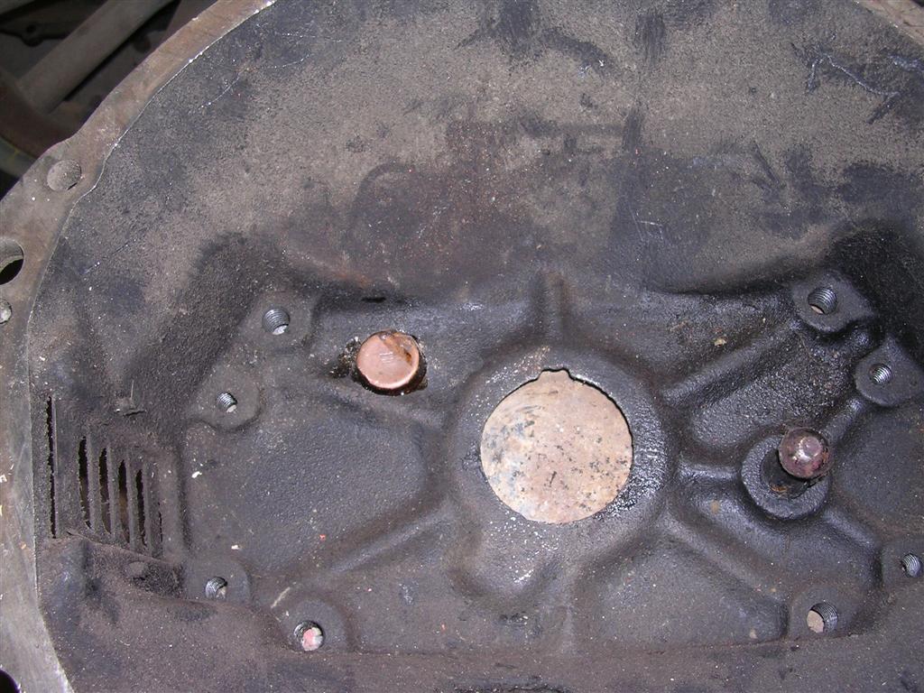

    I had an idea last night on how to do the hole in the bell for the 1st-rev shift rail that sticks forward in first gear..
    I used a copper water pipe end cap like a freeze plug. A freeze plug would be too shallow, and the end plug is longer.
    Drilled a 1" hole on the drillpress and I figured the bit would walk as it went through the very uneven inside of the bell, which it did do. So I dressed the hole round again with a die grinding bit.
    I used gasket sealer and it went in real tight, so it should be fine.

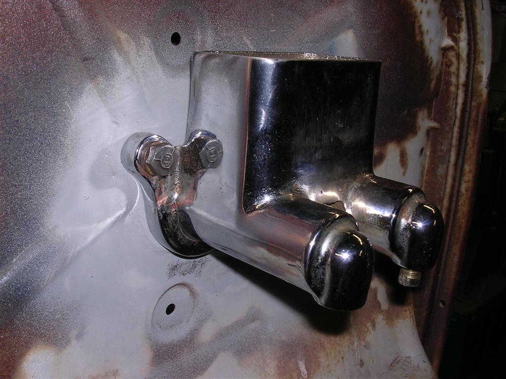

    I guess I'll work on the firewall; t******* the lower edges, mounting the master correctly on a new flat plate welded in, then try to prep for paint. I sure wish I had sandblasted it, but......

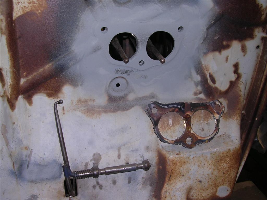

    Small stuff eats a lot of time. I cut out behind the master cylinder to weld in a new 3/16" plate so that the cylinder can sit flat, instead of sitting on the firewall beads.
    Ran into some old brazing when I was welding, as this firewall came from an old hotrod 3w that had holes for two seperate masters that were brazed back up.

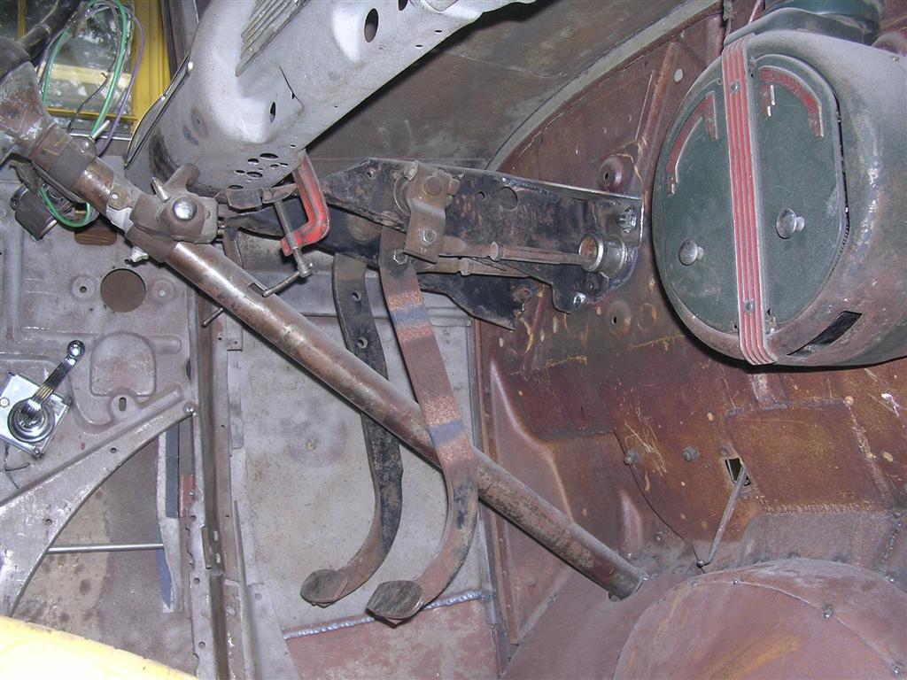

    I am working the last of the mods to the 60/62 truck pedal cluster brackets to tie into the 40 dash. It all is fitting ok, but I need the 2 special Chevy pedal return springs so that I can make pedal return stops. I might have some in the barn. I hate looking for stuff.
    there won't be any firewall flex with this pedal cluster, compared to Ansen pedals.

    jealous of that chrome m/c, frank. super cool. i like your firewall treatment too. taking notes for my near future.

    Welded spare holes in firewall yesterday, tried to sand/grind firewall but I need to blast it on the car in a couple of days. Need to finish some frame welding first while it's up on blocks ...I forget what else because that was yesterday.
    Today, I straightened out the lower firewall where someone patched an old cut-out for a distributor. It was all stretched outwards and hidden with genuine "bondo" which was peeling. I was going to cut it out, but used the torch and hammer to mash it all nice and flat. Less mud that way, you know:D It's just a hot rod.
    There are strange openings at the lower firewall, right behind the "feet". that go right into the car. I have no idea what was supposed to fill those, so I made good fitting patches and welded them in.
    I also went through some boxes of 60-66 Chev truck parts in the barn to maybe find the correct pedal return springs. Wow, I found one and did not recognize it being correct, but found another in the next box and also the TOB fork arm longer return spring. So, then I could fab a pedal stop thing. Need to cut corners for time, so it's just a 3/4" angle iron with welded nuts for the adjustable stop screws.
    Put a froze up master on to see if the pushrods can reach, etc. They do.
    Now I need to drill the 40 dash bottom edge for the pedal cluster bracket. The cluster ***'y length was perfect to reach from firewall to dash.
    I'm not pulling the body off, screw it. I'll weld/paint the frame as best as I can. I don't give a S... right now...I want it yard drivable no later than March 1st....of 2012 :rolleyes:

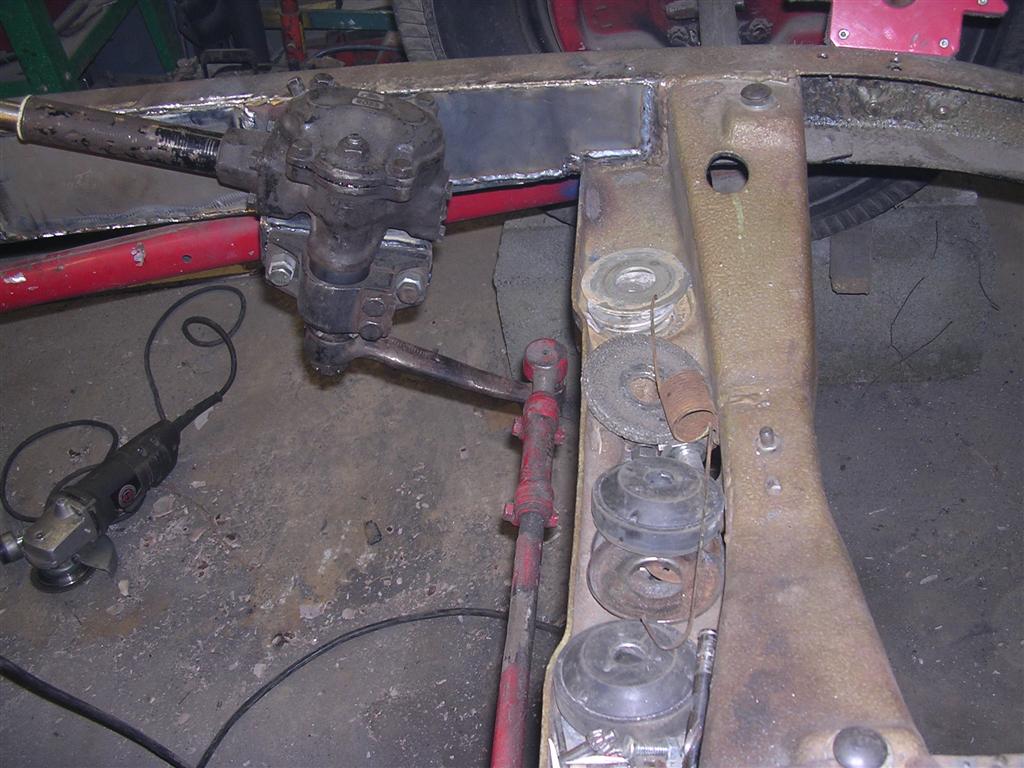

    This frame was an old rod frame I found in CT. When I first got it home, I had to cut out the driver side frame boxing plate, because the rail was bent down swaybacked, and they boxed it bent.:confused: Back then I straightened the rail with a rosebud, a big beam, chains and a jack, but never reboxed as I needed to do a cross steer box mounts.
    The steering box is a very low mile early 50s Ross fast ratio with 2-3/4 turns. It never steered right. Today I had to find out why, because I wanted to box the rail. The box steered nice before I shortened the mast jacket and inner shaft.
    So I pulled the homemade steel upper mast bushing out again, and saw that the shaft was not in the center. I took the worm gear and shaft ***y out, put it in dead centers on the lathe to find out that the worm was welded wrong at the factory. The shaft does not press into the worm like a Ford, it's ****welded.
    It felt OK before I shortened it because with a very long column before, the misalignment was taken care of by a gradual flex over a long distance, and that the upper bushing was a rubber deal that had some give.
    I thought it was doomed because I did not want to cut the worm off and reweld such a critical spot. I finally found a way to straighten the inner shaft so it ran true in the mast bushing. It feels perfect now, I can't wait to try it with the heavy motor back in.
    Made the front boxing plate out of 3/16 so that I'd have a solid place to weld the other steering mounting braces to. The back brace runs right though the plates and is welded to the side rail itself.
    It's all rock solid.

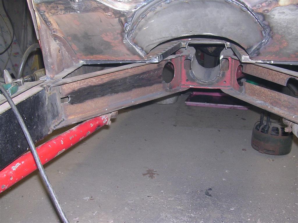

    Short day, but I did the finish work on one front leg of the center frame X member.
    Some of you know that I used a 2 foot long section of 35 Ford center X that was cut out by a streetrodder redoing his 35. I turned it backwards so that the wishbone ball socket could be used for my 35/36 rear trailing arms that are now a true wishbone.
    So I needed to make 4 legs to hook to that center X. The Ford channel has a rounded radius, and I ended up cutting pieces from 4" square tube I had. That left a long tapered gap between the 2 pieces on each leg. It looked real hokey, so I've never shown a pic before. But now I have filled that gap on the right front leg, and I think it looks great, being that it's all s**** metal. I left the one big round hole at the back because 3/4 of it was still there on the center piece.
    The left side still has that gap, so you can see how bad it looked before. That leg is getting a second hole for the clutch fork, that might get close when pushed back.
    You can also see the floor mods for the Olds rear half bell extension on the motor. I fit it all close to get some room for a gas pedal.

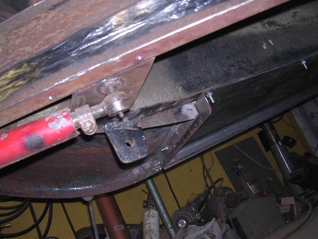

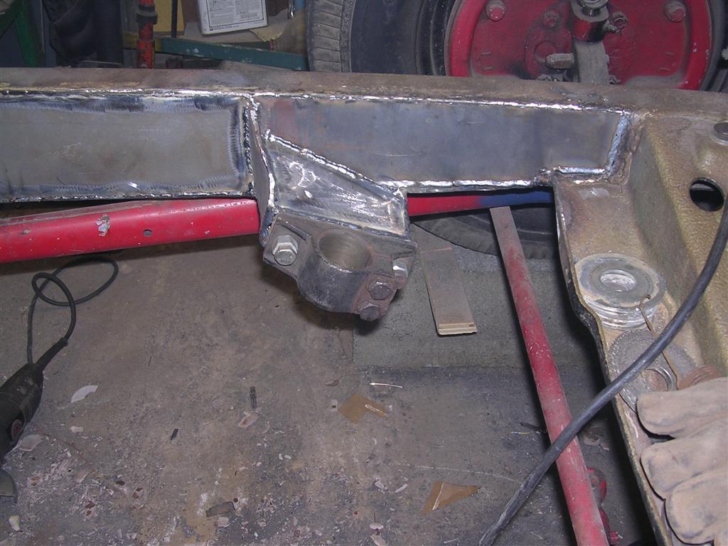

    2nd pic shows where the old rod frame had front split bone mounts at the outer rail, but with backwards tapers, so that the bone tie rod end was coming in from the back. That pulls the bone in, away from the tire.
    But I moved the new horizontal bone mounting plates up higher and and under more. They are welded to the front legs and the outer framerail.
    That really gets the bones tucked way under, but as HammeredT noticed in person here, that the bone gets close to the bottom rail with the engine in. I doubt it would hit, but I already had taken a mint set of 42-48 S-bent bones in trade from a Fordbarner. I will just use the bent tubing and weld those to my slimmed/trimmed 35/36 front bone yokes. I want to try running the caster real light just for grins. I hope it works ok.

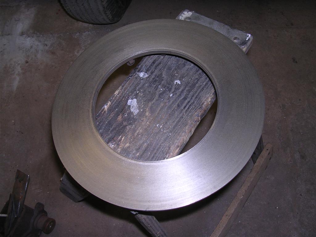

    The antique NOS/NORS place is closed on Weds, so I can't call on a new pressure plate availability, so I wanted to try to reface this badly pitted one. Wow, cast iron, but work hardened? surface. It would dull a high speed steel bit in 2 seconds. Then I tried a new carbide, and it would hold an edge longer but sparks were flying!

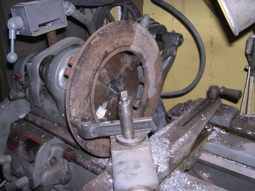

    So then my hotrod friend shows up; a lifetime tool/die machinist for Pratt & Whitney Aircraft. He tried all sorts of things to get it to get a bite, but then had to get to work.
    I kept trying different cutting angles, and finally ran the lathe backwards and cut on the far side. I ended up with a better bit angle, and tightened the drive belt, and forced the bit under the pits or hard layer, I guess.
    I gave a quick measure after it was done; maybe 11 to 12 thou.
    I wonder if it will work:D:confused:

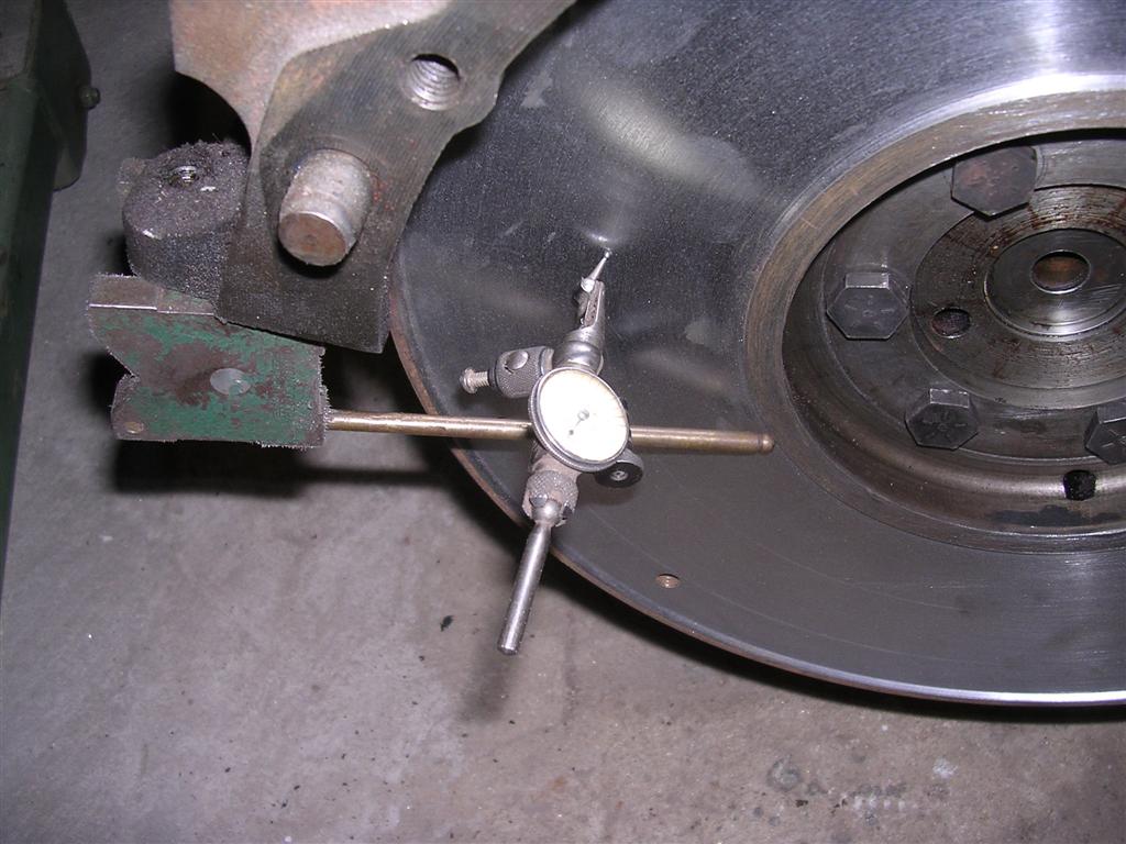

    I have 2 questions for the 2 auto machine shop owners, Dave and the hamber from NJ who also is a machinist.. I would like to know about the hard spots on flywheel surfaces; If you use the proper grinder, do the hard spots blend in or are you positive that they are gone?
    The reason I ask is that I did turn my flywheel on the Ammco setup today. I thought there were no hard spots because I had thought that they all looked the same: "those wavy choppy blued spots" you see on hard use clutches. But yesterdays cutting of the pressure plate, ended up with m***ive hard spots that could not be seen before cutting.
    So, I expected the same with the flywheel and even though none were showing before cutting, it did have quite a bit in the inner 1/3rd of the face to maybe half way out. I kept cutting on slow feed till I got every last one completely gone. It took 70 thou to make them gone, and then I did a light slow clean after that.
    80 thou, but I wish I could take way more to make it look like the Olds 6 cyl wheel that is very light, and very dished in the center...but then the TOB won't reach I ***ume.
    So, I know mine are gone, but how can you tell if they are gone with a flywheel grinder? These spots were the same color as the flywheel in good spots.
    2nd question; I have .003 runout at the face I just cut when torqued to the crank, and 1.5 thou of that is because the flywheel itself has runout. I checked the uncut outer edge as well as the cut surface. I say 3 thou is fine, but I can't find a general spec in Motors. I could get it to 1 thou or so by dressing the mating surfaces.
    I had to do that once on one that was .016 out, due to a bent crank flange on a sbc, I got that one to 1.5
    Well, the cutting went really good, but the set up to get it to run true on the Ammco was frustrating. First pic shows checking hub runout and I also was doing face runout as well.
    I made my parts list while waiting on the lathe cycles,.. I need to go to M*** tommorrow to the old parts warehouse. I hope he's open.

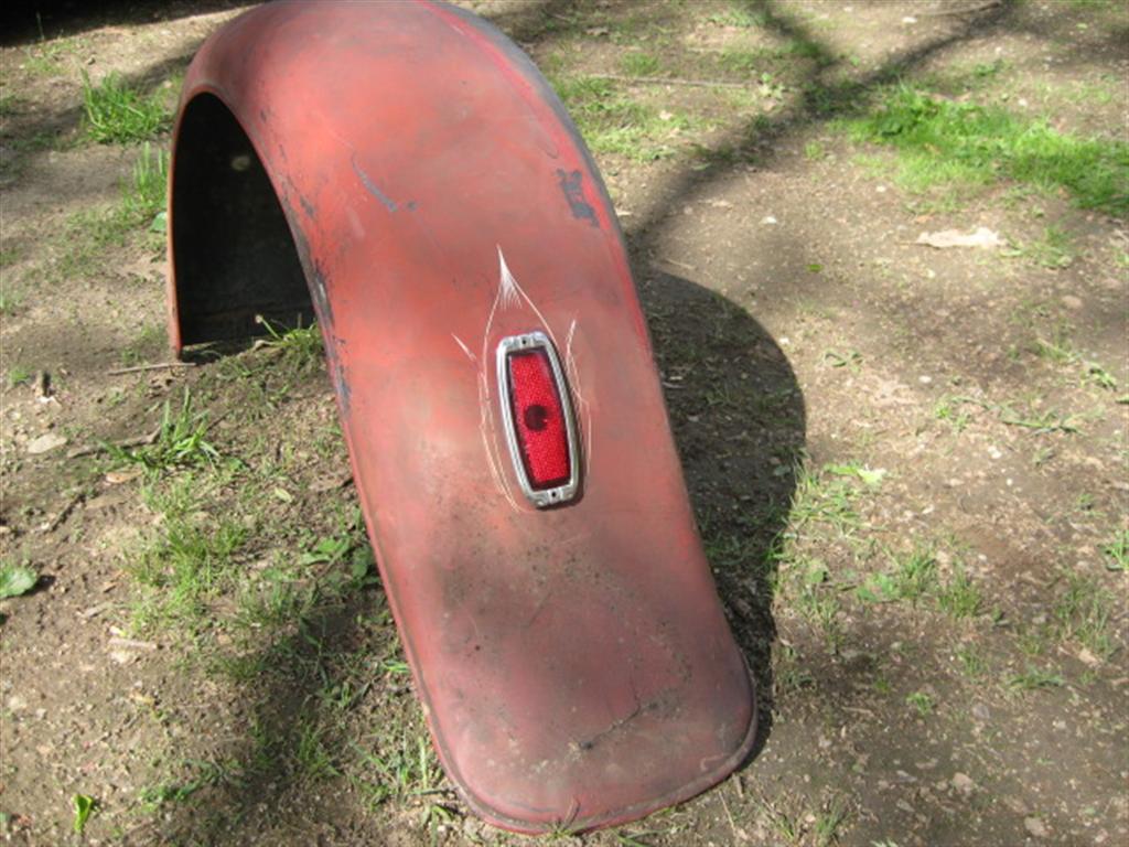

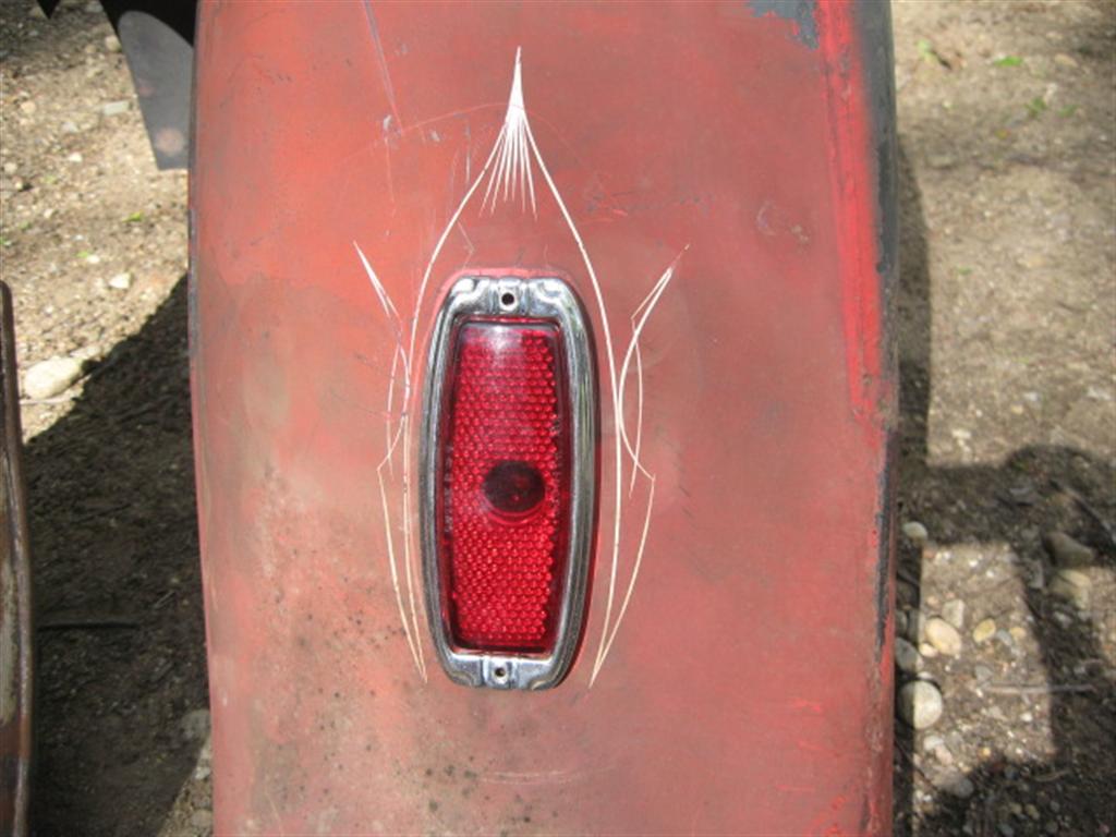

    ...and I am thinking about putting the 41-48 chevy tail lights back on the rear fenders like they were when I got them??? What do tou think? It's a piece of the old ways I guess, even if a bit odd. I will get Charlie "one armed bandit" to do the old cl***ic "fine line" striping on the car :cool:

    i like the tail lights in the slightly awkward old style context.

    Ditto here on the t-lights; the Chevys were an occasional alternative to the usual Ford & Pontiac lenses.
