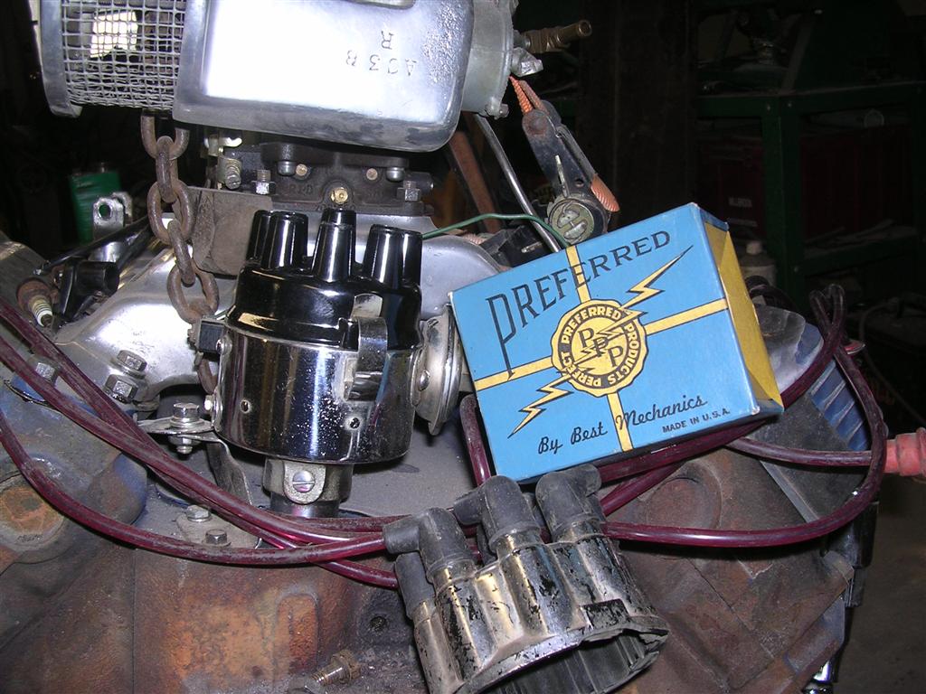

    Heathen ID'ed my chrome distributor earlier, when I said the 53 and 55 cap and rotor would not fit it. He said 49-50 Olds, so that's what I ordered. I had problems before with the wrong cap where the wires would hit the Edmunds back draft aircleaner. Well, the early cap is super short, so that's what the Edmunds was set up for: the very earliest 303's. I think the shorty cap looks cool.

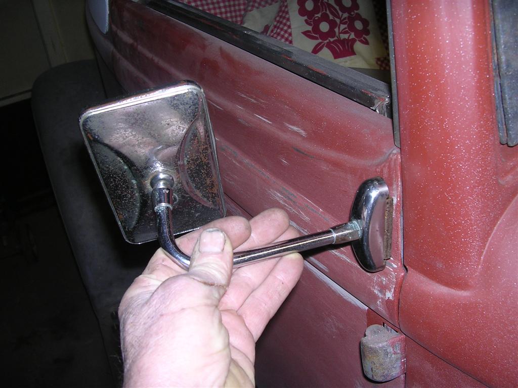

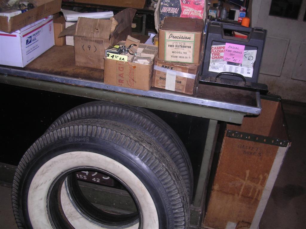

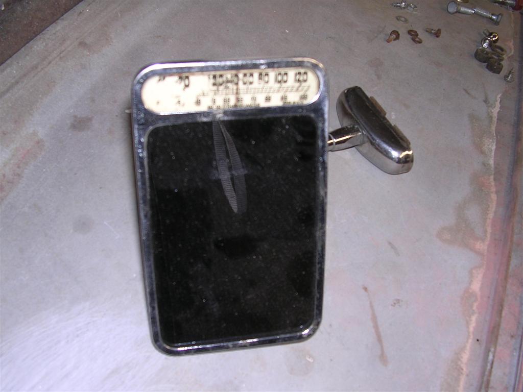

    Also, Pease has TONS of used stuff all over. I spotted this cool O/S mirror with a working thermometer. It needs replating, but it looks much better in person. I like it.;)
    Got lucky with 4 sizes of NOS Packard cloth wire for the engine compartment.
    And nope, he did not have any more translucent gas hose....so the world is safe :eek::D

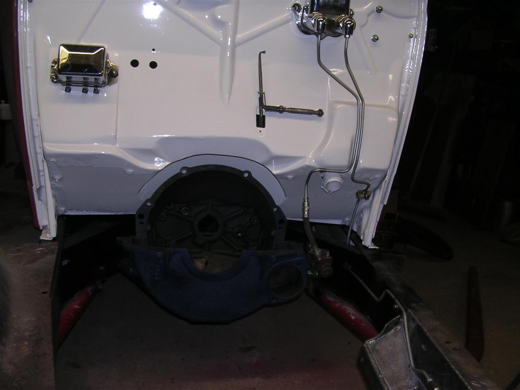

    I worked late last night to get the eng compartment ready for the motor install, which I planned to start by Thurs AM.

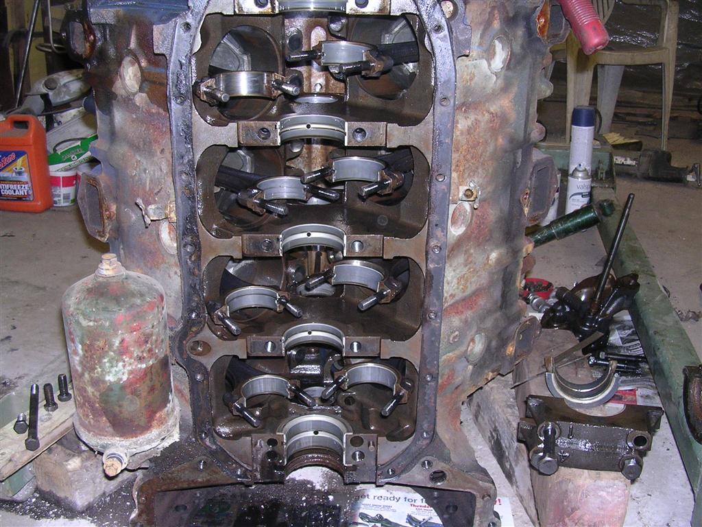

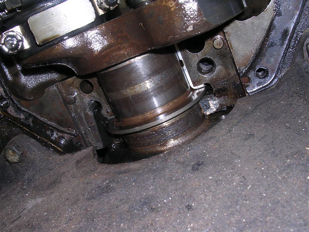

    Well, the bad karma of the car continues.. Look at the pics. I dropped the pan which was spotless inside, "except" for a 1/8" deep layer of what looks like metallic from paint, all sitting in a perfect oval shape right under the oval oil pump pickup screen. hmmm..

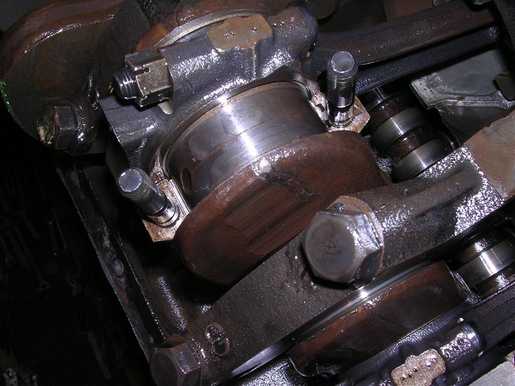

    Then I dropped the rear main out to see that the crank is rusty:confused: So then I dropped a random rod cap, and it also had a bit of rust. And if you notice the prick punch marks on the rods..this has been apart before.
    I said earlier that this motor was "too clean" in the valley to be 41,000 miles...now I know that is true. The only thing I thought of is that this was one of the 54/55 motors that lost a piston top when they were new? The 56 had upgraded pistons for that reason.
    So, what do I do? My spare 56 crank came from a 61k motor that lost a rod 20 years ago and the owner put used parts back in, and nicked the crank when he tapped in the replacement rod/piston..
    I hate to send either crank out to a shop that sends them elsewhere??
    I am planning on pulling the crank in the AM to see if the rest are worse or better.
    N.B.Pease may have .001 over bearings, and likely has .010 and larger.
    I don't want to tear the complete motor apart, but I need to think it all out tonight. The 303 in the 40 needs cleaning inside and at least a set of lifters, so that's not the answer.
    Yes, I still love my Olds motors:cool:
  11. At least the firewall looks DAMN good, Frank!;)

    Well Andy, I am still thinking it out tonight. I went back to the shop to clean a spot on the main journal with 400. I'm not feeling it will polish out...yet.
    I really need to pull the crank out in the AM, as maybe some journals are far worse. Even the surface for the rope seal looks like it definately needs to be machined. That's really rusty. I quess the seller was right when he said the donor car sat in a barn in MS for over 50 years after getting sideswiped. The crank dried out completely of oil, then moisture set in.
    The old situation where "while you are at it, you might as well do..." But this motor is strong compression, no smoke, zero blow-by, and quiet.

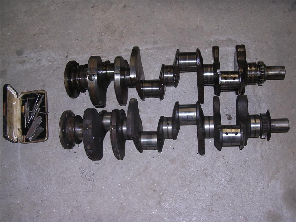

    Just a minor setback; the crank has a crack up front at the first throw.
    On another thread yesterday, the gang all said my spare 56 crank with a nick or two will be fine.
    I did not find out if I can sneak the crank out without pulling the heads and pistons, so I will try today.
    Also am trying to measure my new-old Crower cam, as I might put it in now if I find out the overlap is not too much. I don't want a "poor low end" cam.
    I still should be yard drivable by the end of the month, maybe even earlier I am thinking.

    Then I tried sneaking the crank out...piece of cake. No problems what so ever. Also, A hamber reminded me to check the 56 crank bushing, I did it with a bore gauge and it's the same, because this was a base model 56 88 that still had the Hydra which I thought was the same bushing as stick. It is.

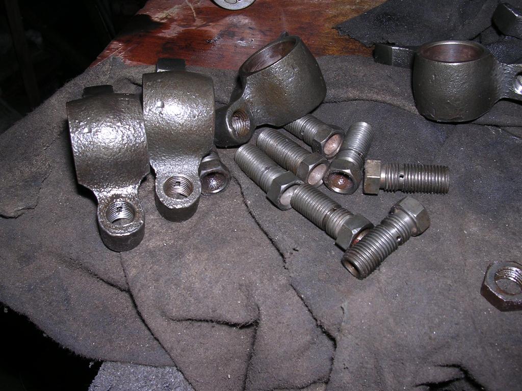

    Then I wanted to see if my pushrods were still too short due to the reduced base circle on the reground cam. A friend was turning the cam while I found zero lash, and then I did some pre-load, and on just this one valve, it looks fine.

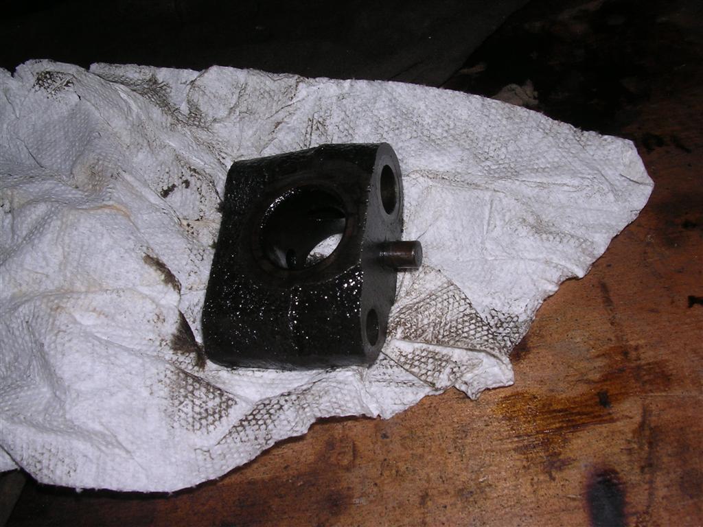

    Last pic shows that there is an oil feed hole inside the threaded hole on the McGurks that must line up with the oil groove cut into the adjuster screw. You can adjust the valves quite a bit, but if you go too far either way, the oil will be blocked.

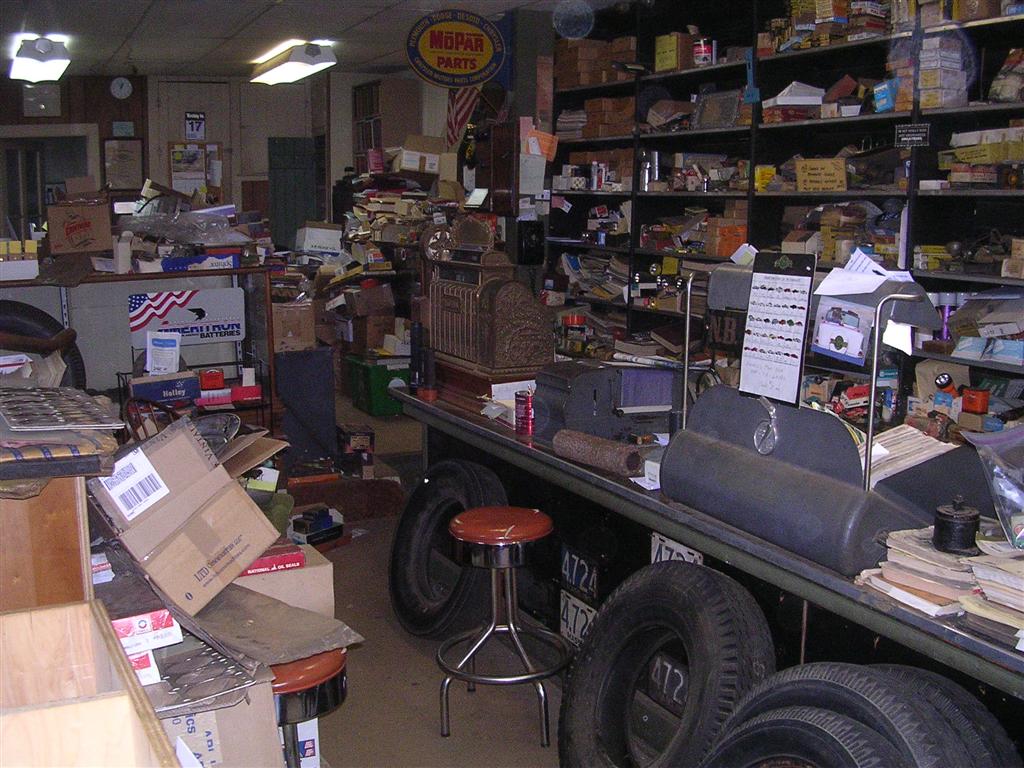

    Pics below: is only what you see in the counter area

    a place like that is always better if you show up to buy something with a repeat customer!
    looks like a horrible place to shop by your pics!

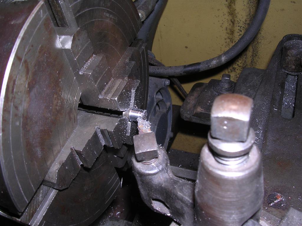

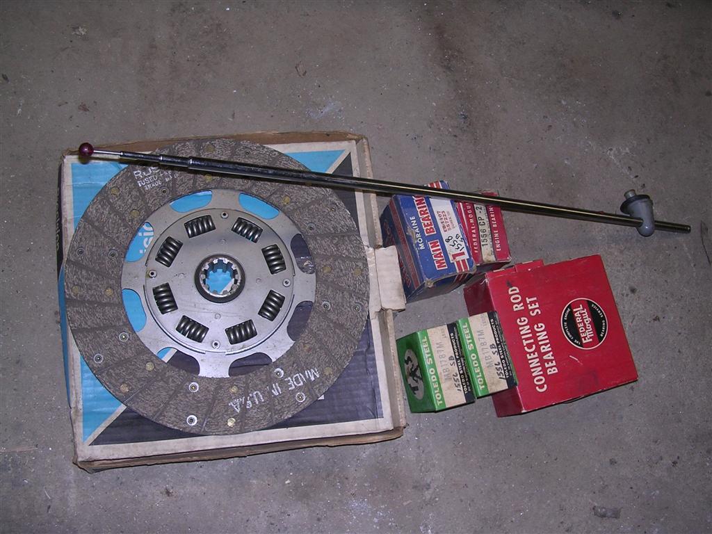

    I went back to the old parts store yesterday to get some engine bearings. He did have a full set of STD rod bearings. The main bearings are 4 of one type, and one rear main. He had the rear main and only 2 of the other 4 in STD.
    I hoped he had 2 of the old .002 oversize that I could resize to STD. He only had one of those, so I knew I'd have to try resizing at least one of the used .010 mains that I took out, if there was enough babbit on the shells.
    I messed up the first 2 by going slightly over specs, but the 3rd one went great and ended up at .001 clearance before polishing the crank. So then I figured it would be real quick to resize the .002 bearing....NOT.... That one box was marked "not resizable". So I gave it slightly less than a .001 cut and it had copper showing..WTH? The babbit was only .001 thick!
    Now, I only had one used .010 left to try, to have the last bearing I needed. I got really lucky and I got it to .001. Those .010 bearings are meant to be resizable because the babbit layer is very thick, even after the resize.
    A friend stopped by so I got him to help lift the crank up and onto the lathe. I have the back gears engaged so it turns slow enough so I can use strips of crocus cloth to polish it. Never tried this before, but it should be a lot easier than rolling it around on a bench.
    I might have the motor finished by Monday night, all cleaned, painted, and ready to go back in by Tuesday morning.
    I saved so much money on the old bearings that I decided to get a new/old 11" clutch disc made in USA. ...and an old red tipped, side cowl mount antenna that my cowl once had. I need to make the one missing mounting post, but $15 sure beats ebay prices of $150 to $300. The antenna is very odd, it extends to 8 feet, and then being mounted about 2 feet off the ground, means it will be 10 feet high? I think I'll be able to find my car in a parking lot :)

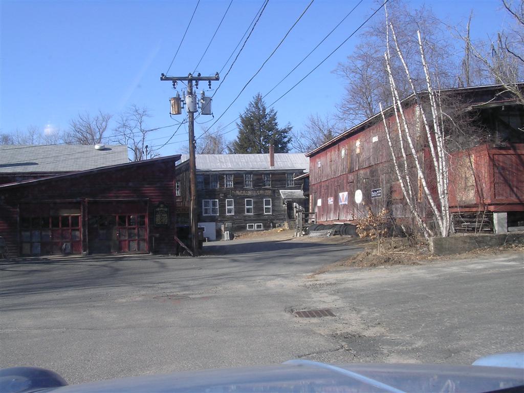

    Pic of the old parts place below. There are two more building not seen in that view, and other buildings elsewhere in town.

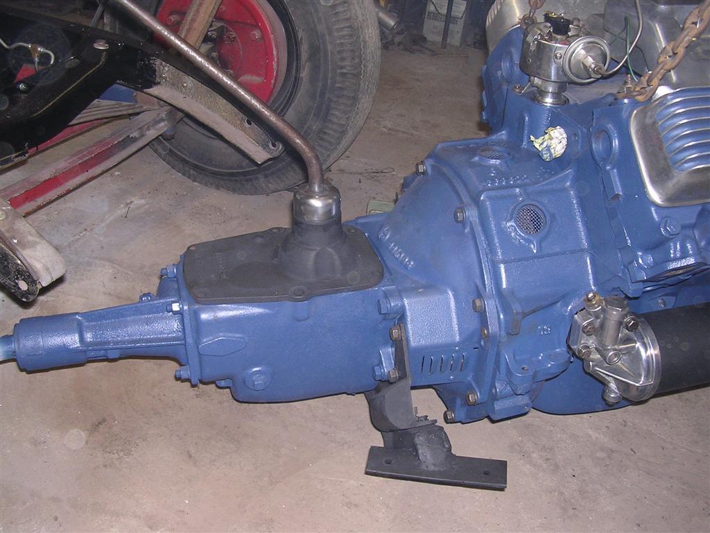

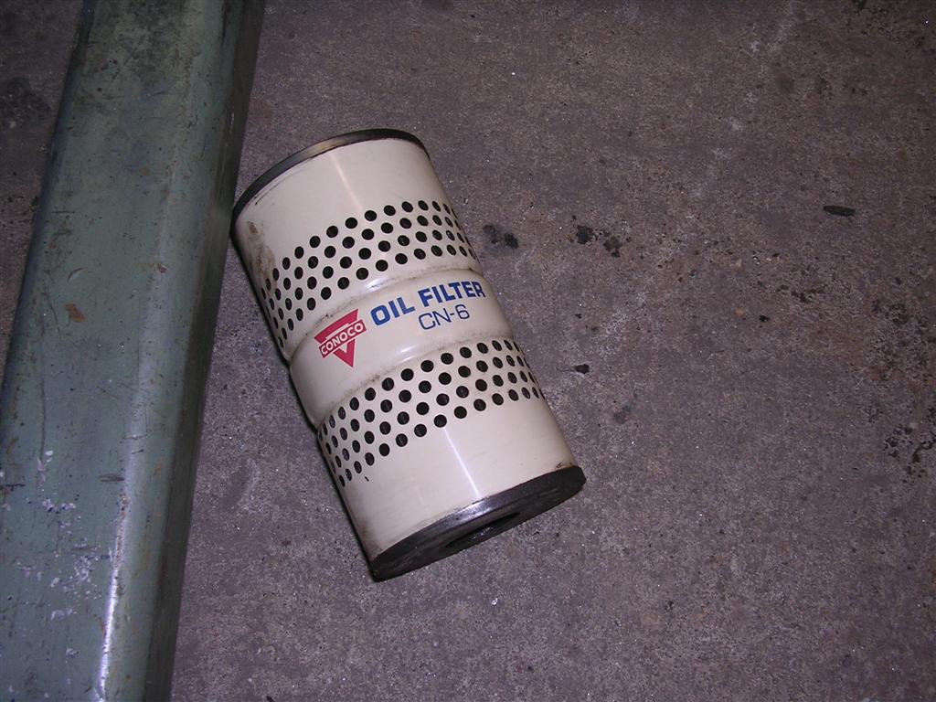

    Well, I lost exactly one week with the engine work, the motor is set to go back into the car in the AM. I only need to install the steering box which will be quick.
    Also a pic of the 37 Buick Roadmaster top shifter trans case... , that I put all the 55 Olds Selector transmission innards into.
    ..and a pic of an ancient Conoco oil filter that came out of this motor...this motor has been unused for 40 plus years I would guess.

    It was a .002 over bearing, so the cut is .001 per side. That bearing was electroplated, rather than a bonded layer of babbit.

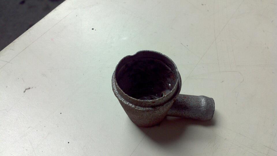

    I'm pretty sure it's 63-67 chevy small blocks had the road draft tube hole behind the dizzy setup to take a hose that went to the pcv on the carb. my 283 is full of rubber plugs and drilled and tapped holes to make it fit a late model smog setup. even had a Q-jet with egr on bolted on it. :rolleyes:
    after the issues you've had with your olds I'm pretty sure I'm gonna open this sucker up and give her a look see to make sure it is what I was told.
  29. Dave50
    Joined: Mar 7, 2010
    Posts: 1,751
    Dave50
    Kev i think what you mean is that they deleted the road draft tube in 67-68 and used a small tower looking cap and had a 3/8 tube out of it that went to carb, the draft tube was deleted i am pretty sure i have one here i will post pic when i find it.
    OK found it i think this is what you want?? Sorry for posting on your thread Frank
