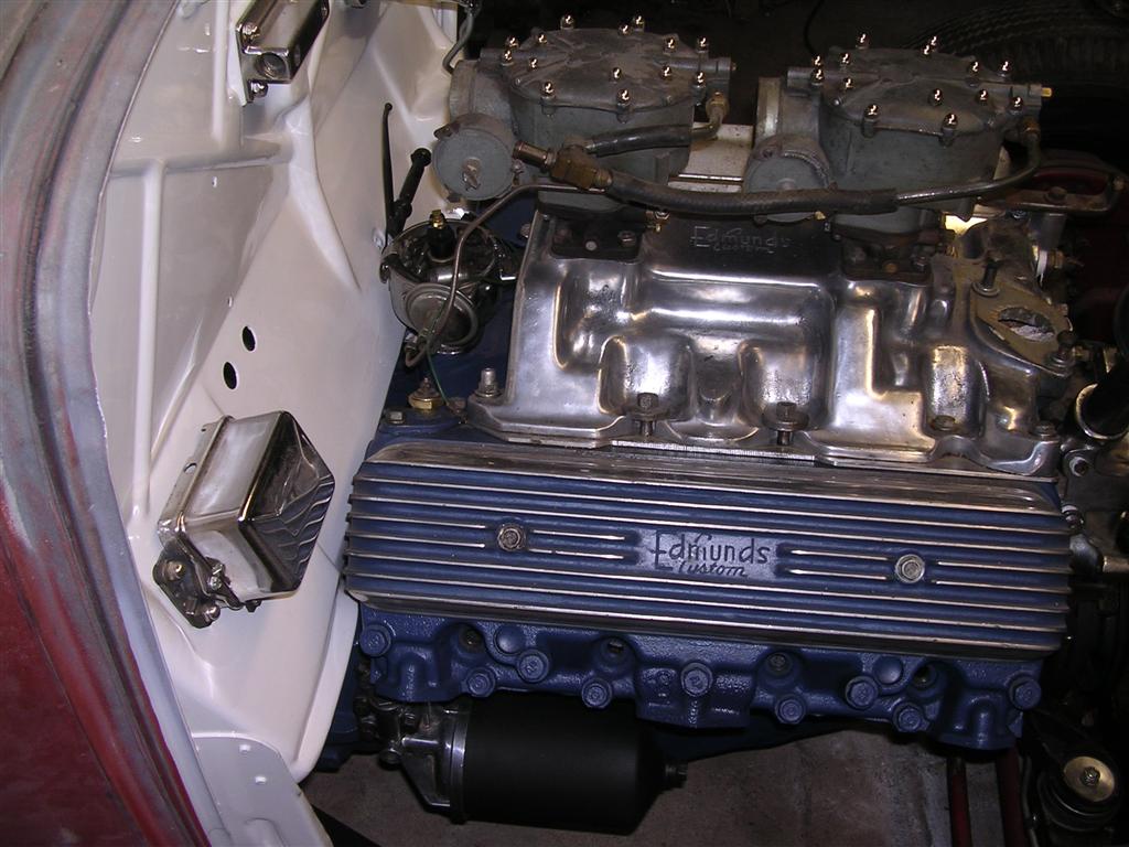

    Maybe my luck is changing; I did not wait for help this morning.. I slipped a long sleeve leather welding glove over the trans tail, and rolled the car forward...and it went right in with no damage. (trans shift cover removed, of course:) )
    It looks better in there, than on the floor all apart. Hope it stays in there.
    Yes, one more valve cover to polish and paint. I'm tired out..:(
    And I forgot to say why it slid in so good; the middle pic in post 145 from yesterday shows wide angled feet for the trans bell mounts. Those actually worked great, as when the motor starts to go in, those feet catch on the lower flanges of the center X. So the whole deal slides in like a drawer, and it can't "go too far" to dent the firewall, it stops as the tapers jamb together. Self aligning from side to side,, as well. At least I got one thing right :)

    NICE!
    I like the way you did the gas pedal too. I still have mine mounted in the stock firewall holes and I think it might be a slight problem when I go to time the motor.

    Frank, I saw those pictures and all I could think was "Man, that looks sweet!" Congratulations. It's looking great.

    Frank IT LOOKS AWSOME!! Man you should be doing the charlie chaplin dance ;) I think i paint my firewall... Maybe same color as the rims? Go man go looks great cnt wait to see it and hear it! I wish i knew how to post videos

    Wow! That is one good looking engine bay!

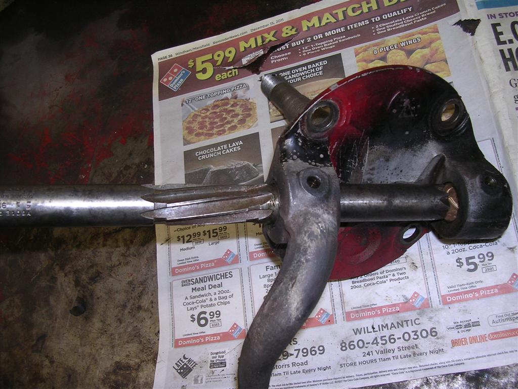

    I was waiting for the brake lathe to make the last slow finish cut on the drum and decided to do the king pins now. Well the reamer is a tick under due to wear, so I am hand honing the last.0005 :rolleyes:
    And I did get one side done, but the kit had 4 very thin shims to take up wear between the spindle and axle. My driver side has more wear than all 4 shims could fix. I used to be a VW aircooled mech, so I knew I had NOS king/link pins with shims in the barn...I hate looking in the barn.... but right when I gave up looking.. I found them. One VW shim and one "real" shim did the trick.

    Pics of 2 different styles of king bushings. New kit had steel backed Cleavite with better grease travel grooves, the other plain br*** on is from a 40'-50s aftermarket kit.
    Some guys were having troubles with reamers: This reamer has a "rough cut-undersize" tip, then the main finish cutter more towards the top.
    The best way to use these, is to leave one old bushing in, while you go down through the old one, to rough cut the new one.
    Now, don't do the finish on the first one; put the other new one in, and go down though the first one, to rough the 2nd one. Now you have aligned both to each-other, and now you can do the finish on each, from opposite ends.
