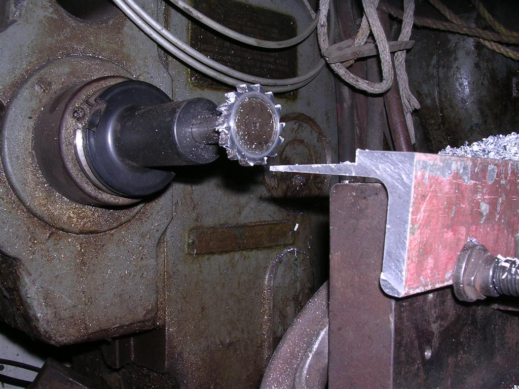

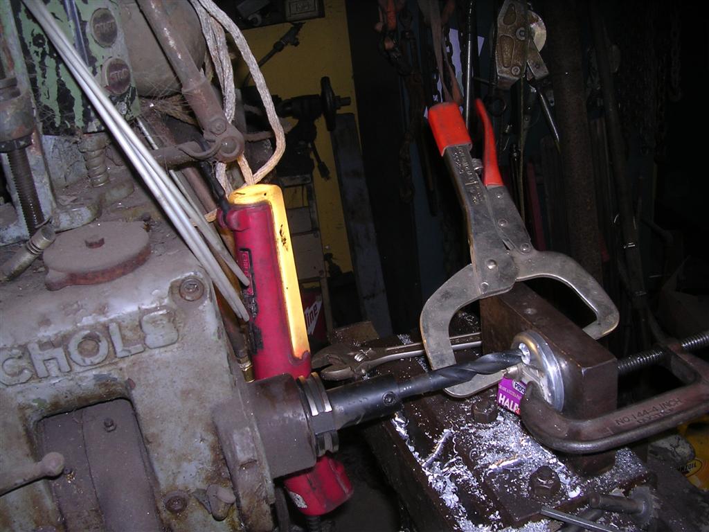

    Ok, this morning I was mounting one of the Edmunds aircleaners and noticed the slightly domed circular shape would be a good idea to copy for lake plugs..
    First pic, a big chunk of 1/2" thick aluminum angle. I cut off a piece in the saw, and chucked it up. I did the doming before doing the final parting cut.
    Then flipped it backwards to cut a groove to match the ID and OD of the lake pipe/ That groove will get thin asbestos cord for wood stoves from the hardware store.
    I don't have a Bridgeport, so I counterbored the 2 mounting holes on the horizontal milling machine. There will be thin, soft copper gaskets under the acorn nuts to seal them.
    as soon as I fix my mig, I will weld 2 studs in each lake for the plugs.

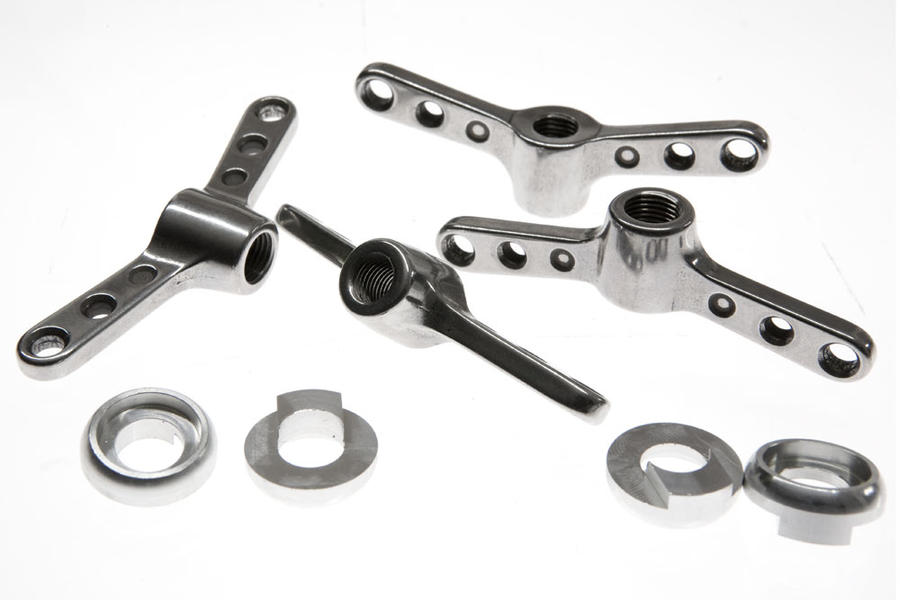

    Here. One of these in the middle. WAY cooler than two acorn nuts. Easier to open too...

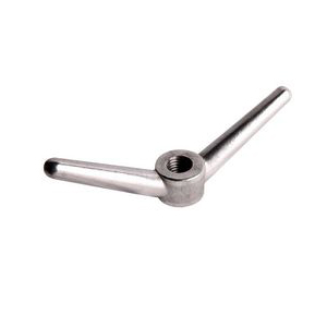

  8. falcongeorge
    Joined: Aug 26, 2010
    Posts: 18,339
    falcongeorge
    from BC
    Or if you want something with some '30s Indy car panache...
    And you wont find either of these in a So-Cal catalog. ;)

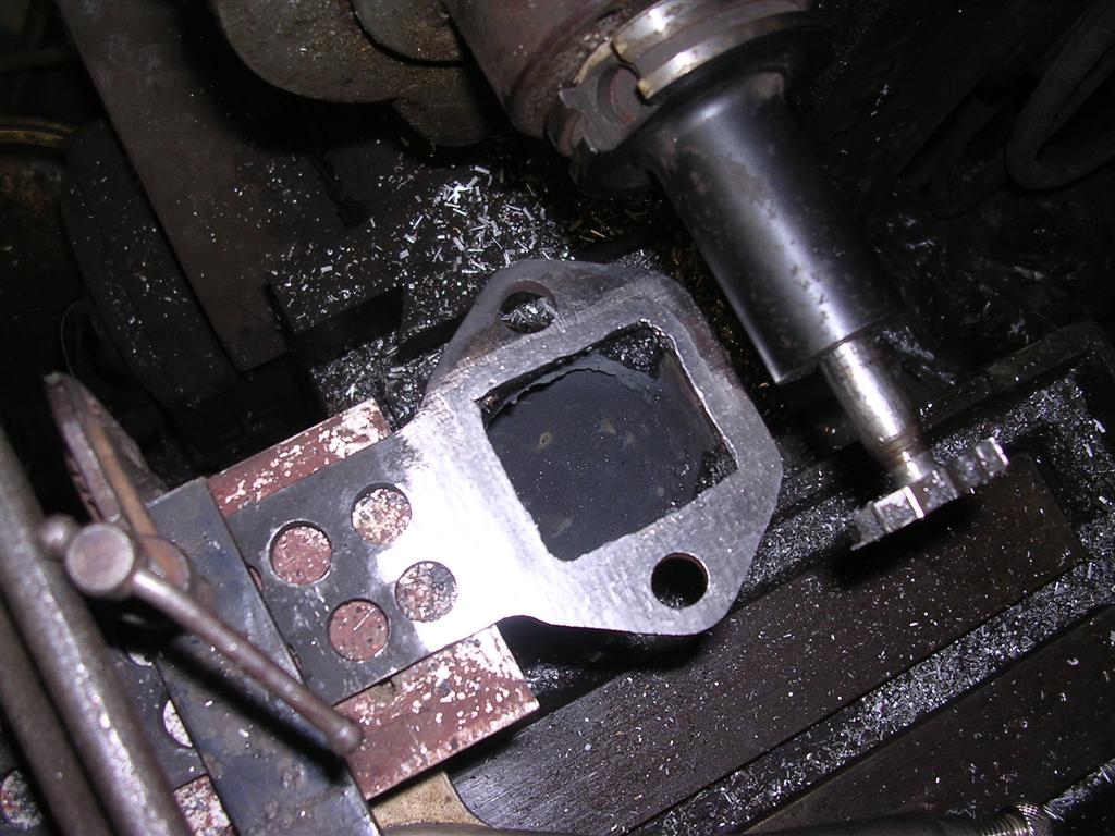

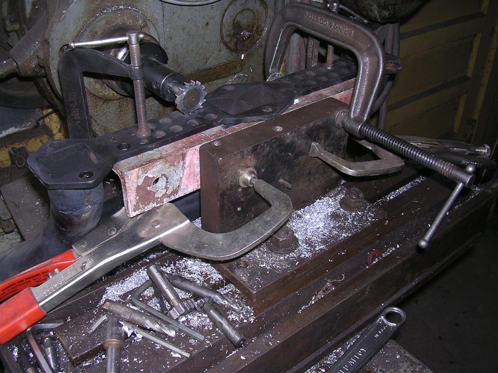

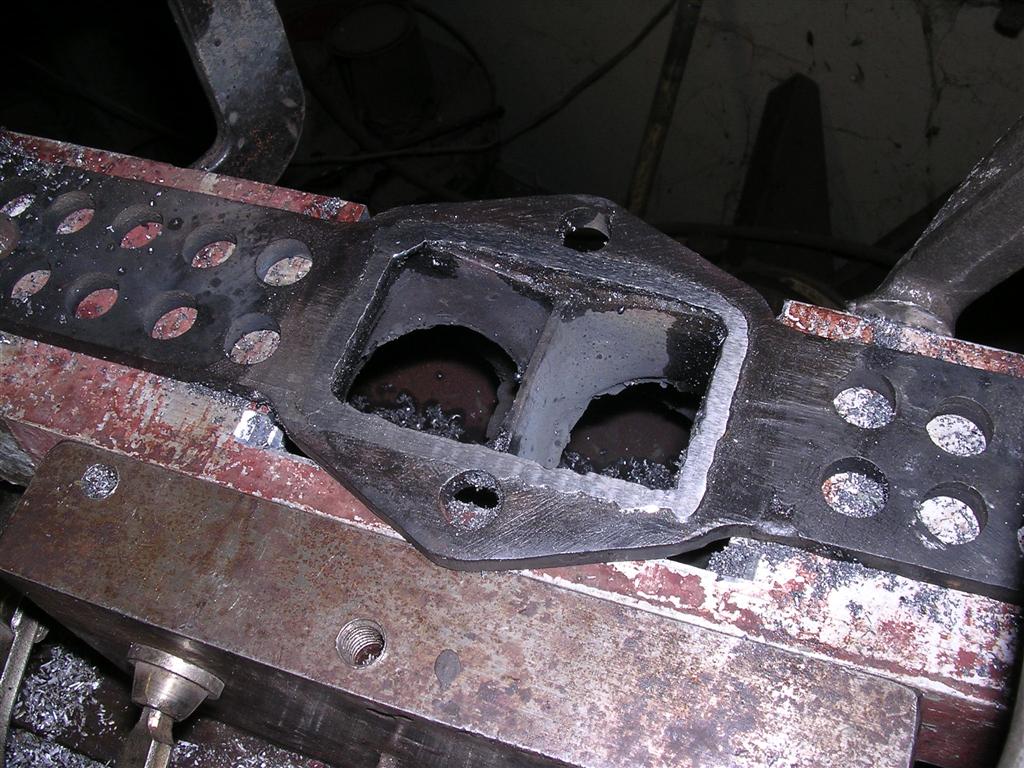

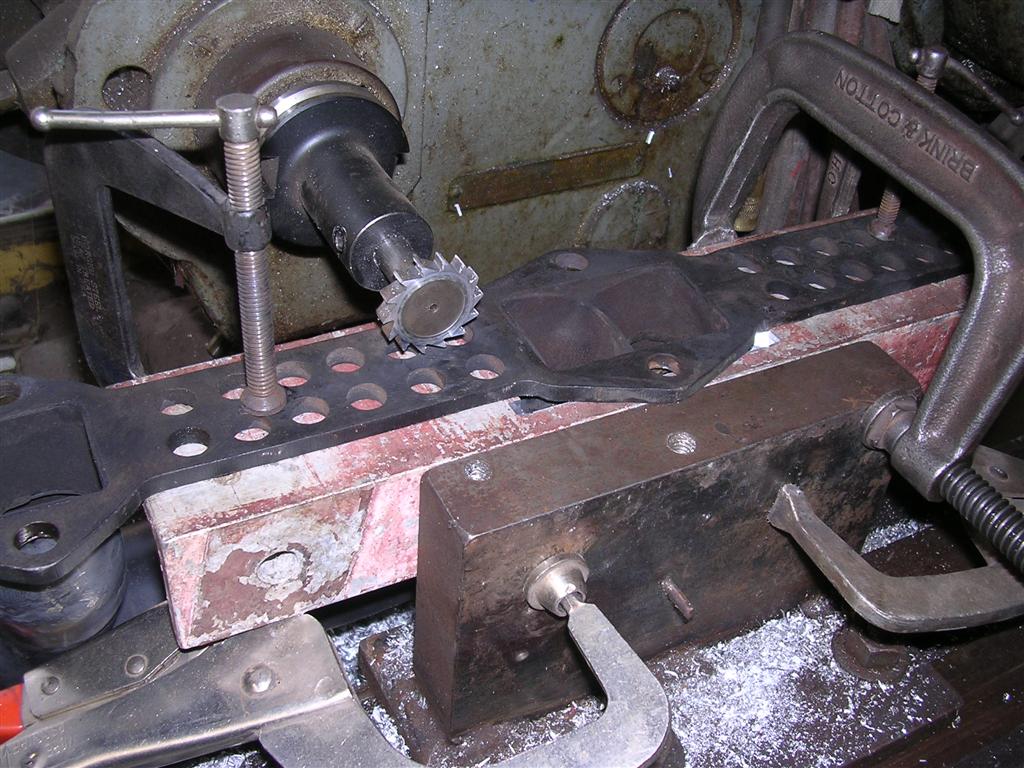

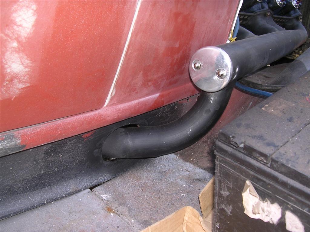

    Now I have mufflers, I hear an exhaust spit on the drivers header. I don't want to use thick white gaskets, so I need to machine the header flanges at the ports.
    I want to weld a bead around each port which will need to be made flat, but I needed to see if there was any way to set the header up on the horizontal miller. I tried many combinations to try to get close enough to the cutter. Horizontal millers don't have much bed sideways travel, so I will need to move the fixture in the bed T slots to reach the end ports.
    The first pic shows making an adaper plate made from aluminum angle. I needed to cut a wide notch for the center port tubes; did the 2 easy cuts on the saw, then used the miller to knock the piece out.
    I finally got it set up so I can reach all the ports...but, because my headers now have the muffler connector welded solid, that pipe hits the bench:rolleyes:. That can't be moved, so I need to rotate the miller 70 degrees away from the bench. Now I can weld the beads, move the machine and then see how it goes.

    Well, I welded the ports, then milled the center first because that one should show more weld all the way around after machining. Got that done, then never touched the height of the cutter, so the rest would be on the same plane. I think I got it right, as the front port should have shown just what it looks like now...going by where that gasket was sooting up.
    I thought a few things would go real wrong, like snapping the cutter, or having the clamps get loose, but it went real good. I'll put it on in the AM. I am using some satin black, real thin, burnproof gasket paper...maybe .008 or so? It did not burn through where the bad leaks were, so I wish I could recall where I got it years ago. I have more than enough, but I'd like to get more.

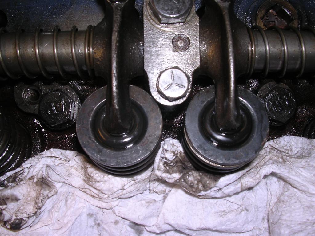

    I posted a while back that I had to convert to 1.5 ratio rockers and stands because my new-old cam is ground for 1.5. I was looking at everything today to look for valve train noise.
    I can't believe I missed this earlier, I guess I was more concerned that I had the right pushrod length:eek:. First pic shows the rocker stand was drilled slightly off when new, and the valve retainer is hitting it with valve up. 2nd pic shows how it should look.
    In total, I had 3 retainers hitting, so I clearanced those and checked any close ones with a piece of paper between, while pushing the retainer towards the tight spot. If it did not grab the paper while I moved it, that's good to go.
    These 3 only hit at dead top, and barely hit, so it was not causing any odd noises.
    As you know, these motors don't have a spec for lifter pre-load because the original rockers are not adjustable. When I put the rockers on during the cam change, I went very light on preload. I found the point of zero lash, then went barely 1/2 turn further. It's a 3/8 x 24 thread, so a half turn is maybe .030?
    On resetting them today, I went a bit more than 1/2 turn, after backing them off to find zero lash again. I was trying to quiet the rockers. Dam motor skipped and clacked like everything was wrong...(tight valves).
    My friend showed up and we decided to go light again, but even less preload. I handed him the wrenches:D...he's got good feel being a machinist. We are at maybe .015, and of course the skips are gone, but it still kind of sounds like a solid lifter minor lash noise.
    I can't believe the setting is so touchy? Any thoughts? These lifters do bleed down quickly, just not as quick as the tired 303 in the other car. In other words, the valves eventually will all close after shutdown:rolleyes:... but as soon as you barely crank the motor with key off, they recover in a split second.
    So, I guess I am just going to run it...unless you guys got something;). I am not at all worried about the motor, I would drive it 100 miles if I had plates/insurance.
    BTW, I am positive it is a hyd cam grind. I checked and rechecked several lobes to see what it has for a "lash ramp"...it's a hyd sized ramp; very short in rise, not enough height to be solids.

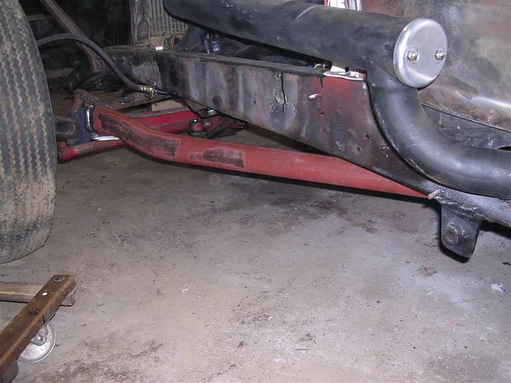

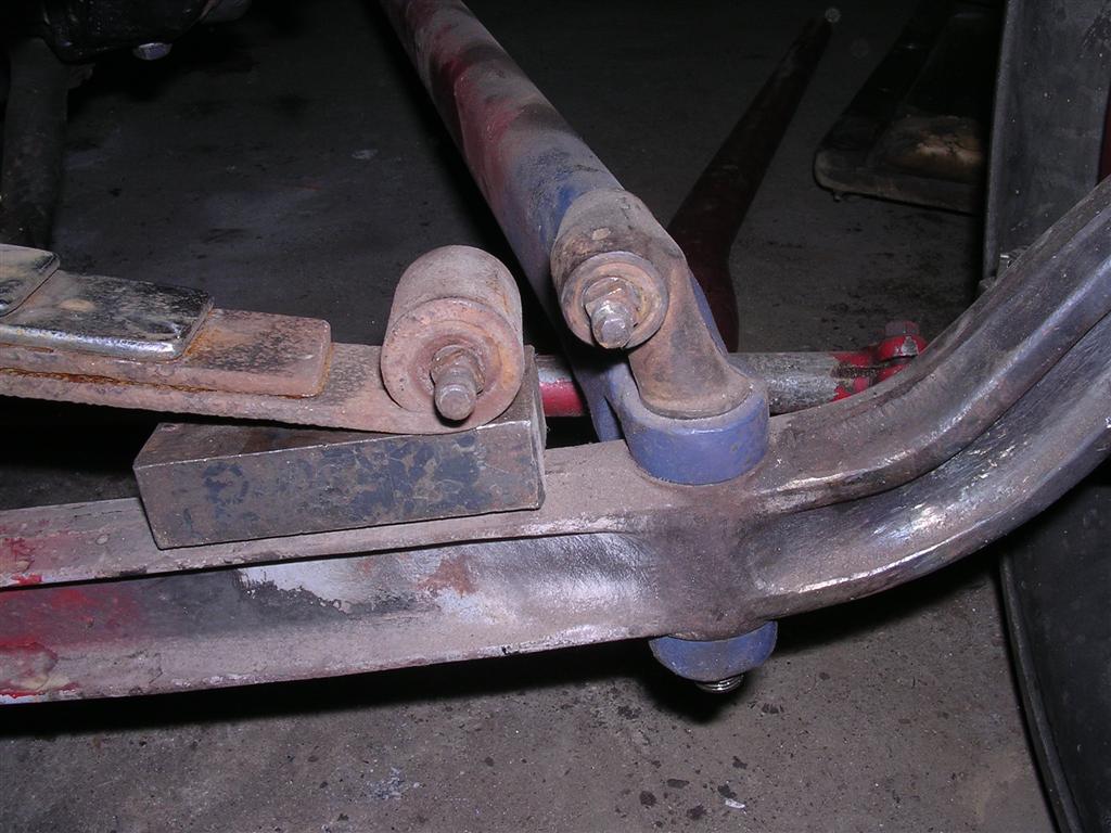

    I finished the rear axle settings so I could finish weld the trailing arm mounting plates. I also put in shocks with another crossmember ahead of the axle.
    Today, I can't believe I took the front end partially apart to switch the 35 front bone tubing to the 46-48 bent tubing. I did not really need to do this, but as the rear of the bones go pretty far under the car, some people who have been here thought that the back ends of the bones will hit the frame over bumps.
    I did check that by jacking one wheel way up, and it is fine...but I will do the bent bones so that nobody else wonders :)
    Another reason to cut the bones apart, is that I am now definately going to try a radical change in caster. My car has a very heavy motor, good offset(scrub radius), medium size bias front tires, larger bias in the back...but.. I am using a very fast ratio Ross steering box as cross steer. The 7 to 8 degree caster that is always given as gospel does not seem to be right for this car.
    The frame was from another old rod and has old bone brackets at the outer rails. I have relocated new bungs to go under the car. If I use the new mounts, I am at a little less than 4 degrees, if I use the old mounts, it is 5.5.
    If I jack the center of the I beam up to take the weight off the tires, my steering will go all the way to hit both factory stops. It does not hit the stops if the weight is on the tires. It bugs me. The caster must be a part of this..
    So, I am going with even less caster just to try my theory, if it goes bad on the road, I'll let you know.
    First pic shows how to sneak a single bone out with a reversed eye spring, without any special skills/tools. Just jack the frame horn tip up until a steel block slips in between the spring and axle...then lower the jack untill the shackle has no side load.
    2nd pic shows the previously trimmed and slimmed 35/36 front bone yoke lined up with the 46/48 bent bone.
    3rd pic shows that there is plenty of bone-to-frame clearance with this setup. Also, it still has the same room for the tie rod up front.
    In the AM, I need to spend time leveling the 4 spots where the tires and alignment tables will sit. I use plywood/boards/shims to get it dead perfect. Then I will be on true alignment tables with the old style magnetic alignment head, to get a much more precise read on the caster and camber, too. An angle finder is sketchy unless you know it is perfectly aligned with the F to R centerline of the car. a slight variance won't be good if I am cutting the caster so close.
    Once I get help to hold the axle beam/perch to the exact degrees I want, then I can weld the bone together. If I get some accuracy, I will offset the caster 1/4 degree to compensate for road crown...but i am not sure I can get it that close when tacks cool..:confused:
    Oh, and I found out that my spring does not have the same OD on the bushings as the perch. I need to use new Model A shackles to make more room for front shocks. I need to make 4 new bushing now.:( The A bushings won't fit either hole.
