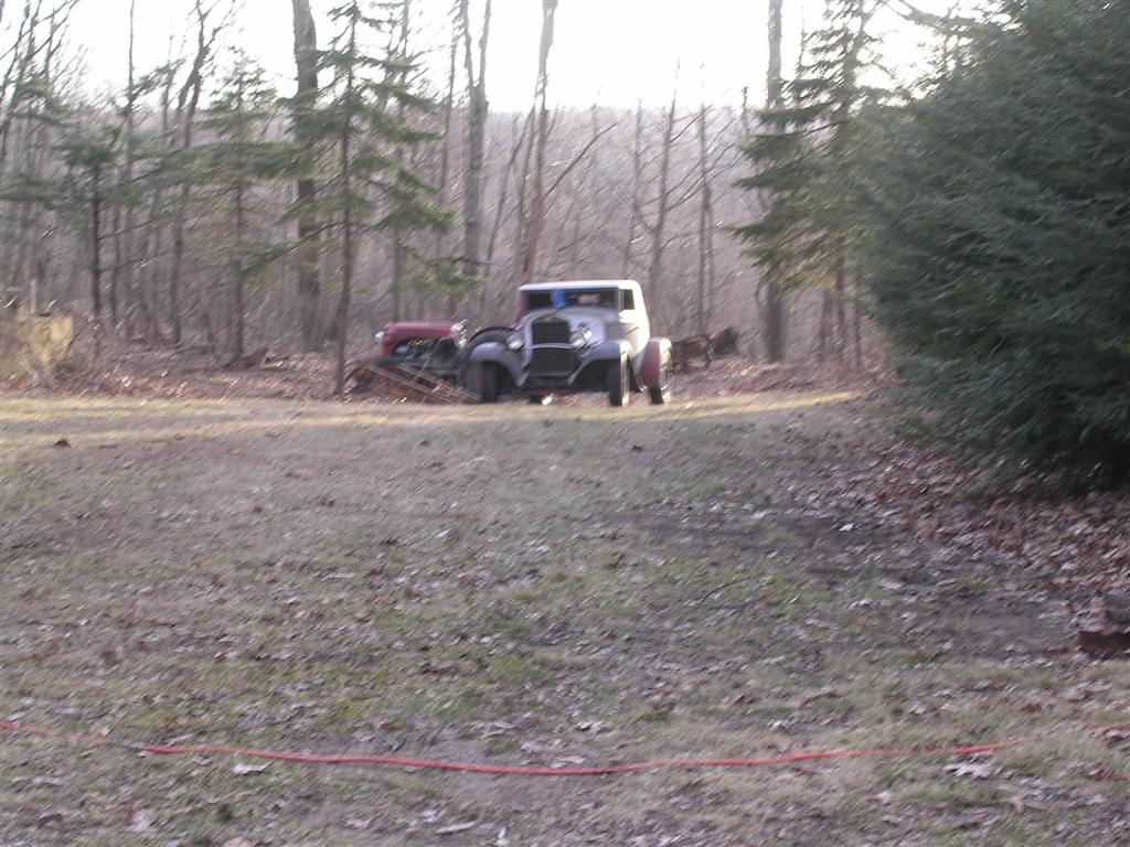

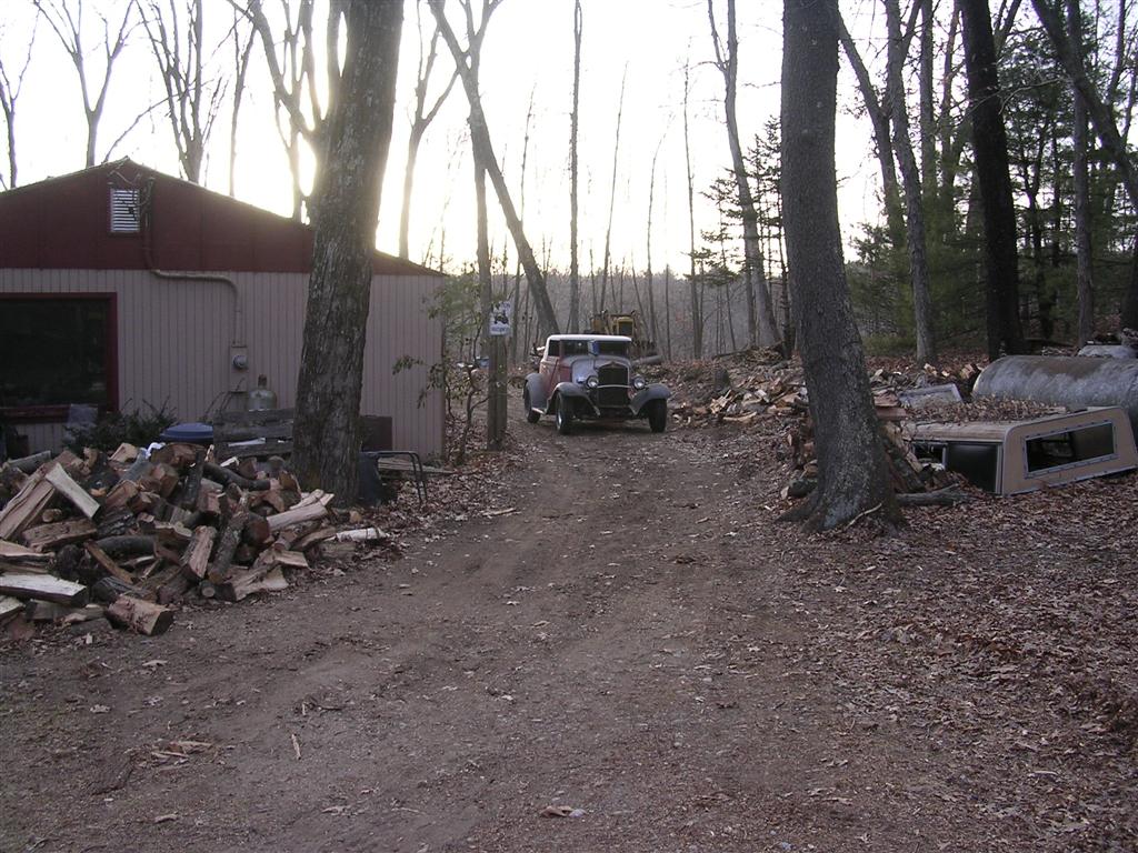

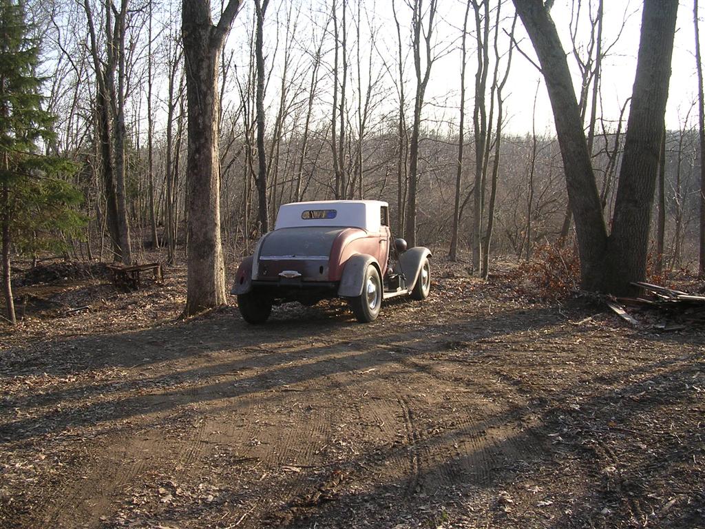

    I thought someone would like the last distant pic. I always look at hambers pics for scenic stuff. If I can get the car fit for the road, I will put up some real scenic pics; the first longer trip will be to RI, at the Beavertail Lighthouse, overlooking the mighty North Atlantic Ocean. It's a stunning place the day after a storm, with bright sun and incredible waves.
    George, I don't have much land and I am on a busy state road...but.. that valley showing in the last pic has a decent sized river and a major Railroad line. It's pretty cool to hear 3 engines pulling the slight grade and listening to the diesel horn as they get near the crossing 1/2 mile up. Some engineers are pretty talented as to how they do the horn, almost like music...but some just do the mandatory stuff. Sounds so cool on a quiet summer night.

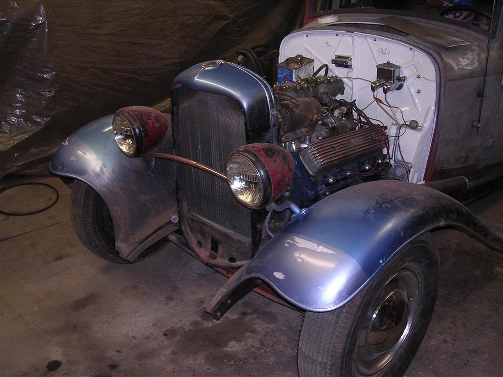

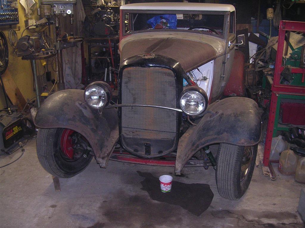

    Ok, I just finished the front spring mods, it all fits so perfect now, and fenders back on to be able to build the top front shock mounts...bottoms are done. Then more drive tests to see how it feels. Warm day for a ride :)

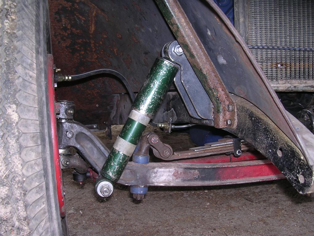

    I had a good day today, all went better than normal. I changed my mind as to what size of front leaf I would put in. Instead of a long one that would stiffen the normal crusing ride, I went with one about 1/3rd down from the top. That will give more backbone as the spring goes into max compession. It worked. Got some more arch without much stiffness. Also pulled the 2 shorty leaves at the very top and installed the caster shim.
    Changing caster as much as I did, actually changes the WB slightly, so I needed to shorten the split bone rear adjusters by 2 threads. It all fits and looks great.
    Then modded these shocks; the mounting studs came from Chev truck front shocks. These studs go on the axle, welded like the old days. But the shocks had bushings on the wrong ends. I just soaped them up and used the new stud to push the old bushings out. Doing two jobs at once :). Then just push the bushing into the top eye.
    Made shock brackets from 3/16" flat stock and welded to frame. Done.
    Then such a nice warm day for testing. I drove around a bit and was feeling more confident now that the suspension is all glued in good, so I did a few "dirt road burnouts" :D. I still can't find another 56 Olds rim for the driver rear, so it's a bald 16". The car consistantly spun both rears just like a posi..he.he. What a flashback...*** end going sideways, engine tacked up and the straight cut first gear singing away...it was fun, I tell ya;).
    My kid wandered out after hearing that, so I had him drive it all over so I could watch the F & R suspension working. It's still too stiff in the rear, so I will fool with that in the AM. It really pays off to watch the car like this, when setting suspension.
    I went in for a coffee while he was still driving. His G/F came home with her car, and my kid quickly pulls up alongside her driver side and starts revving the engine... Ha, ha... that's my boy.:cool:

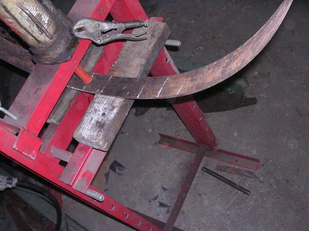

    Hard work today and a lot of time, trying to tune the rear spring. This is a 40 Ford "front" spring in the 32 crossmember with 35 bones.
    I learned a lot by watching the suspension move while my son was driving it yesterday, as well as what went right on the 32 front spring mods I did get right.
    I looked at the spring pack while up on stands and chalk marked which ones I would take out, then just studied that a bit. I ended up taking one medium length and 2 more that were halfway between that one and the top shorty leaves.
    I knew this would lower the car a lot, so I faced the fact of having to re-arch the entire pack, one at a time, with the press.
    If you look at the loose leaves; each leaf is slightly curved tighter than the one under it..they are all different. So I recurved the main to match the one above it, then did the same, all the way up.
    Spotted a cracked one, but I had another donor 40 spring to get the right one.
    Pressed about 1.5" between each push. The main was a tough one to get enough curve, the rest went better as I got better at it.
    But, when I decided to test ***emble the pack on the floor, it was SO curved up, that I knew I could not build the pack up in the car. The spring was almost a true half circle:eek: . At that point, I thought I should de-arch a bit, but I figured I need to start somewhere. Problem was that i could not get the spreader closed up enough to fit this goofy spring. I stood it up on it's tips on sheet metal plates so it could slide on the cement as I sat on it, to get the spreader hooked.
    By the time I adjusted it out, it seemed very dangerous, like a huge mousetrap. But I did get it in. I lost 3/8" ride height but it felt real good in the shop, bouncing it. It was near dark and I was dying to test drive...but the 1 gallon tank was almost dry:(. I did drive it forward out of the shop quick so the rear would drop off of the cement into a dip. It felt good, so I gunned it in reverse to hit the cement real fast. None of the parts in the trunk jumped off the floor, so i think I got it:D It feels real promising.
    Even used Ford spring grease for springs...sheesh

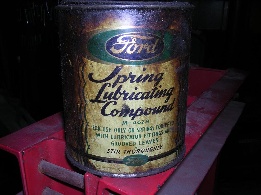

    and my Dads old OTC spreader from when he ran a shop through the 1950s..

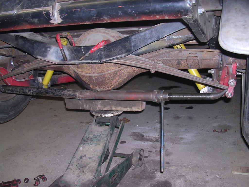

    More driving and.. I give myself a big red F on the rear setup. The more I drove, the more the axle was hitting on the Rt or L frame kicks. It still felt way too stiff on the springs:confused:.
    I had my son drive it so I could see what was going on, and even on a fairly smooth surface, the car twitches up/down about 1/2" like the spings are too stiff. I put the car away for the day after I saw that I lost 1.5" rear ride height!
    Pretty discouraged, but I went back to the shop at night and disconnected the rear shocks, and was shocked to how it changed. A 5 year old child could bounce the rear of the car up and down 4".
    So I went through the hamb archives for 28-34 rear shock threads. The consensus is using 63-67 Corvette rear shocks, but those cars have way more weight at the rear than mine.
    Todays attempt will be ultra soft front shocks from pre-66 VW bug. My son has a 59 bug buried in the shop and I think it had new shocks:D.
    My son says I need one super long leaf added to the spring, and I do have one that wraps halfway around the main leaf spring eyes, I guess I will put that one in after rearching it, and add a 1/2" spacer in the spring mount.
    The shackle angle is way off now, so if I can't get the arch back, I'll need to re-roll the eyes. Not having much fun at this point.

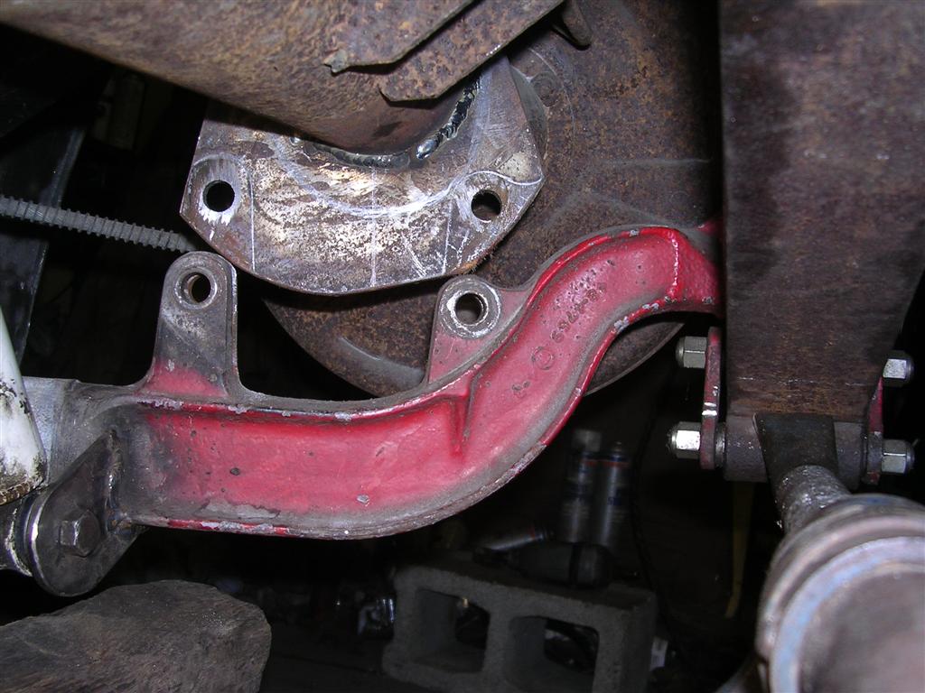

    Back on track today. I stole my son's front shocks. They are KYB gas filled. I put them on with a simple swap of upper bushings and noticed the gas pressure raised the car back up 1/2 of what I had lost.
    I drove it around and it feels so much better, and i think a gas tank and rear mounted battery will make it all good. But still too low and still hits the frame on hard bumps, and the shackle angle is too light.
    Here is what I will finish tonight: I have decided to cut the rear bone mounts partially off, then push the bones to the outside by overlapping the cut off piece on the outsides of the remaining mount plates.
    This will: Move the shackles to get a good angle, and by creative cuts, I can get 7/8" rise on the body directly over the rear axle tubes. I am also moving the rear 3/8" forward as it needs it. These plates went in when the car going to be fenderless, and the centerline is a bit off with fenders on.
    Sounds mickey to do it this way, but if I had cut the entire plate off, then I would lose the pinion angle, lose the side to side measurements, and add tons of time to do set up. I already did one side, and it looks fine, just looks like a gusseted plate mount. Screw it. :)
    Going back now to cut this side and get it on all fours tonight to see the new ride height and new shackle angles.

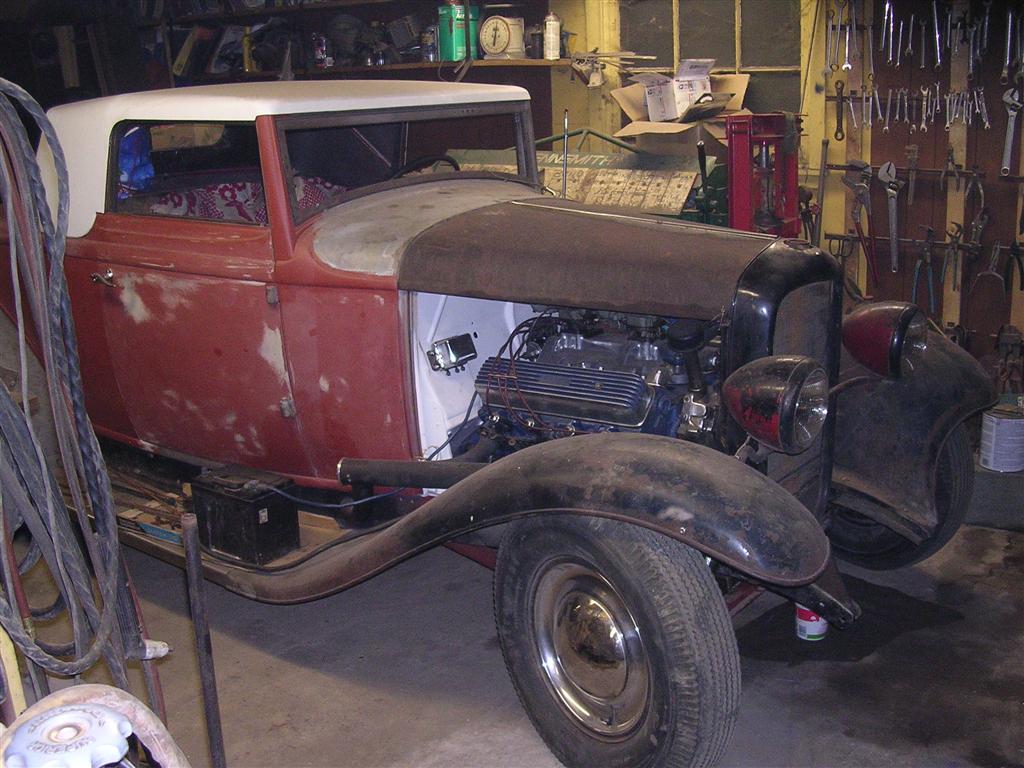

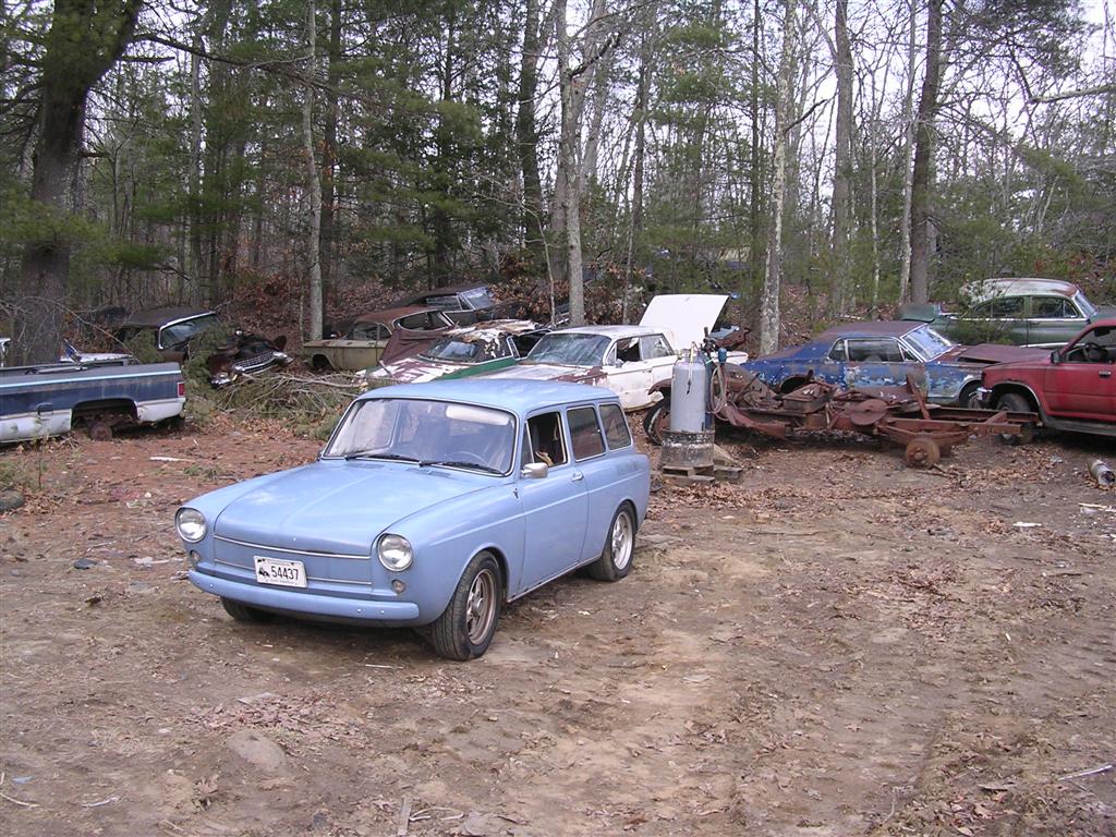

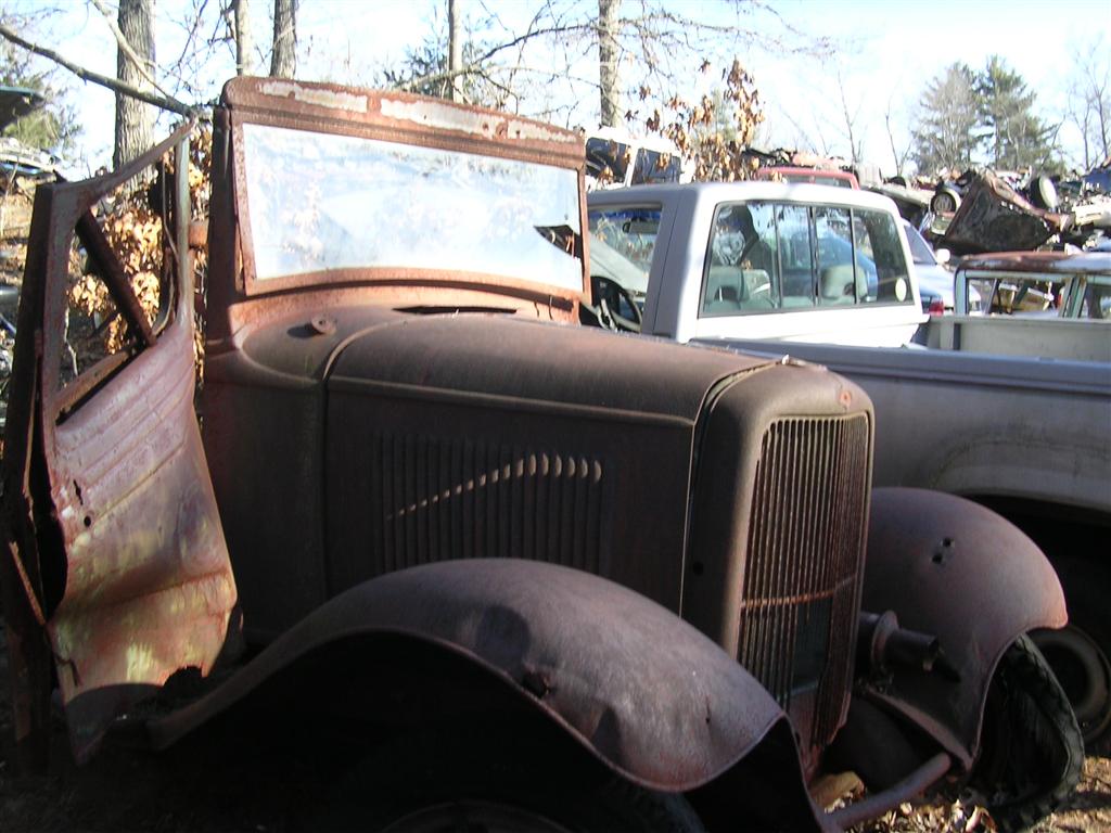

    Well, it ended up being one month before I went back to that junkyard, "for something for my car". ....a 32 Ford! How often does a 32 end up in a yard?
    ....32 truck, but I'll take parts where I can get them. Fred did not want to sell just a part or two, so I talked him into all the upper parts from rad, back to what's left of the cab, incl cowl, dash, firewall, column with lock and a key! etc.
    Fred went to get the payloader with the torch setup while I unhooked the hood rods & hood, hoses, cut wires and pulled up the wood toe boards. His wife showed up with a cooking pot of water and said "Frank, here you go, now you get to do one of my jobs; putting out the fires" :D . Ten minutes later and it was done, and loaded in my tiny station wagon.
    So, my build keeps changing; now it will have a hood top. No louvers because my kid says "the rest of the car has a smooth look" and he thinks louvers will clash with smooth.
    How about the old filled in cowl vent? Should I put one back in for hot summers? I almost want to leave it filled? My windshield does open, but maybe I need a cowl vent?
    Note the water leaking out of my old radiator...It's been leaking more as I drove it so much lately. I got a real nice one from that truck, and after cleaning it, it looks really promising. Also mounted the cowl antenna right where the old holes were brazed up, and put on the old mirror.

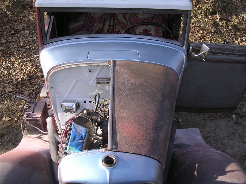

    Using a few minutes here and there while waiting for primer to dry on side job.

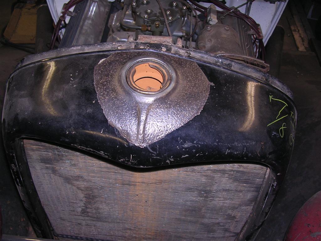

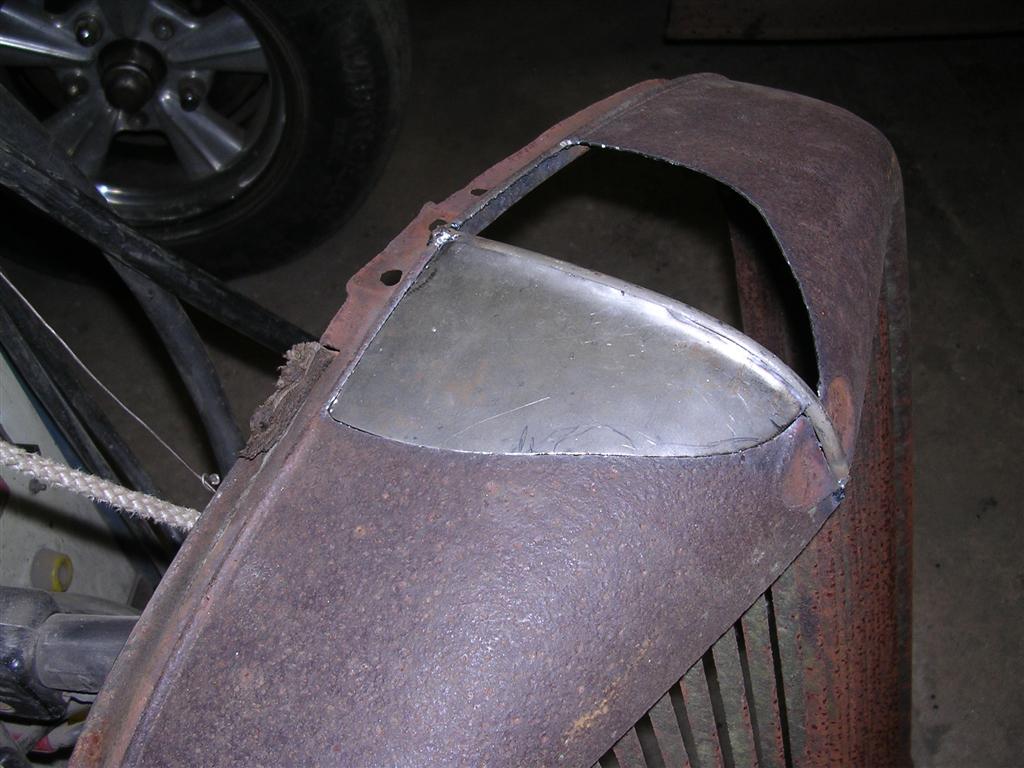

    I needed to fix the top of my radiator shell where it used to be poorly filled. To save time, I figured to use some of the rusty 32 truck shell for a custom "partly peaked" look, with a stock cap. That's Pic 1 and 2. Pic 2 shows a little rust gone from trying oxaylic acid and battery charger...I can't find washing soda, like has been said to try. The underside is now 100% rust free, but not the top. 6-7 hrs test.
    But after I ruined the truck shell, I decided to try to fix it, as well as learn how they did the fill 'n peak with a metal rod. Only a half hour so far, but I think I got it. I'll cut/fill the Ford oval hole later. I did not want to cut too much out at once to lose the shape.
  17. F&J

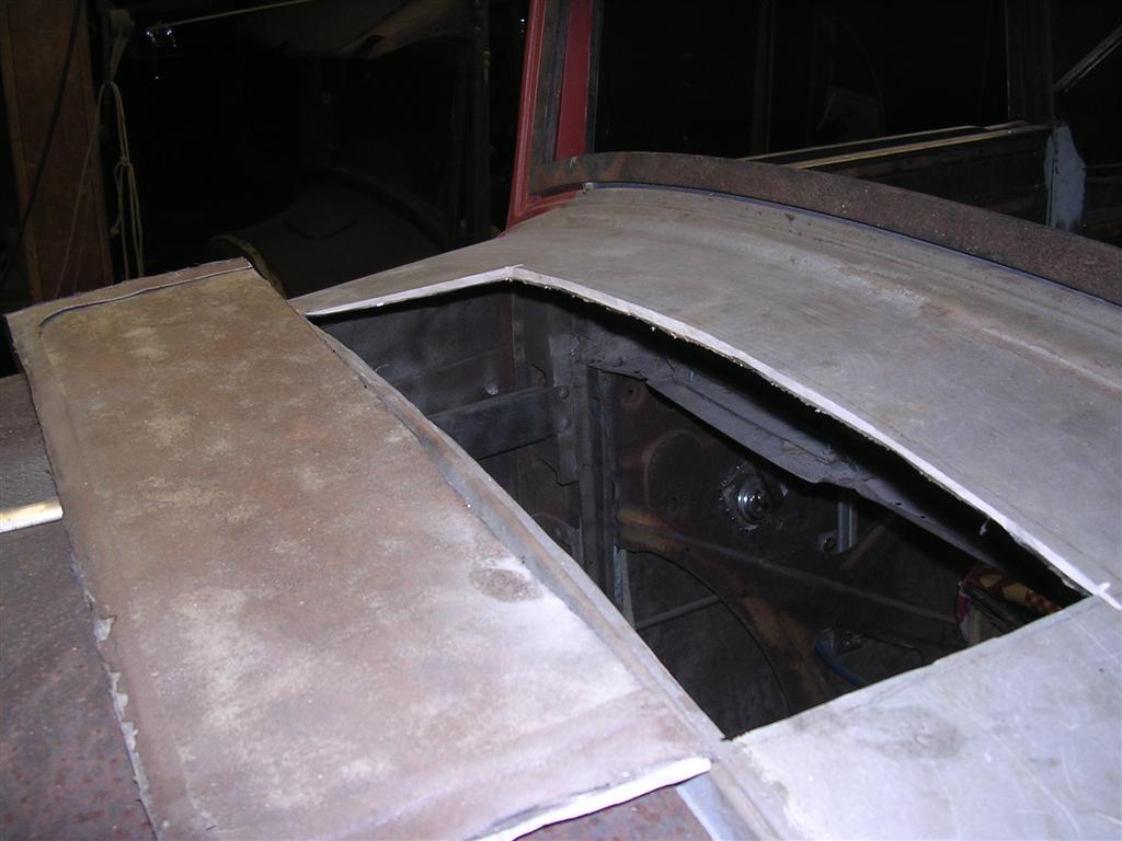

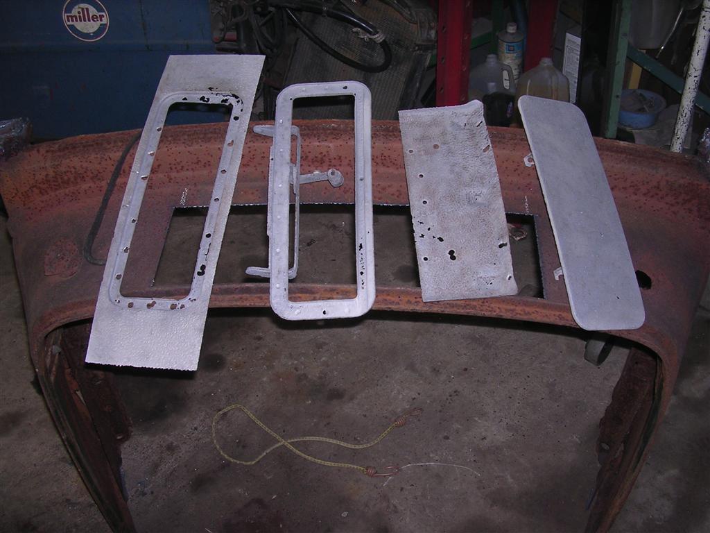

    Started off today cutting out the cowl vent parts from the 32 truck cowl. The parts looked iffy, so I drilled all the spot welds to sandblast everything including seams.
    After blasting, they looked about what I expected, but screw it, I can weld tinfoil with my old Miller 35 mig. :D
    So, then I cut out the previous cowl patch in the coupster. Yikes, that's deep bondo :rolleyes: 3/16 lt rear corner to 1/4 at rt rear corner.

    ...anyways, I am almost done with the cowl vent install. I almost decided to make a complete new cowl top, because it was so bad under the mud...but I got lucky; I did not have quite enough 18 ga left:D..so I fixed the old one real good;)

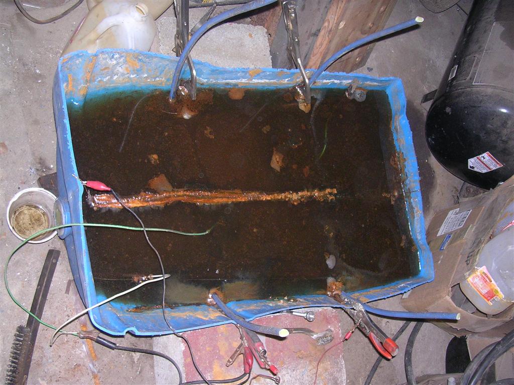

    Also trying the hood derusting by electrolysis... 48 hours so far... it's way too thin for blasting. I'll do some pics.

    Other pic is 1/2 of the hood top in electrolysis, trying to get rust off. I did have both halves in at the same time for 2.5 days, but one was shielding the other. Wish I could blast, because this is a pain to keep cleaning the anodes. The top long anode is only 3 hours old in the pic, and looks like it's been in the ocean for 10 years :)

    i don't know if they were made but could that splash pan have been for a model a with a spreader bar, and 32 shell? i like the look of that mesh, at least zoomed in, it has a denim like texture. i also like the bar down the middle. Ted
  30. F&J
    Joined: Apr 5, 2007
    Posts: 13,291
    F&J
    The guy I got the parts from, had finished his show quality 32 Ford stock cabriolet. All he had at the swap were 32 ford parts. It does not seem to fit too good right under my shell, My shell is beat up, as it came from a channeled car, though.
    That mesh;... I should have done a pic from the other side. It shines more from the drivers side, due to the way the metal folded when slit/expanded.
    I thought of cutting the sheet down the middle to flip it, but there is also a diagonal pattern going on, and the diagonals meet at the exact center for some reason. The sheet was also pre-bent right in the middle where the diagonals meet? Strange.
    Then I thought about cutting it down the center, flip it upsde down and backwards to get the patterns right, but my brain cells could not figure out if it would/could be right. So, I gave up.:confused:
