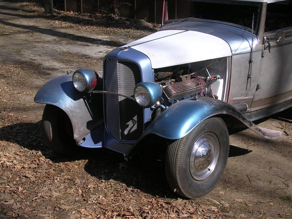

    I gave up on electrolysis on the hood because it was eating good metal and some areas would not clean. I ended up with "cracks" where the metal is folded, and I know they were not there a few days ago. I used worn out sand dust from a cabinet blaster.
    I almost wussed out by not putting the taillights back on the fenders on Monday, when I had it outside. But yesterday, I blocked off the rear deck panel to hide the other taillight holes, and then moved the lights up 2" and then moved them inwards 1/2", and it looks great to me in person. Some things are just not done anymore, but this is one thing I recall from the past, so I am going with it. I plan to have Charlie "Bandit" to redo the ultra fine white pin striping, just like it used to have.
    Yesterday is the first day that when I stared at the car outside, and said I actually like it. I am happy with all the details, so it's time to start slinging filler :D It looks like the style I remember around here.
    I also made up the spring loaded, hood hold downs, sort of like Tommy and Rolf have done. I may not run the hood full time, but I need to have it ready for paint with the rest of the car. It's pitted badly but i can fix it.

    Frank, are you going to run bumpers?

    I`m liking it frank doing gooood

    This was originally going to be a highboy, so it would be quicker to build and not have to look for so many parts.:confused:
    Yes, it looks very odd without nerfs or bumpers...but I can't do stock bumpers now that the rear frame is bobbed, AND I don't want to run a rear gas tank.
    so, maybe some sort of front nerfs, next winter. IDK

    it looks VERY New England to me. I like it a lot.
    i think a clean simple front nerf would put it over the top. but i wouldn't let that stop me from driving it. next winter's project...

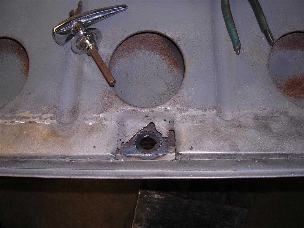

    My decklid is junk, and I did make new inner and outer lower patches last year, but never finished the latch area inside.
    I bought the NORS 37 Ford locking handle a few years ago from a CT swap vendor who must have bought a warehouse full of these...he always has one on the table...for years now.
    My son said it was too big and i should get something less noticable, but he's in Key West this week, so I put it on. :)
    I welded in a mag wheel thick washer in the outer skin, with a keyway slot for the lock pawl to lock into. Then made a thick plate to weld into the inner skin with a pipe bushing to keep the handle from feeling sloppy. I just need to make a simple J shaped hook to fit on the shaft, and that will hook onto a simple U shaped loop on the lower deck panel.
    Also got the taillight holes welded up on that panel. This panel was totally welded solid to the quarter panels when I got this body. It was a tedious job to cut the panel away from the quarters.

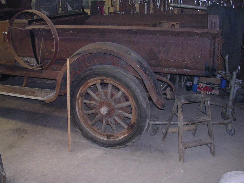

    I am stuck working on a elderly friends super rusty 23 Dodge truck. I've replaced the entire ch***is, spliced in a better donor cowl, rebuilt the lower tub, built a seat box that sits further back(he is disabled and needed more room), mashed and welded the bed back into shape.....and found a pair of correct 23 and older, commercial rear fenders at the Stafford swap 2 weeks ago. That's the same ch***is as a Dodge car; the Dodge's are huge cars. Yardstick on the back fender.

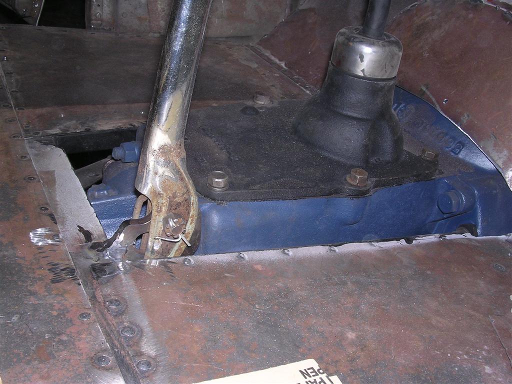

    Anyways, I did buy 2 1933/34 Ford E-brake handles from a vendor at the Fitchburg Ford swap Sunday, for $15. One had decent chrome, and the other one had all the mating parts I needed.
    On Monday a friend and I tried to find a way to bolt it to the 37 Buick trans, but there just was no room, this late in the build, without hacking.
    After reading Ted's PM late yesterday, I gave it a try again. I trimmed off most of the E-brake L bracket, and barely found a spot where it could get full throw without hitting something. I welded the shortened bracket right to the heavy wall floor crossmember. The 33/34 connector link p***es right under the floor crossmembers and just above the ch***is center X.
    Then I trimmed a hole in the heavily modded 60-66 Chevy truck trans hump cover.
    That is the last fab project on this car. I can't think of anything else that needs thinking/planning. :)

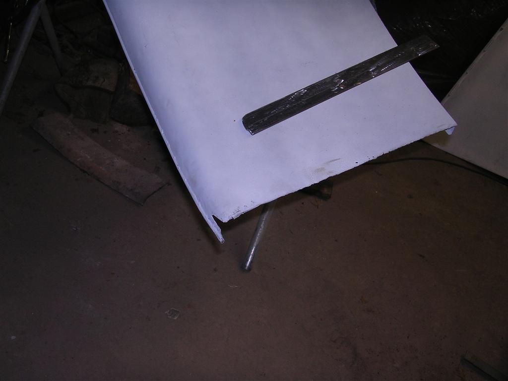

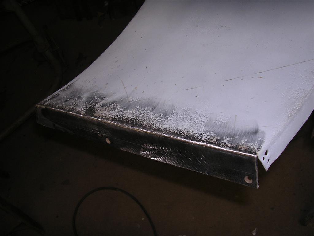

    Some more people asked why i am not posting. It's just metal work now that my son and I finished every last piece of sandblasting on Saturday.
    I'll do 2 posts to keep the pics in order/
    First repair shown is the Drivers front fender tip that was bent way up, and did not fit the frame horn. Car got hit in both fronts, right above the bumper.
    Mashed it down to begin with, but the curve is not right in the first pic where the X's are marked.
    Easiest way to recurve, is with a shrinking tool to shrink the lower 90 degree flange. My shrinker has always been mounted to a 2" long piece of channel iron to be portable. I rarely use it like pliers, but here is one time I did.
    I also welded the rip in the front where the downward part of the fender bends to meet the shelf part.
    After recurve, it needs to go back on the frame for final tweaking, which I did do later.

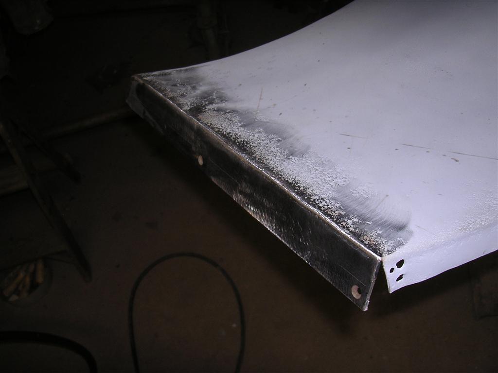

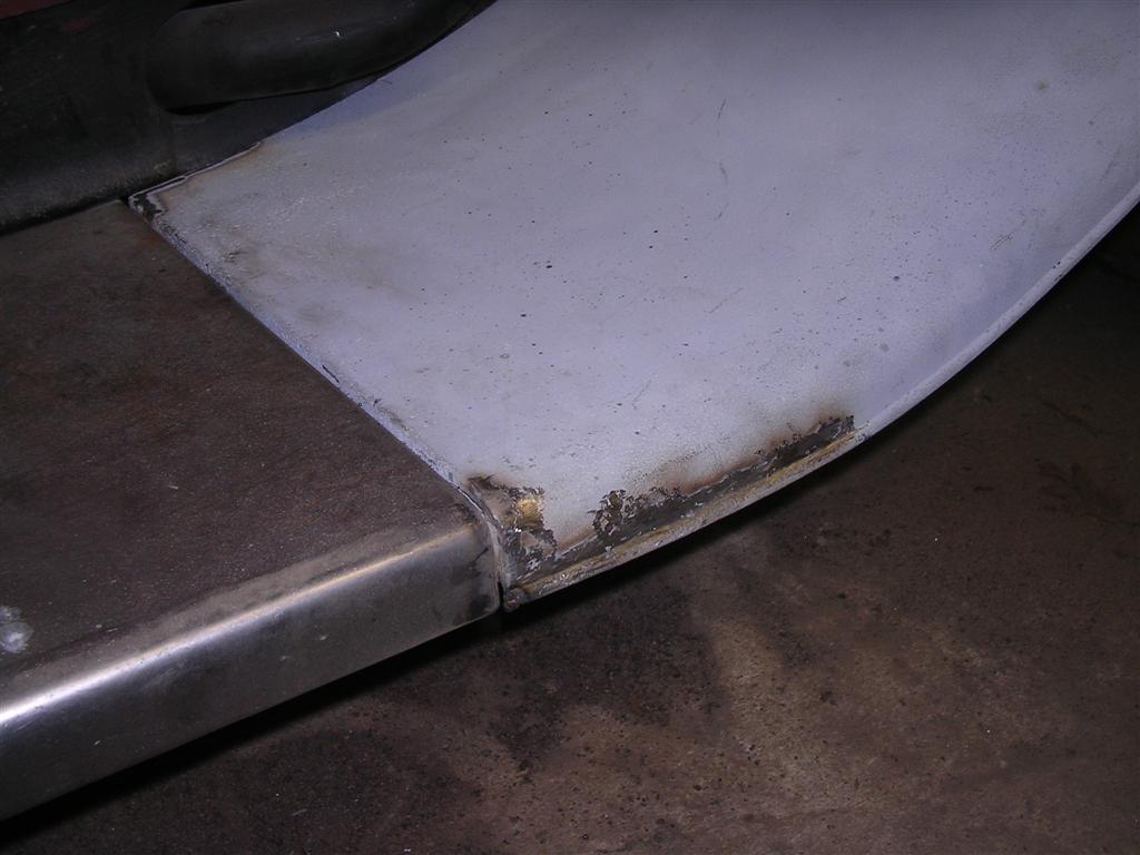

    First 3 pics are the rear tail of driver front fender. The rear flange to bolt the running board to, was full of holes.
    The original piece was the outer skin bent down 90 degrees, then another piece of slightly thicker sheet metal spotwelded on backside to reinforce the bolted flange.
    Easy way for me was a piece of .120 wall s**** flat stock. Pretty quick job with the mig, and then ground with a 36 grit 4.5" flap wheel. I can't weld the corners yet, as that new piece must be bent in or out to match the 90* flange on the homemade running board.
    Last pic shows the other front fender. I fought this one for a full day. It got hit hard halfway down the side, and must have stretched the wire edge bead. The lower edge right where it swoops down to meet the board, drooped down too much, then went back upwards to the board.
    It looked terrible, so I piecut it forward about 6" and recurved the wired bead edge, and welded it up. Getting the board to fit the framerail and fender was torture. I have read of some hambers pie cutting the fender tail from the frame, right out to the outer edge, but I knew I'd better not do that;)

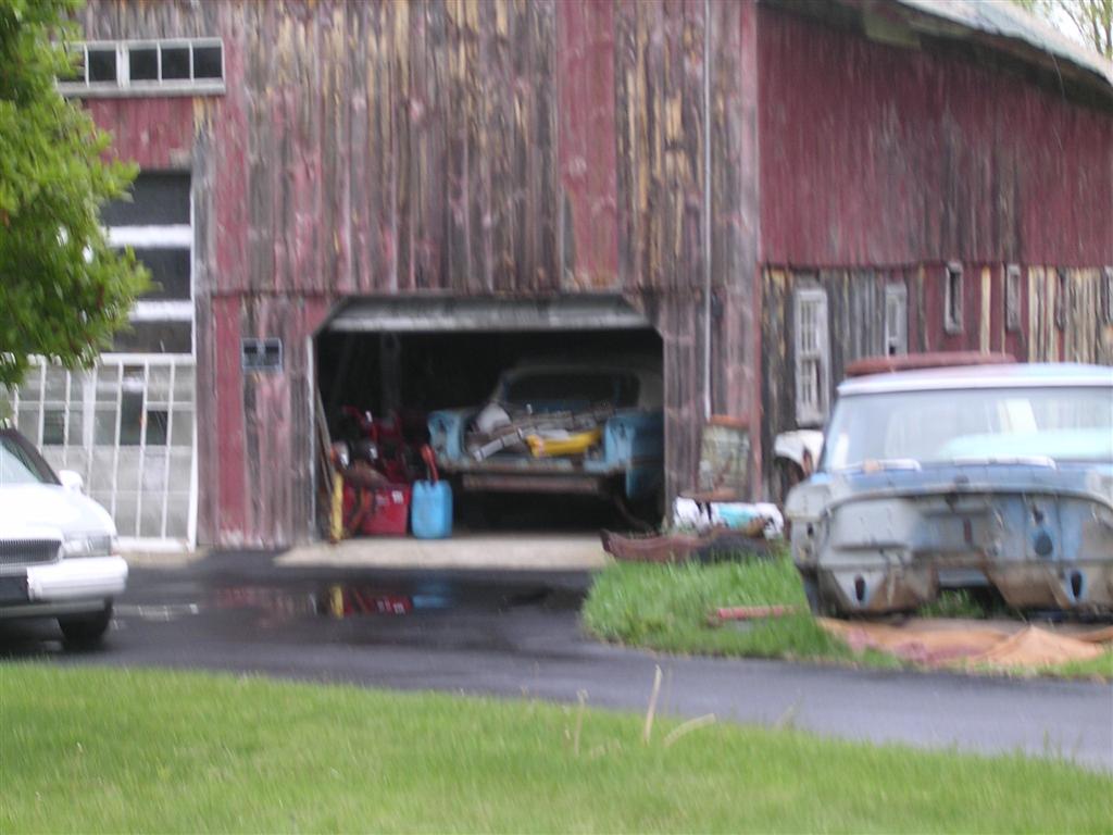

    Today I followed a hand drawn map from a guy at a swapmeet about a month ago.
    Turned out to be a treasure map instead. Estate of a hard core Olds lover.

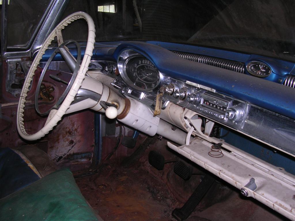

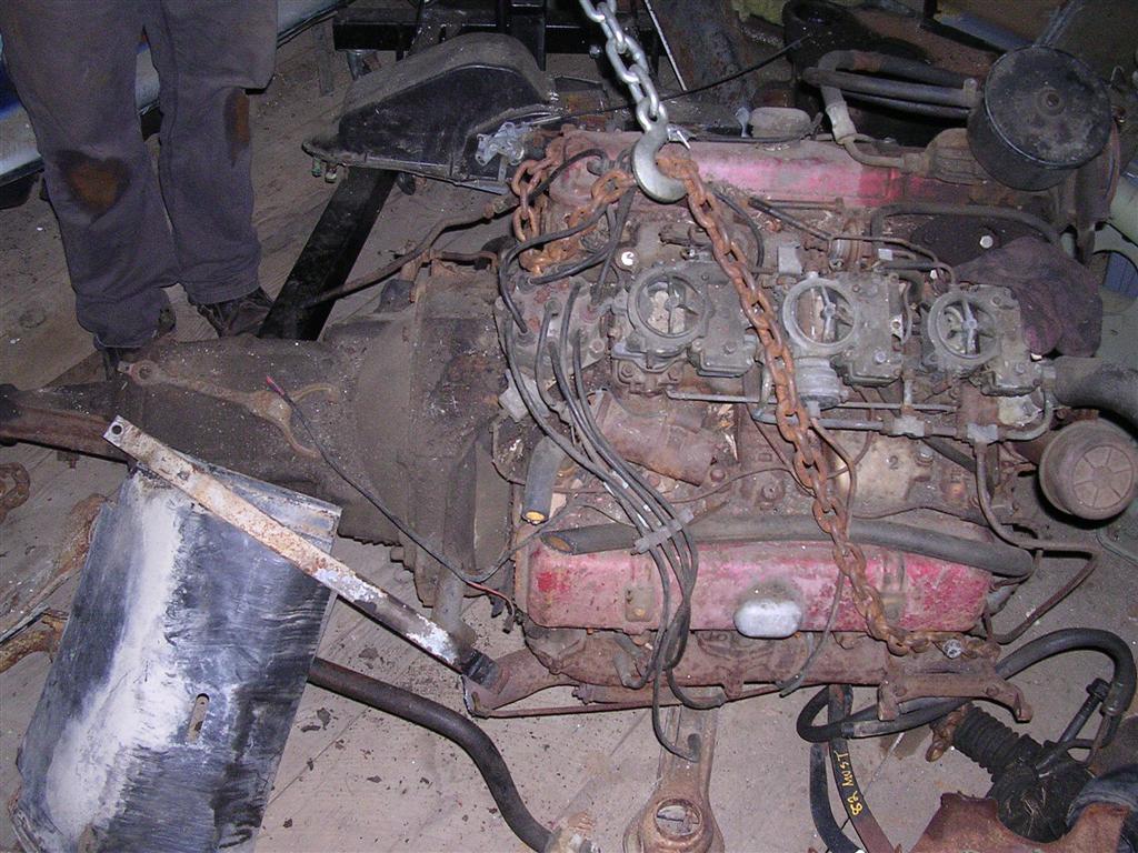

    57 Super 88 J2 factory stick trans conv. with wonderbar radio too. Blue one
    56 conv souped up 394, offy trips and covers, factory stick. Brown one
    Also pics of a flathead intake for sale, and I saw 2 1935 Ford wires just laying there. There were some flathead motors.. etc
    He said tons of stuff has already been sold off in the years since his Dad p***ed away. I did not get to see it alll....yet;)

    So far, he said they are keeping any of the Olds cars that Dad used daily. There are a few, and all are convertibles. The others are early 60s?, but I did not see them all.
    He said Dad dated Mom in the 56 conv.. and Dad drove the kids to school in the 57, and one other conv. That other conv spooked the son so much as a kid, that he would only ride in the back, because Dad had a shrunken head hanging from the rear view mirror:D

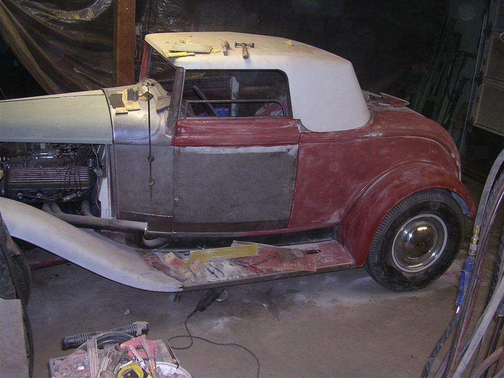

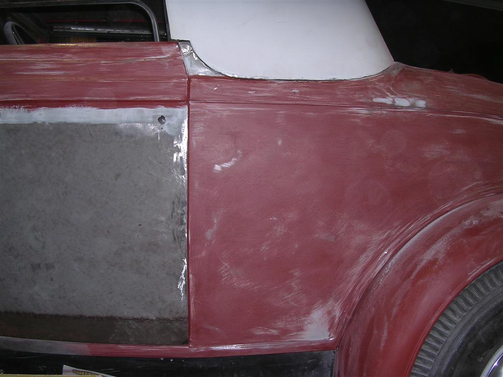

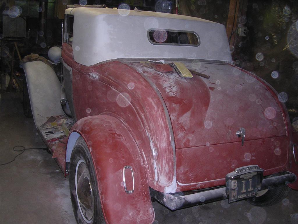

    Rear fenders took a lot to get the fit, but now I am doing the last side of the main body, and just skimmed one hood top half. The pits were so deep, it weighs nothing and has a hundred tiny pinholes :)
    There is no glory in this part of the job, even bondo dust got on the camera lens in the last pic.
    Gaps are a bit tight on the doors, but they are coming in dead straight. I may **** at all else, but I can fit doors ok:rolleyes:...especially mostly cloned/Dodge doors onto a bogus Ford cabriolet.:D

    I'm really liking those tail lights in the fenders. Nice job!
