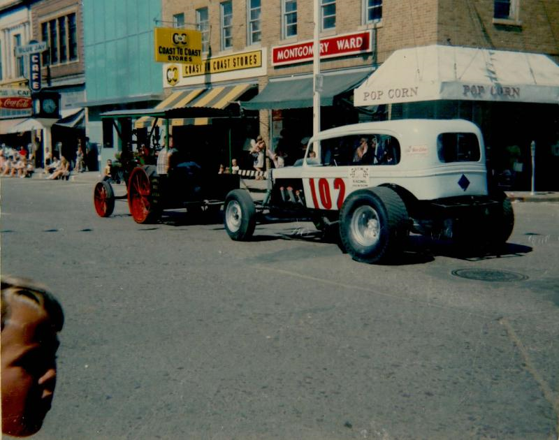

  9. tubman
    Joined: May 16, 2007
    Posts: 8,679
    tubman
    Yes they were. It was supposedly a problem. I own a dirt modified that ran in the sixties with a 324 Olds. I am missing the engine that was in it, but I have spoken to one of the original owners and builders, and he told me that the engine was heavily modified and one of the major modifications was enlarging the center exhaust port, installing a divider, and running four pipes on a side. Unfortunately, all of my old pictures of the original car are back in Minnesota while I am in Florida for the winter. I'll try to remember to look for them when I get back.
    I do have one picture of the car back in the day on this computer. It is not very clear, but they had orange rubber balls shoved into the exhaust pipes. If you look closely, I think you might be able to see two pipes in the middle, each with an orange ball.
    Don't you love the tow vehicle for the parade and the period stores? "Montgomery Ward" and "Coast to Coast"? How mid-century mid-America can you get?

    Yep, that's a great picture. Looks like the racer is being towed by an old Rumley or Hoyt-Clagwell tractor. :p
