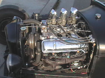

    I have seen a few different mounts for the Olds Rocket engine into an A frame, but I was hoping to see some other ideas.

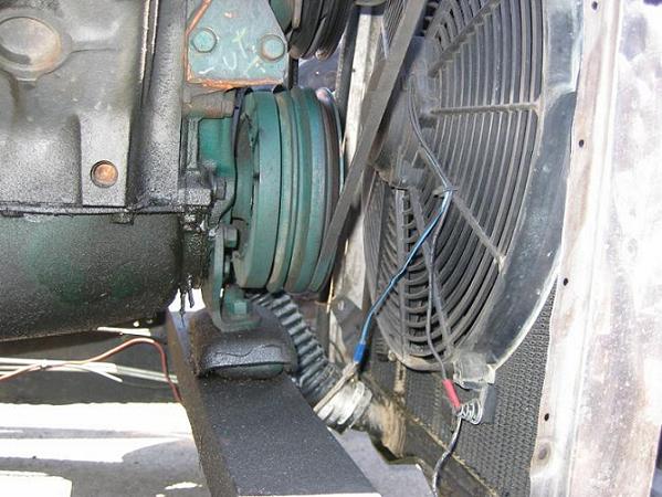

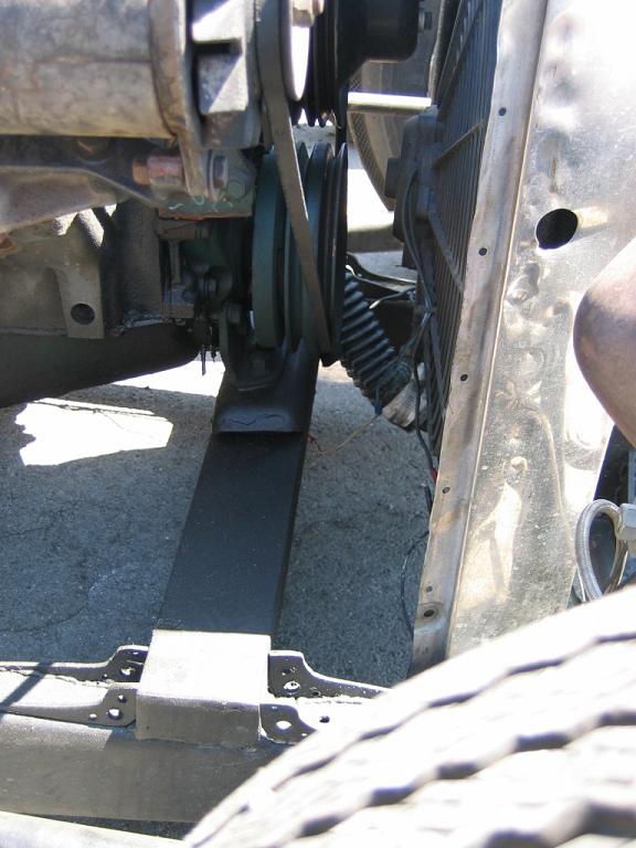

    I have seen fancy mounts to the side, I believe the Hurst style it is called, and also a very simple (yet maybe the most effective) front mount style that just goes right across the frames... as shown in the picture.
    Anyone with any photos of their setup?

    I'd like to see some ideas on this subject as well. The straight across right in front style looks like laziness he's just using the factory mount and I really dont think thats gonna give enough stability under torque. I suppose it would depend on what kind of trans mount you use but I think I would go with the aftermarket side mounts. Anyone have their own side mounts they've made they would like to post?
