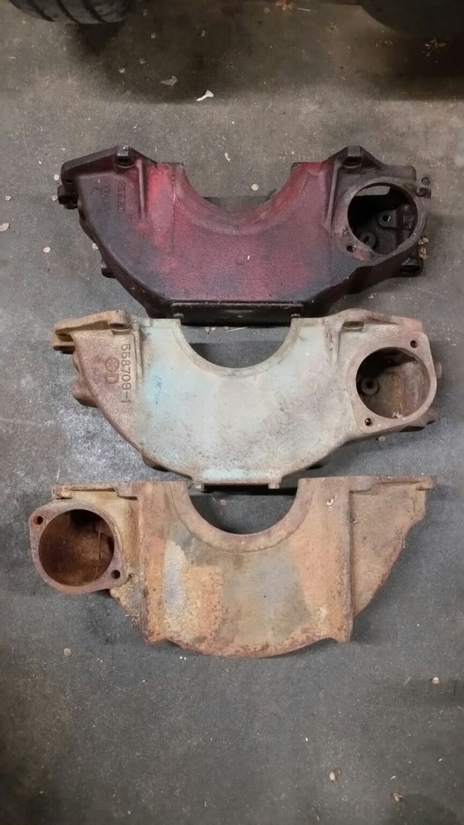

    Here is the starter relocation bell for the Olds. The caddy would put it on the same side if it could be made to fit. FFD21315-94AE-4B89-9875-37B764C7BD45.jpeg

    And here is a caddy one. They look so similar..... could this be done.

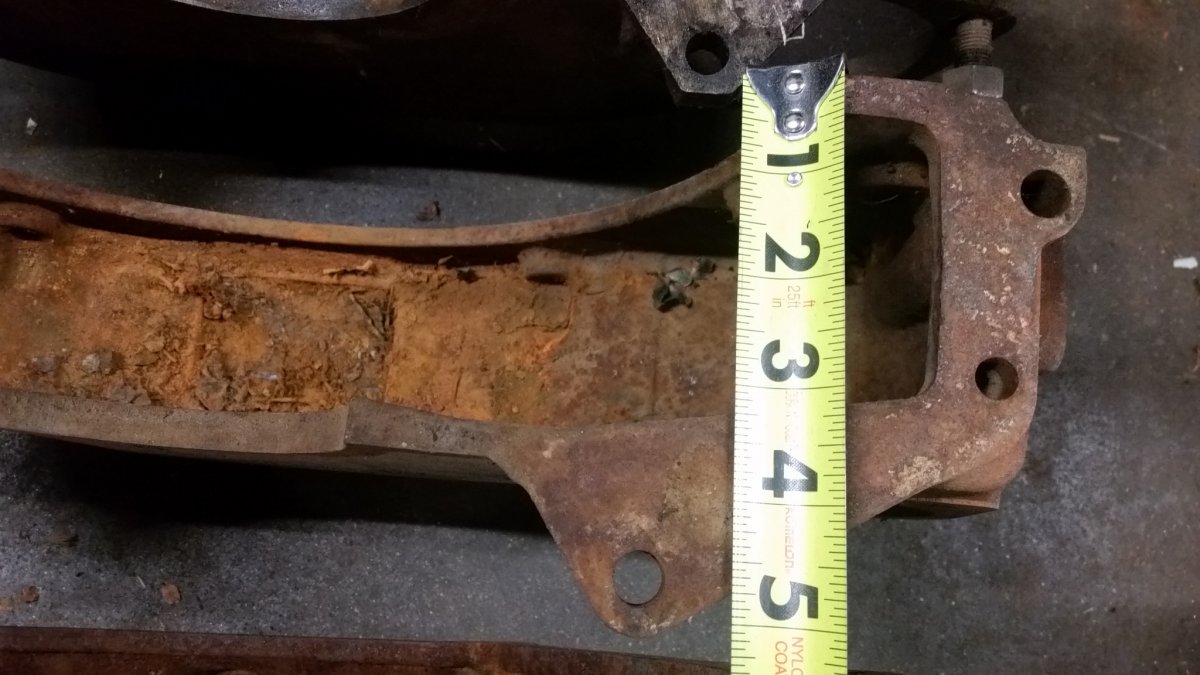

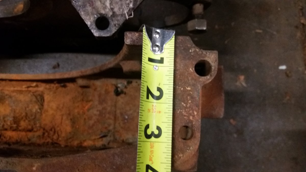

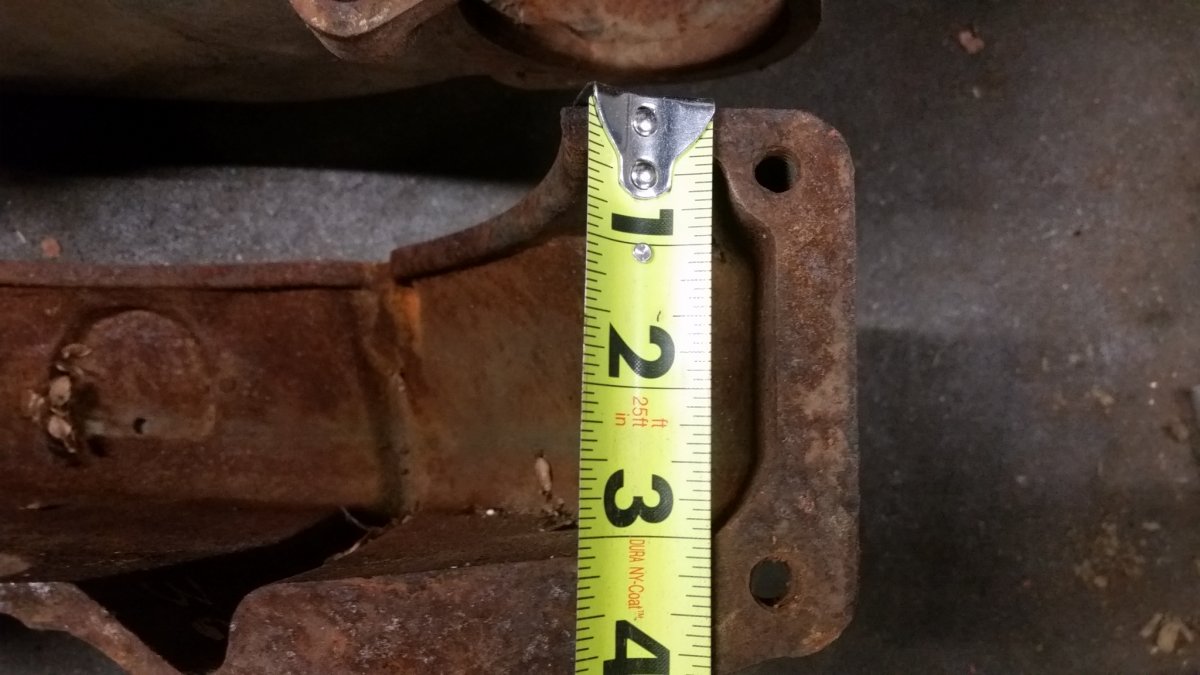

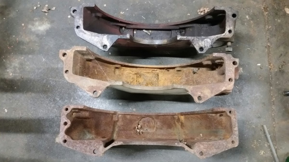

    Olds
    Cad
    Olds
    Cad
    Cad bottom, early Olds middle, late Olds (394) top. Just measuring from transmission mounting face to holes, doesn't look like any holes line up. I do not have an Olds engine readily accessible at the moment to try it on.

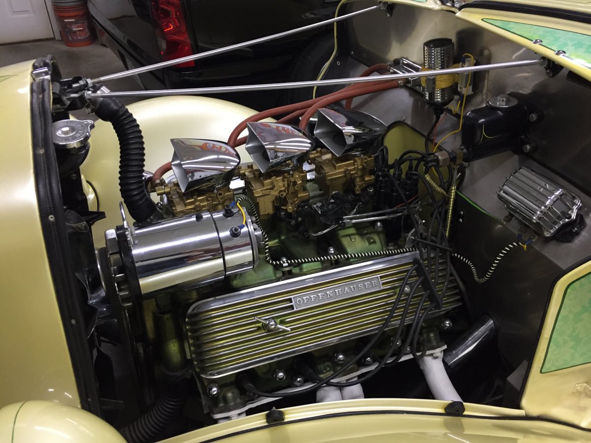

    45B9FED0-0D90-4A55-A0FD-621BBB454778.jpeg C422AA4F-6222-4D9B-923A-E3C802A78289.jpeg My 36 ford pickup with a 324 olds has an offy starter switch over on it and I am ***uming the stock olds starter. It is put on with the solenoid facing down and it works fine. The starter doesn't care that it is upside down.
