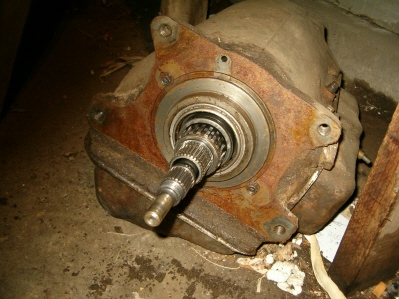

  22. 56olds-ERDY
    Joined: May 26, 2002
    Posts: 278
    56olds-ERDY
    there are several differances externaly to identify between the hydro and the jetawy.the hydro will also have a side pan that contains your valve body.with no cooling line like what was mentioned.those fins on the bellhousing are just a vent.the jetaway has it too.at least in 56.the jetaway(56-60) is a different trans that the slim jim(61-64).go with the hydro if going automatic.also i wouldnt go word for word on that 442.com website have of what is n there is wrong.
    eric
  23. Hellbilly_Buzzard
    Joined: May 5, 2004
    Posts: 454
    Hellbilly_Buzzard
    the junk-a-way also has the side pan. I know the bellhousing for the junk-a-way is part of the block and not the ******. Another thing that might help you out. The junk-a-way is a center "O" transmission. Reverse is all the way to the right on the tree. I beleive the hydros are center "R" trannies. (I could be wrong so please correct me if I am.)

  28. 56olds-ERDY
    Posts: 278
    56olds-ERDY
    the jetaway doesnt have a side pan.i can post pictures.maybe that would be easier.the trans still has a bellhousing that attaches to it.while it is shorter than most.its still there,and bolts on.oh wait i have a couple pics of my 56 poncho slant pan(hydro) here but i tore the front apart.ill snap some of a complete 55 olds one,and a 56 jetaway that i am in the middle of pulling from a motor at the moment.
    eric

  30. Model40
    Joined: Apr 11, 2004
    Posts: 177
    Model40
    from MA
    Eric,
    As they say "a picture is worth a thousand words." I can see the slant pan and side pan. Any pictures are a help and lots of other HAMBers with similar questions will be able to see for themselves too.
    Thanks
