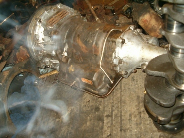

  10. 56olds-ERDY
    Joined: May 26, 2002
    Posts: 278
    56olds-ERDY
    sorry for posting this pic late.heres what a jetaway looks like if your still wondering.you can look in the classifieds to see what the other side looks like.later,
    eric
    btw sorry bout the smoke.... [​IMG]

    Eric,
    Thanks for the picture. I hope to see the fellow with the 56 engine tonight. I also got a lead from a friend about a junkyard with four early Oldsmobiles. I'm not sure of the years but I intend to take a look.
    I'll look for a picture of the other side in the classifieds and at the Olds site that I have a link to.
