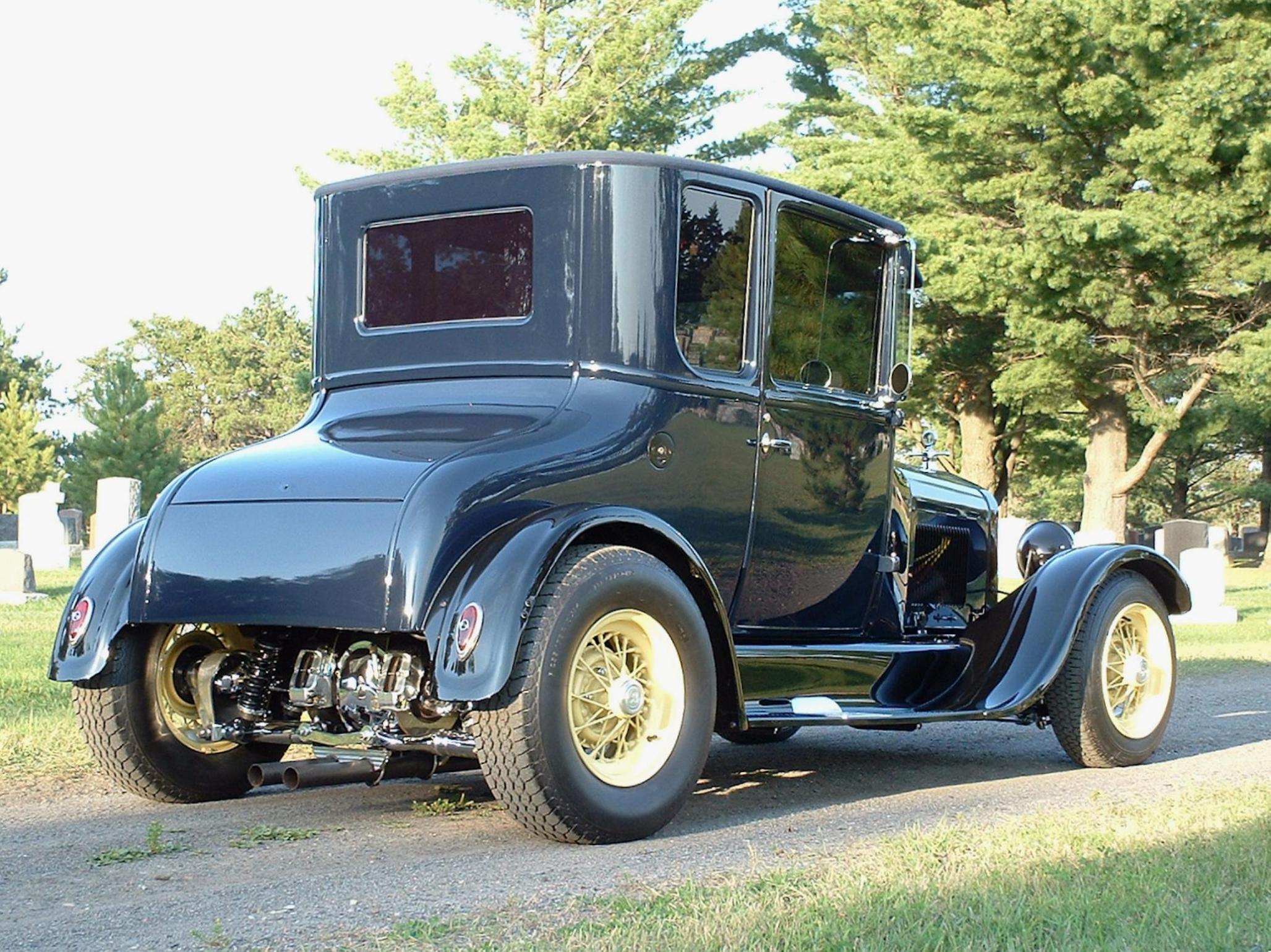

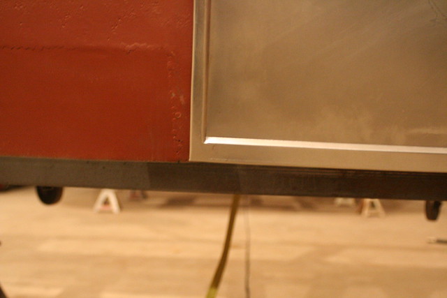

    Hey Oldsboy, I'd like to see a close up of the door skin you put on the p***enger side, I haven't installed my skins yet, but I'd like to see the transition between the skin and the original door beads on the edges!
    Nice Job BTW!!

    I've had some requests for the sheet metal work on the quarter and p***enger door. I hope these answer your questions.
    The rear quarter was a bit tricky. Had to scribe a guide on the car, remove it then used the original sheet metal as a rough pattern to cut out a cardboard template. Fit it. Then transfered it to the full replacement panel for t*******.
    The simpler way to do it would have been to remove the entire area, however I really liked the rivets and wanted to keep the look of them in the metal.
    The p***enger door panel I had to add a bit of a crown to the bead since it seemed to be a little flat compared to the factory bead. Once that was in it seemed like a decent enough fit.

    How'd you crown the door skin?

    Chaddilac -
    hammer and dolly. maybe crown isn't the right word. I had to raise the metal on the outer bead of the new skin to mate with the original shape of the bead on the factory door. Small detail can kind of be seen in the 2nd picture. [the close up shot just below door handle]

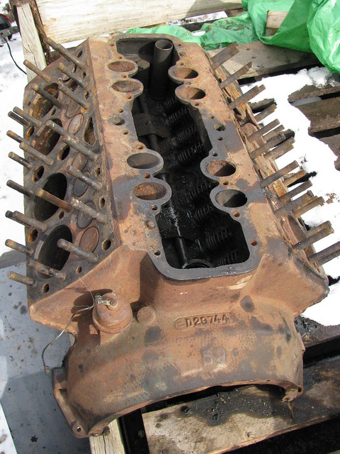

    Just a quick update here guys. Unfortunately I haven't been able to get a lot of work done on the car outside of locating a transmission, researching on how to go about setting up the drive line and settling on the rubber for the wheels. [450/475 - 16 up front and 750-16 for the rear]
    I was pretty lucky to pick up a free mock up block and transmission to work with from the same guy whom I bought model T and A frame from.
    After a closer inspection though I'm trying to decide if it can be more than just a mock up block and see if I could rebuild it and run it. I know its been sitting in not the best conditions. I found it underneath a large sheet of tin roofing beneath some trees. (so its been some what covered I suppose)
    I can't take credit for tearing it down. Its been my Grandpa's effort and time in dismantling it this far since I've taken a job out of town for a few months. This weekend though I was able to make it back and inspect it myself. I can't see any cracks anywhere which doesn't mean anything. He also mentioned all the pistons came out except 3 with no problem and the crank apparently looks really good too. Though I want to know what you guys think.
    Runnable? or Boat anchor??
    Left bank. (driver side)
    Right Bank. (p***enger side)
    The bottom end internals.
    As it is now he's still trying to get the cam out because of the 5 stuck valves which doesn't prove to be a promising sign. Any tips on removing the valves? You can see in the photos in what state the they are in.
    Thoughts suggestions?

    just pulled a flatty apart the other day and it seemed every other valve was stuck...
    used a combination of PB Blaster and an Air Chisel... soak 'em good... beat the tops of the valves with the hammer deal for the air chisel a bit to loosen the crud..
    if you can get them up out of the seat a bit and get something under them or grab the head with a pair of channel locks (i had a big pair of curved jaw vice grips) you should be good.. seemed the hardest part was getting the keepers and springs off since I lost my spring tool...
    good luck!
