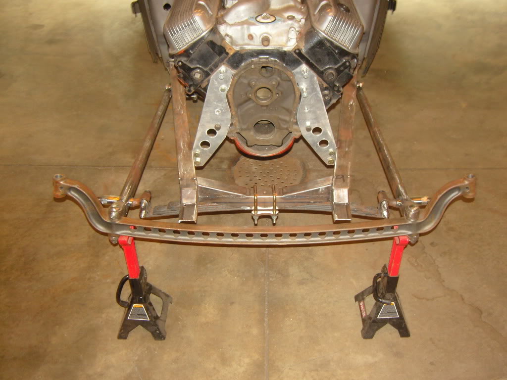

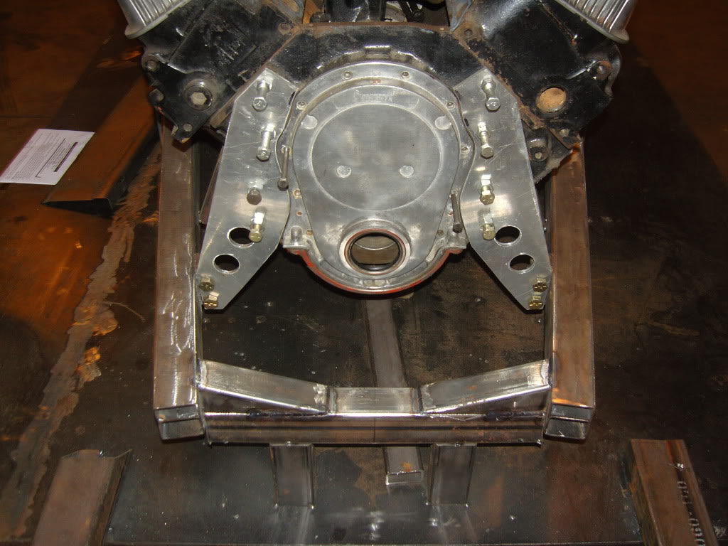

    Well I spent this last week hard at it and have come up with a semi completed front suspension. Here are a few shots of the shock setup and an idea of the motor mount/ engine situation. I'll be relocating the mounts early this next week. I'll update again when I have another mock up. Till then... some updates.
    I did recently pick up a plasma cutter...and to say the least its been an amazing addition as I think the work reflects its impact.
    I ended up splitting the boxing plates to locate and mount the engine mounts properly prior to the '38 x-member which is to come this next week.
    Floating.
    shock mock up.
    engine mount mock up. Credit to the Rolling Bones for the engine mount idea!
    checking proper fit.
    end of day mock up. I ended up tacking it all in place to check fit with the body next. Might be having to move the motor ahead a bit, but its a start.

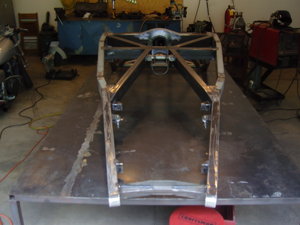

    I finally took the plunge and started in on the cross-member and transmission setup. A little while ago I came across a '38 x-member that I wanted to attempt to utilize for stock ford component locations. Plus I wanted to try something a little different at the same time but maintain that traditional look by using all Ford parts.
    Started out by doing a few repairs to the x-member.
    Took a stab a reinforcing the bottom side. Thats where the plate comes in.
    brEad likes this.
  29. oldsboy
    Joined: Oct 24, 2005
    Posts: 528
    oldsboy

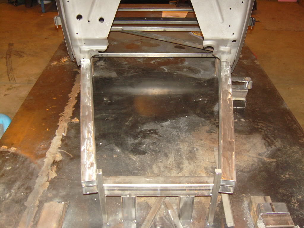

    Next step the stock cross-member had to come out.
    At this point it was all or nothing...
    Since it came from a '38 a little modifying was necessary.
    Before.
    After. Ended up narrowing the arms and taking out about 2in via a pie-cut.
    The front only ended up being about 7/8".
    End result.
    After a few hours of tweaking it dropped in.
    brEad likes this.
