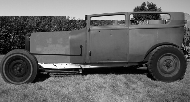

    I think a milder chop would look better. Something like this? Cool car though, looking forward to seeing it progress.

    You said you liked the look of the heavily chopped lakes or Bonneville style. But there is a BIG difference in craming yourself into a heavy chop for the few minutes of a speed run and being wadded up for two hours on the road. I have a 5 1/5" chopped T coupe [it was already chopped when I got it] and I'm concerned about fudging somehow to get back a bit more head room.
    Put a piece of plywood or cardboard in at your proposed chop, figure out your seating, and see if you can live with it. It's easier to cut off more than put it back if you go too far.

    You make a good point OH. I'm going to be postponing any type of thought regarding the chop until the very end as I have some body mods to get to which will impact the proportions and in the end effect the amount of chop.
    I like the idea of building a temporary roof to figure out the head clearance.

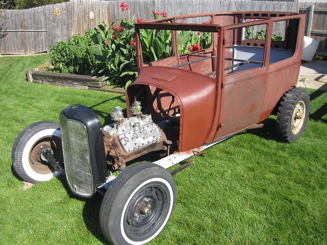

    Well, the last few weeks have been productive on a few levels. Might have found a job as well as a potentially running flathead (thanks to Timm and his new '46). All of which has been motivated me enough to get some body work done on the T.
    Started out by sectioning the header panel. I did take some photos as I haven't seen anyone do this, but I think thats because its a pretty simple procedure, regardless they're here.
    The header lead to raising the cowl and straightening out some patch panels that were installed a few years ago on the lower portion of the cowl. I wanted to raise the cowl to achieve a proportion the T's (to me) are some what lacking, however all credit for the idea goes to the "bad news" T from the choppers.
    Also I wanted to try and run a stock '32 grill shell with the potential of a hood on the car without having to section it because I love the proportions of a stock deuce shell.
    Regardless take a look, let me know, I did more photoshop play earlier tonight for kicks.....

    Cowl.
    The whole process turned out not too bad once one figures out how Henry put the darn thing together so you can get it apart.
    Ended up making the pieces to add in...
    Who needs a break...
    I'll have to do a little more finishing work when the time comes but its as clean as it needs to be for now...
    Everything installed...
    Proportions....its all about proportions.
