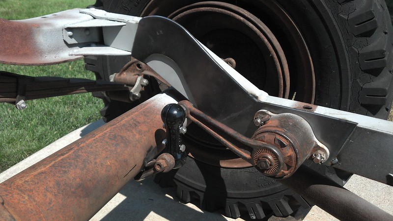

    Found an afternoon to take a look at the rear shocks. It was pretty warm but I had some help from my Grandfather so the work was a little easier with an extra set of hands.
    Not to mention he came up with the shock mounting idea.
    mock up.
    was a frozen shock arm...
    now axle shock mount.
    installed.
    FYI the "C - notch" in the fish-plate will be finished soon. I'm going to take care of that when I disassemble the chassis down to the frame and put it back on the welding table....

    I dig the shock mounts, very clean.

    Wow! Taking your time and doing things right is paying off. Is that a solid enough connection where the shock mounts hit the axel housing?

    I'm thinking it should be but we'll see. It'll have a good inch and a half of solid weld on each side of the lever where it hits the axle tube. Ill post some pictures after its finished.

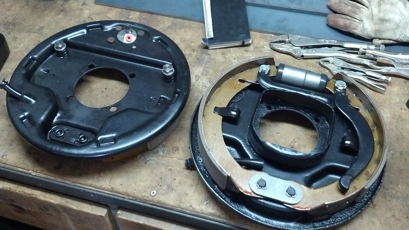

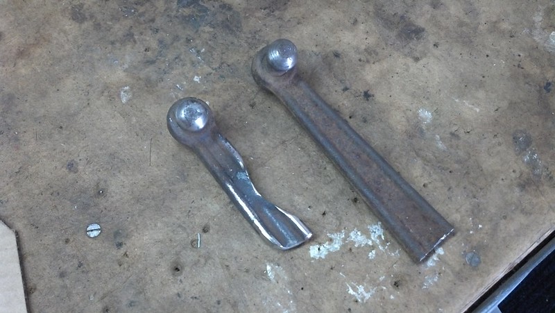

    Kept on it this weekend and was able to finish up a few small details, i.e. brakes, e-brake mount and reverse sectioned the firewall to account for the addition to the cowl...slowly and I say slowly it seems like its getting there.
    I have a steering setup in the works so in the next month something will happen with that as soon as I tackle the frame. In the mean time, its the small things that are getting wiped out.
    Brakes.
    Emergency Handle.
    Firewall.
    Ran out of time as it needs to be finished, but the test fit looked good.

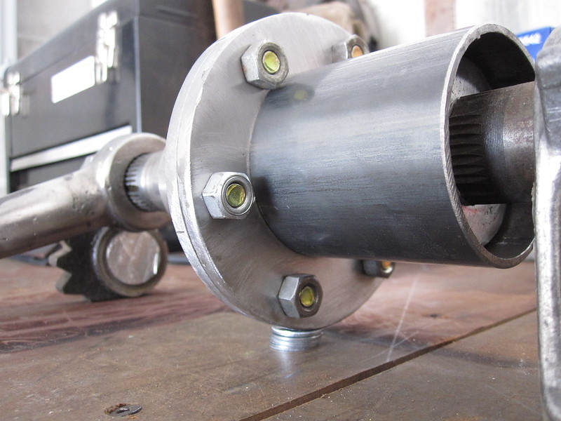

    Steering:
    I have to say this effort all came from the great tech articles posted by Chris Casny. However I wanted to attempt to utilize the look of an old for steering arm so this is what I've come up with. It can still be broken down, but it should be able to handle the stresses of a steering arm.
    Components:
    '40 Ford Pitman Arm
    '37 Ford steering shaft
    1-very large machined bushing
    (2) 1/4" x 4" Plates
    1 - 2-1/4" tube
    6 grade 8 bolts
    This is all mock up since I don't have access to my welder yet, but I think you can get the idea.
    I'm now working on a design for the steering rack this will be housed in, that'll be the next post if all things go accordingly.
